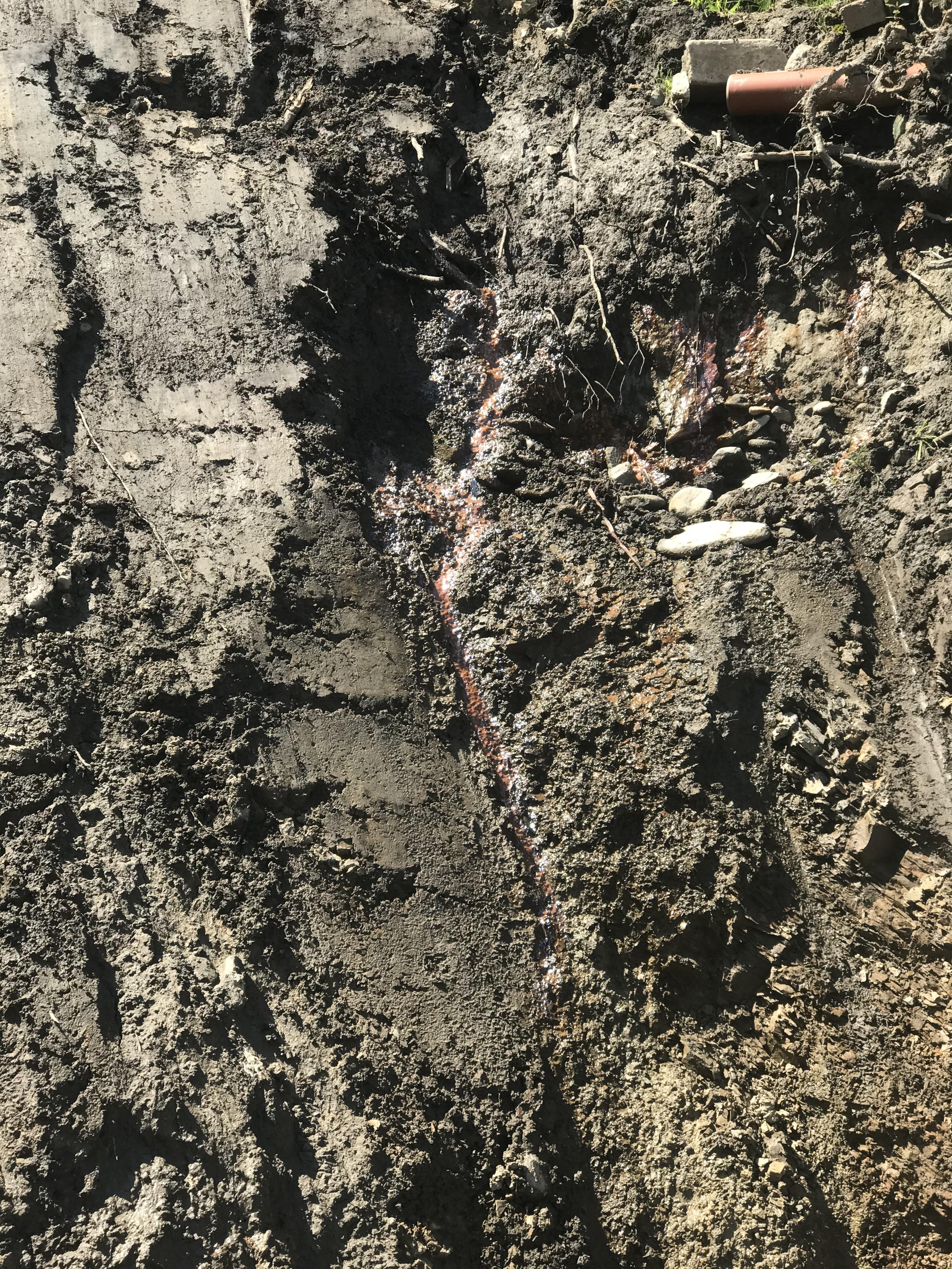

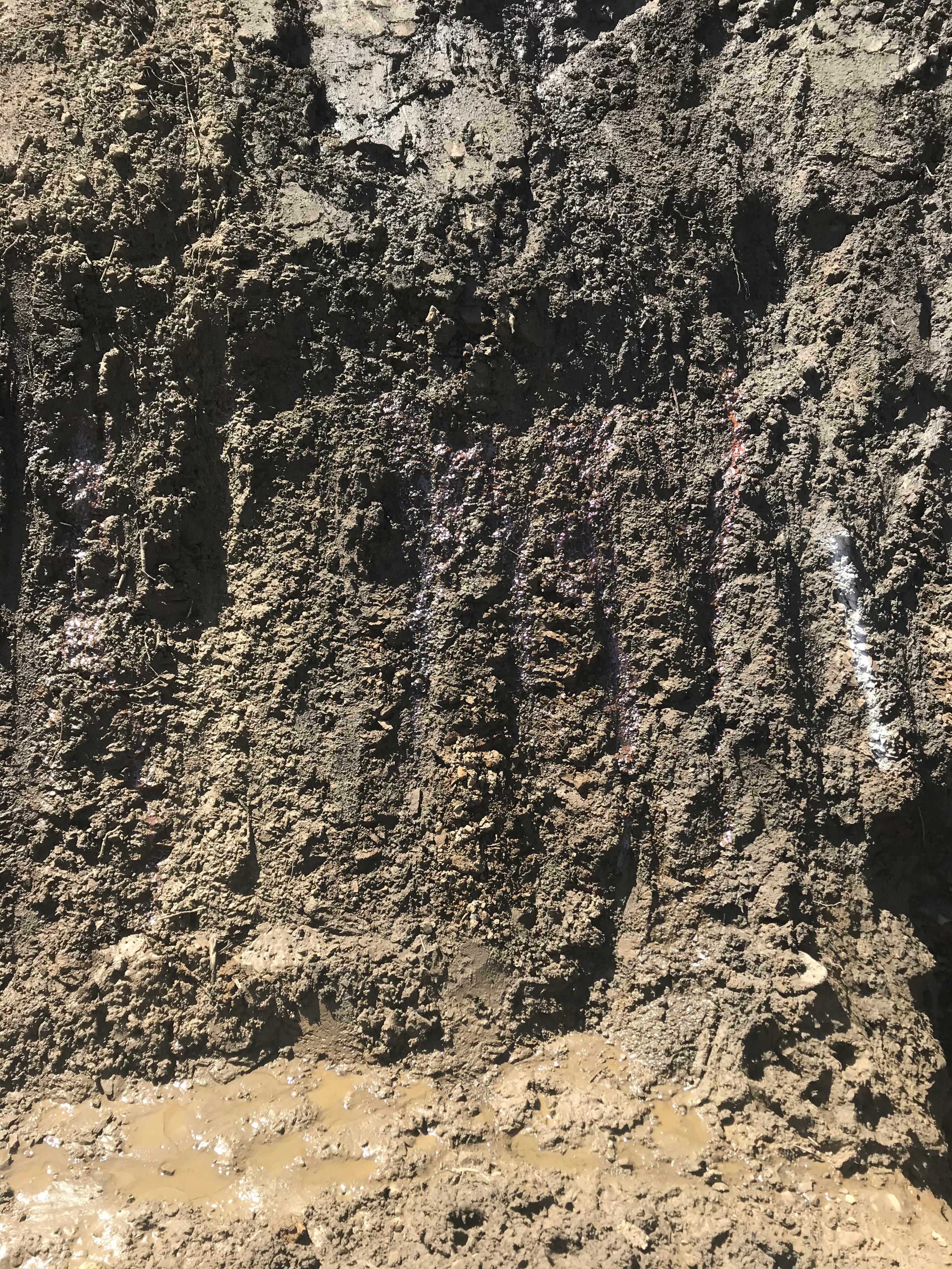

  5. Hi. I have recently dug out for the foundations on a sloping site and the bank at the back of the house has an orange - petrol coloured liquid coming out in a couple of places. A local ground worker that's helping me with the dig, has said that it's all over the area and it's Iron ore residue from the closing of the mines. The building inspector has also seen it and wants me to get it checked out. I've mentioned it to my architect and he is in the process of finding out what needs to be done. Has anybody come across this before and what is the solution to it? Thanks.

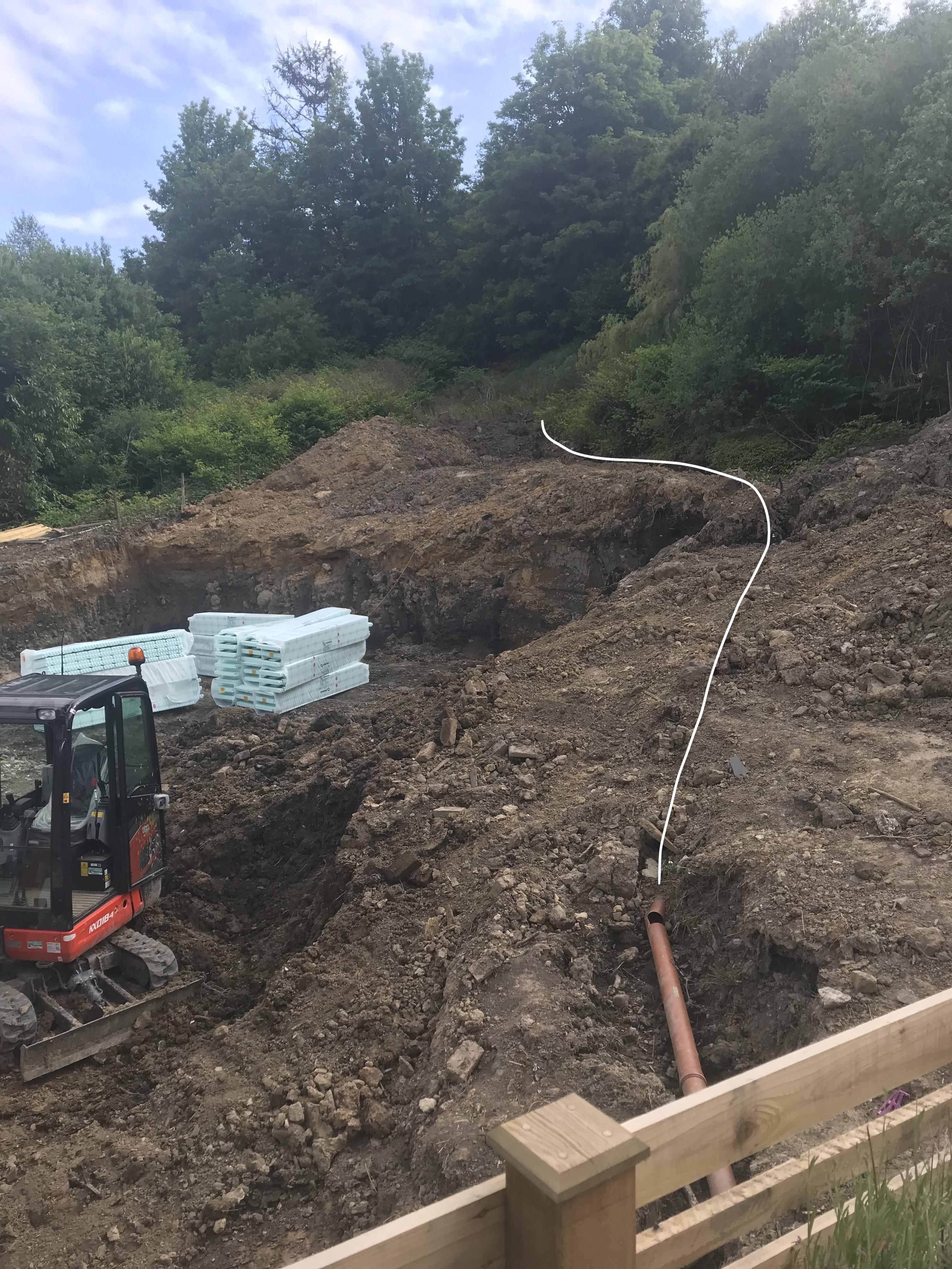

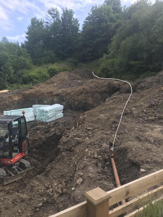

  9. Mine is nothing like yours. There are a few springs in the ground behind me and the water is coming from there. It was called a ditch, not watercourse from NRW and they said it was my responsibility. The engineer in planning said differently. The house will be positioned where the ICF is. The water runs through a ditch behind and I have temporary culverted it, whilst I was moving earth. The whole length of the white line needs to stay open and then it will drop down into a culvert.
  10. I've spoken with Welsh water, NRW and the drainage engineer in planning is the one that I am dealing with. The other 2 didn't want to know.
  11. Planning have agreed for me to culvert part of it. The watercourse I have is starting behind my plot which is elevated and runs through at a higher height than my house and garage. I've had to cut out a big amount of earth to build the house and water is seeping through the ground. Thanks.
  12. Hi. I have around 50m of watercourse running through my plot. 30m will be culverted and the other 20m needs to stay open. I'm looking for ideas on the best material to line it with, rather than just a half concrete culvert. There is not a huge amount of water, so it doesn't have to be very deep or wide, but it will be on show, so I want it to be a bit of a feature. Any body come across this? Thanks.

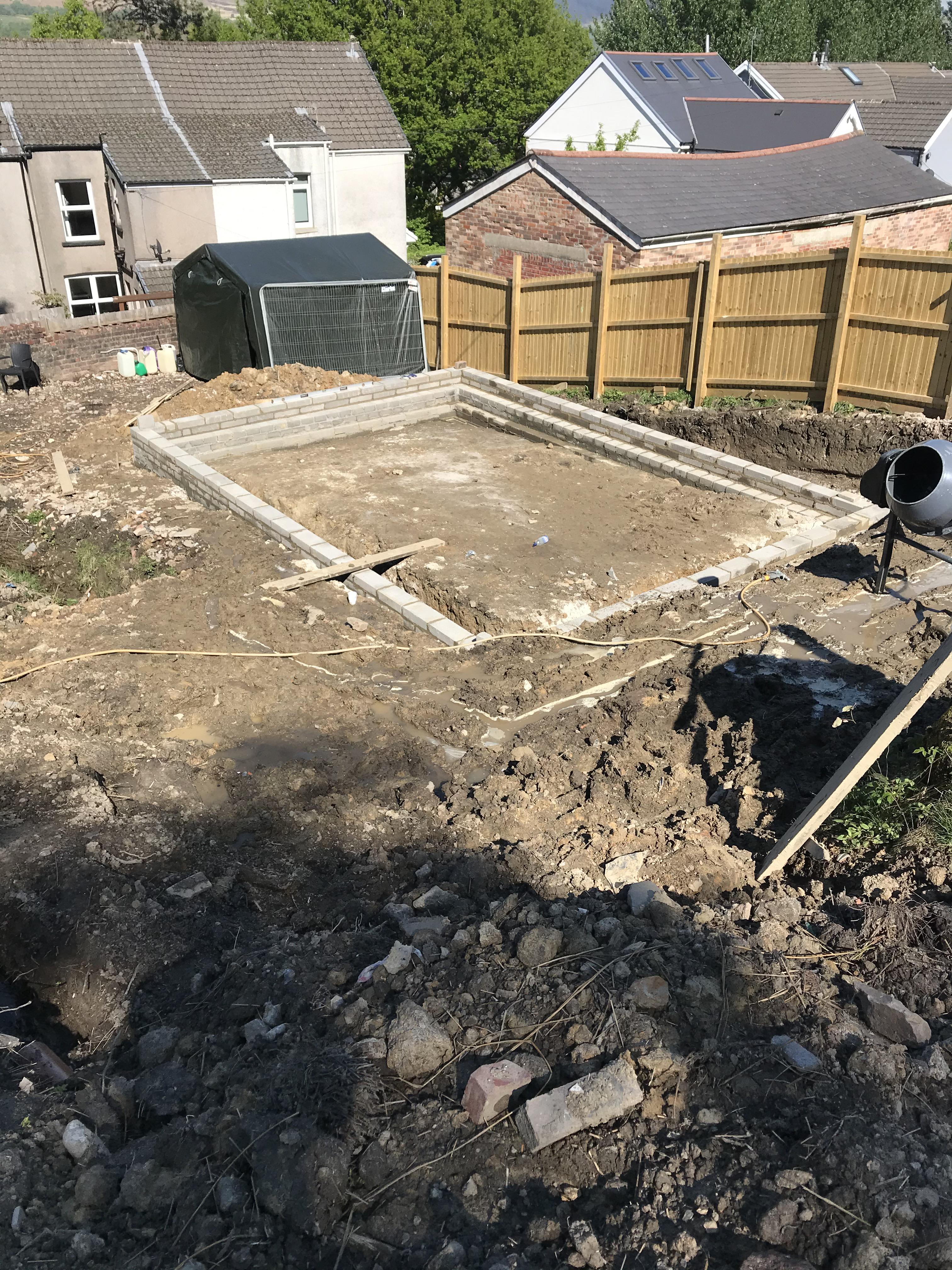

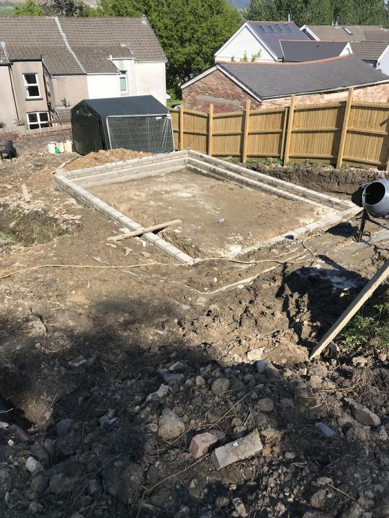

  23. I wish I knew this a couple of weeks ago. The bricky has been a pain, not very helpful and really bad mouthing ICF. I can see this being more straight forward if using a raft, but more complicated with strip foundations. I have come up to floor level with a block flat. I've been told to just lay the DPM up the inside wall and render as far down as I can, below floor level. There will be thermal bridging at that point, but it is a garage and the BCO isn't that concerned. My only concern is getting any damp. Do you think this will be good enough? Thanks.
