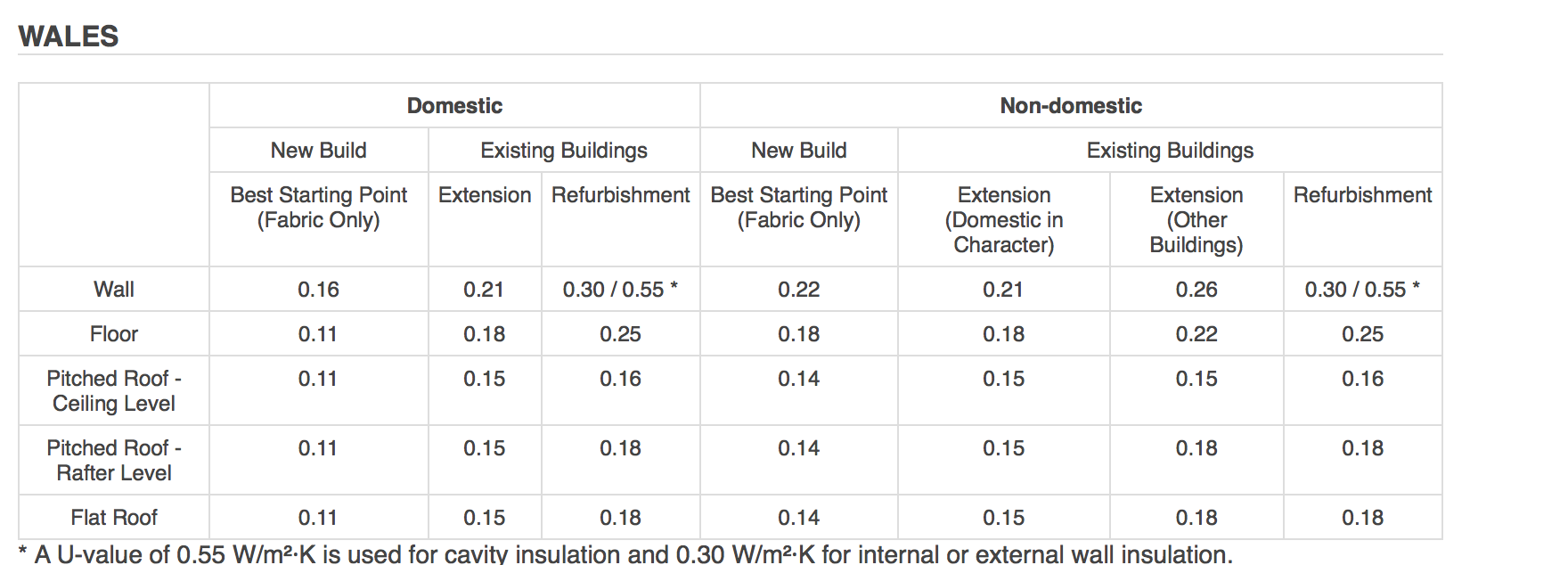

So, Ive just been speaking with a developer who is building multiple properties and he suggested that I speak with Superfoil as he has used this product on all of his properties. They have given me the following solution. SF60 below rafters, 25mm PIR in between rafters and SF40 above rafters. They have stated that this achieves 0.11. I have just spoken to them again and told them that I don't want to have the hassle of fitting PIR if I'm going down the foil route and asked if I could fill in between with wool (whether glass, mineral or natural). He stated that I only need to double the thickness of the wool to achieve the same U value of a PIR insulation, but will still need to have the 2 layers of foil. They have also sent through an alternative, which is 200mm wool in between and SF40 on top. This method seems a lot less hassle than having to cut and gapotape PIR, but I'm still unsure, as so many people say foils are not good enough. I've input these materials into the Ubakus calculator and it doesn't come near 0.11. Does this seem correct.
From the diagram it states 0.18 for pitched roofs at rafter level. My own logic says that what he's been told is incorrect, as I had to do more than this with 2002 regs. I can't understand why they've told him this and are they treating the quilt foil as if it is some type of super insulated material. I'll be putting the last floor of ICF on soon and then ready for the roof. I'm trying to work out the most efficient way of insulating it. Thanks for the link, but where do I go once i'm in ProDave's profile?
Hi. I'm trying to understand exactly how building control calculate insulation requirements. A friend is currently refurbing a property in South Wales and has been told to put 75mm PIR in between the rafters and a foil quilt underneath. The rafters are only 4x2s and so he's had to add a batten underneath to get a 50mm air gap. I've put this into the calculator and the U value is 0.39. I refurbed my own property from 2002 regs some time ago and had to put 100mm in between and 50mm underneath. I'm currently doing a self build and to achieve the 0.11 that I need, I am putting 200mm of mineral wool in between and 150mm on top. Are these foil quilts that good and why doesn't the calculator recognise the U value of them? Thanks.
