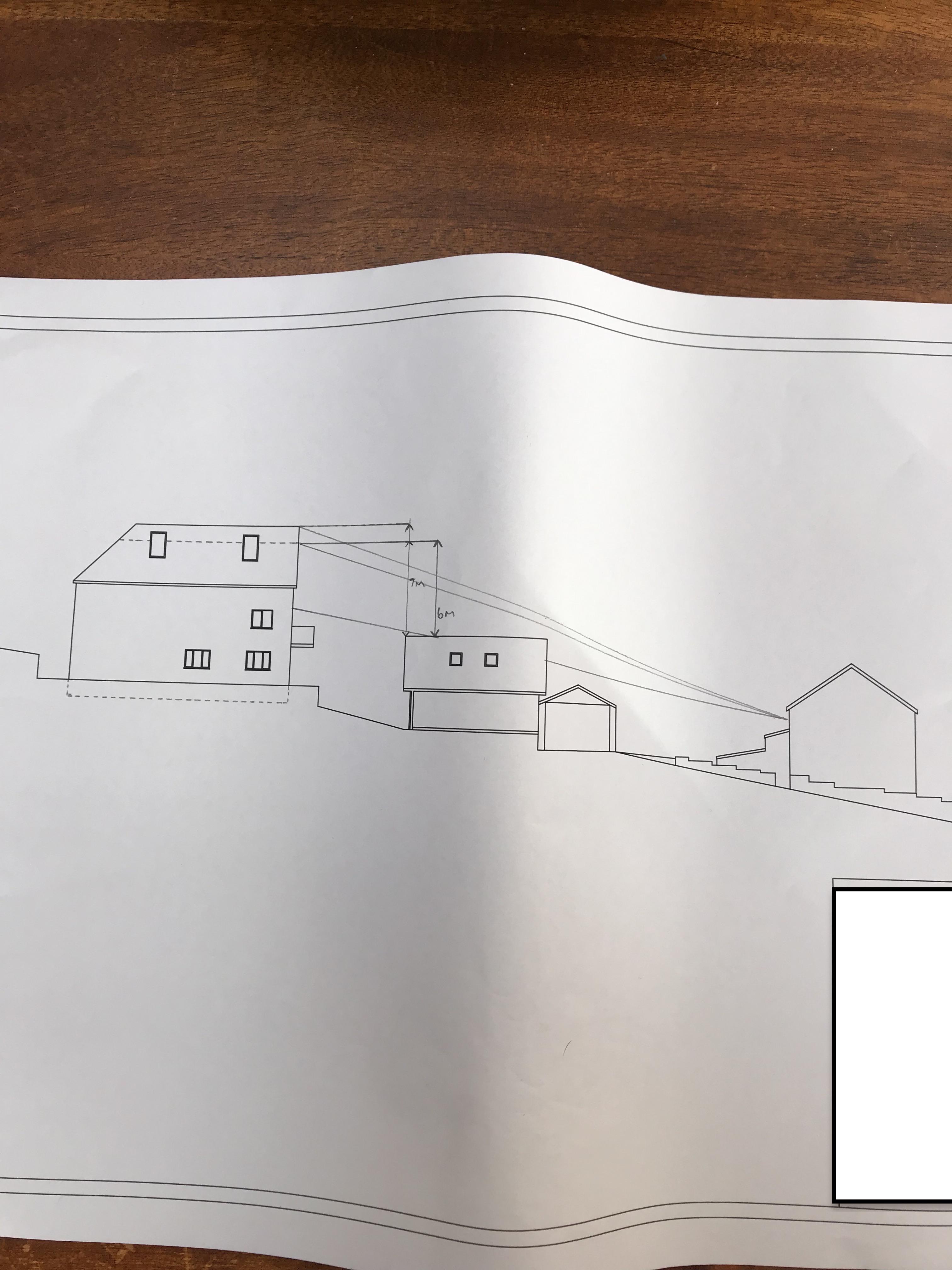

Hi. I have now found out that the concerns the neighbours have are down to privacy. It's difficult to get to the bottom of everything because even the planner is not being honest with me. It feels like she is trying to keep the privacy issue away from me, but keeps asking for amended plans to show the impact of the property it will have. Does this proposed plan seem unreasonable? There is a windows on the 2nd floor, just below the ridge height, but she has asked me to obscure it. As far as I can see the only relevant windows would be to the first floor and the garage will be in the way. The house is also over 30m away. Thanks.

Hi. I am still having issues with my application and would like some advice from some of the experienced members. After almost 4 months from first applying, I was asked by the planning officer for a side cross section showing the elevation of my proposed build in comparison with the houses in front. I questioned why she was asking this after so many months and she said it was due to the one neighbour having privacy concerns. She then asked me to amend the plans, but said it was due to what she and her team thought and had nothing to do with the neighbours. She wants me to drop the total height of the house by 1m, remove the balcony from the front elevation and remove a window on the second floor. Even though I didn't want to do these things, I have accepted. She has now emailed asking for a further 3 weeks as she will need to consult the neighbours. This has now confused me and it's getting frustrating. It feels like she has to get permission from the neighbours to do her job. If this is correct then I am fine with it, but everybody I speak with tell me, that if I'm within planning policy then it shouldn't be an issue. Can somebody please give me some advice on how planning actually works. Some people tell me not to bow down to them for everything the ask for, as they will take advantage, whilst others speak about them as if they were gods and do everything they say. Thanks.
I think a lot of issues that I've been getting is due to the person I've used for the application. He is a SE by profession, but also does drawings, so he is not a true Architect. The majority of the things he's submitted has been very vague and basic. I'm having to meet him on site today to do the calculations for him to draw up a detailed cross section, including the surrounding properties. Hopefully this is good enough for them to finally make a decision. I'll post it up once it's completed. Thanks.

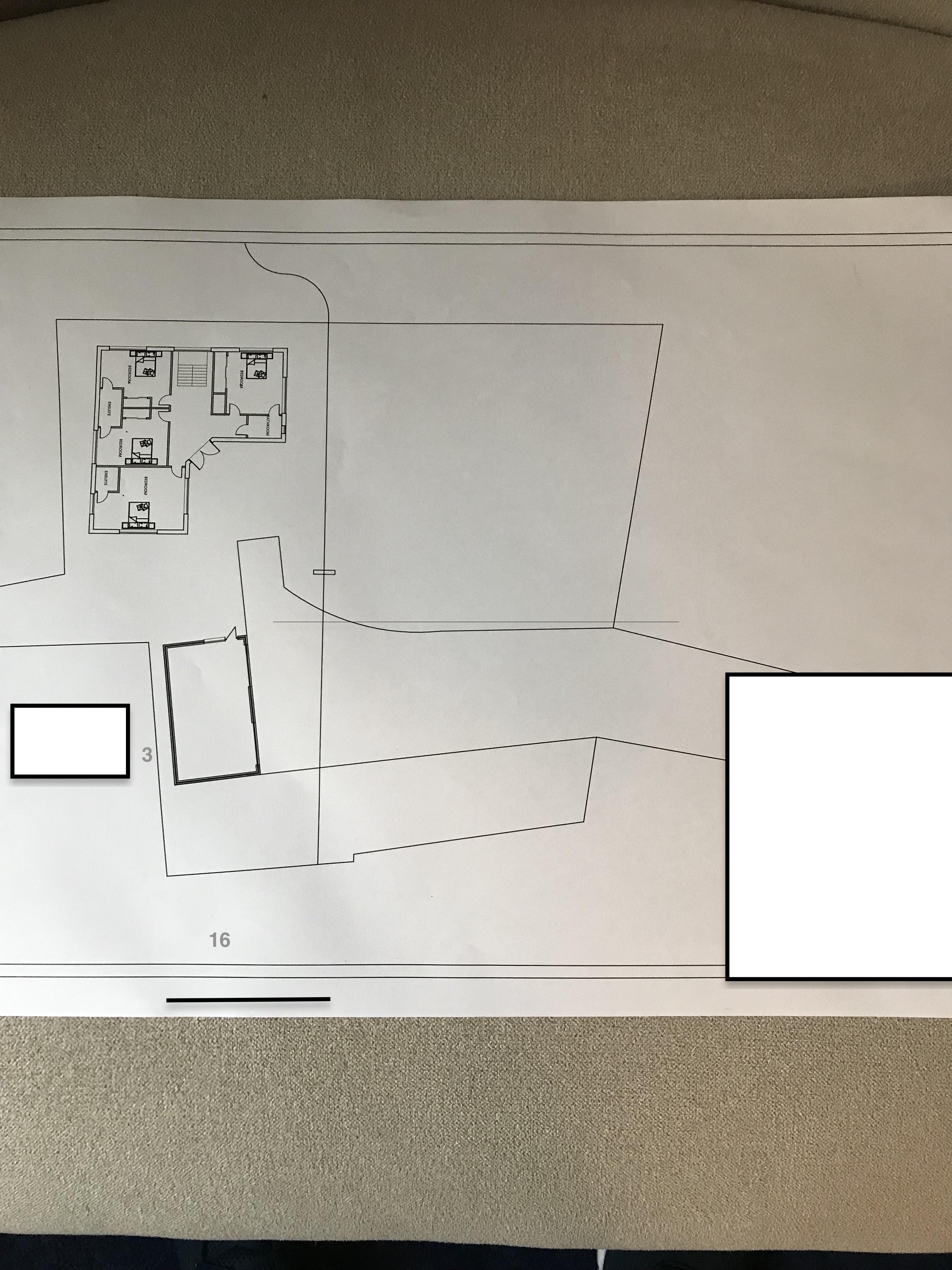

From the back of there house to the garage is about 16m and 3m from the garage. There house is about 10m or so away from the boundary.
Cheers Mr Punter. What's the problem with the address? Should I just crop it out? I think I've left it in on another plan I've put on here.
The neighbours house is below the garage and I have moved it quite a bit away from the boundary. The ground slopes up from the bottom boundary to the top and keeps rising behind the property. The bottom edge of the property is about 25m away from the boundary.
The garage has a room above which will be for a home office and the gable end is facing the neighbours property. There are only windows in the roof. I can’t see there being any overshadowing from the sun as the ground keeps rising for a few hundred metres behind my house. I am higher up than the neighbour, but then there is another property behind me thats a lot higher again. The people recently moved in. I bought the plot off the owner that also owned the property that they’re in. They told him that they had no objections when they were buying, now they’ve changed there minds. The party wall next to the existing garage is a chain link fence, so there’s no issues with a wall falling down, his garage is a further 2m or so away from that. That’s exactly what I would have preferred PeterW. If they communicated with me directly, we could have sorted all this out. I will try and speak with them to put there minds at ease. The last thing I want is to be having disputes with neighbours. That’s what I thought PeterW. If the objections could potentially have serious consequences then it would be considered. Just because they don’t like what is going to be happening is not serious enough.
Hi. I am now coming to the end of 4 months since my planning application was submitted. The planning officer has asked if I can extend it for another month whilst they are just waiting on a few more things. I have managed to find solutions to all the issues they’ve had so far, but the next thing they want detailed is a cross section of the property in relation to the house in front. The 2 properties that are in front and below have objections and concerns about a few things. The one neighbours concerns are understandable and there won’t be a problem dealing with them. However the other neighbour has issues with privacy and sunlight. A garage that I will be building will be towards the party wall and an existing garage. How far away should I be from both these structures to stay within the law. I will be around 3m away from the existing garage and 5-6m away from the party wall. Thanks.
