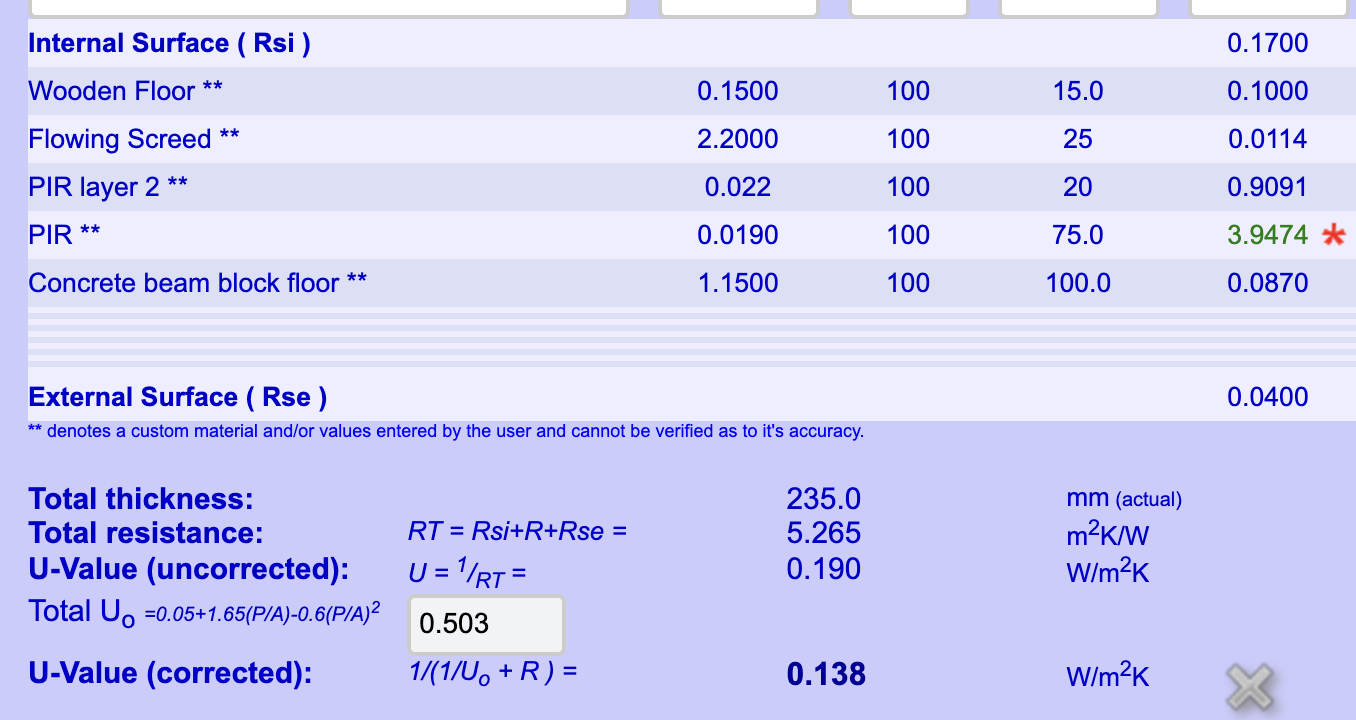

  9. Yes. It's often referred to as a "slip membrane", can be the thinnest/cheapest plastic that can survive a couple of days of foot traffic as you lay the ufh piping and pour the screed. VCL isn't really the best term for this layer.
  10. Switch out to 40mm of liquid screed instead of 70mm of sand/cement. That gives you an extra 30mm for insulation (e.g. giving you 130mm total for insulation), and liquid screed has 3X conductivity meaning more heat goes into the house instead of into the ground below. If you want to bump up performance further... For the insulation, you could go with this: https://www.secondsandco.co.uk/product-page/20-x-70-85mm-kooltherm-non-foil-1-2-x-2-4-s and then add a layer of 50mm regular PIR on top (stagger the joints). To be honest, likely simpler to just put in ~130mm PIR and be done with it.

  16. Hi all, We've got the following two options, please can you advise ? Option 1 Kingspan K103 at 75mm depth 45mm to 65mm of sand/cement screed with hardener Option 2 Kingspan K103 at 75mm depth 2nd layer of floor insulation at 20mm depth 25mm to 45mm of Liquid screed Thought process is: The K103 is already purchased and on-site, so no option to go with a different product This would be a significant improvement in performance: u value goes from 0.158 -> 0.138 A liquid screed would conduct more heat into the building, rather than below the house, so would be more efficient to run Key notes: 1) This is on Ground Floor. Construction is beam and block. 2) We have UFH. Questions: 1) Does this make sense ? 2) Is there a disadvantage to a liquid screed ? 3) Are there any issues with laying a 20mm depth PIR on top of a 75mm depth PIR ?

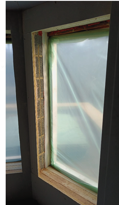

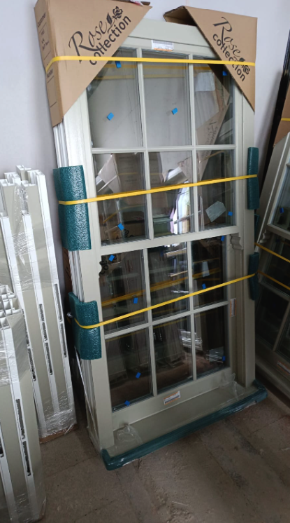

  18. We're using 25.5mm insulated plasterboard in our reveals (17mm PIR + 9.5mm plasterboard) Given we've got sash windows with wide frames, this works nicely visually, and provides a good airtight finish.
  19. Cement fillet on the outside to match mortar colour might look nice also ?
  20. 1. Agreed to fix with brackets, this is the manufacturer recommendation 2. Compriband around sides sounds sensible. 3. Silicone or PVC trim ? Assume you'd match colour to the outside colour of the sash window ? I've seen examples of silicone and it doesn't look that neat to me - is trim nicer ? Or would you do clear silicone ?
  21. Hi all, We've got some PVC box sash windows to fit in straight reveals. Any advice in terms of how best to fit these? I.e. sealant, etc. Also, was thinking coloured sealant to match the outside colour would make sense, rather than cement ? Does that make sense? We've already put decent cavity closers in. Thank you in advance !

  24. Thinking was that 75mm phenolic is like 90mm PIR... Should be okay? Especially with a liquid screed so heat won't have much resistance going upwards
  25. Proposed GF buildup: 1) beam and block (already done) 2) radon barrier 3) 75mm phenolic insulation 4) slip membrane 5) UFH pipes 6) 40mm liquid screed We are very height constrained.. I'm just wondering if there is any kind of radon barrier or slip membrane that would help me reflect the heat upwards ?
