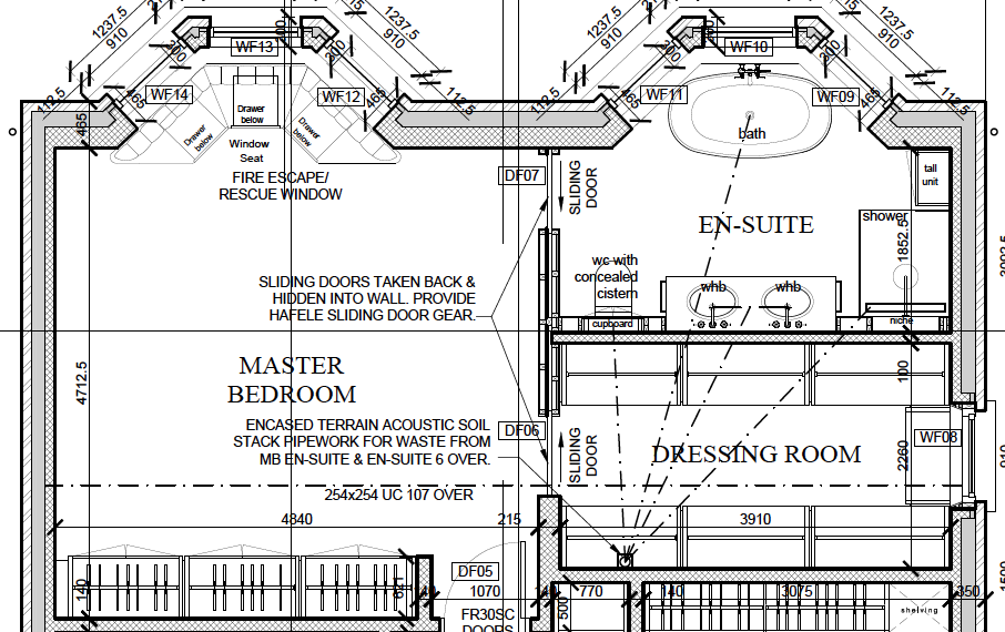

Very. We dry lined with insulated plasterboard and it's a new build. And yes the doors are undercut. I'm inclined to give it a go unless someone tells me otherwise -

We've got an mvhr unit on the ground floor bring fresh air into kitchen and extracting air from toilet/boiler cupboard and under stairs. The rest of the house has trickle vents that we can open and close as needed. My thinking was to install this in the master bedroom area and then close the trickle vents in that area. We've got dmev fans in the other wet rooms running continuously. -

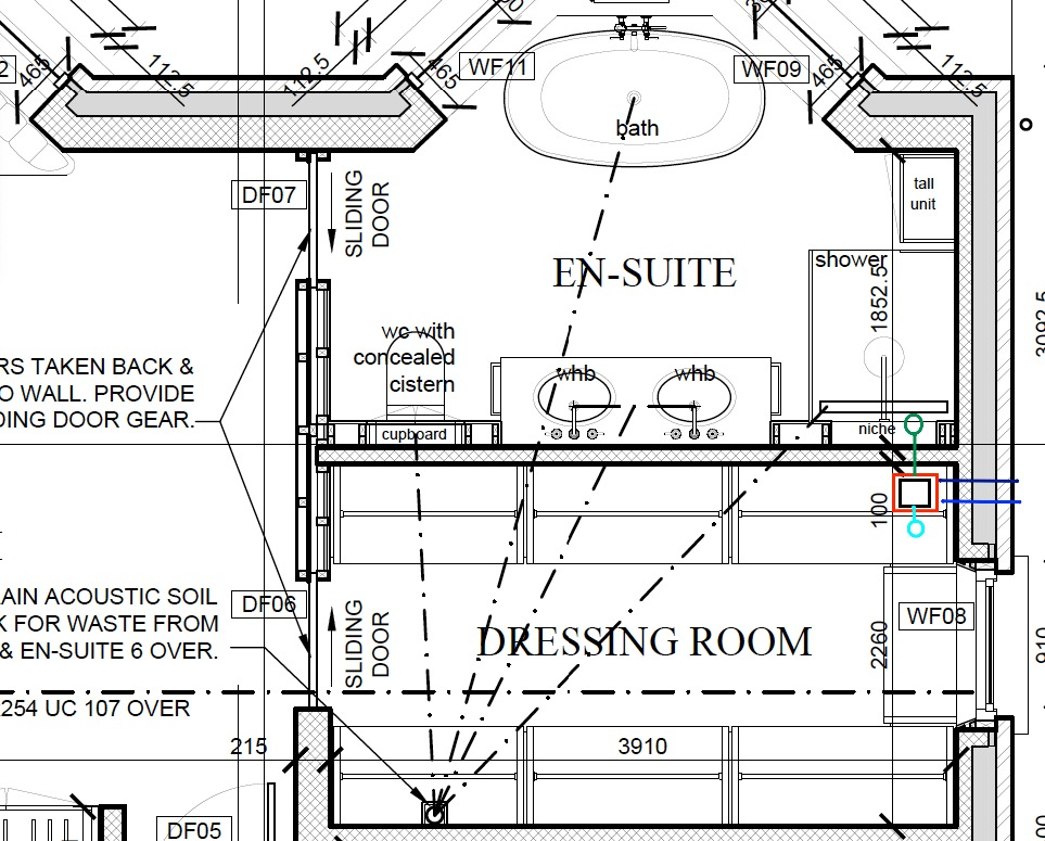

We're looking at adding some MVHR quite late in the day... (ceilings already up, plastered and painted, walls painted/tiled, we've already moved in and are finding the master bedroom quite stuffy). This minimises what we can do in terms of ducting runs (without damages and so costs being prohibitive). Floor plan showing master bedroom/dressing/ensuite here: I was thinking to do the below, i.e: - MVHR unit in the ceiling (above joinery) - duct straight outside for the in/out - extract out above the shower in the en-suite - fresh air into the master dressing room - drainage straight out into the guttering (outside) From those with experience, do we think this will be sufficient to create a flow of fresh air throughout the master bedroom ? Thank you in advance !
