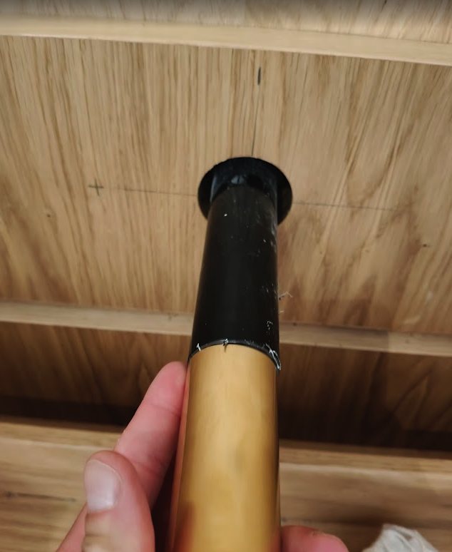

Hi all, I'm working on this fancy joinery piece, and have this nice looking waste pipe (it will be visible) for a basin waste. The plan would be to cut back the black solvent weld pipe, make the connection, and then hide the connect under the cover plate (provided by manufacturer of the gold coloured pipe). Any suggestions for how I should connect these two pipes ? (I'm not a plumber) Thank you in advance
