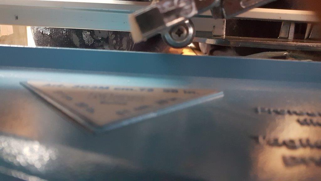

I tried really light pressure and it still did the same mate From what I can tell online, it's a 19mm wheel

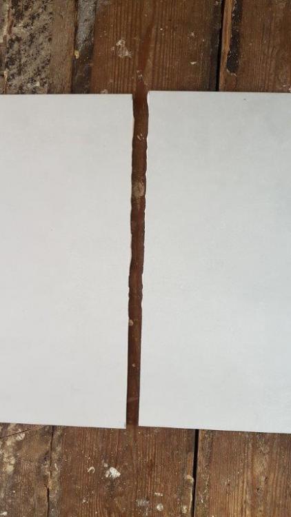

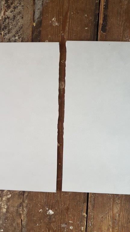

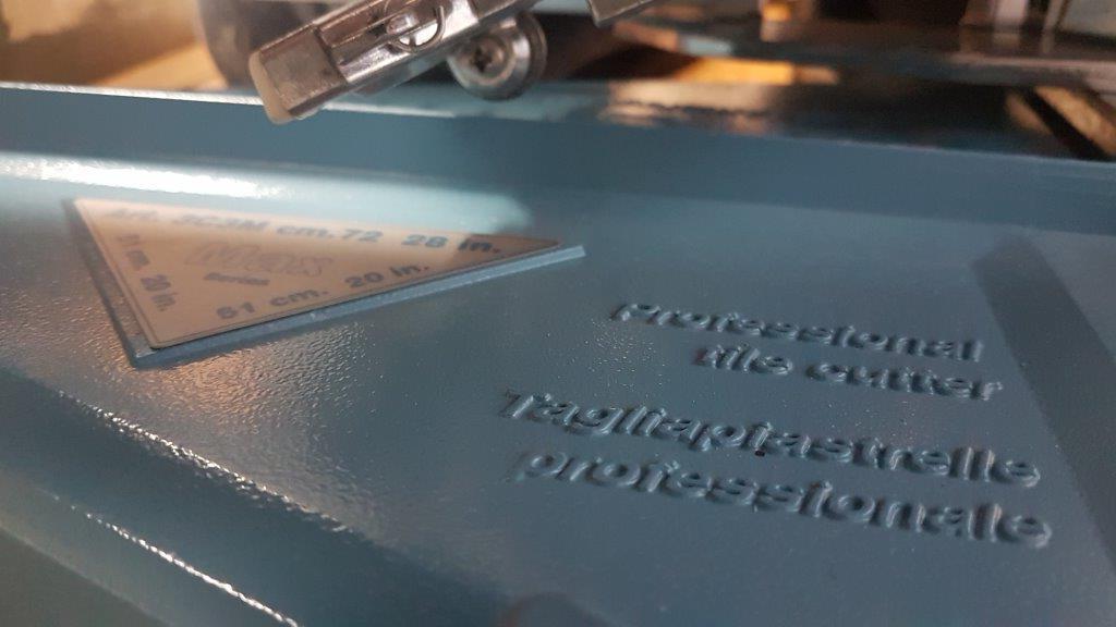

Guys, how clean of a cut should I be getting with this Sigma cutter? Cutting 8mm wall tiles, the tiles just aren't cutting cleanly, edges are raggedy and I'm ending up using a wetsaw to clean up the edges. Really not impressed with a £300 bit of kit

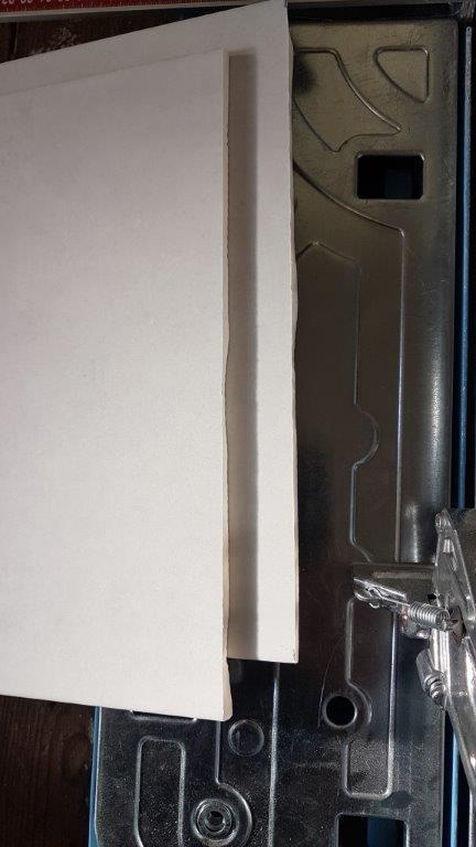

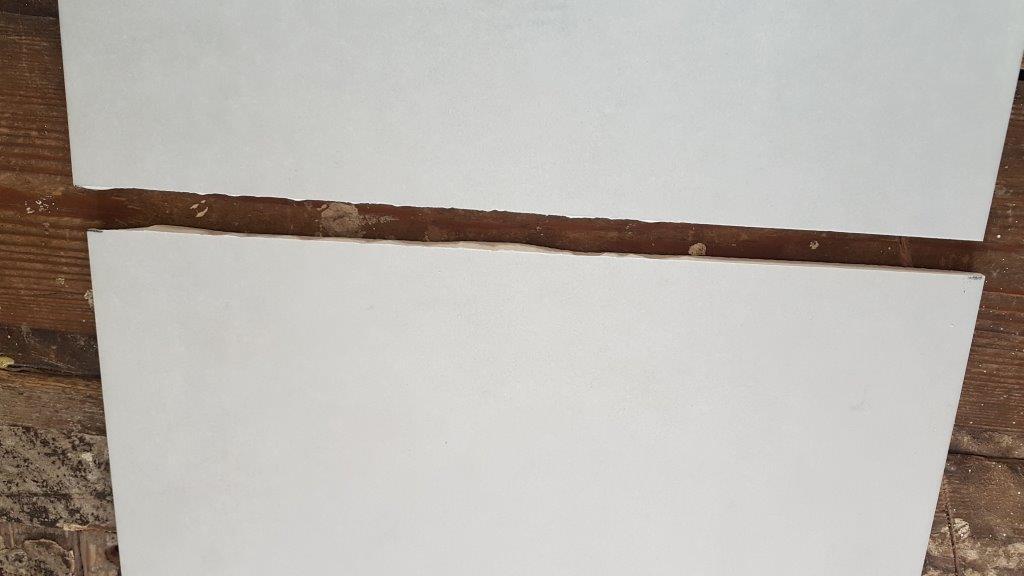

Starting using this cutter and having an issue. Scores fine but won't break evenly along the score line, the cut breaks off sideways. Spoke to the supplier which says it's down to the tiles, which are from Wickes https://www.wickes.co.uk/Wickes-Amaro-Linen-Porcelain-Wall+Floor-Tile---615-x-308mm/p/153690 they are slightly rippled which you can see in the pics. Anyone have any advice with this situation? I tried scoring a few times but still didn't break cleanly

Ended up ordering the slightly larger Sigma 3C3M model
Right, based on what you guys have said I'm looking at a Sigma. There is the 3B4 and 3B4M which I believe the 3B4 is a pull action and the M(max) is a push version (and slightly smaller cutting dimensions). From you experienced tilers, is a pull or push action better? The guy online said to go for a push action as it's what is used more and is more natural - but that could be cos he only had that one in stock lol
