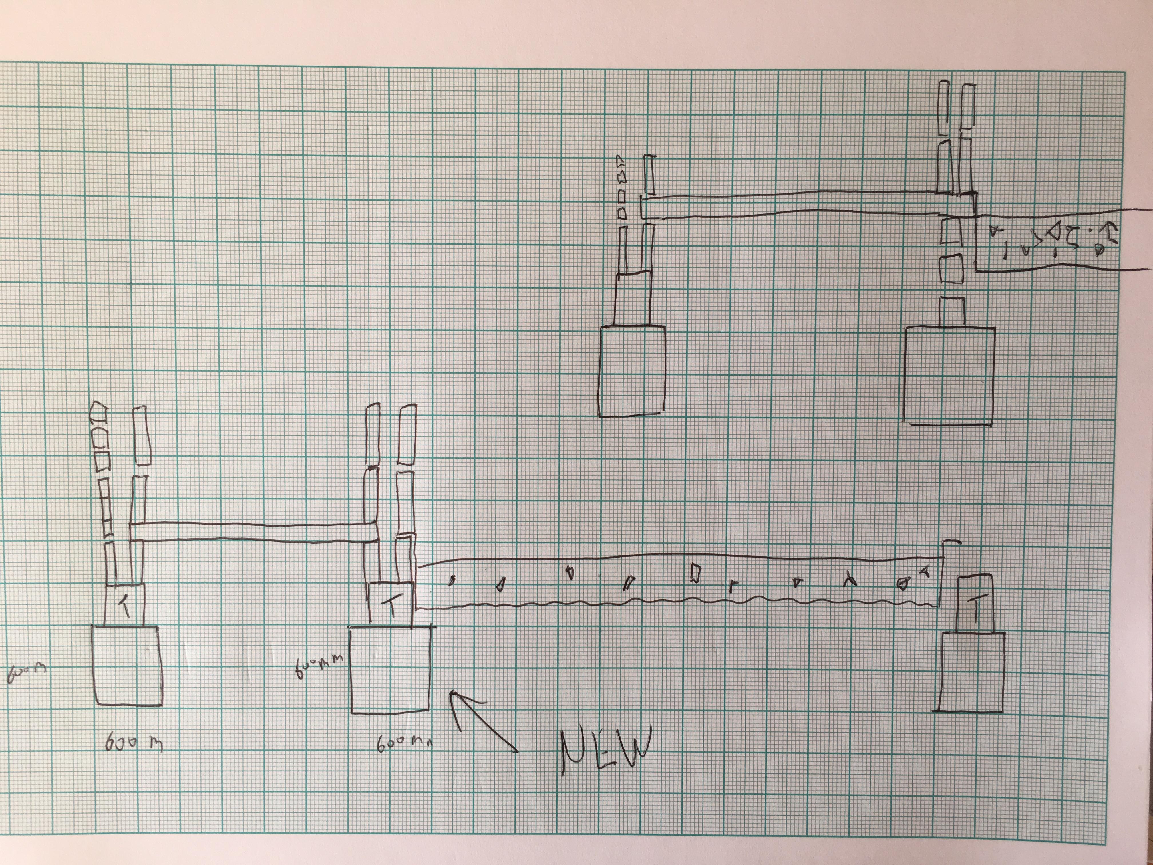

OK here is my read of this... Start the footing blockwork of the internal wall with basic standard concrete blocks on their side i.e. the footing wall will be 215mm wide. Then play with the block height maths to bring the footing height up to the right level to carry the beams on a final block laid the normal way up? This design removes the need for a cavity footing wall below the internal wall. If I sit the beams on a dpc and the adjacent solid garage floor slab is poured over a membrane bought up the side of this footing wall there will not be a path for rising damp. -

Although not central to my main question, are such "standard 300mm concrete blocks" different to trench blocks which I thought were always a lightweight construction? -

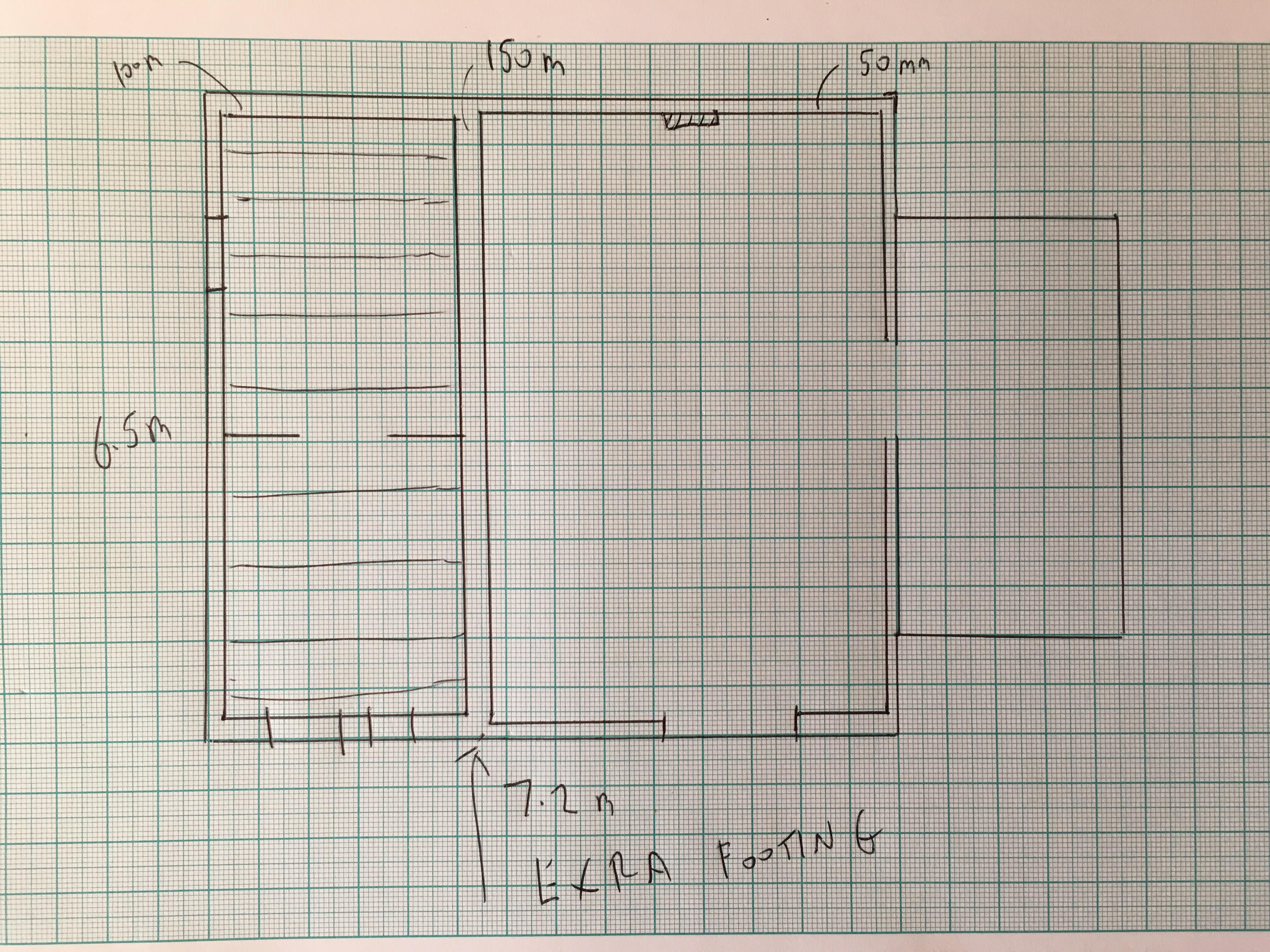

My foundation concrete was poured last Thursday & Friday and I now have a pair of brickies lined up to build my footings. They can start asap because another job is on hold for them. The problem is that I do not know what block types I should order for the garage footings where I have strayed away from my building control diagrams. I got my JCB man to dig an extra internal wall trench for my garage. What I have done here is jumped the gun and made a provision for a future planning amendment that would divide my double garage into a large single garage with a workshop and store to one side. My present building control diagram shows a solid 215 double skin brick/block wall all around. I plan to upgrade this to a basic default 50mm cavity wall and widen the cavity to 100 or 150 around the workshop. The floor of the workshop would be beam & block to the same standard as my main house. The remainder of the garage floor would be laid as a solid concrete slab. Should the footings of the internal wall be the same standard as a main house external wall or can I economize? As shown in my hand drawn diagram could I sit the beams on a single skin of 140mm footing blocks and then build both skins of the internal cavity wall direct off the beam & block floor? I am concerned about designing in a conduit for rising damp if I do this. The internal cavity wall would just be thermalites to 2.4m in height with no weight above. Diagram Notes: The first diagram is a plan view showing the position of the new foundation trench and a basic plan for the cavity walls. The "T" blocks in the second diagram are assumed trench blocks. All poured concrete is 600mm x 600mm and well in excess of the structural minimums for the ground conditions.
