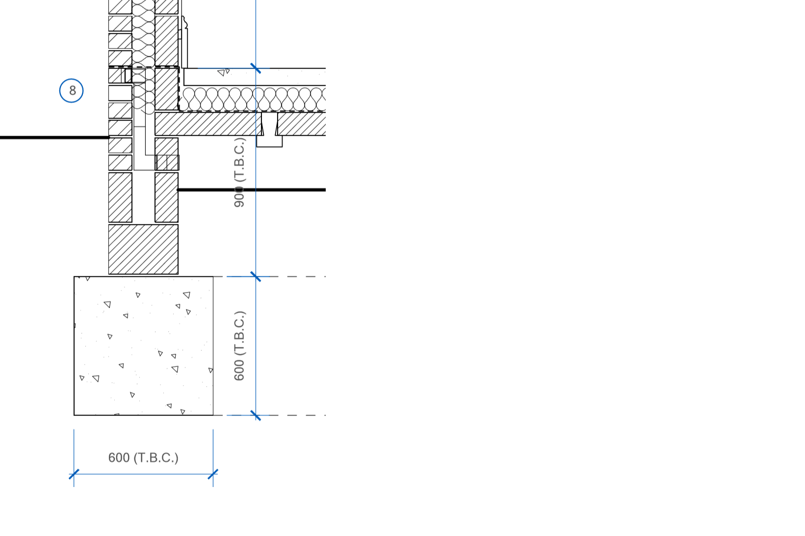

As a minimum I want to get a course of foundation blocks laid on my trenchfill just poured last Friday. If the heavens open and finish this summer drought, muddy water can then wash into the trenches without causing too much trouble because I expect the trenchfill blocks will keep their upper face above any puddling. The trouble is I am confused by all the block types on the market. Given the following diagram specific to my house what should I order to get up to the beam & block floor? My guess... 200 x Thermalite trenchfill blocks 440 x 215 x 300 (7N). A large delivery of regular 440 x 215 x 100 dense concrete blocks. Footing lintels for service entry points. Telescopic air vents for the inner wall (need some extra reach due to the elevated main dpc). 100mm DPC roll for the beams to sit on. Coursing blocks (65mm) for that awkward 150mm part of the inner block wall (to avoid block cutting). Should I amend this order to substitute in thermal blocks to reduce cold bridging near the beam floor?
I know some of you have taken a diy approach to creating diagrams for building control submission and others have splashed out many thousands for the same. I took a middling route which involved forwarding the outline architect's house design that had planning permission to an Architectural Technology (AT). The original architect was a quill & pen operator which meant my AT had to lift the design from paper into digital format. For £1200 I got 8 diagrams with impressive detail plus some lengthy building advice telephone calls thrown in. The AT also accommodated changes such as removing a supporting wall to create an open planing sitting room, reversing the stairs and incorporating a 90 degree twist. He gave me permission to post examples of his work, here are some snippets... Snip-2. Snip-3.
