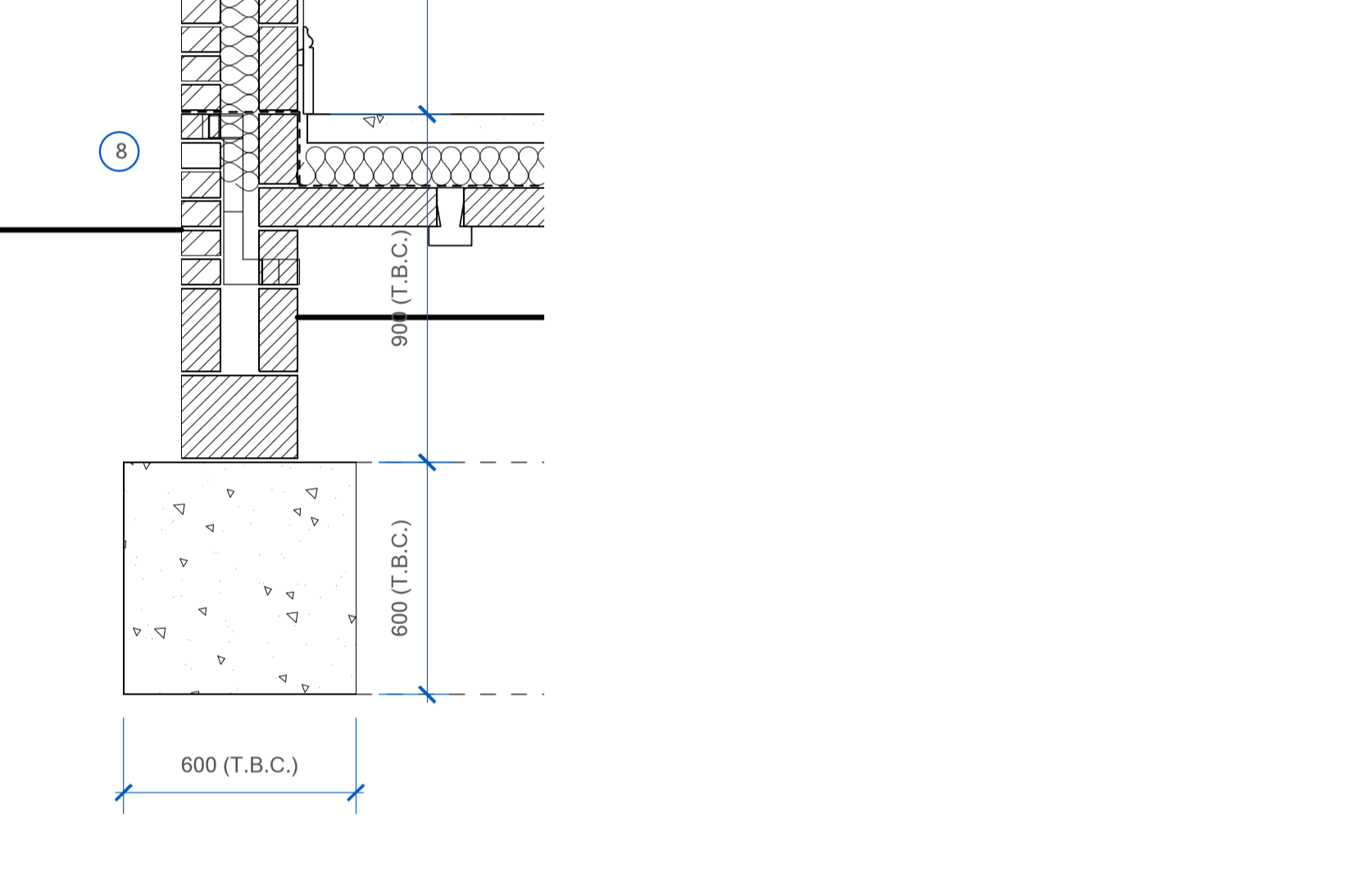

I need to order some footing blocks, what types?

Probably 120mm + 75mm with UFH pipes embedded. -

Soapbar blocks = a top tip. Thankyou. I think I will build up an extra wall section for the adjacent wall supporting the beams to save confusion. I could go all the way and include a demo beam offcut of say 500mm if I could pick up an offcut somewhere. I had been thinking that the dpc shown on my original BC diagram could not prevent damp raising into the floor infill blocks. -

I must be overlooking something here, would 120mm of insulation + 75mm of screed make the FFL up perfectly? -

In the photo the two courses of inner wall bricks are supporting the edge block of the horizontal floor. The beams would be running parallel with the portion of the footing wall shown, the diagram I posted with the opening thread post show the position and height of the first beam in from the wall. (Edit: My building advisor who is a trad solid floor man did wonder if beam/floor flex might move this first edge block and thus cause it to leverage the block wall above.). The block heights of the adjacent wall supporting the beam ends is more interesting. If a beam protrudes 55mm below into the void then instead of two regular 65mm coursing raising 150mm to the first horizontal floor block there is now a 95mm gap to the bottom of the beam, I guess this is where those 40mm coursing slips are used. -

And @dpmiller& @Declan52 I have dry assembled the following footing block build up that is the best equivalent of my building control diagram shown in the first post. Is my 3-block substitution for the trench block similar to what you are intending/have done? The buff/red brick boundary represents the average external ground level around the perimeter of the house. -
