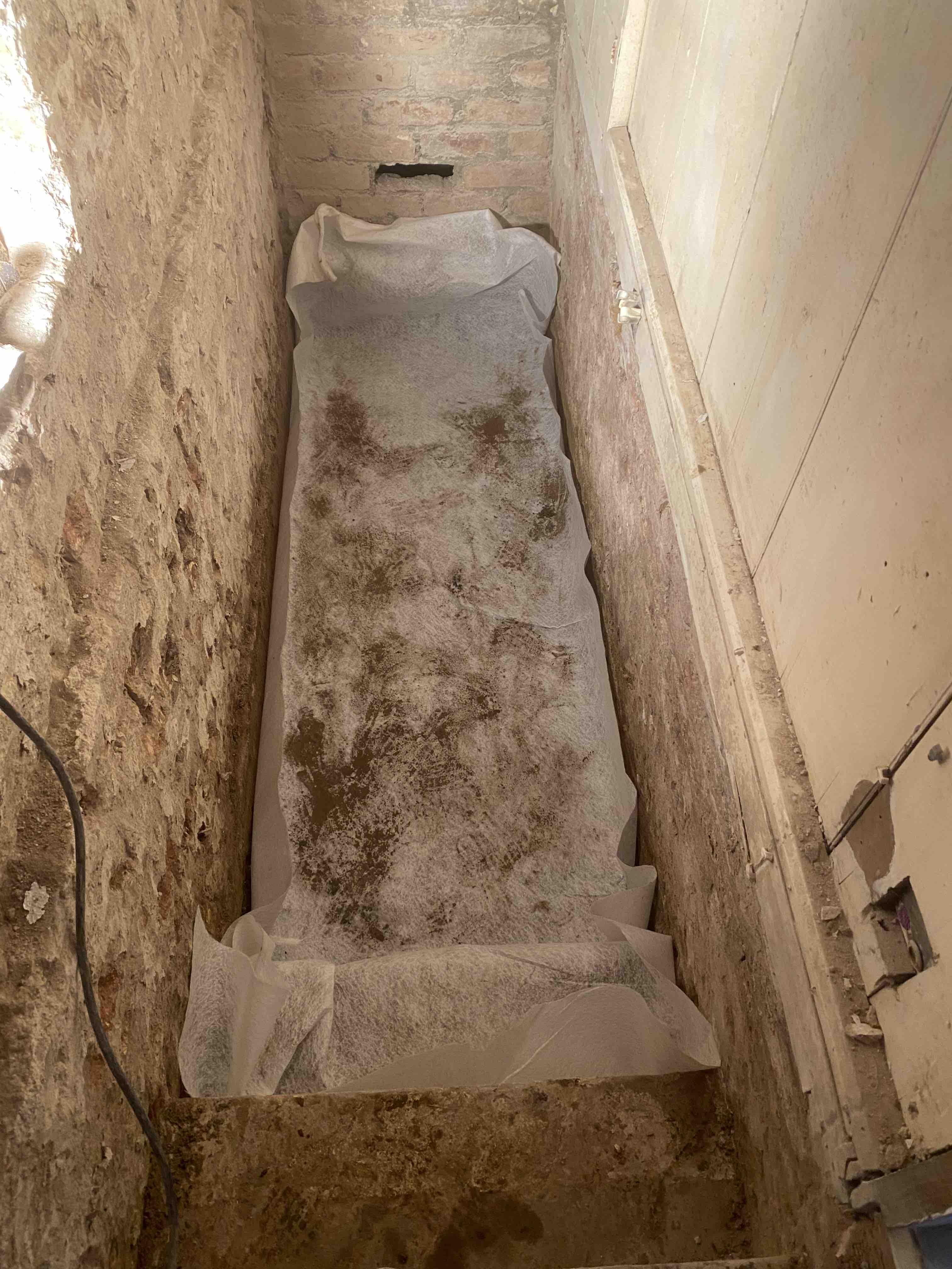

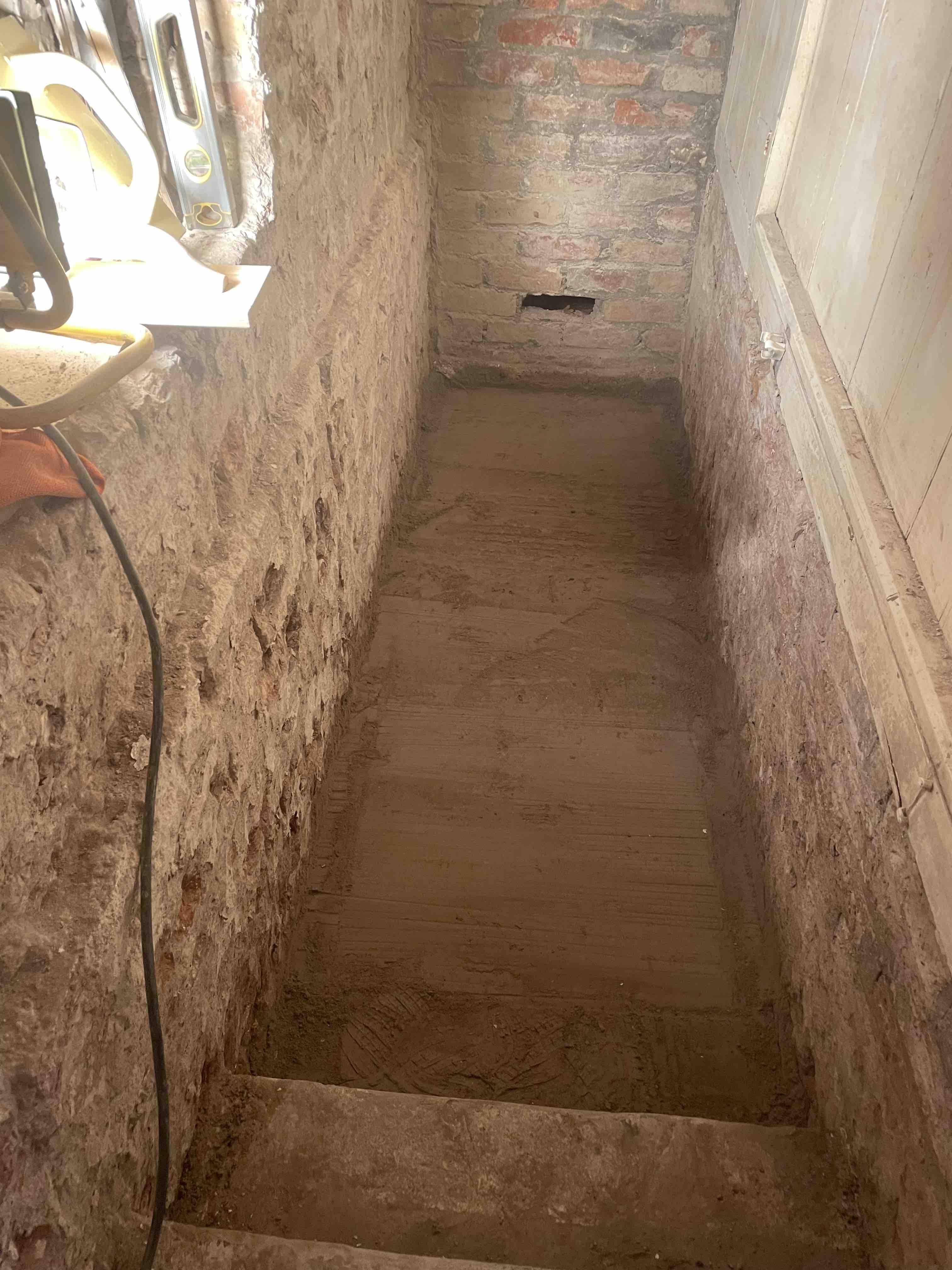

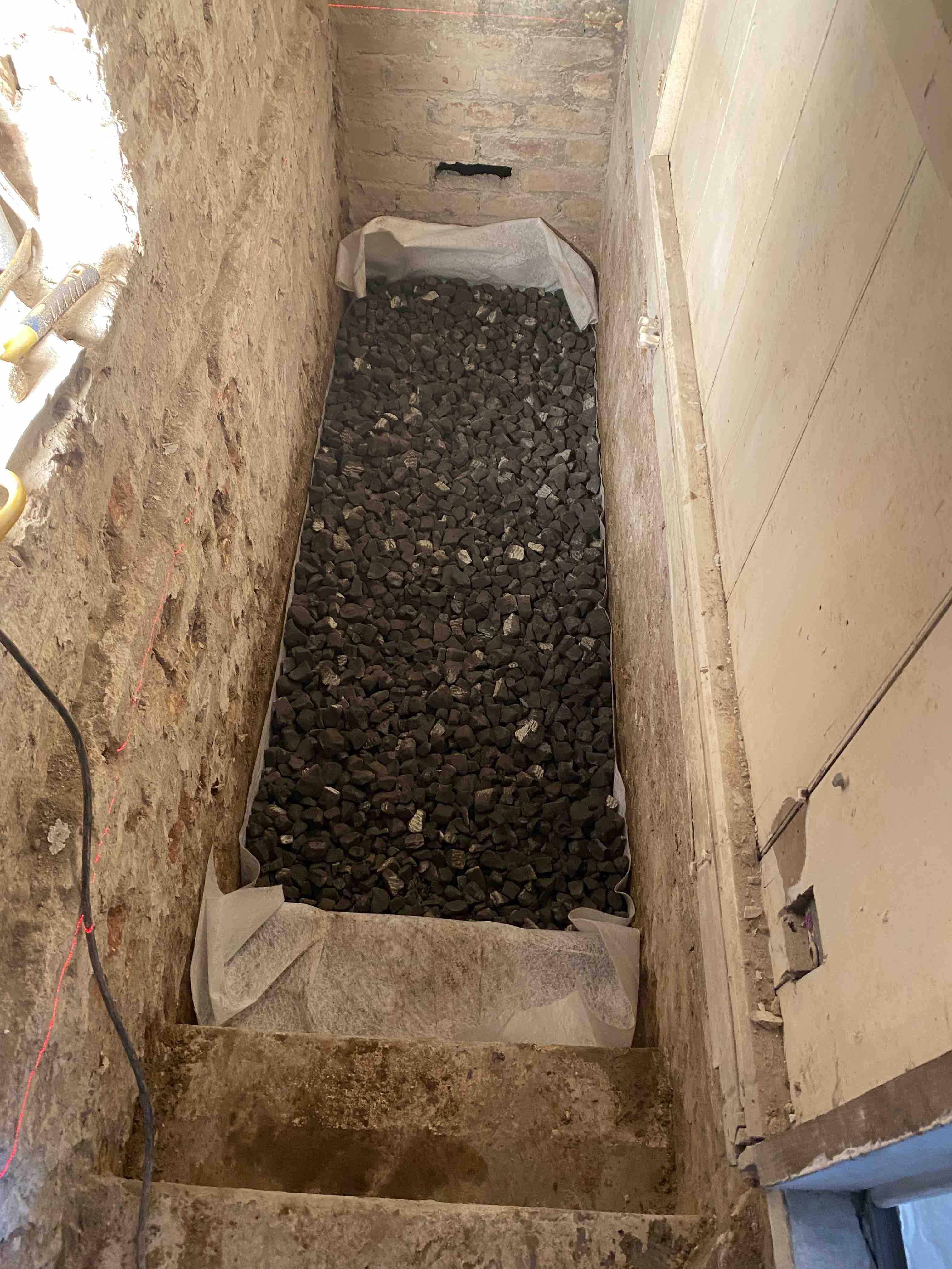

  5. Hardcore (foam glass) when in yesterday, wrapped in geotextile. The following morning the cupboard already felt less humid. A 2:1 Sand/NHL5 mix followed. It's looking much tidier now! It's my first time screeding using sand/lime (or cement) so it would good practice for when I need to tackle a larger room! Hoping to get to re-plastering the walls mid-August. First will be a harl coat of Reabilita Cal CS followed my a couple of coats of NHL 3.5.

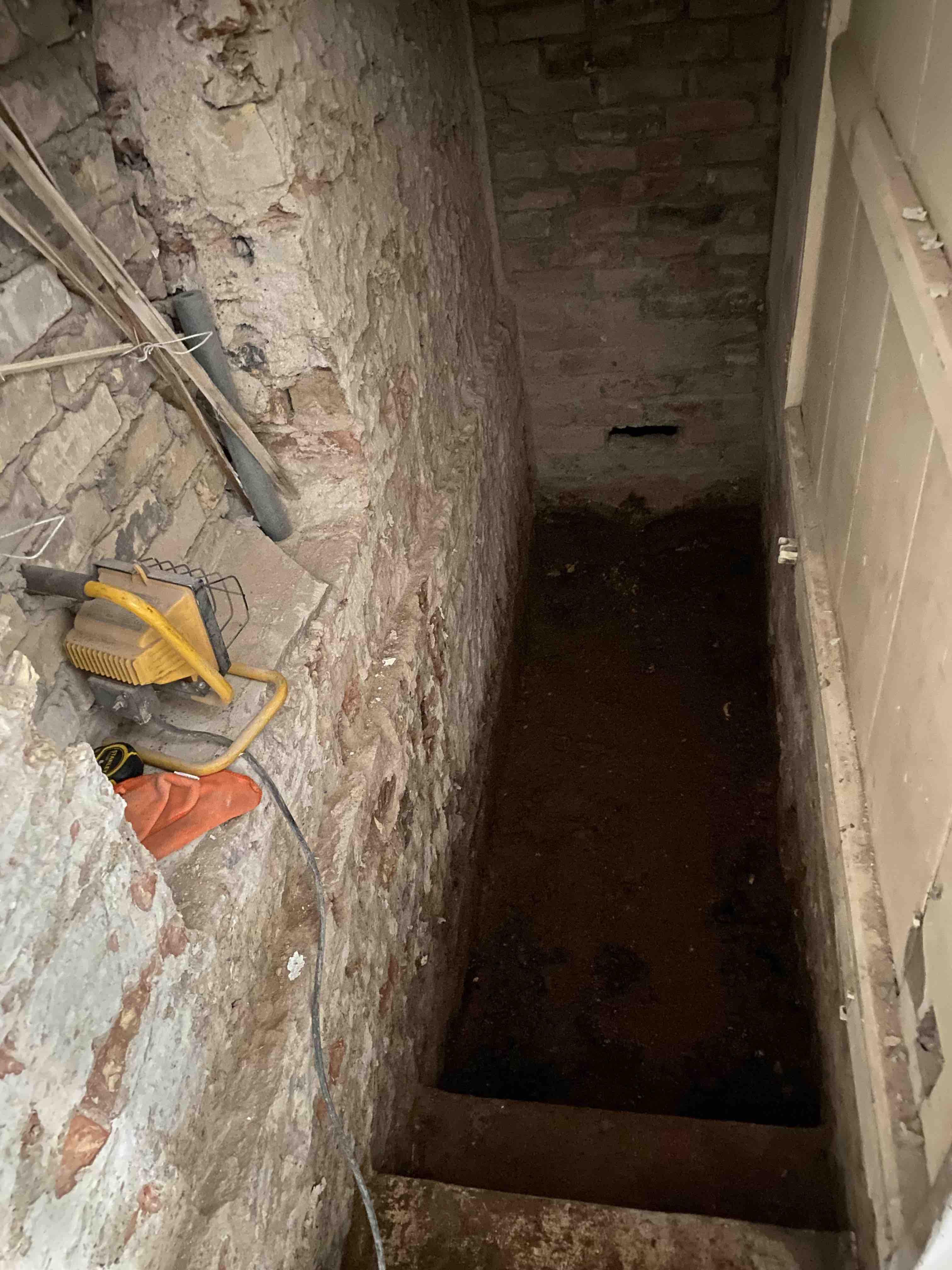

  16. Render's finally off. It looks like there was some additive to the stuff applied to the lower half as it was a pig to get off, whereas the top half came off in large chunks. I'd have preferred to get more off, but it was taking chunks of the brick off too. Short of sand blasting, I'm not sure what else I can do with it? The floor has also been dug up. Turns out it was clay slabs laid on about 300mm of sand and rubble. The sand was sopping wet so there's no wonder the slabs and bottom of the walls were damp. I presume this was all dumped under there when they finished building the house back in the day as we're actually in a clay area (which also explains why they sand has never dried out!) Materials for the new floor and to render the walls will be ordered tomorrow. I've decided on a glasscrete floor, apparently the foam glass is non capillary so should stop the "rising" damp, and lime on the walls - Harling coat, scratch coat and float coat all mixed with pozzolan. I probably won't apply a finish coat given it's only a cupboard plus I've never plastered before in my life so thought the cupboard was a good starting place, at least it's then hidden if it looks a dog's dinner.

  23. Hydraulic lime is what I've been recommended to use, this stuff - https://www.mikewye.co.uk/product/secil-reabilita-cal-cs/ - mixed with pozzolan though https://www.mikewye.co.uk/product/argical-pozzolan/ as the harling coat. Which is what confused me. My understanding is pozzolans reduce capillary action and vapour permeability, I'm not sure by how much, but if that's the case its seems as beneficial to use cement render, which in itself seems counter intuitive.

  25. I'm restoring our understair cupboard. It drops to approx 500mm below ground level, and the floor is slabs laid direct to soil so the floor and bottom of the walls are damp. I'm going to laid a limecrete floor to sort the floor out and it's been recommended to render the walls with a lime + pozzolan mix. Apparently the addition of pozzolan kicks off a chemical reaction that allows the lime to set in damper conditions. This all sounds great, but from reading up on pozzolan, my understanding is that it also reduces capillary and vapour permeability characteristics too. If that's the case, what's the difference between using lime + pozzolan and a cement render?
