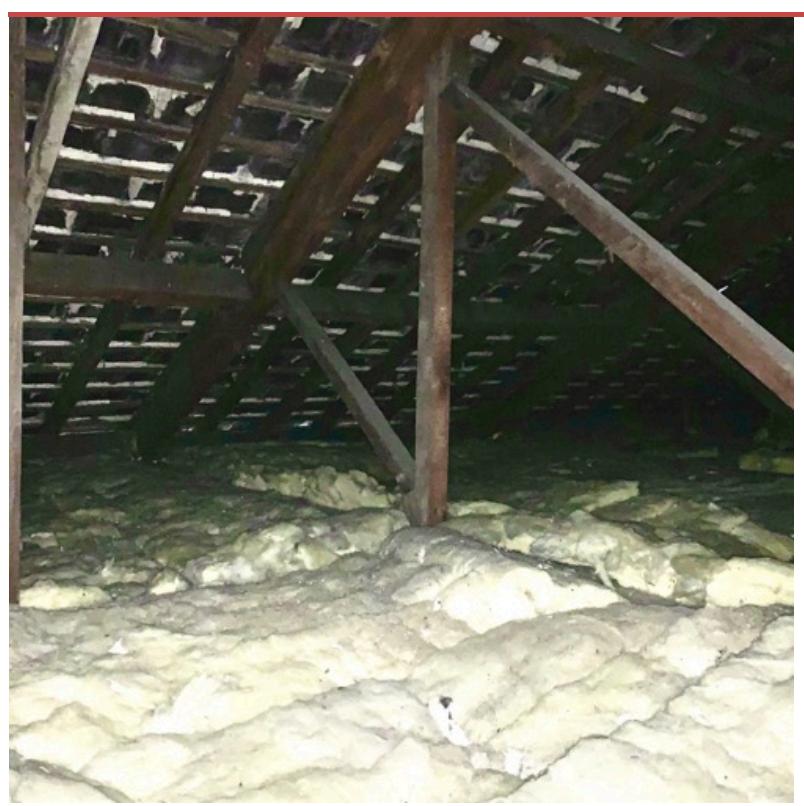

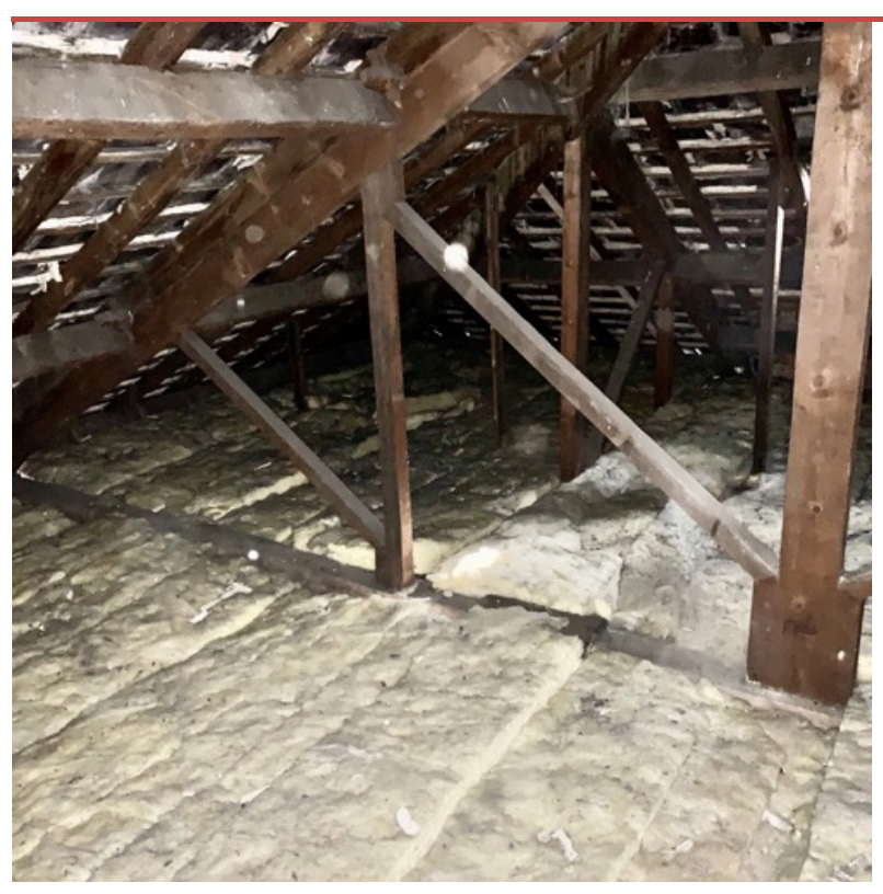

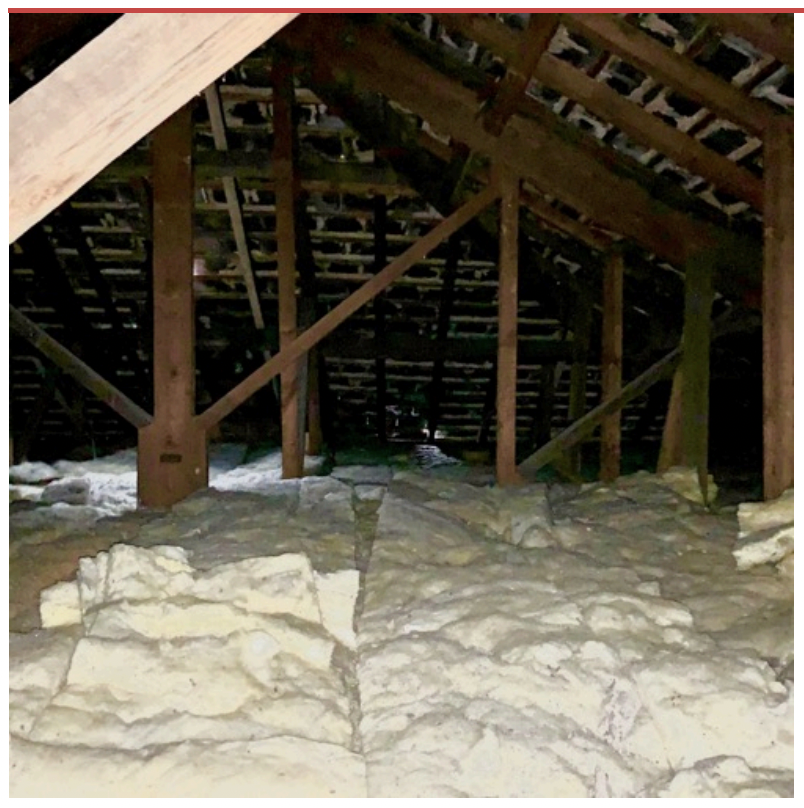

Our roof space is a web of timber. I want to make it airtight but can't decide whether I should do it across the rafters, or horizontally over the joists. It's double hipped and there's bugger-all space in the far corners, so they'll be fun to detail correctly.... Either way, the membrane will be lapped down the internal face of the external walls to be taped with the 1st floor wall membrane. What would you suggest?
