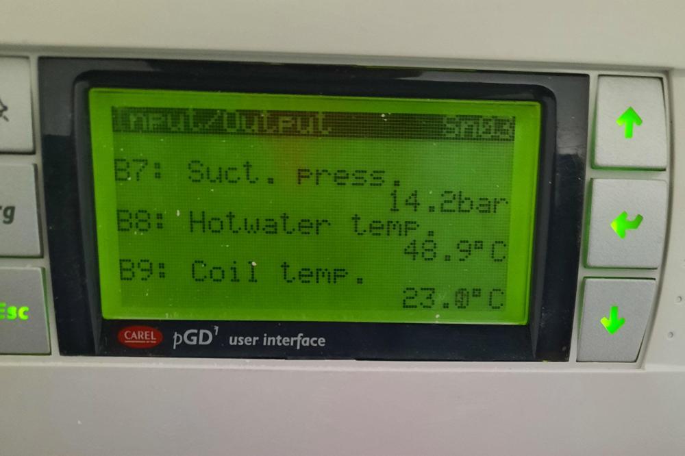

Results for us as they come forward...(and not what I expected)
Our Cool Energy inverTech Air Source Heat Pump CE-iVT9 4.3kW-9.5kW has been on standby only, for the last few weeks, and I have measured the power consumption. It appears to use about 0.1 kWh an hour. That's about 2.25kWh a day in 24 hours.
We use a Solic 200 to direct our excess electricity produced by the PV to the hot water immersion.
Whilst the Solic way of heat the hot water uses more energy, because it only runs using power we would otherwise give to the grid, its better for the bills to turn the ASHP off all together rather than use it to heat the hot water tank.
You would think that with a high COP it would be better to use the ASHP but with the other things on in the home and the car being charged, you can never be sure your not buying all the power.
Secondly I think the ASHP runs at  a minimum of about 1.5kW when heating the water. The Solic can use any spare power from the PV: 10 to 3000 Watts.
We could turn the ASHP off altogether and on only when we need hot water and I have decided this is a bit fiddly so won't do it.
Another benefit is the fact that the hot water tank is set to 70C ( the ASHP will only do up to 60 and that is at its least efficient) and this lasts us at least 2 or 3 days before needing to be heated up again! ( We do have a super insulated tank) Days when it could be cloudy and we would have to pay for the power. ( We will turn it up higher in the winter and use it as a thermal store for night time warmth...)
And finally I would rather wear out the £50 immersion than the £3180+VAT ASHP!

We do not heat the water above 45C when using the ASHP (However I would like to point out that the tank temperature is very different depending where the probe is. At the moment the high probe says 71C and the ASHP probe says 48.9C
Perhaps I written it wrong... let's try 4 scenarios:
Use ASHP on all sunny days
ASHP heats hot water to 48C for 3 days: Lets say 6kWh.
ASHP on standby for 3 days: about 6.75kWh
Total power about 12.75kWh but at least 2.75kWh purchased for the hours from 9pm until 7am
Immersion heating system on all sunny days:
Set to heat to 70C: Uses about 9kWh of FREE power (well 10 pence per kWh from the PV)
Use ASHP on one sunny day and 2 cloudy days:
Total power about 12.75kWh but at least 2.75kWh purchased for the hours from 9pm until 7am and 3kWh for the  cloudy 2 days when not enough PV.
Immersion heating system on one sunny day and two cloudy days:
Set to heat to 70C:  Fills up on sunny day and trickles bits in on 2 cloudy days. Uses about 9kWh of FREE power (well 10 pence per kWh from the PV)
One way we buy electricity, the other we don't, or at the very most it cost us about 10p per kWh for the system.
On cloudy days if we only have 0.5kWh spare being generated when the ASHP comes on it will grab 1kWh from the mains. Secondly the PV power not being used varies from moment to moment but the ASHP cannot currently accommodate this change but something like the Solic 200 can. Low and slow is the immersion way or high and fast, but either way only with excess energy.
( Goodness I am having to proof read all of this to try and avoid Steamytea's interventions)😂
Hope this helps to explain
