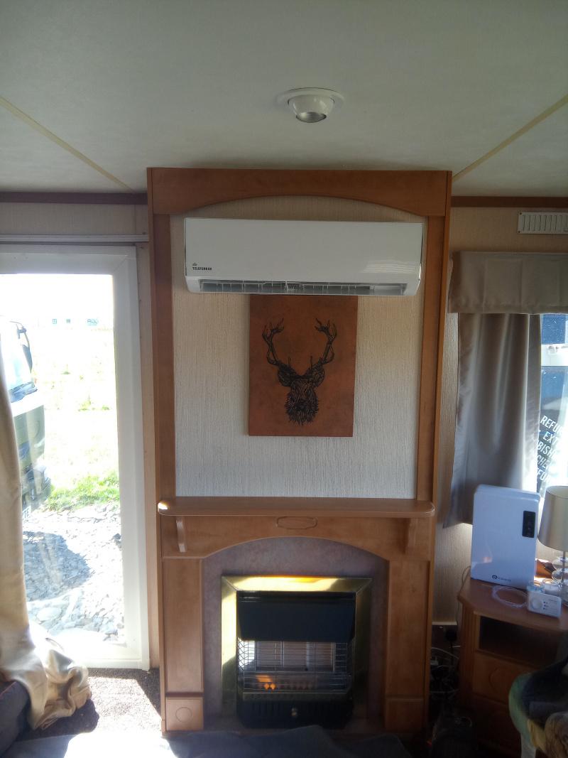

A short blog to show my Mini spilt Air2Air install, in the Windy Roost Static.
I looked at installing a wood burning stove, but we have zero trees on site, so when I looked at the costs of twin wall flue, terminals, flashing, creating a heat shield and making the caravan tidy plus the hassle of getting wood / coal, the costs were adding up.
A quick question on here - Build hub, some options were suggested and I decided to go with the a cheap Air 2 Air heat pump from Appliances direct.
The unit is a Telefunken 12K BTU split unit. cost around £375 but did not included the pipe to connect from indoor to outdoor unit.
I got 5M twin insulated copper pipe with the flair nuts from ebay for £56.

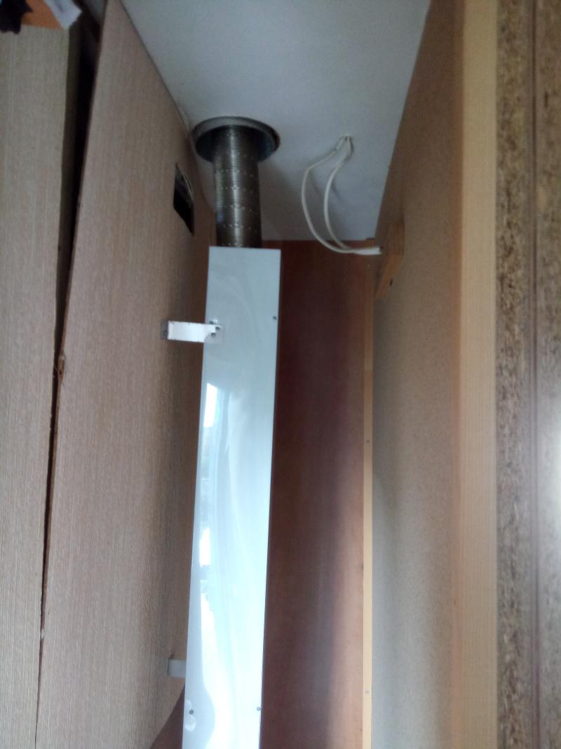

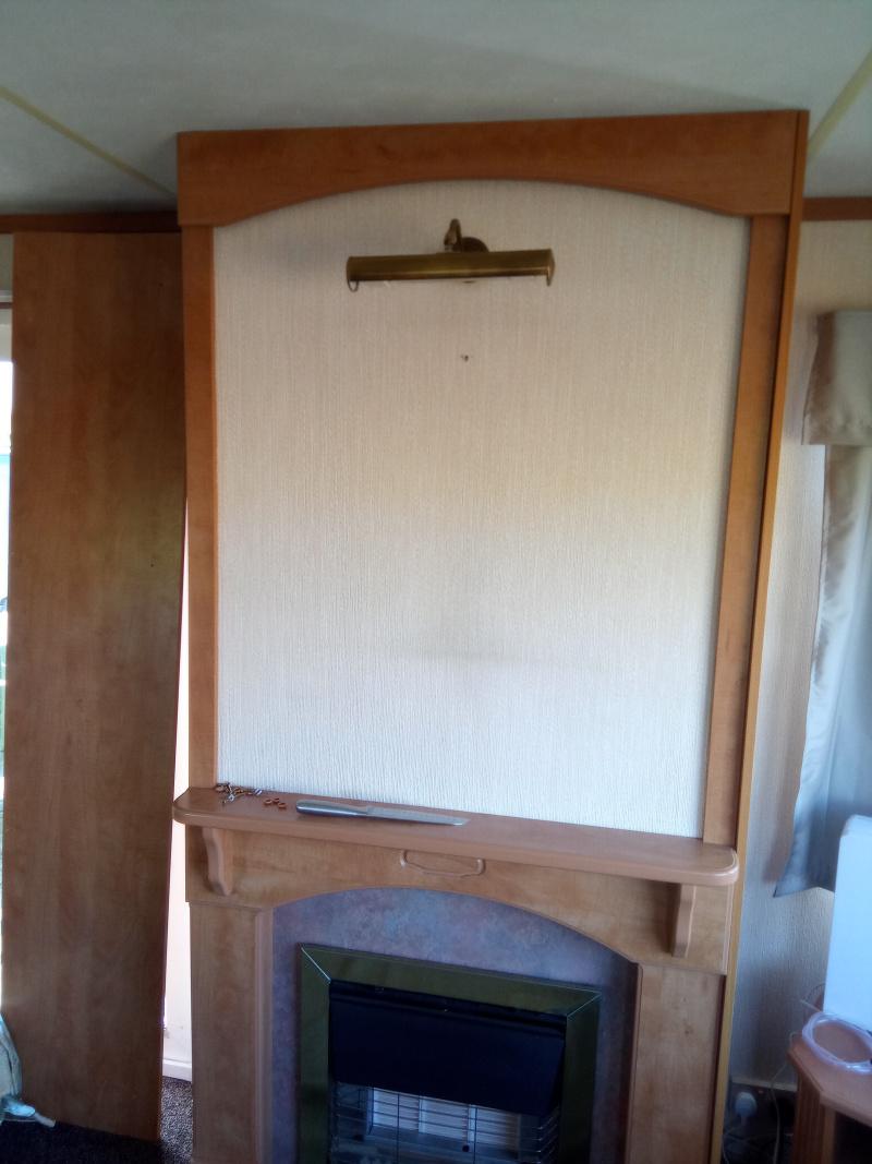

Our Static has a gas fire - useless, and a chimney breast made from chipboard, the side panel just screws off to access the flue. This was the perfect place for the indoor unit, as it would be a neat install and the rear will allow for the pipes to be hidden, also I could use the hole in the floor to route the pipes/ drain and power for the remote unit.
minisplit4.thumb.jpg.beaad08bd7167675ae75f18c58133052.jpg minisplit5.thumb.jpg.dd7ed60ff41f88720e6469ada00d3575.jpg

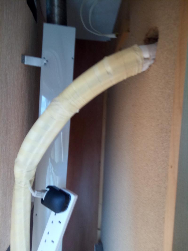

I removed the light fitting, screwed the bracket on the timber, and drilled a 80mm hole, for the pipes / drain and power.  Then its a case of posting all the pipes/ drain and power cables through the hole, really straight forward, the indoor unit then just clips into place.
The indoor unit comes pre wired with a 13A plug top, and you need to run a 3core and earth cable from the indoor unit to the outdoor unit. this is Live, Neutral and a control / switch cable.
Next to the chimney is a double plug socket, so I wasn't messing around running new cables, I just drilled an 8mm hole in the side of the chimney breast and used 2M extension lead to plug the unit in. I used some zip ties to secure the extension lead and plug to the pipes (these were put on after the photo below). and that was the internal work complete. zero mess, and no rework / decoration required.

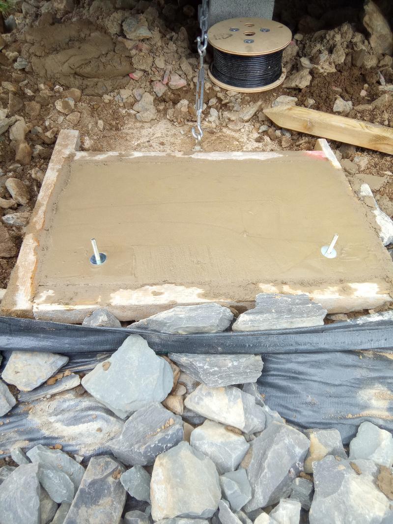

The outdoor unit was going to sit directly outside, behind the chimney breast, the ground outside was not level but it is bedrock, so a made a simple frame and made level concrete pad, and cast some hook bolts into the concrete.

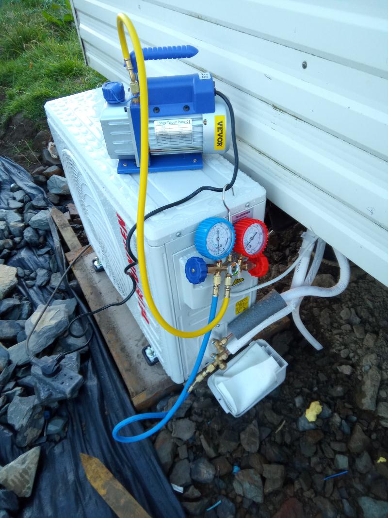

I found an American You tube guide which was helpful on the pipework side.  (linked below)  Basically, the unit comes pre charged with gas, so you are not filling  with gas etc. the main issue is removing the air from the two pipes you install. This is done with a vacuum pump. (some more expensive units come with pipes and they are pre-vacuumed with quick connectors)

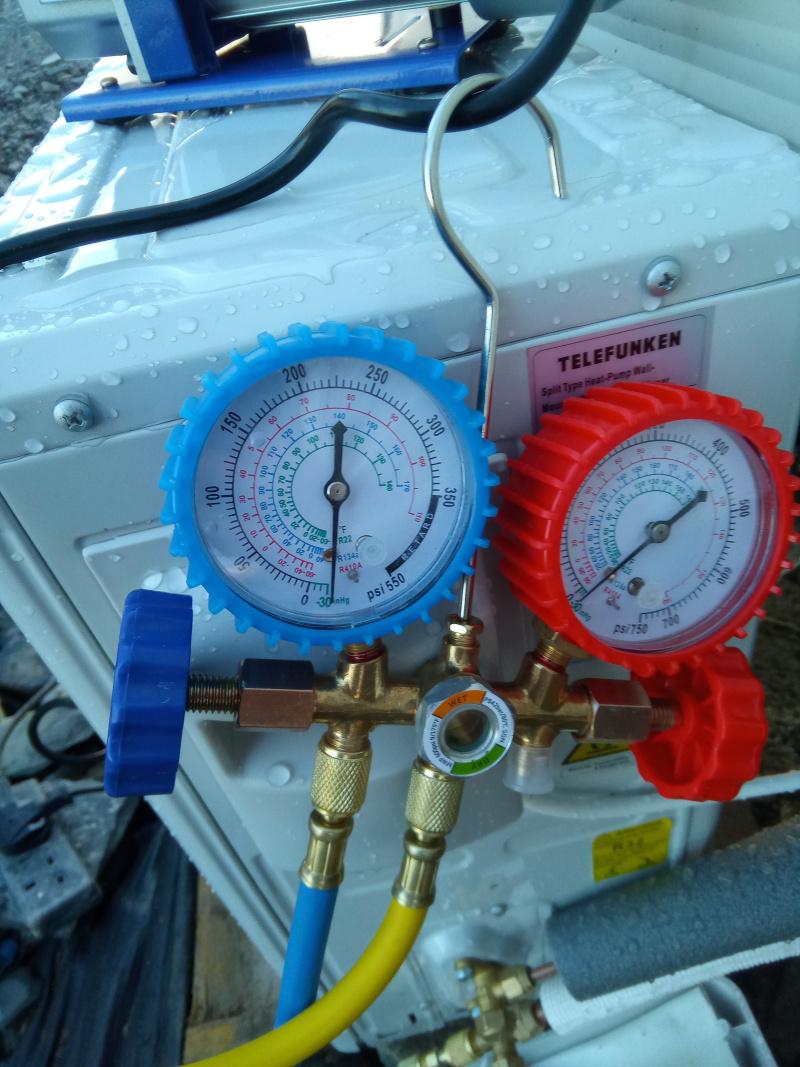

I found a vacuum pump and gauge set for sale on Vevor for £79 so £41 cheaper than the refrigeration engineer.  I bought one, and an adaptor. I'm not suggesting anyone does this without an F - Gas Engineer, but the main issues are leaks, if when you connect the pipes up and they leak you are going to loose the gas, and the unit wont work.
To Purge the pipes
Step 1 connect your pump to the centre of the two gauges with a hose
Step 2 connect  a second hose to one of the gauges and the other end to the one way valve on the outdoor unit
Step 3 Open the valve on the corresponding gauge from step 2.
Step 4 Run the vacuum pump for 15mins  to remove the air, and you check the gauge is reading negative. (-30 blue gauge in pic below)
Step 5 turn off the pump and wait 15mins, and check the gauge is still negative. (-30) - this proves there is no leaks
Step 6 close the valve you opened in step 3.
Step 7 Open the 5mm Allen screws on both valves to the gas fill the internal unit.
That is disconnect the pump plug the indoor unit in and you ready to go.

Notes: I used expanding foam in the hole at the rear of the fire. We have no intentions of using the fire as it is /was rubbish.  Also the indoor unit should not be near a source of heat.
The total install time was around 4 hours. and total cost £530
More importantly my caravan has warm air.   lets see what its like in winter.🤞

Not overly sure about the extension lead and the very nasty plug top converter running something that is a heating appliance !! Can you access that easily to at least remove the euro plug and hard wire an extension to it ..? Would be much better and safer than a euro into a converter into an extension into a socket … @ProDave you agree ..?
Link to comment
Yes you definitely want to improve the power connections.  I would have fitted a Switched Fused Connection Unit to power that.  Static caravans are notorious for tiny cheap and nasty consumer units so unlikely you would be able to add a new dedicated circuit so the best would probably be a spur from the ring final to the FCU.  Does the outdoor unit also have a similar power feed? If so that wants improving as well.
Link to comment
Agree with the crap plug, but its part of the warranty. The other end is hard wired to the control board. - else I would have removed.
The outdoor unit is connected via 4 core (well actually 5 core as I had some external 5 core), cable from the indoor unit control panel to the outside unit.
I've checked that the socket I have used is part of the ring and not a spur- IMHO a FCU is not required. Its accepted practice to install ovens and hobs / tumble dryers etc all heating appliances up to 3KW on plug tops, so don't see the issue using the socket.
The socket is rated at 13A, and as long as I don't plug anything into the spare socket no problems.  the fuse in the plug top protects the cable to the appliance and the breaker in CU protects the ring cables.  So all is acceptable and conforms to BS7671.

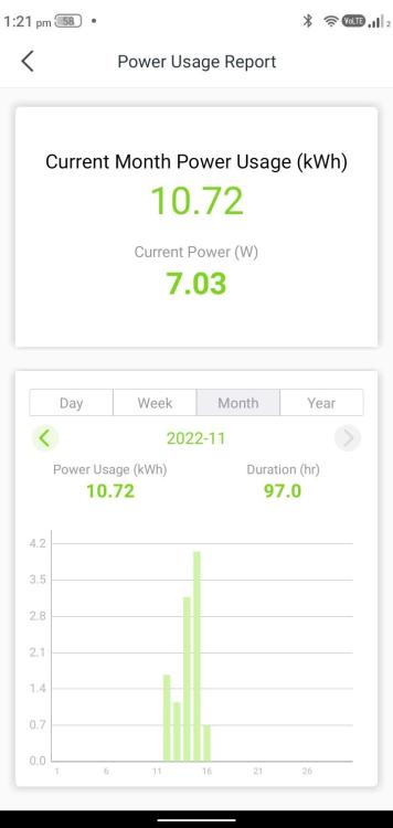

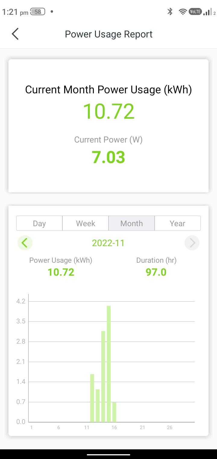

Thought I'd round this off with a bit of info on running costs.
The last few days have been fairly Windy in the static, and the heating has been used a lot. I bought a plug in WiFi energy meter to have a look at the power usage.  Below is the screen shot.
It seems to use between 5 and 45 watts in standby. The unit was in standby when this screenshot was taken. And using 7.03W. I'm quite happy.
We run the unit to set temp of 20 Deg and leave the internal doors open In the static to try to get the rest of the van warm.
Appreciate anyone's thoughts on this.

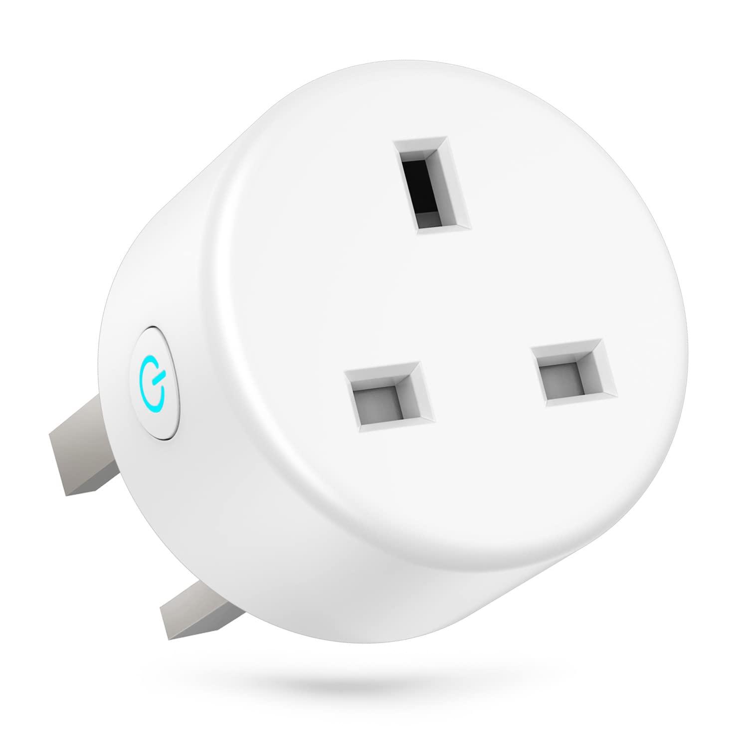

Who makes that and can you grab live data in it into a file.
If it averages out at around the 7W you were metering, then that's nearly 25% of the total energy use this month. Seems a little high.
But then again if it does the magic work of keeping everything up at 20oC for les than 25p a day then it's very hard to complain. I'm seeing consumption of around 2.5kWh per day for keeping around 60m2 cosy but I leave it on 24/7 so similar to yours at around 0.1kW/h
Your system seems to be in what my Daikin units call "auto" mode. This switches between heating and cooling to achieve the desired set-point. Mine additionally has discrete cooling and heating modes which means the units turn off once the set-point is reached. This allows a little bit of under/overshoot but saves a small amount of energy. It also widens the available range for the set-point.
I'm going to have to talk you through how to set up Tuya convert, MQTT and Node-Red on your Rpi.
Grab one of these
And we'll get started.

I bought 2 more units(slightly different model from appliances direct) for my cabin builds I'll be installing next week.
This is the plug I bought.
https://amzn.eu/d/8EGmaj2
