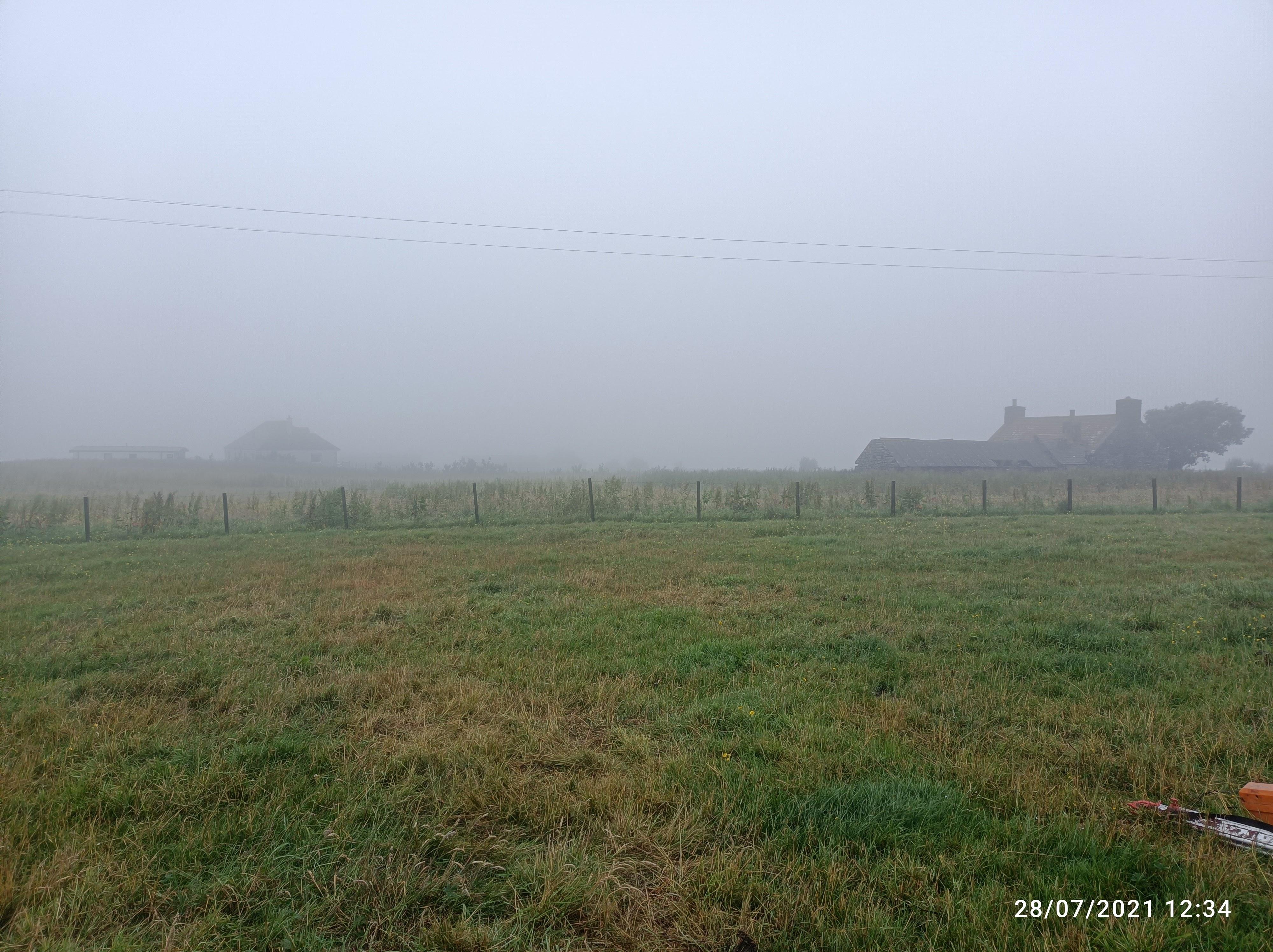

We now needed a land survey. The plot is 8hr 30mins approx. from our house so we put some feelers out for getting a land mapping done.  £1500-£3000 to produce detailed digital levels and dimensions....
We set off around 2pm on a windy day in July, with my trusty dumpy level, 100m tape and sighting staff, also some red flag metal spikes.  We arrived in Inverness around 9pm and stayed in a lovely B&B in Inverness for a mere £130 had breakfast at 7.30 we were on the croft for 10.30.
The plan was simple, walk around the area the house was going to be, look out to sea and make sure we position it for the best views (there are 2 houses and a stone barn between us and the sea).  Then from here get the levels to make sure the drainage works. And start measuring.
The sea harr didn’t help, I couldn’t see Mandy more than 35M away never mind read the staff.
We set our datum on the corner of the field on the road, we measured in 10M increments to the position of the house plot around 80M in then created a grid of 10M sq 40M x 50M, using our little metal red flagged sticks to mark the way.
I had to reposition the dumpy level a few times due to visibility and used previously measured markers to re-define the datum.  An hour or two later cold and wet we had the measurements we needed. After a brew in a café, we set off home getting in around 10.30pm just shy of 1000miles.
