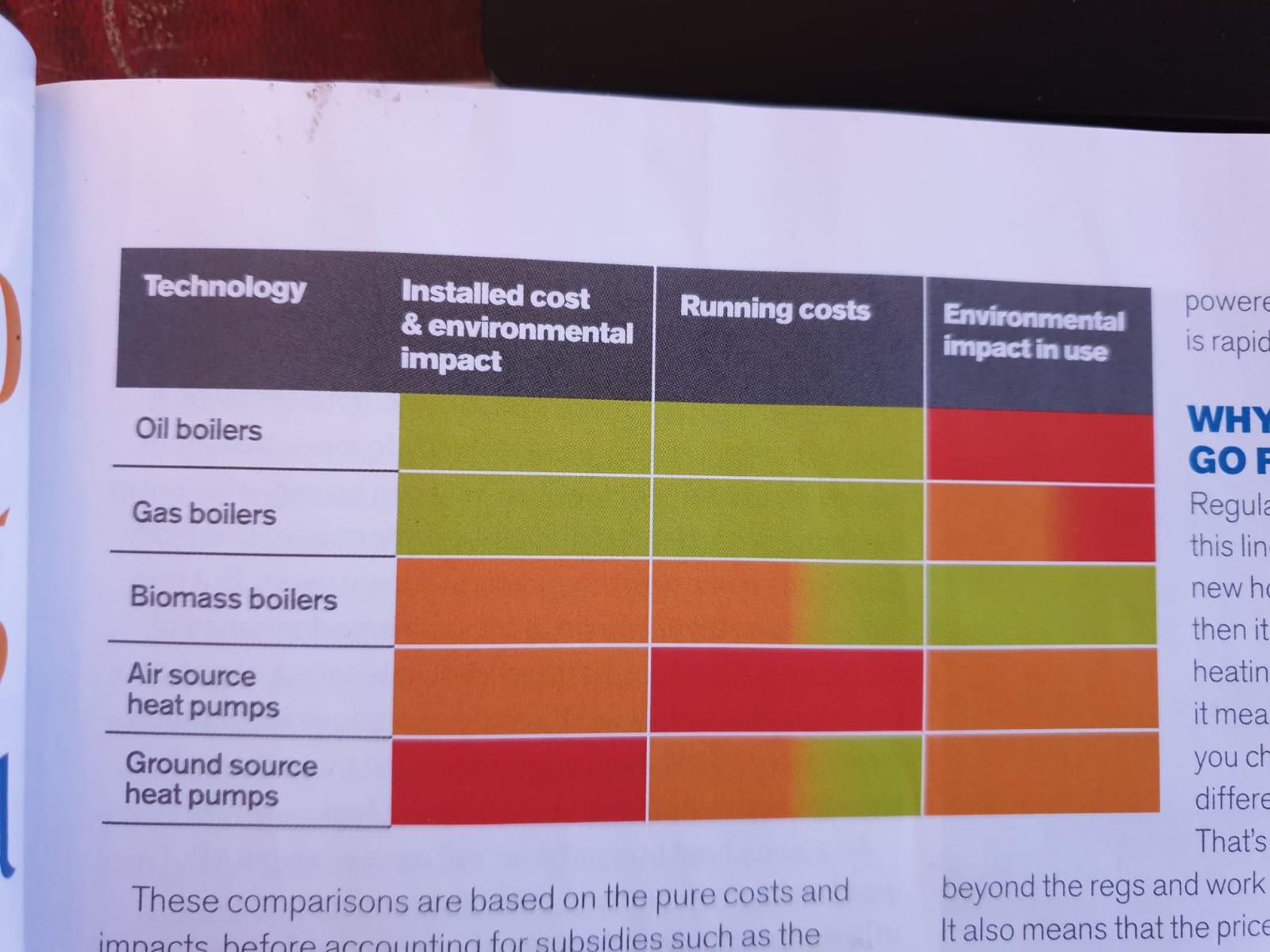

2nd Dec ASHP - or not
LSB
3728 views
As part of my barn conversion I was planning to use an ASHP, that was until I read an article in Build It magazine.
This considered the cost of installing and running heating and the eco credentials.
It included gas (mains), oil, ASHP, GSHP and biomas.
Well, somewhat surprisingly ASHP came out at high for cost, very high to run and not very eco friendly.
This has put me in a total quandary about what to do.
My planning says ASHP with a backup boiler.
The best method overall is mains gas, but we don't have that so the best for us would be oil.

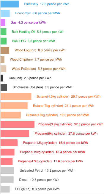

Can someone with an ASHP here tell us how much they pay per kWH for electricity?
Last I looked electricity was 3 or 4 times the cost of mains gas per kWH so the COP of the ASHP was needed just to equalise the running cost.
Link to comment
Yes, 16.09 from octopus energy but we have no mains gas available, I keep saying I may change to economy7, just need to work out consumption/times.

6 minutes ago, Temp said:
So ASHP needs a COP of 3 to make the running costs the same.
correct, but only if it’s available!!!!
Link to comment
Also factor in if you have an ASHP you just pay the unit cost as you have electricity anyway.
If you have gas, you have to pay to have it installed (in a new build) and pay a standing charge.  If you have a well insulated new build that standing charge may be a significant proportion of a low usage gas bill.
But for many gas is not available so a heat pump makes more sense than the only real viable alternative, oil.

this is the table that started me on this question.
The full article is in the January edition of Build It.
What worries me is making the wrong decision.
I don't have gas so that's out of the question, but that leaves oil, which we use now or Biomass, but getting the pellets is something to consider.
Link to comment
To choose Biomass means you have swallowed the greenwash and been led to believe burning something that shoves CO2 up your flue is going to reduce your CO2 emissions.
At least with electricity, it is getting greener all the time as more real renewables come on stream.
Would love to see the criteria for those scores ..!!! How do you score environmental impact of installation ..?!
Link to comment
To right, the basis of the policy was wrong from the start and should only be compared to coal burning, not gas or oil.
Link to comment
So would I.
BSI has all the standards and criteria, they are not cheap to buy.
