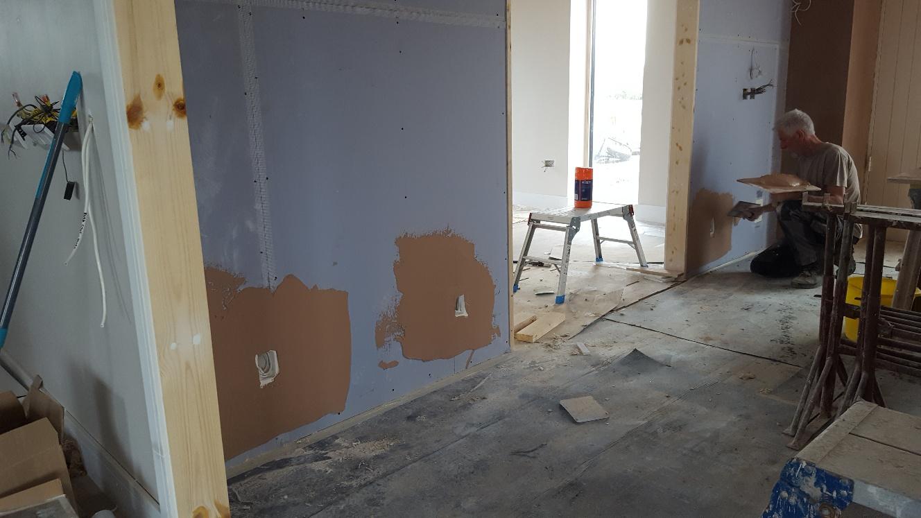

If plasterers were musicians, mine would be Elvis (except my plasterer is still alive, obvs!) or some arena-filling brain-melting rock god, because that's how good his plastering is.  Others have been trying to coax Ian to work away for the last 3 weeks and they've had to accept failure as he doesn't travel (far).  Anyhow, Ian the Plasterer has now left the building apart from a teensy last bit in the hallway that can't be done until the new stairs arrive, so 99% there.

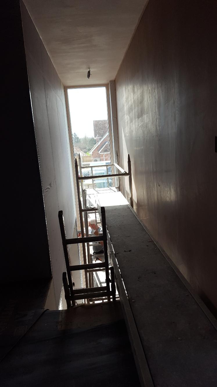

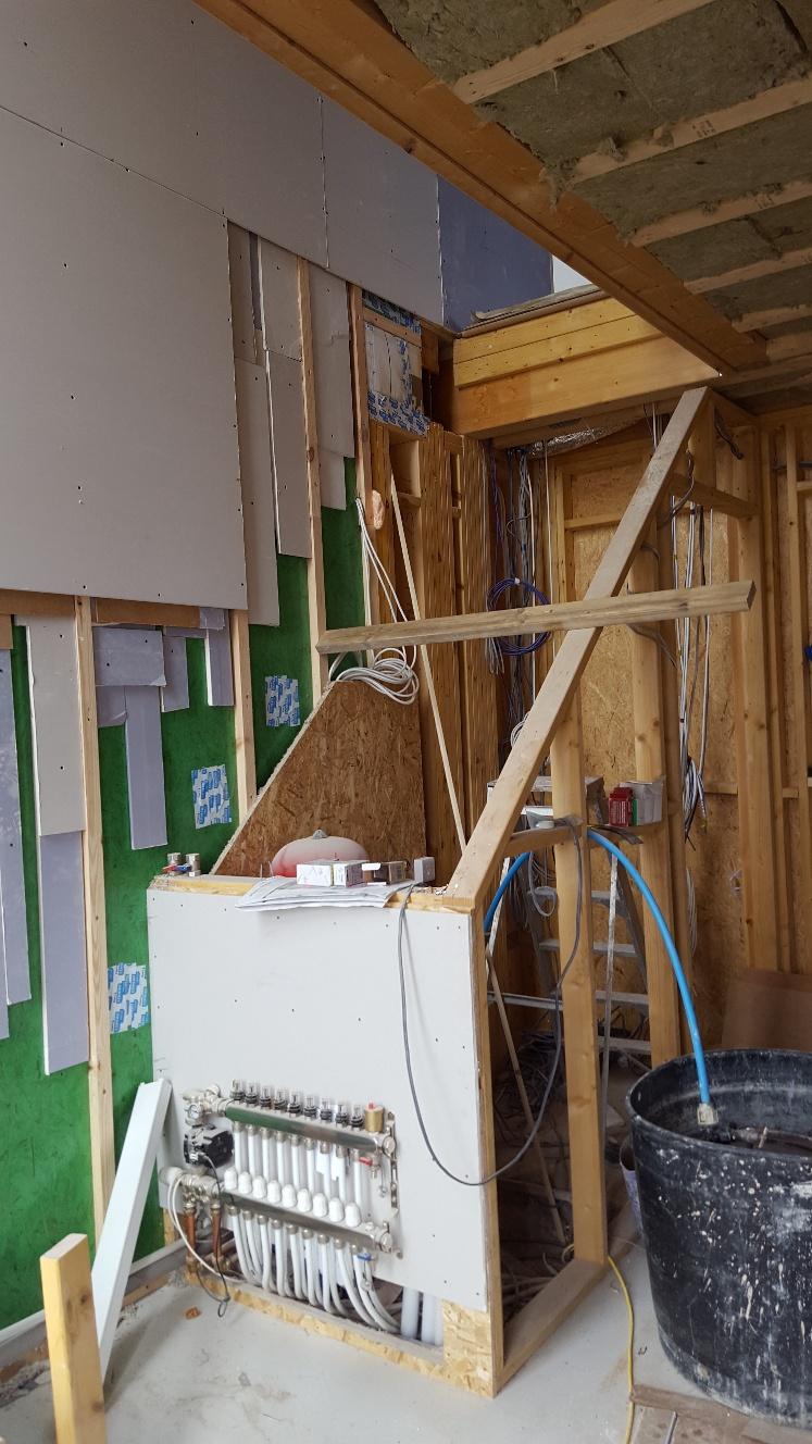

The week just gone saw the most challenging part of the plastering, which was the drop down the stairwell and the box section along the floor/upper ceiling run, which isn't one for a person with the slightest touch of vertigo. To get this done, the temporary staircase had to be removed and a compact but tall scaffold hired in to allow access.  A youngman board was run across from the landing to the scaffold stage so that the width of the area could be accessed.  As the last of the plasterboard was going up, we packed in as many of those pesky offcuts as we possibly could as this was our last chance to dispose of this within the walls of the house.  It looked like some random form of plasterboard modern art as it was going up.
Clearly, you can see that the stairs have been removed.  Also moved temporarily was the UFH manifold that's been sitting comfortably under the stairs, as we didn't want any damage to come to that whilst Ian the Plasterer was doing his thing.  Here's a not very good shot of the boarded stairwell and a peek at the edge of the PB lifter putting the board onto the hallway ceiling.
The stairs are now on the floor in the lounge.  Whether they will return to their original position depends on how long the permanent staircase takes to arrive, which is unknown right now as I need to have a chat with a couple of people about a couple of things, but I should be ordering it early next week.  In the meantime, here's the stairway to nowhere.

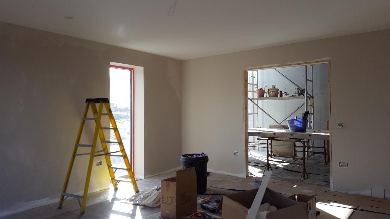

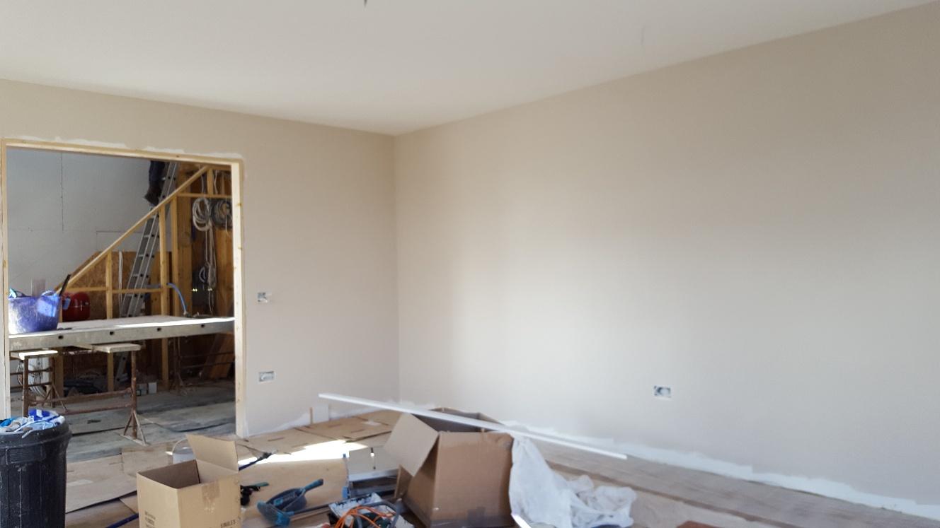

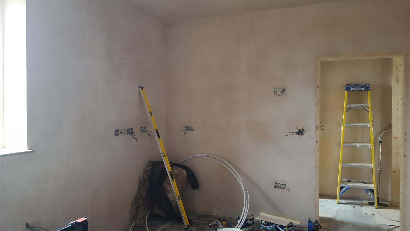

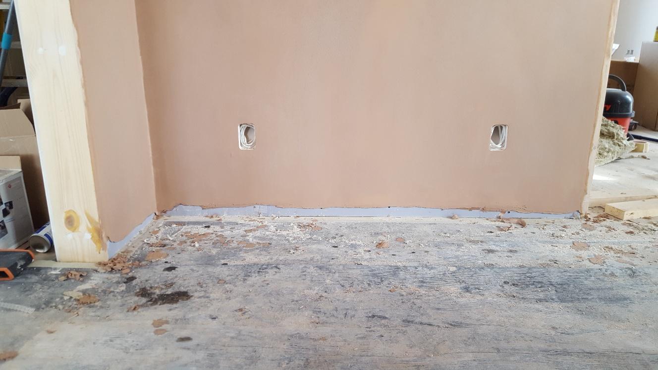

Back to the plastering, things are looking very different now that it's all done and drying out.  The building instantly feels more solid and less like a construction site.  The utility room is all done now and I intend to get in there next week with Jeremy's trust paint sprayer and then emulsion.
There isn't that much going in the way of units going into the utility - just 4 in total.  It will house a fridge, freezer and washing machine, then the units will continue along the same wall and have a work surface running above them.  I've deliberately kept it less full as it's useful to have some empty space for all the things that fill up dumping grounds voids that most households naturally have.  This is the other end of the utility, going through to the garage.

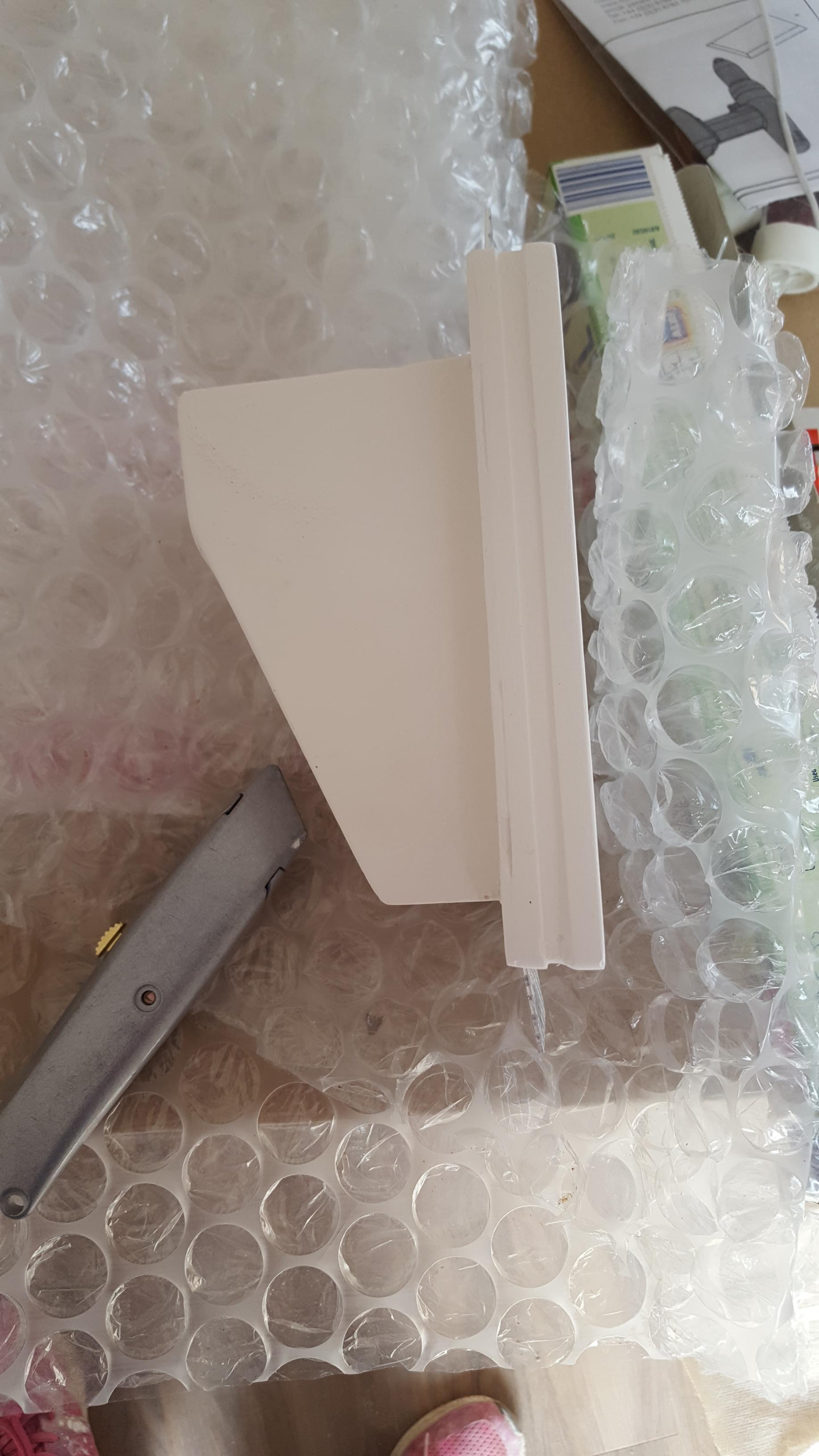

We've planned to have low level lights in the hallway for some time now and I've copied ones that can be put in flush with the plasterboard and then plastered in (thanks, Barney12!).  It sounded like a good idea so I ordered them and they arrived a few days later.  Cue panic on my part as they appeared enormous and were way deeper than I was expecting.  I had to measure them several times and be convinced that they wouldn't come out of the wall behind them.  As it was, only a screwdriver point did that.  The lights weigh a tonne - they are moulded plaster of Paris and very odd looking things, but look good once they go in.  Here's the side view of the light that needs to be lost in the cavity of the stud wall.  What a whopper!
And here they are once they've been plastered in.
Finishing off on the plastering, here's a view of the bottom part of the scaffold tower that I've hired for the occasion.  Even though the stairwell is plastered, I've kept the tower as I need to paint the stairwell and the prep for this means masking the long window, so I need the extra height for this.
Ian the Plasterer was cursing the weather that day as the sun was beating in and that long window faces almost due south.  He was bemoaning the fact that you could see every single ripple in the plasterboard and even the slightest imperfection stuck out like a sore thumb.  Overly critical of his own work as he is, he was very relieved when it was pointed out to him that there will be a brise soleil in front of that window eventually, which will smooth out his ripples in a jiffy.

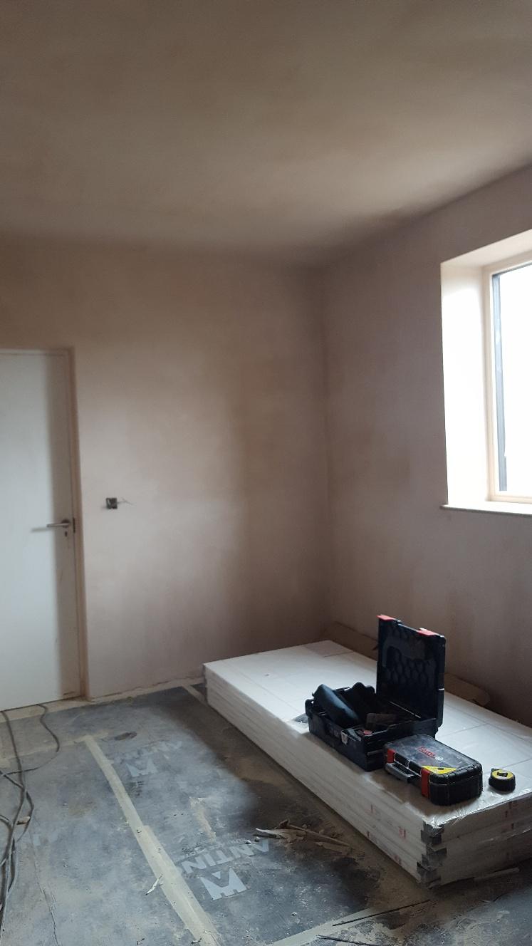

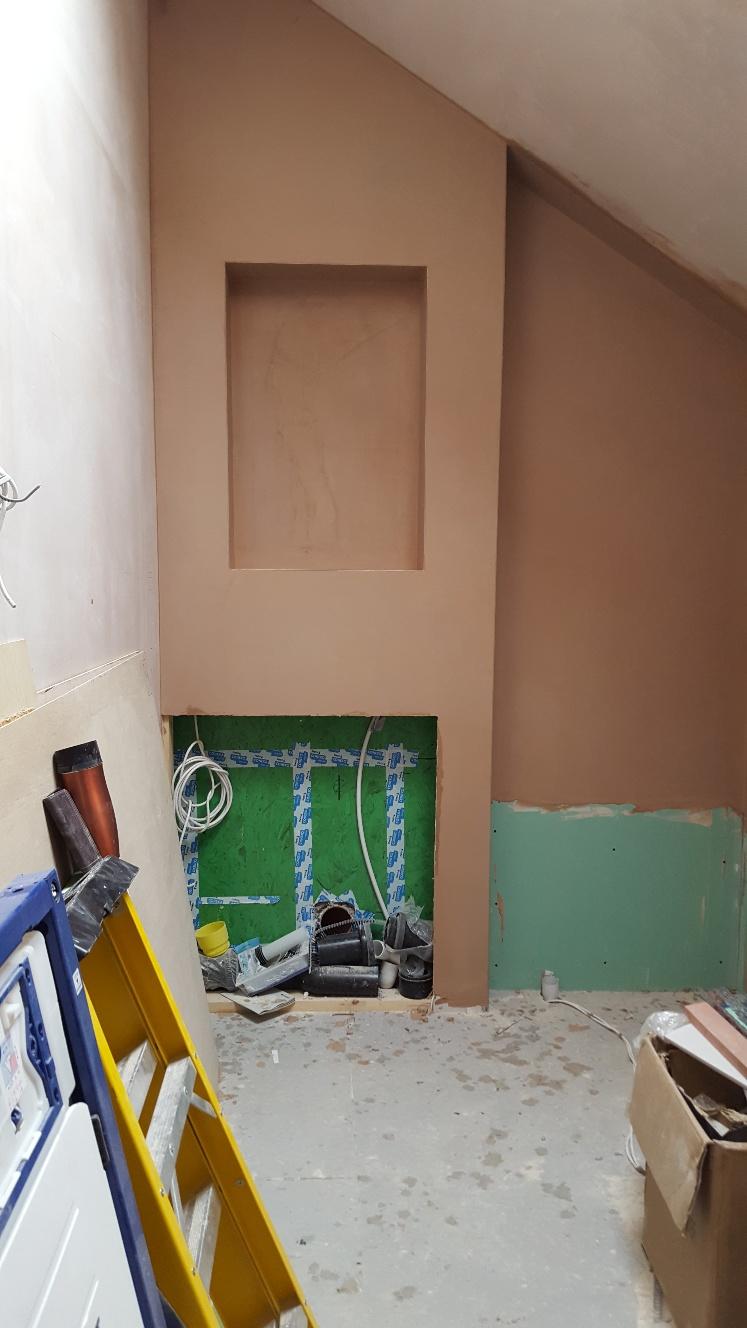

The last bit of plastering is a slight change of plan in the bathroom.  Originally, the slanted wall opposite the door was going to be tiled all the way to the top and the MVHR extract hidden with a false panel covered by a tile.  After some discussion, it was decided that this would look horrible as the side walls are only going to be tiled part way up.  We still needed a work around for where the wall protrudes to house the cistern for the wall mounted loo and decided that continuing the theme of niches in the bathroom, a large portrait-style one above the loo would look good.  I suggested that the MVHR outlet could then come down via the 'ceiling' of the niche, but a further move was made and it will be on the right hand side of the niche wall, above the bath, and so be virtually invisible (once the vents are covered!).  As ever, a sharp bit of plastering from Ian.

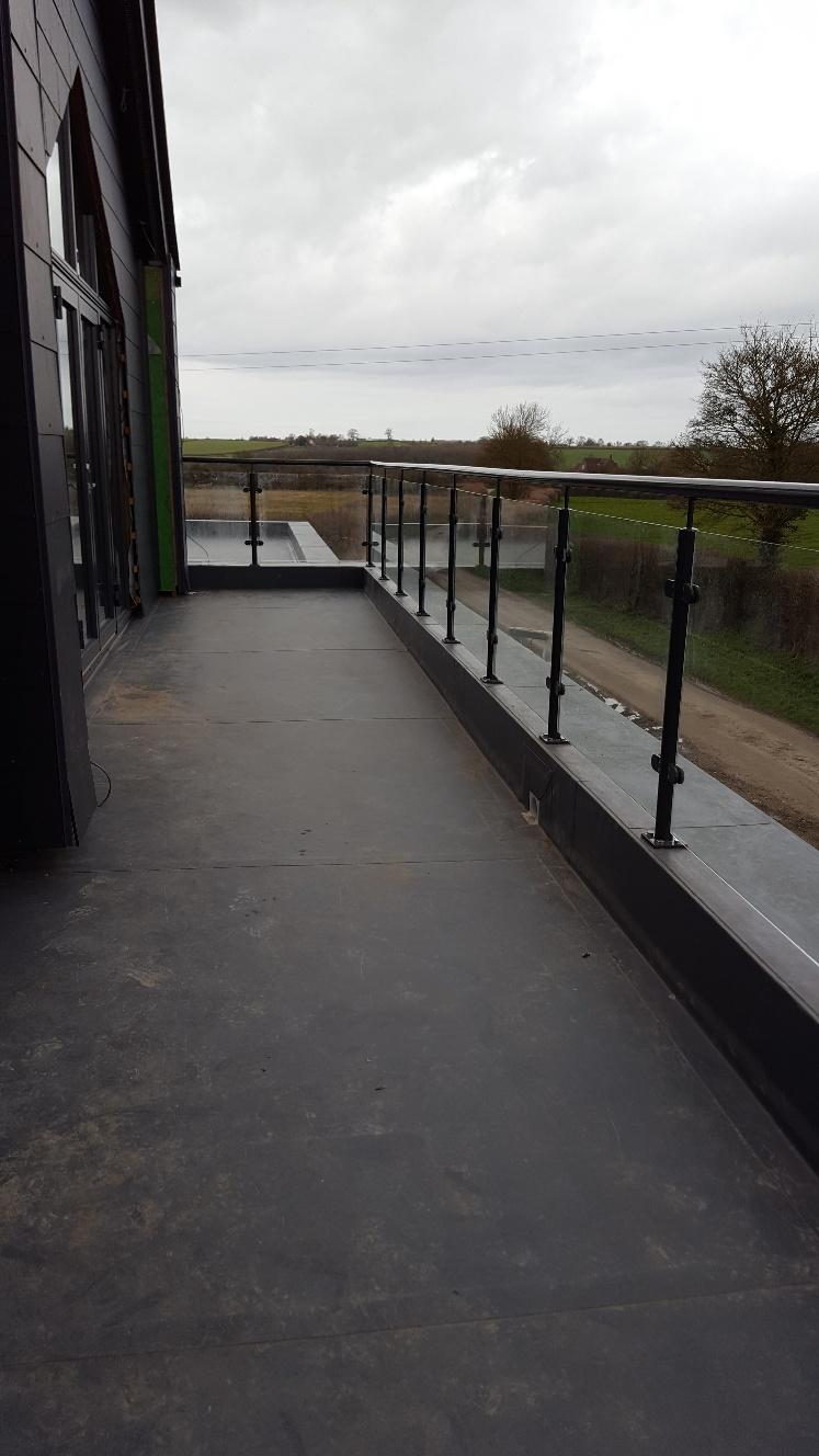

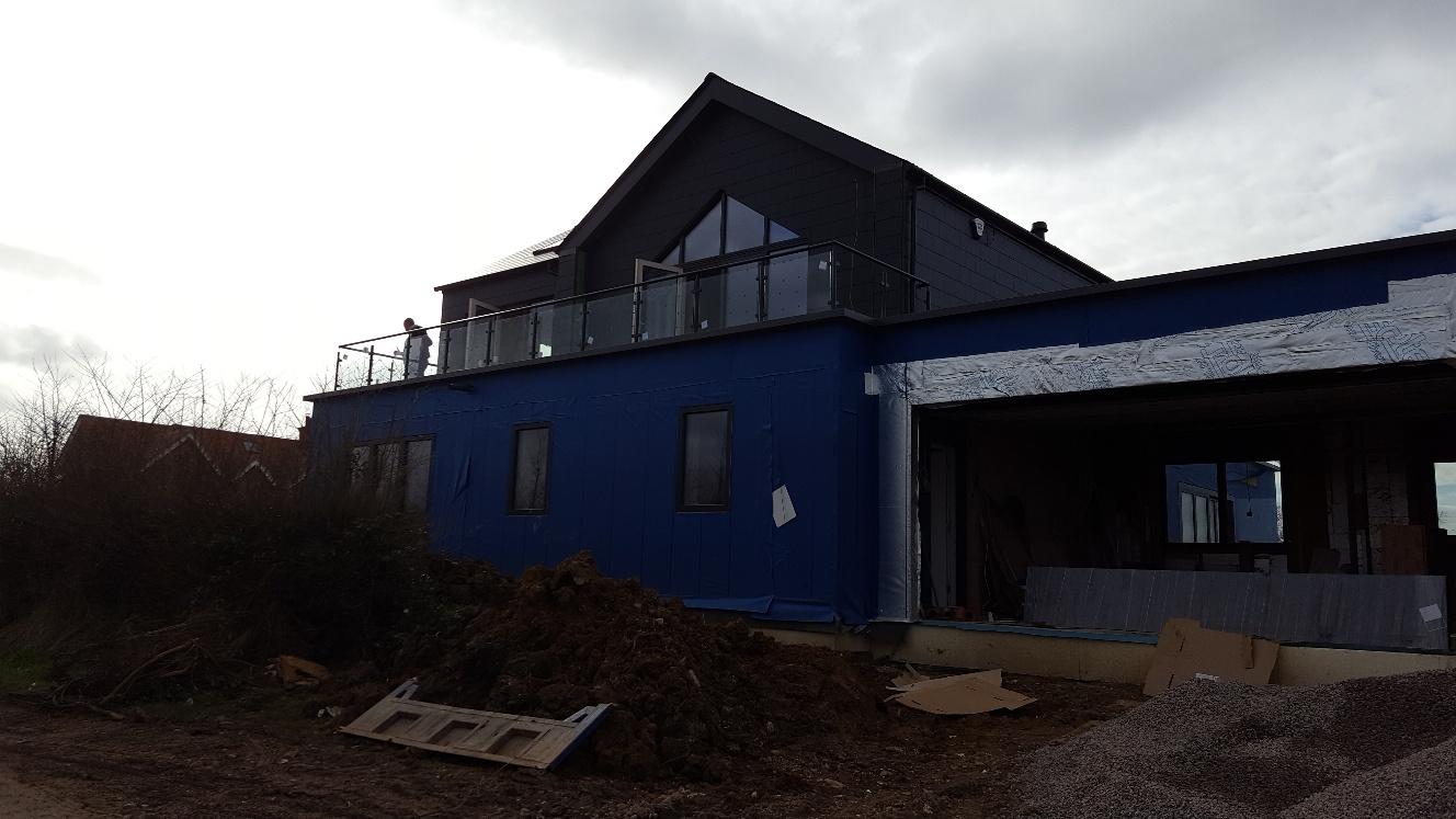

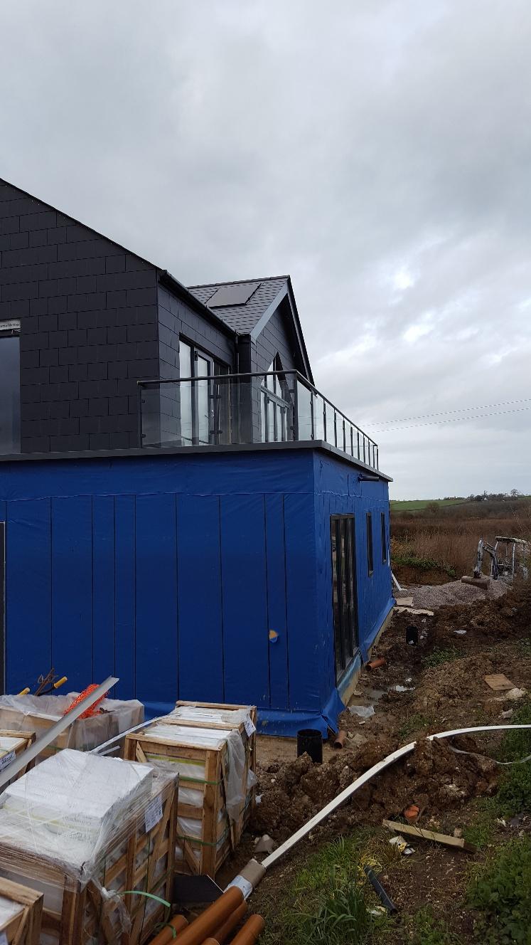

As well as the groundworks, the balustrades for the balconies started going in last week.  The east balcony is completed and the supports and railings are in on the west with the glass to follow shortly.  There was a problem with a couple of panels not being the right size so I'm waiting on those, then the guys will be back to finish the installation.  When I first ordered the balustrade, I had a minor panic shortly afterwards.  I had requested that all the metal work should be powder coated in RAL 7016 to match the windows and be close to the colour of the slate.  The panic was due to my wondering whether I should have gone for brushed steel or something a bit brighter.  Come the day, however, the darker shade of anthracite grey was the right choice as it blends seamlessly with the windows and slate cladding on the upper storey, so much so that standing in the lane, the railings disappear and only the glass is obvious.  Phew!
Here's the balustrade viewed from the balcony.
The same from the top of a pile of wood chippings in what will be the garden:
And, finally, from the lane.
The building looks very austere at the moment, but once the stone cladding goes on, it will be transformed again.

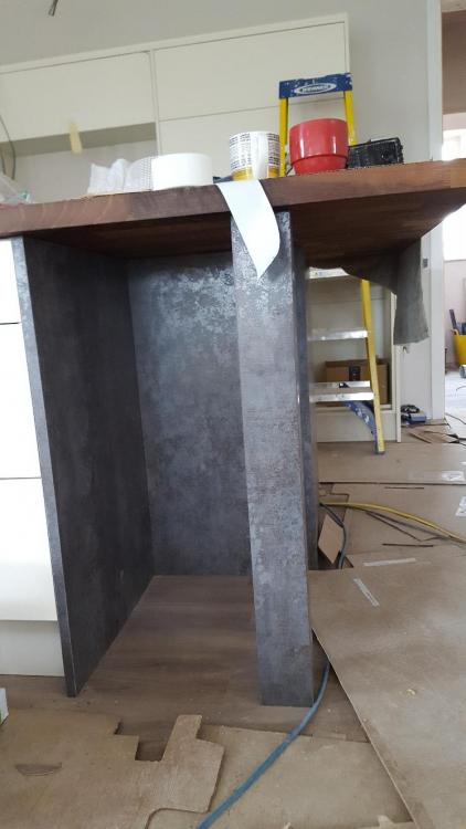

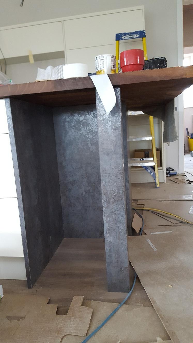

It's a bit chilly outside, so let's go back indoors.  Work has been continuing on the kitchen and the laminate worktop is in situ now, as well as the sink.  Photos on that to follow next week once the clamps are off.  I had been pondering the support post for the overhang on the island worksurface, and how to overcome my dislike for most of the ready made options out there.  I really didn't want a metal post as it would look incongruous against everything else in the kitchen and so in one of those late night flashes of inspiration that occasionally come along, I decided to ask Harry the Carpenter to clad some timber with the laminate splashback to make a post that matched the underside of the breakfast bar part of the island.  Harry did his thing, and I'm pleased with the result.  Much as with the balustrade against the slates, it largely disappears into the background of the recess under the walnut worktop.

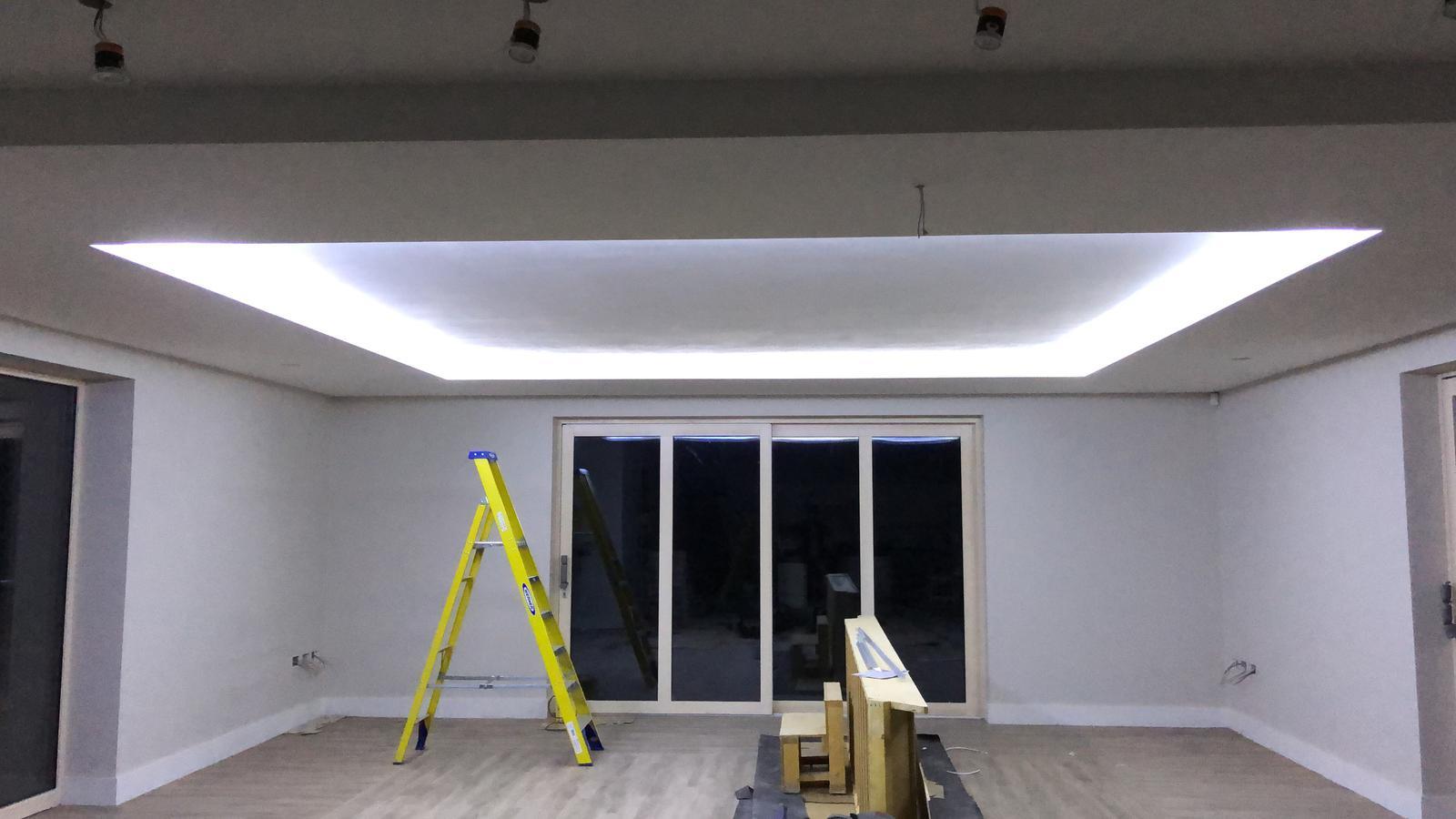

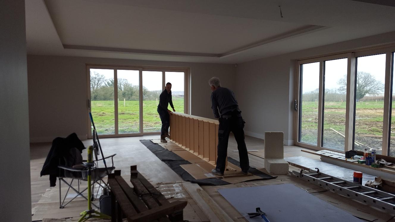

Finally, as I started the blog with Elvis, it seems appropriate to finish it with a bit of a light show.  Team Blackmore worked hard on the ceiling feature in the lounge but up until now, it's been uncertain just how well (or not) it would work out with lights.  Patience isn't always a virtue and so some LED strip lights on the feature were temporarily rigged up.  All I can say is that Team Blackmore had a smile on its face when it saw this.  Ladies and gentlemen, may I present the ceiling lights.

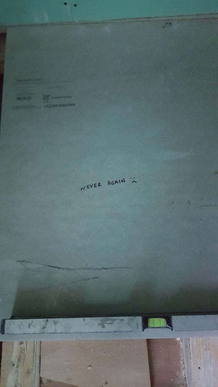

p.s. I was on site to do a clean up today whilst it was nice and quiet there.  There had been plenty of cursing during the week as work on the en suite shower for the master bedroom finally started.  Foul things were coming out of both ends of the plumber the day after his curry night and the recalcitrant shower wasn't doing much to improve his mood.  I noticed this today, written on a piece of board in the base of the shower recess.

I’m feeling quite pleased that I didn’t get a ‘never again’ message next to my TS given curry and a bunch of frustration was involved lol ?
