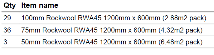

After reading every post on this forum on the subject of sound insulation and in particular Rockwool I wanted to document our experience.
Until the delivery arrived and we opened the packets we really didn't know what we were going to be working with.  Here is the best description I can give.
We ordered the following from Insulation4Less.  They told us the lead time was about 4-6 weeks (nationwide shortage) but actually it all came within a week leaving us with a literal mountain of rockwool to store around site.  It was wrapped but needed to be lugged into the house out of the rain.  Big job.  The 50mm deep packs were orginally intended to go in the ceilings where there were lots of pipes to fit around.
We chose RWA45 rather than the more expensive Flexi.  Having not seen the Flexi I can't give a really accurate comparison.  But the RWA45 is flexible and can be pushed into spaces and compressed a little anyway.  And it is cheaper.  It is not rigid / solid like Celotex (which I had first thought it might be).

So although it comes in these "batts" which have a form to them, you can trim to to the size you need.  We are trimming almost everything because the 600mm wide batts don't fit into the 560mm gaps between the 600mm centred studs.  But there are plenty of places to stuff the offcuts and the puzzle of how to use every offcut as efficiently as possible is keeping us both amused somewhat.
We are fitting this into all the stud walls (internal) and the ground floor ceiling.  No need for any insulation on the external walls or top floor ceilings as that has been pumped in by MBC (more of that in another blog).
