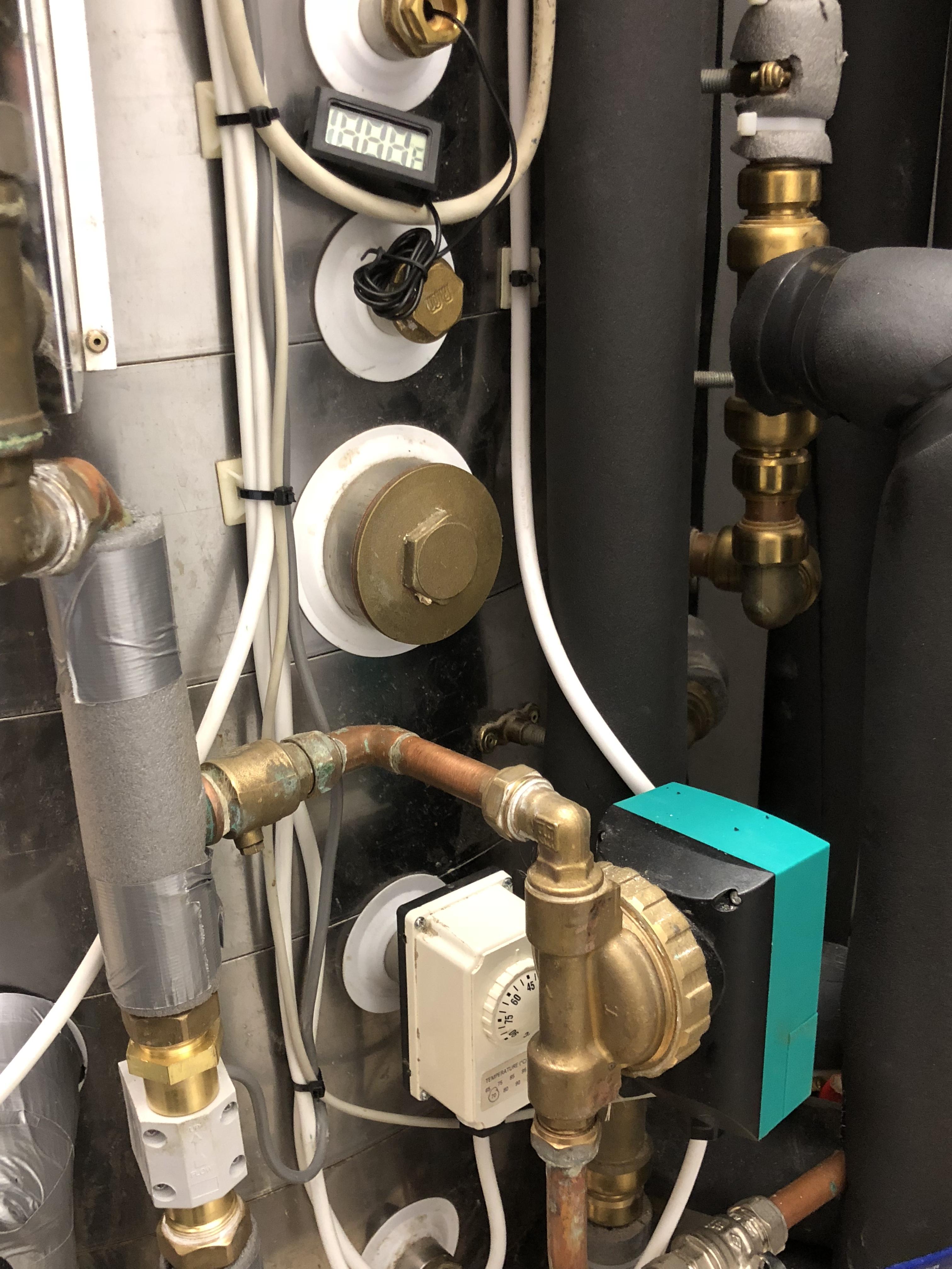

I also have these little stats in various places on the tank. @Nickfromwales and @PeterW put them there and I find them quite useful so have left them there.
In this photo the creamy box with the dial is the cylinder stat.
Link to comment
