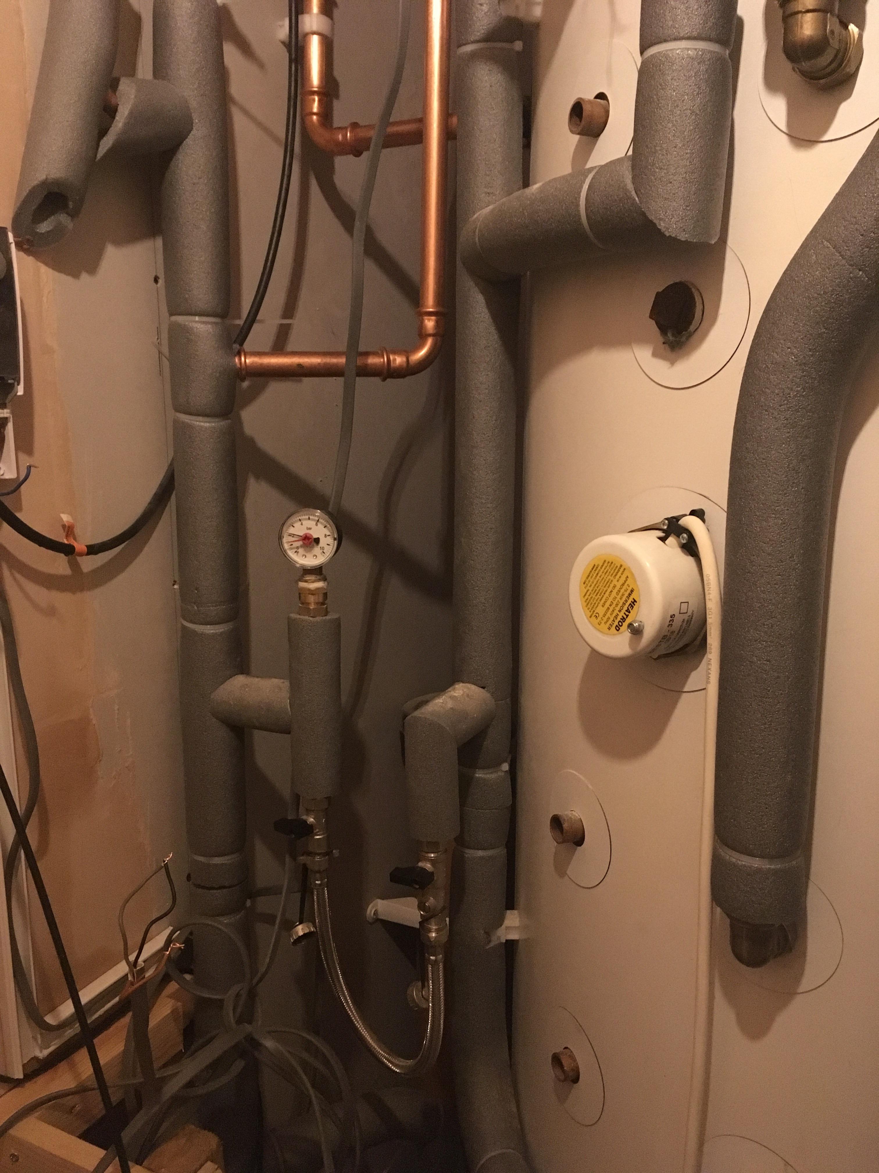

Basic observation.
This WAS working (to a degree) and the tank was getting hot.  Now it is not.
have you changed ANYTHING?
Where is the stove in relation to the tank? and more importantly does it flow by thermosyphon or is there a pump?  Is the pump running?

Yes @ProDave that’s right it was working although not quite right but we haven’t changed anything, there is a pump on the boiler and yes it’s working but because we’re hearing a gurgling at times we’ve been bleeding it and getting a bit of air out

There will be a pressure gauge somewhere.  What pressure is it reading?
If you have been bleeding air out, and not putting water back by opening the valves on the fill loop, it may have shut down due to low pressure.

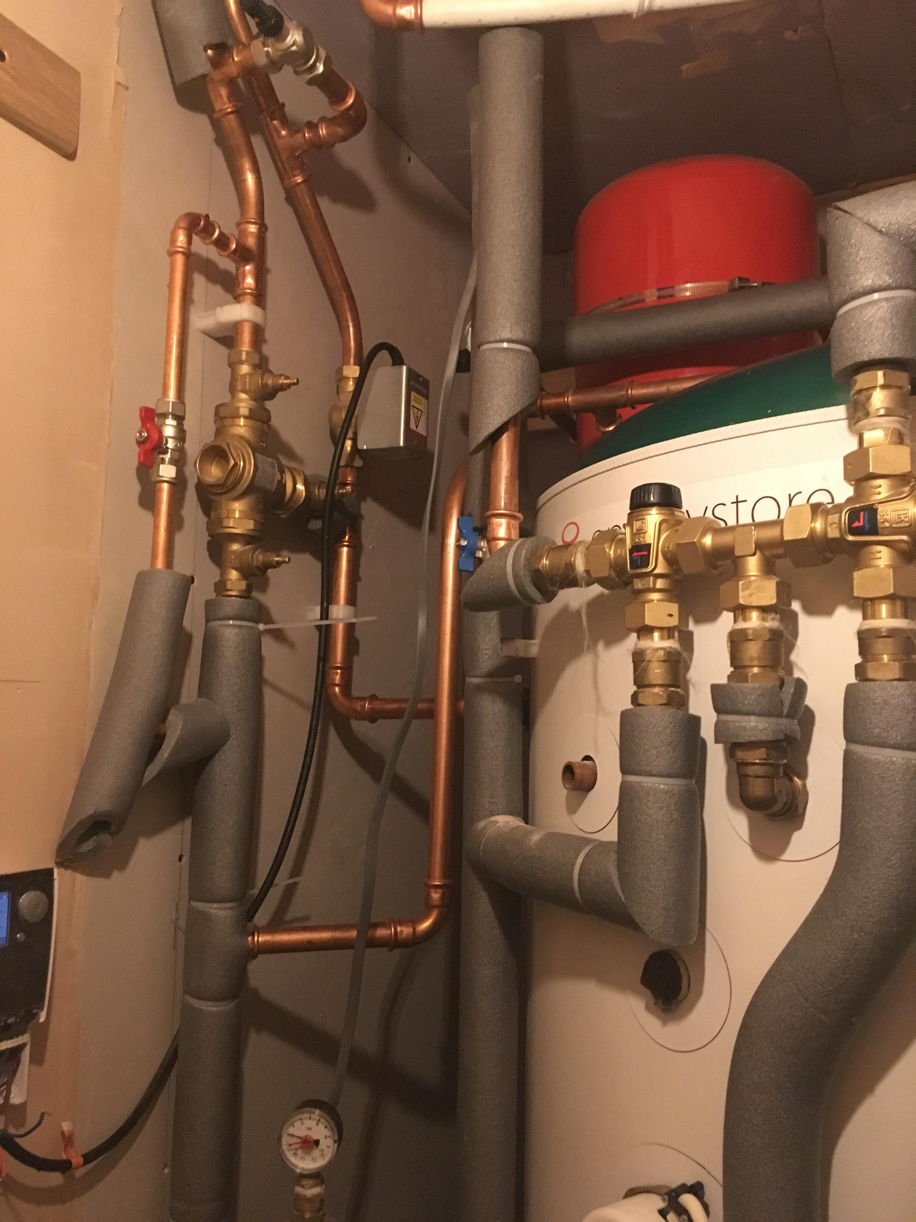

Open the AAV and just leave it open and let it clear itself. Stick the pressure up a little on the circuit too.
Now  looking at it, the right hand load valve just seems to take from the top of the tank until the lower tank is hot and that’s why the load valve is set up as it is.
Any photos of the left side of the tank ..?  And does it have an internal hot water coil ..??

8 hours ago, Christine Walker said:
Reading just under two bar @ProDave
yes @PeterW it does have an internal hot water coilimage.thumb.jpg.b62c2ef16eac242f7988768275acf062.jpg
Those bare wires twisted together bottom left don't give me much confidence it has been wired properly.
Link to comment
Don’t worry about the wiring @ProDaveit is being attended to as we speak, installer did not do any of the wiring and resulted in us having to get the spark out at short notice just to get it going, he’s back now to finish off.
thankyou thank you @PeterW hubby went through everything you advised and was up till 3am , air in the tank seems to have been the problem and it’s now working fine ?

Really pleased for you @Christine Walker..!!
I would leave that butterfly valve open to the air vent, top up the pressure to around 2 bar and then ensure the bypass is closed on the boiler return mixer.
I would also get them back to fix that zone valve and get everything labelled up properly

Hi everyone, thanks again @PeterW for all your help last night but unfortunately things have gone t*ts up again, I’ve just emailed the installer AGAIN and told him this set up is not fit for purpose, it just can’t seem to heat everything, we either get roasting hot tap water or we get ufh, haven’t even tried the radiators upstairs, house is not warm at all although it seems to heat certain parts of the tank but not it all, really really wish I’d never seen it!
Link to comment
Yup on full chat it will be fine HOWEVER....
If you’re referring to the one that you’ve got next to the thermal store then it feeds both rads and UFH manifold and the manifold will be a higher resistance. You may need to up the flow rate on the manifold to make it draw off that tee as currently if both the rads and manifold want heat, the lowest restriction will be the first rad on the circuit.
