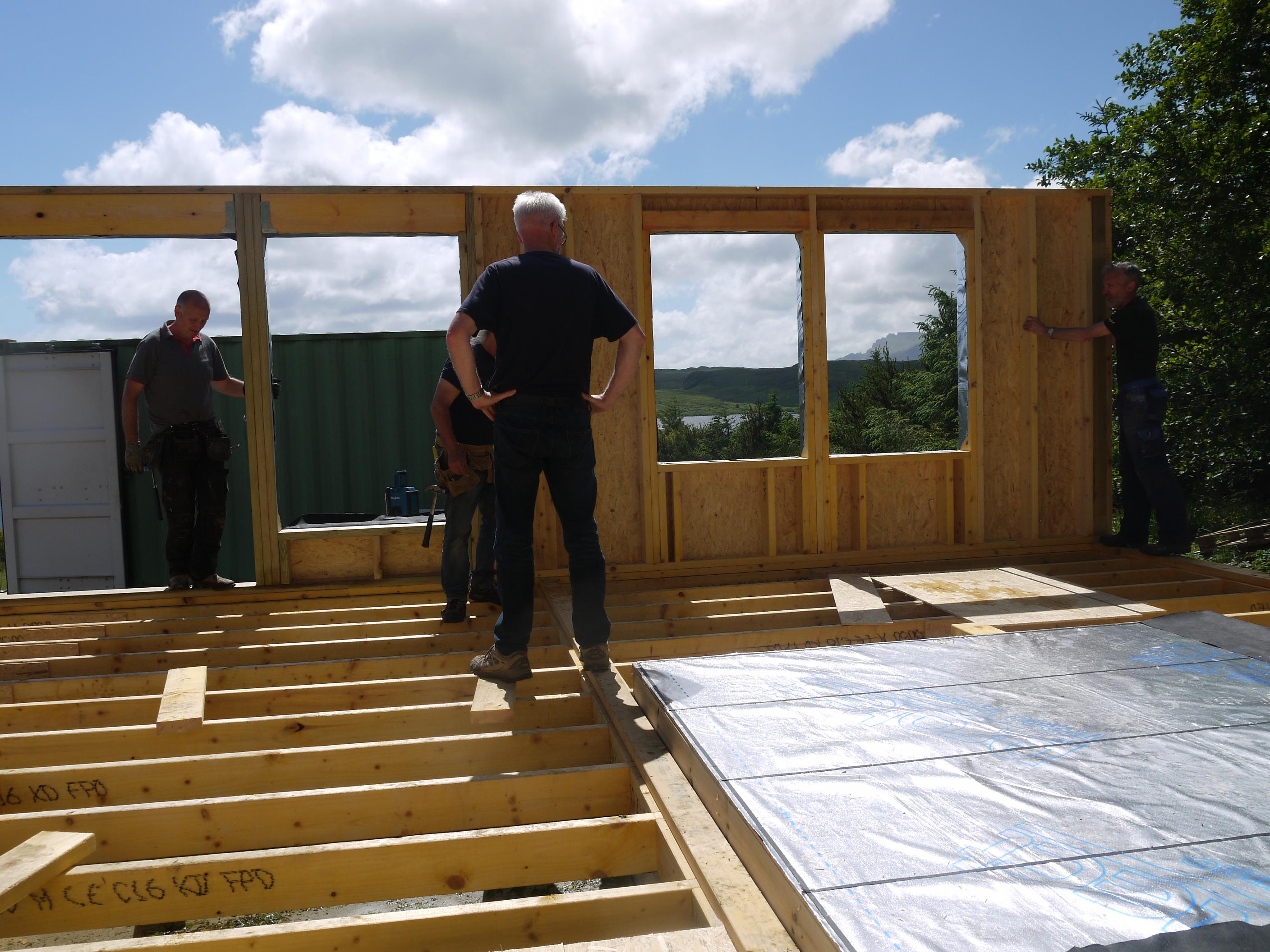

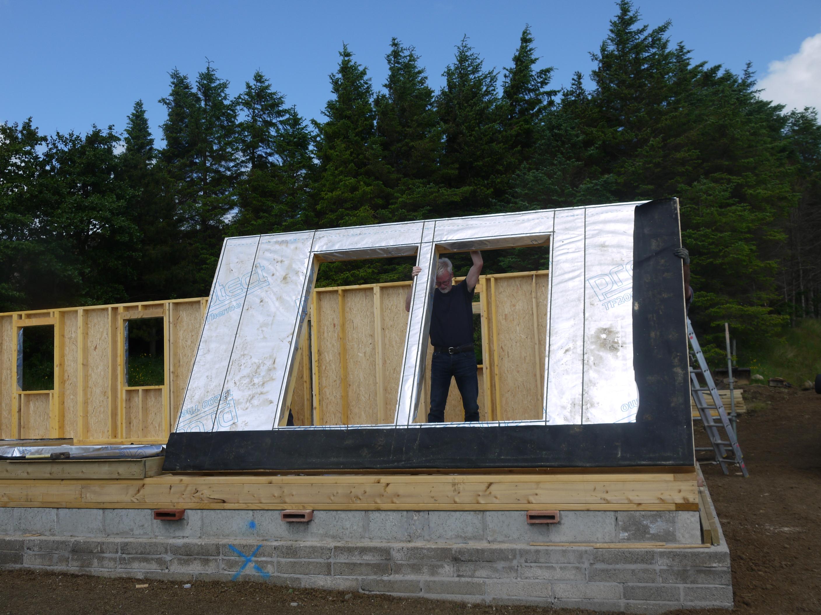

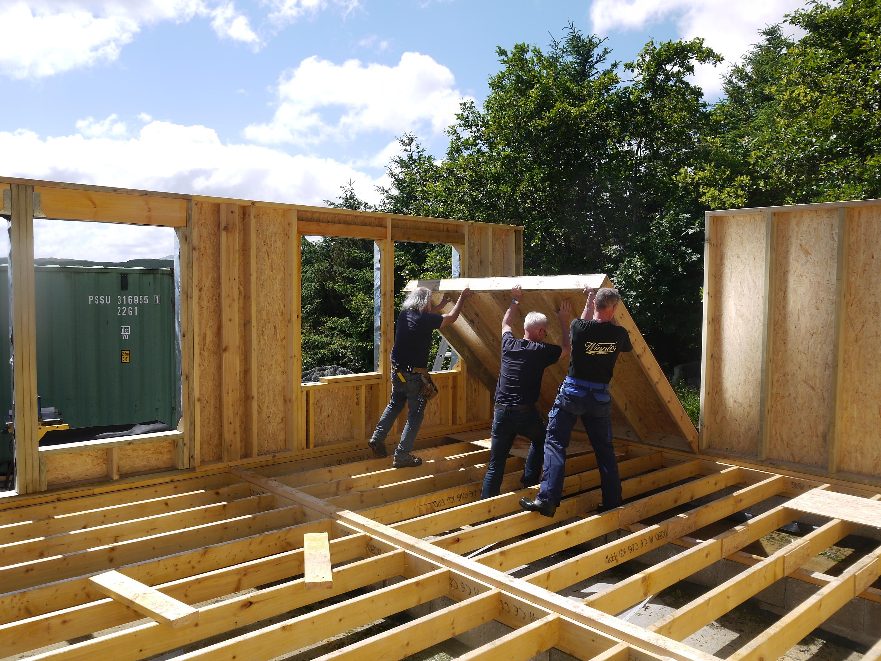

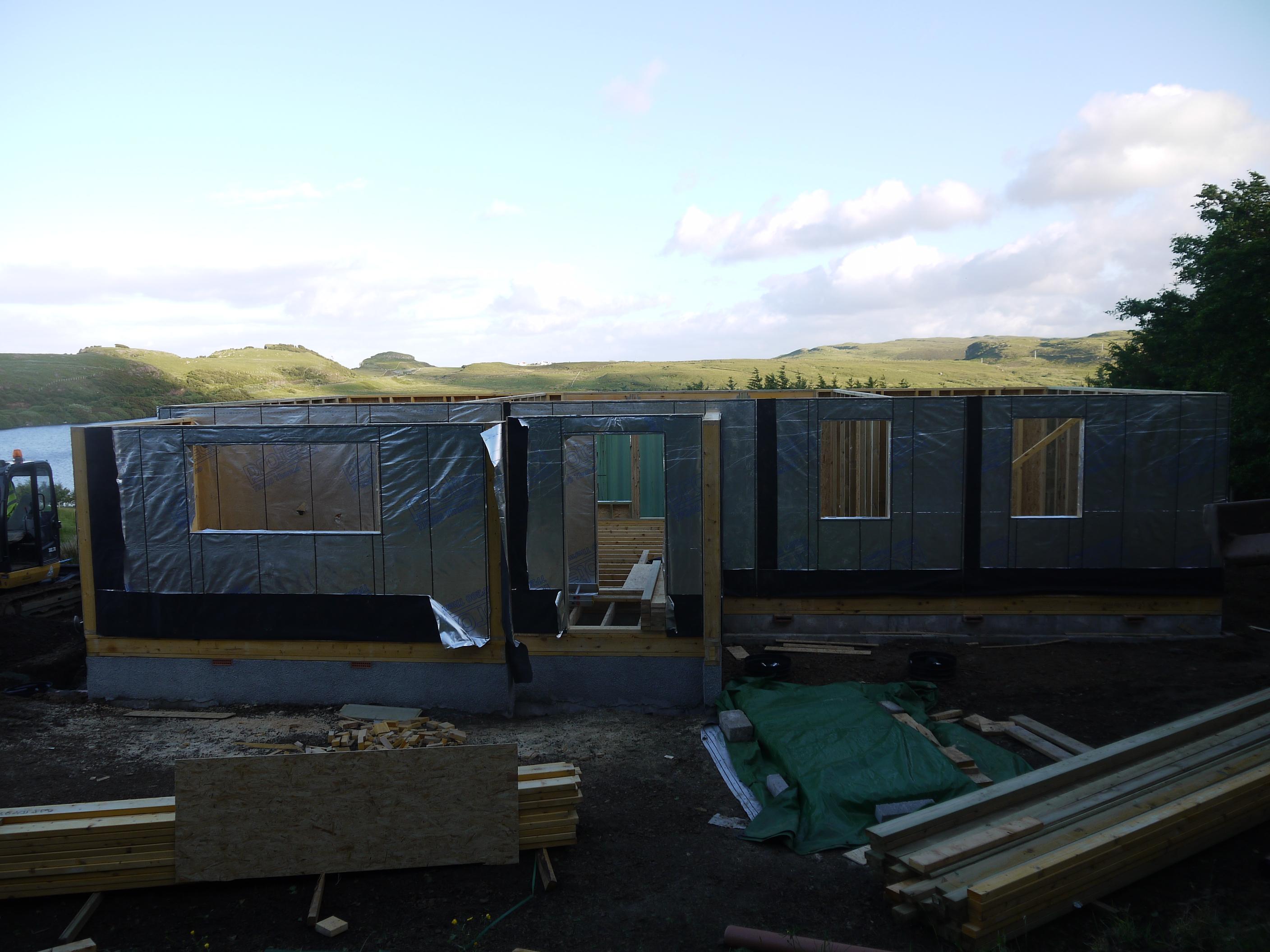

Today was one of those special days where suddenly years of work starts to come together in front of your eyes.
No machinery here just elbow grease.
P1150223.thumb.JPG.80b11302b529f2d0fe44cf903c8f2c57.JPGP1150225.thumb.JPG.7dc50a43f7e96283ec764f0c91705e20.JPG
It was all going so well until the building inspector turned up.
A few internal load bearing walls to be finished and then on Monday we have the telehander coming to stay for a couple of weeks, followed by the delivery of the attic trusses on Tuesday.

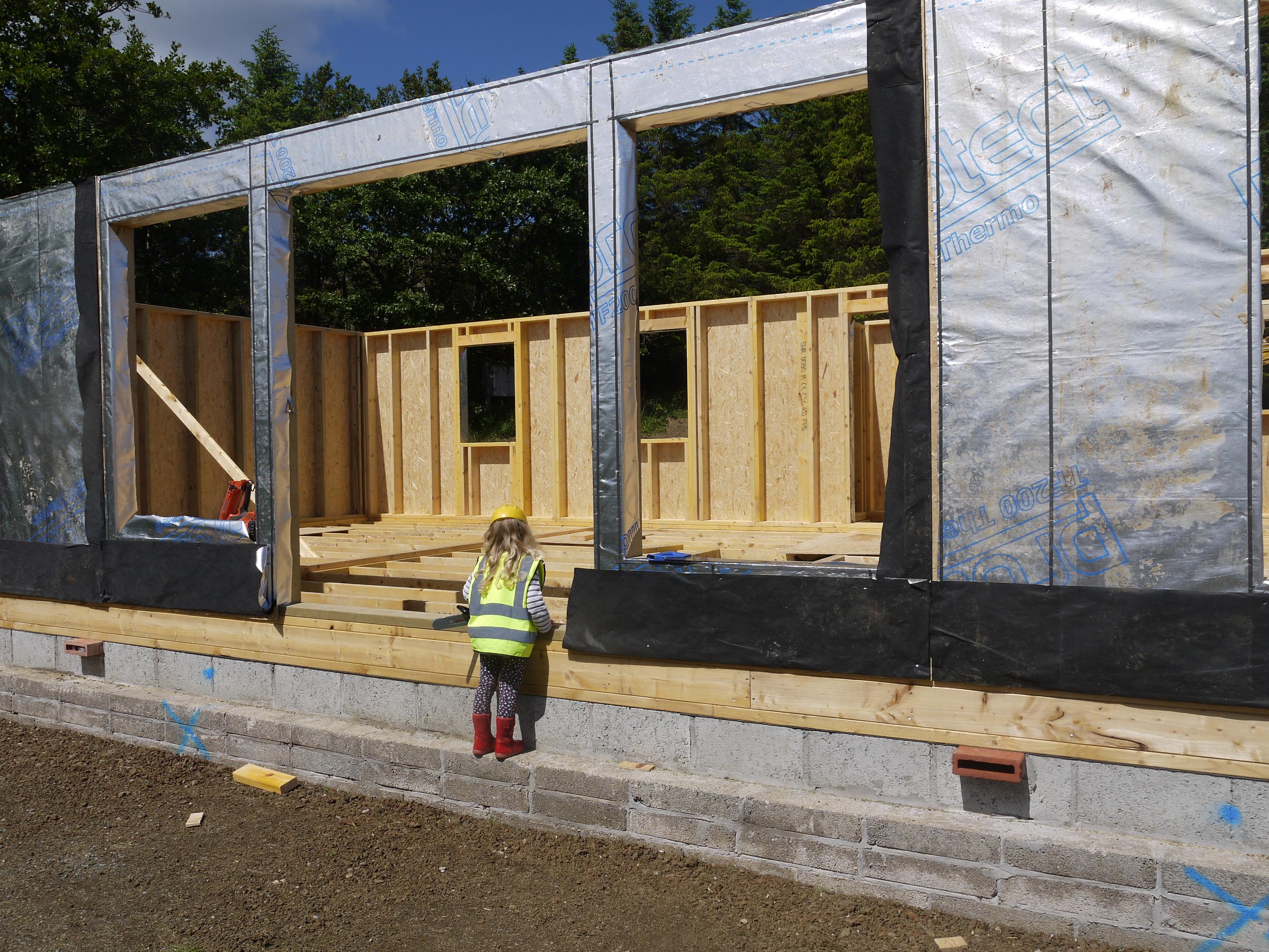

Hi @Thedreamer looking good and progress appears to be going well too. I noticed you have "vents" in the block work at various locations is that because you are having what looks like to me a suspended floor? The reason I ask is simply because our TF and ground floor construction doesn't have them! o.O
Thedreamer
Hi @Redoctober these are just required for a suspended timber floor to allow ventilation, if you have a normal concrete slab these are not required. Although it is uncommon for a new build to have a timber ground floor across the UK, this was the method of choice for many houses in the Highlands & Islands that were built in the 80's and 90's, whilst down south slabs and beam & block were being utilised.
We actually have quite a lot of layers under the joists. A thin slab of concrete, DPC, a layer of fine rock (whacked) and then a deep layer of compacted rotten rock. Therefore what is underneath the joist will never be damp and with ventilation externally and within the sleeper walls the joists will last hopefully a very long time.
