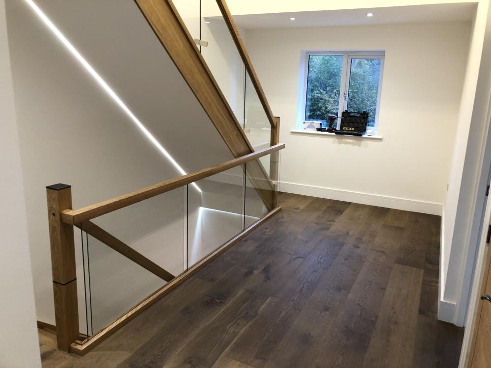

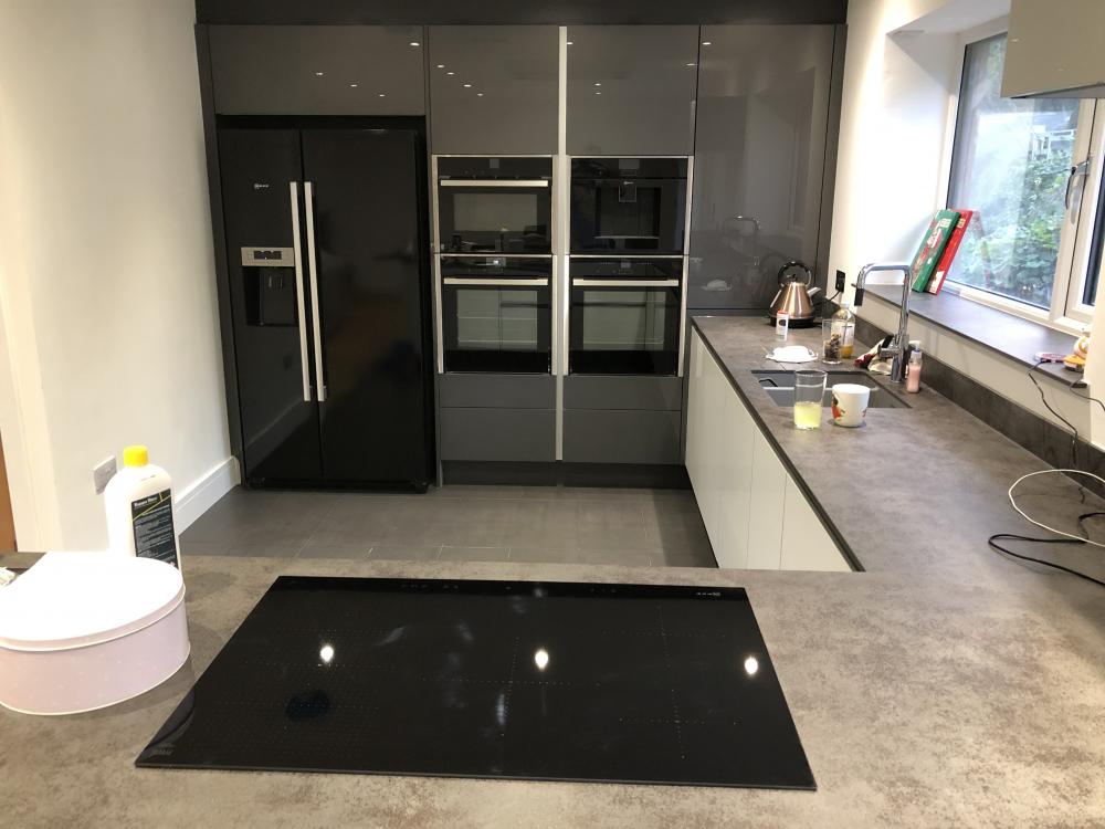

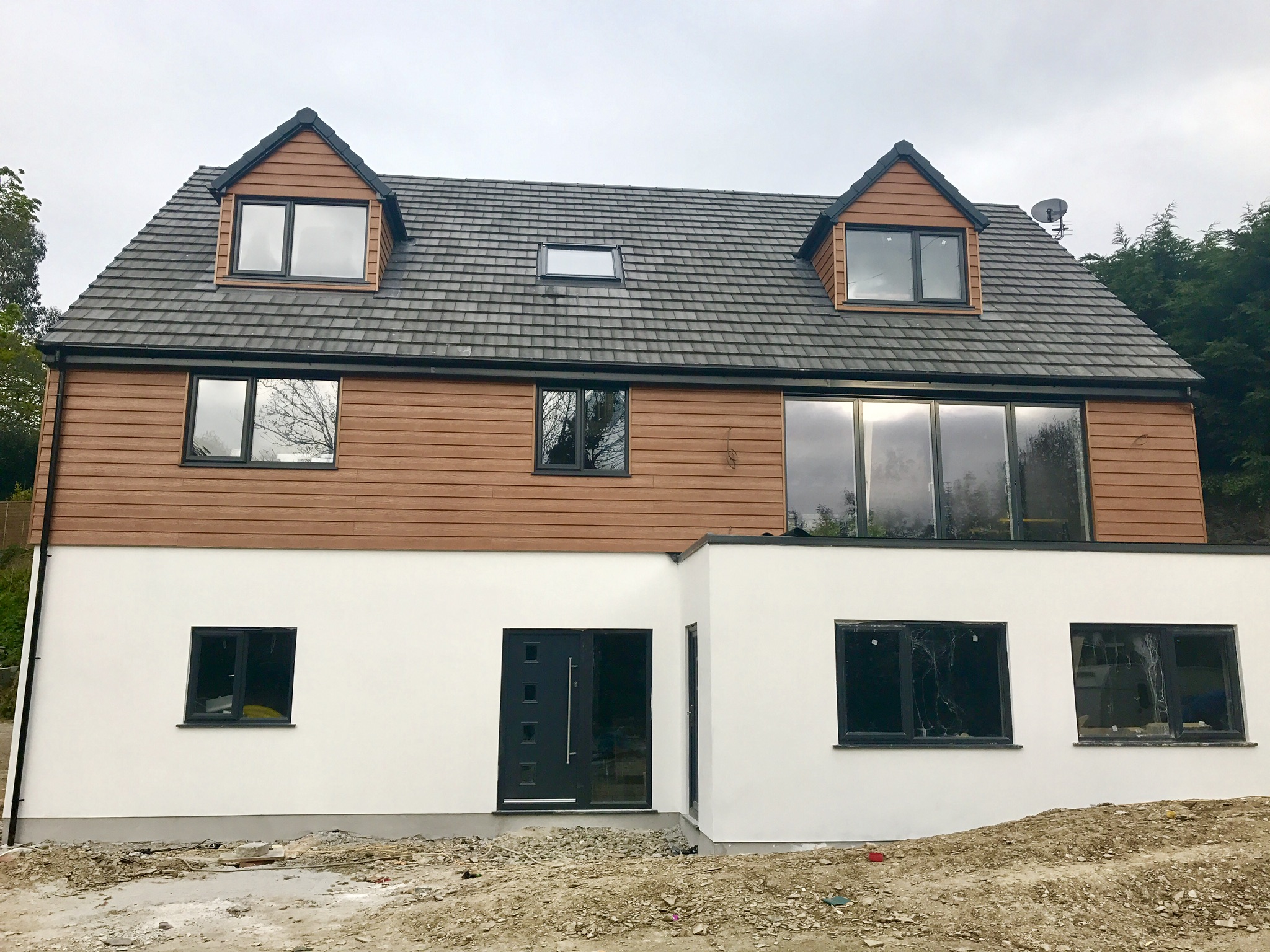

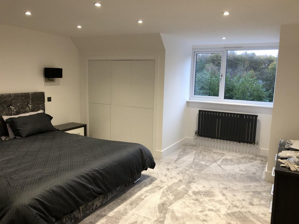

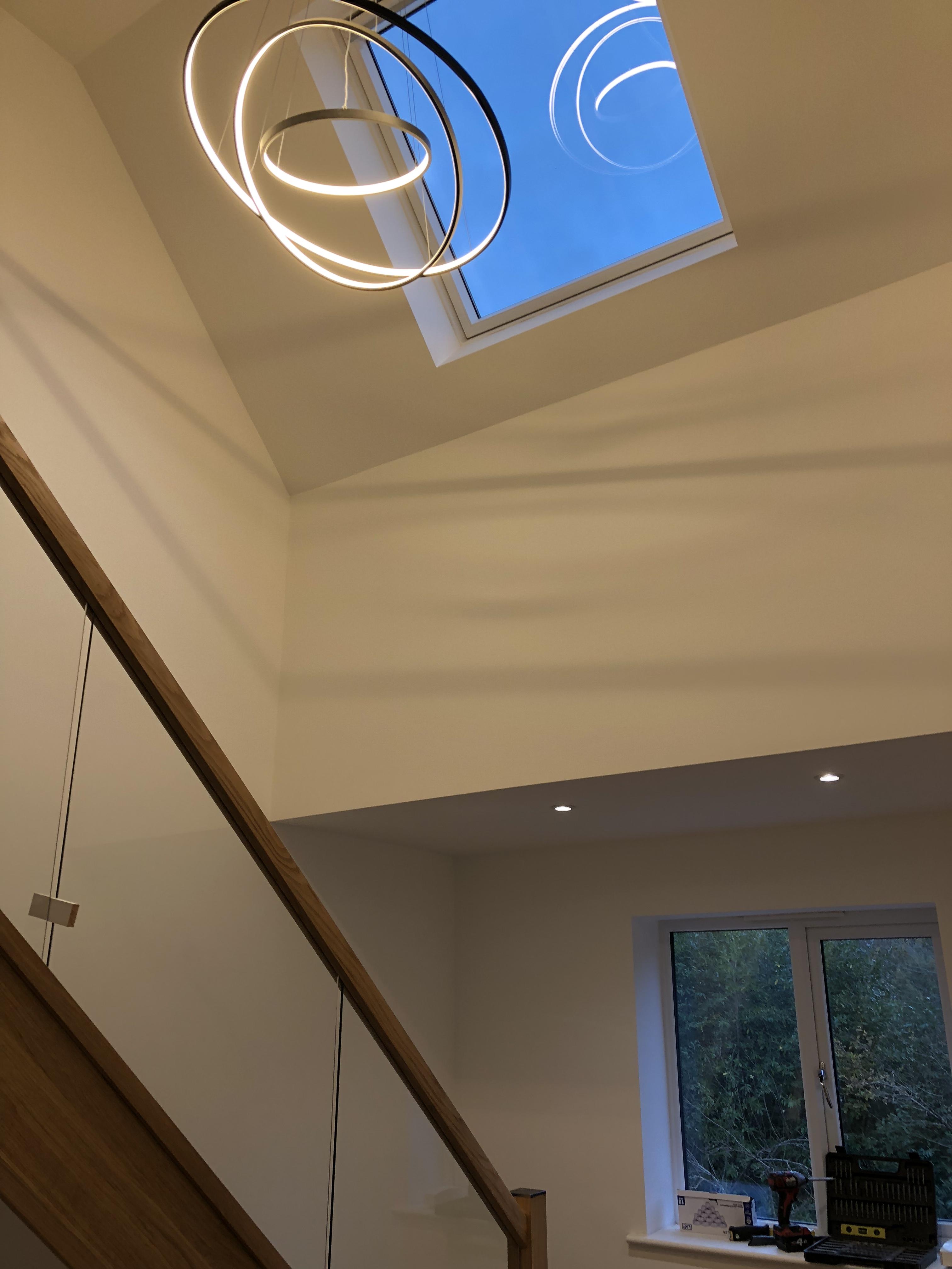

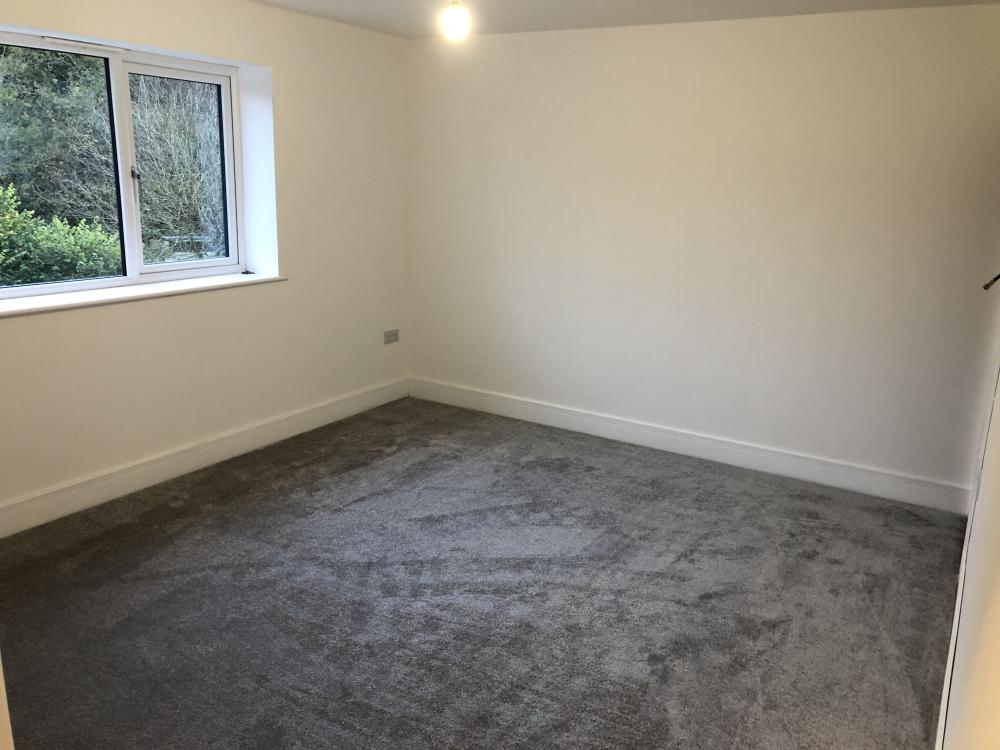

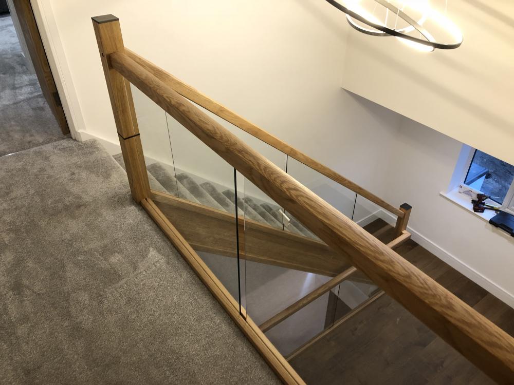

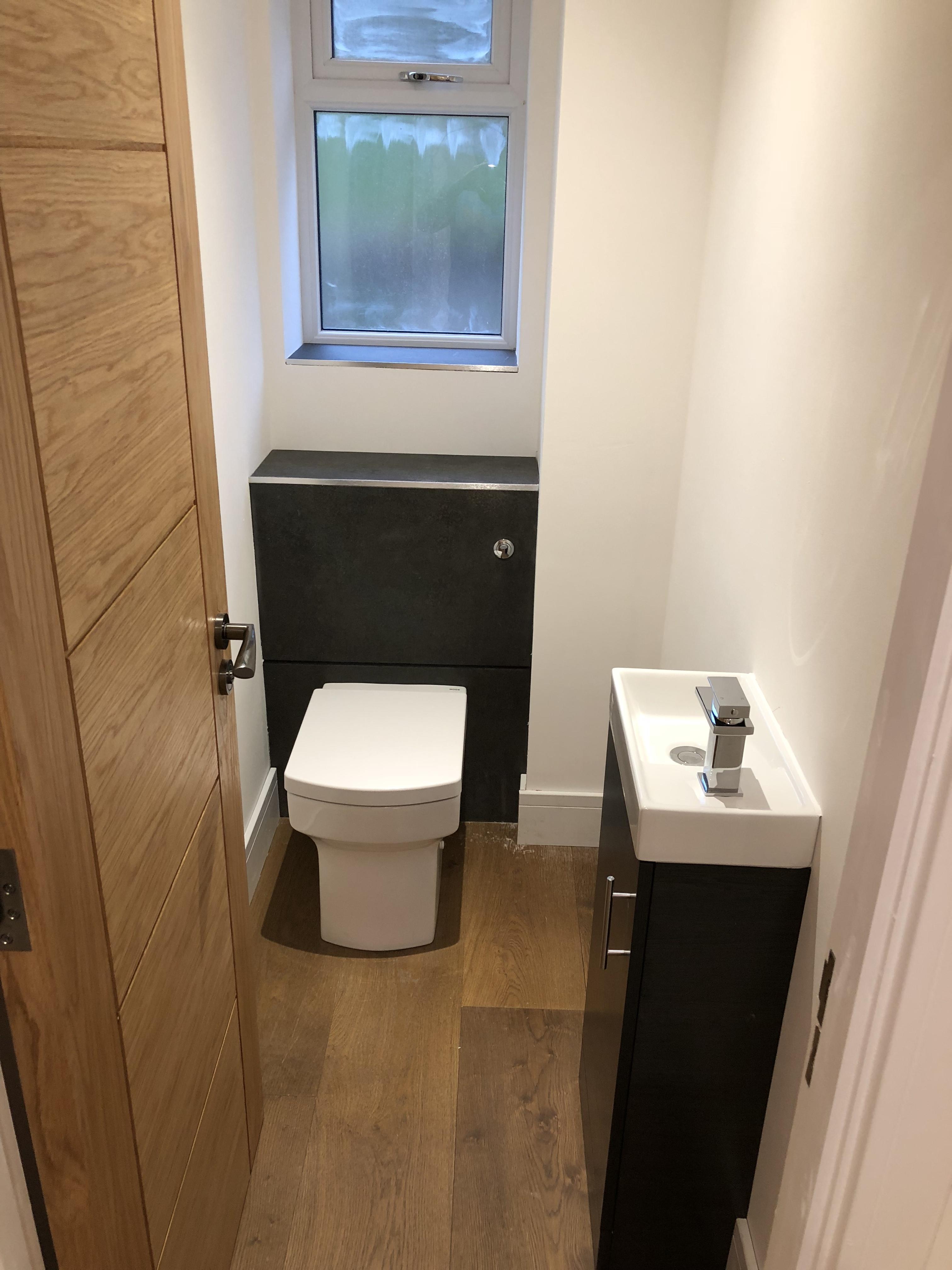

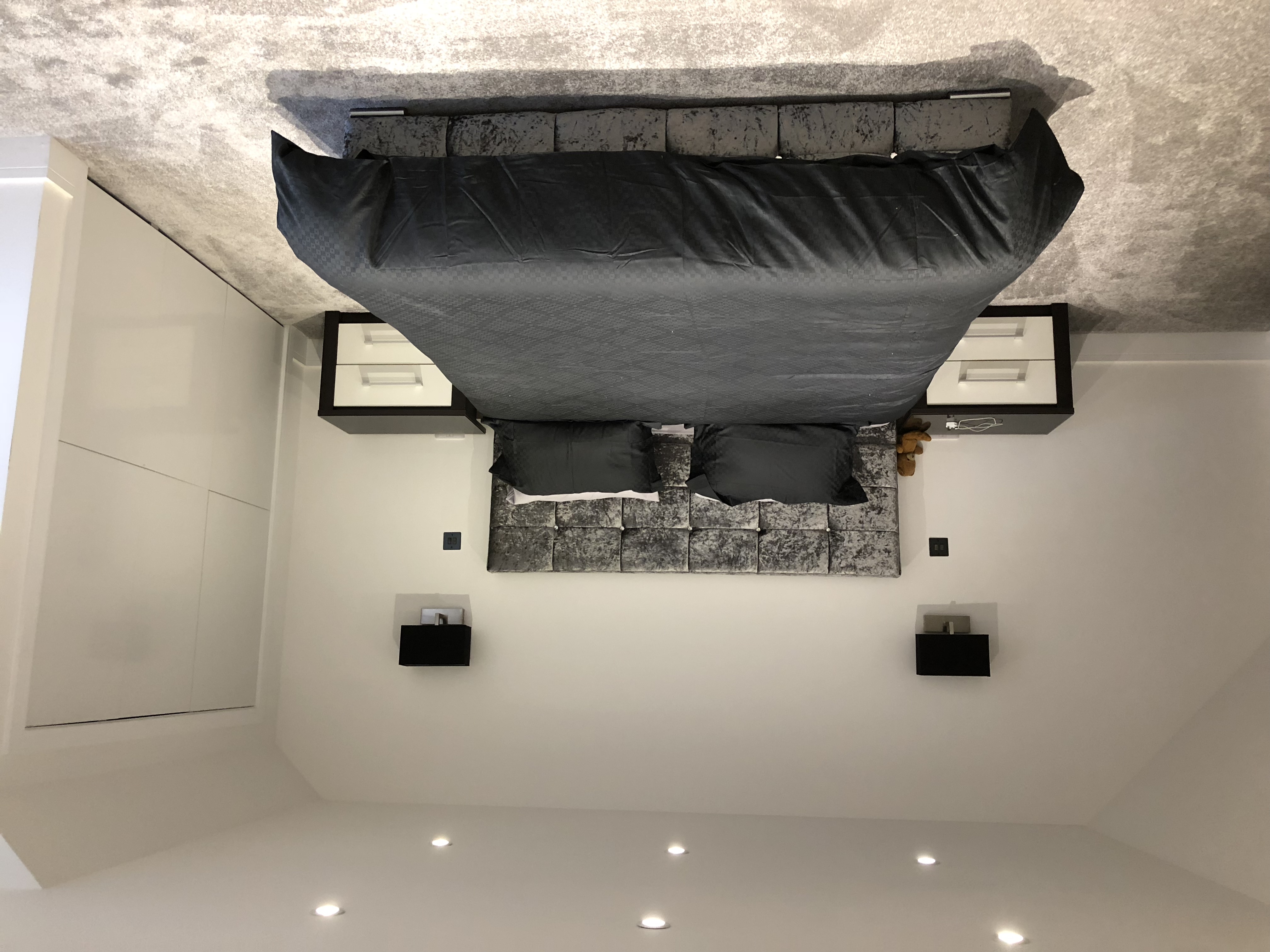

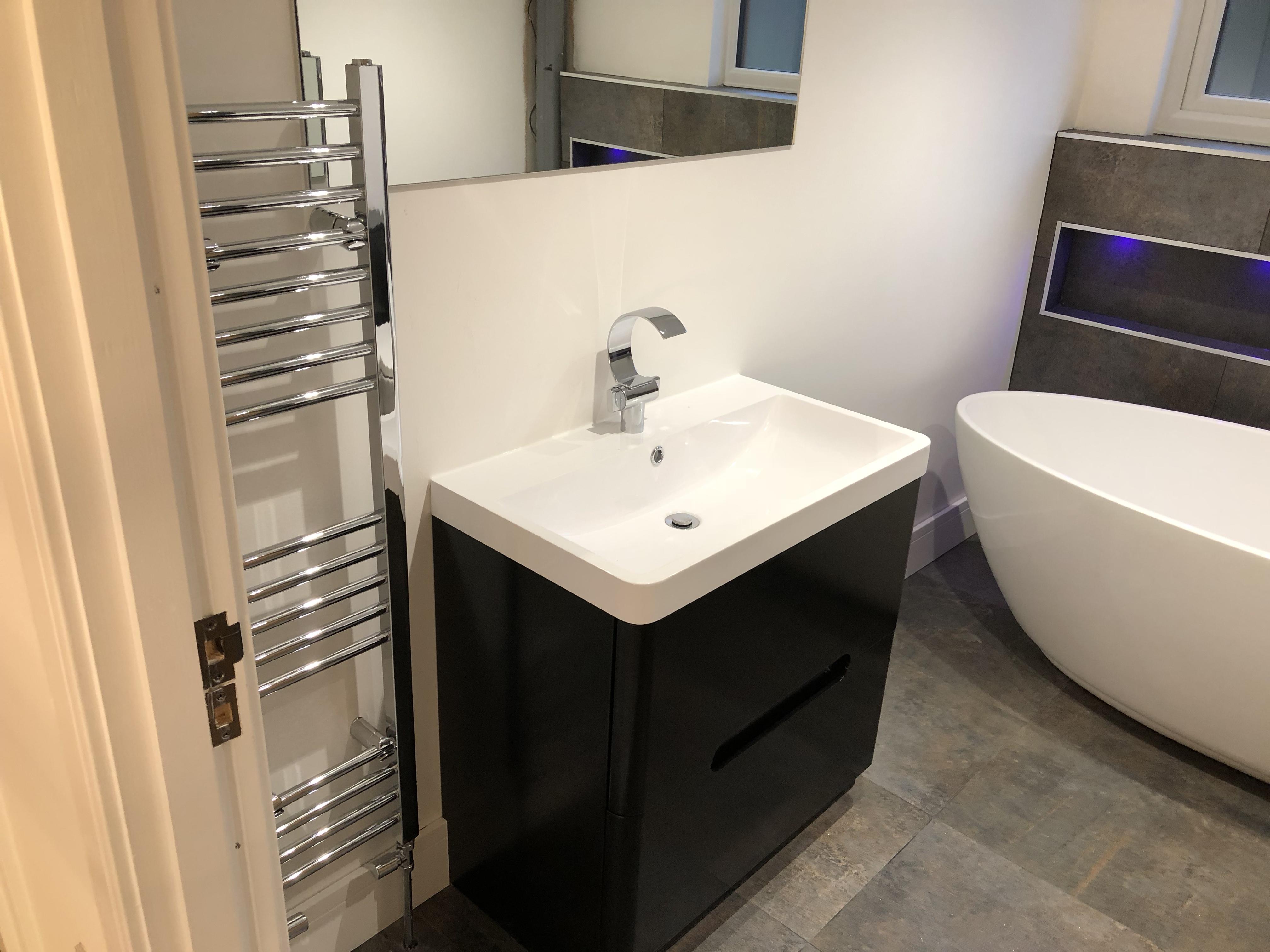

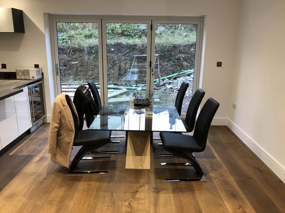

Woke up this morning in our new home! Now sat on the sofa watching tv in my new home, waiting for a full day of rugby TV to start so I can sit and sip cold beers in my new home!
Can you tell I’m pleased?!
Facts and Figures
1 year, 1 month, 14 days
(Breaking Ground to Moving in)
4 Double Bedrooms
3 Ensuite
1 Family Bathroom
1 WC
Open plan lounge kitchen diner
Utility Room
Double Garage
Workshop
Land: £120k
Build Cost: £200k
Cost per m2: £666/m2
(This figure is slightly off as a large part of my ground floor is garage / workshop space so can’t really be counted as fully costed m2. However I’ve also got a £30k retaining wall in the ground floor section that wouldn’t usually form part of the cost per m2. Either way I think I can happily say I’ve built for approximately £800/m2 which I’m very pleased with)
Photos below of all the finished areas. Garage and outside space an ongoing project!

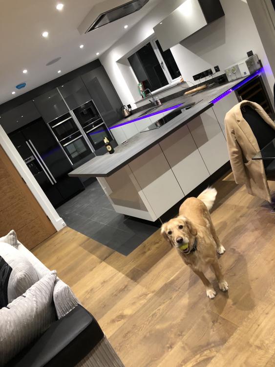

Very very good - you seem to have hit a sweet spot with nearly everything (more detailed comment tomorrow).
I love the anti-gravity dog and beer (last 2 pics click-thru) :D.

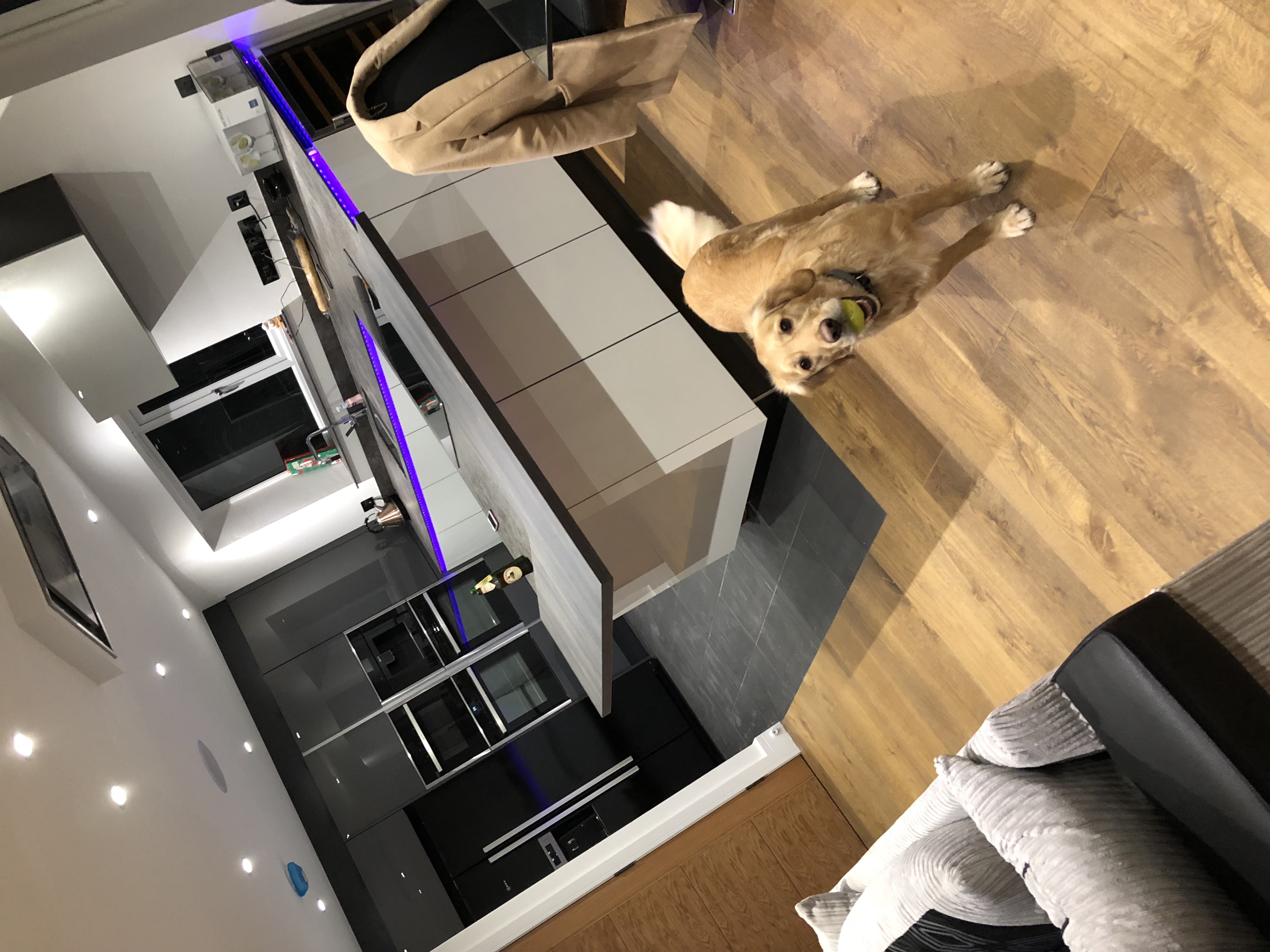

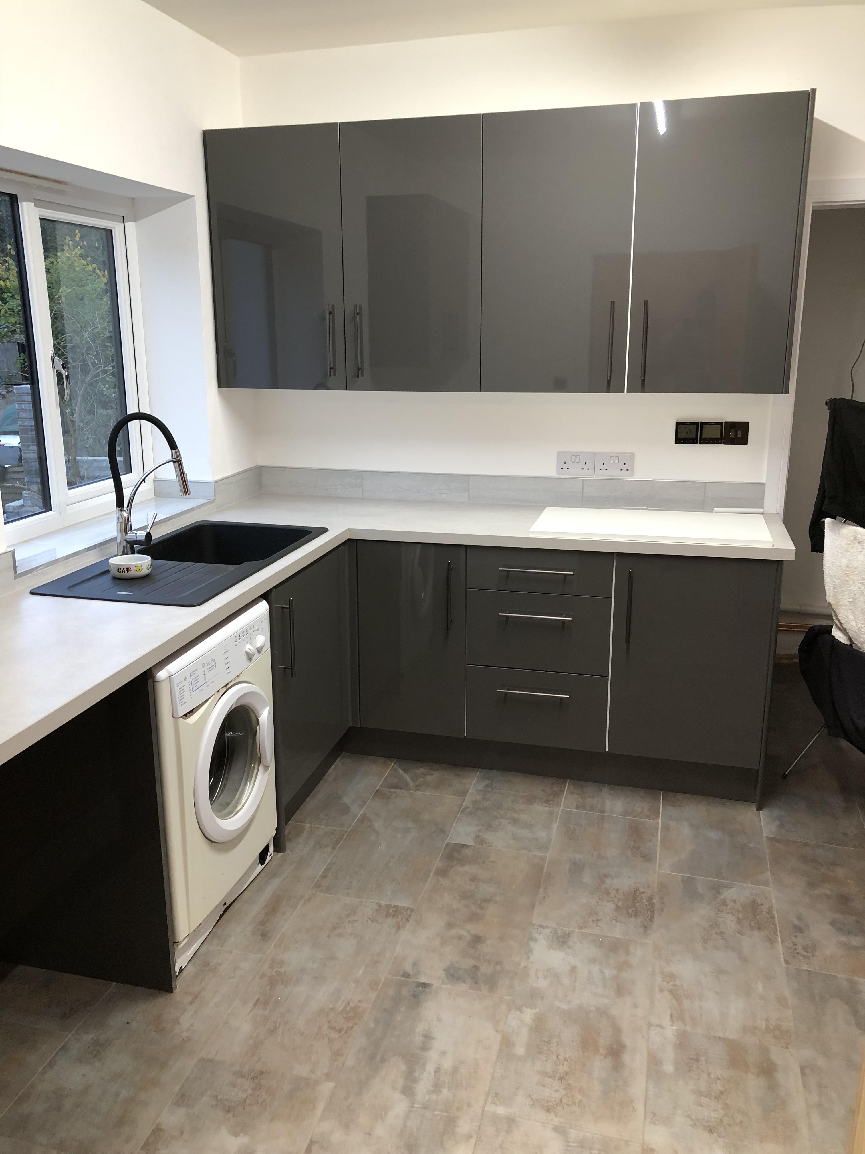

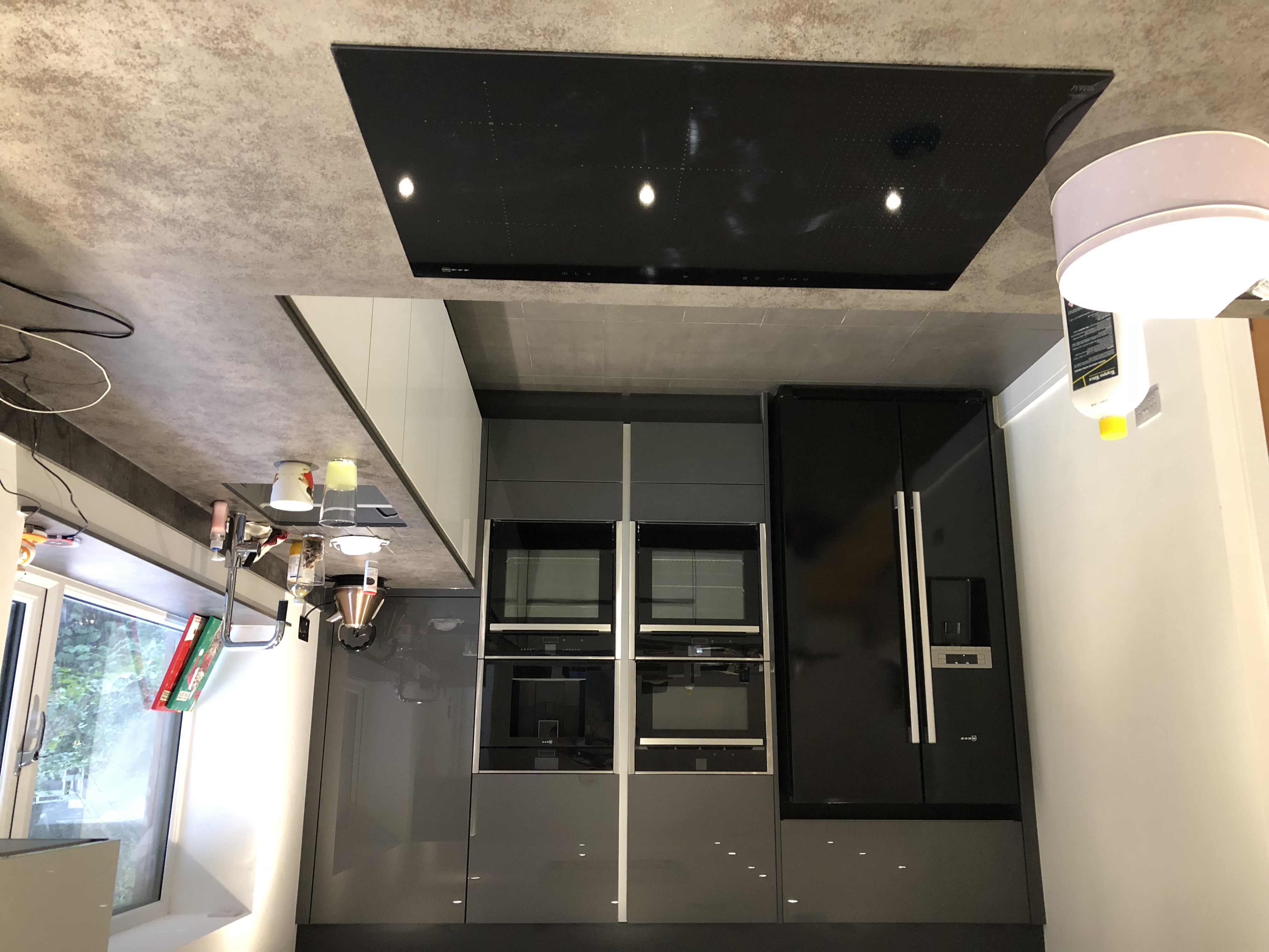

Thank you, I was trying to think of a way to explain how we’ve gone about budgeting for our finishes. And I think you’ve nailed it with “Sweet Spot”, there is obviously diminishing returns as you go above a certain price point for things, even more so when brand names get thrown in.  @Ferdinand I think you can probably understand what I am getting at and can probably summarise it in to a useful post for others better than I can ?

Still think your dog is the best thing though, so lovely :D
He is a beaut! Currently trotting from spot to spot trying to see where the best place to lay and snooze is.
Basking in the sun from the balcony doors is currently winning...

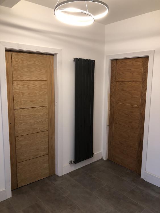

I think that a few lessons that i can pick up from this in achieving a lower build cost - but please correct me where I am wrong.
1 - I think you have targeted a spec at well-above-average, but not quite as ambitious as some here (ie Very good performance, but not 'the full passive'). I wonder how much is added by the "last mile"? Was there a big saving from going 2G not 3G? (Guessing - 25k) What was the spec of your walls / roof / floor?
2 - The build method is quite traditional - block and render / clad, and block and beam floors. Easier to find builders and quotes?
3 - There is an absence of specialist envro-hardware - eg solar panels. I think you seem to have just left out a whole lot of things of things that weren't strictly necessary.
4 - Careful use of relatively inexpensive materials that look very classy - the Howden's doors are brilliant, and aren't those tiles in the ensuites the Wickes 'slate' and 'grey mist' special offer ones I have been looking at all summer without needing any at present?  I can only see one thing that you have obviously spent a lot of money on in addition to the kitchen, and that is the flooring.
5 - Do you have good contacts to get those labour rates for specialists? My labour for a 75-ish point rewire on a 65sqm bungalow came to about £1200. And we made it easy for him because everything was exposed with very little chasing.
6 - Very impressed with those Eurocell doors. I will remember that. The cladding also looks like quite a find that I for one was not properly aware of.

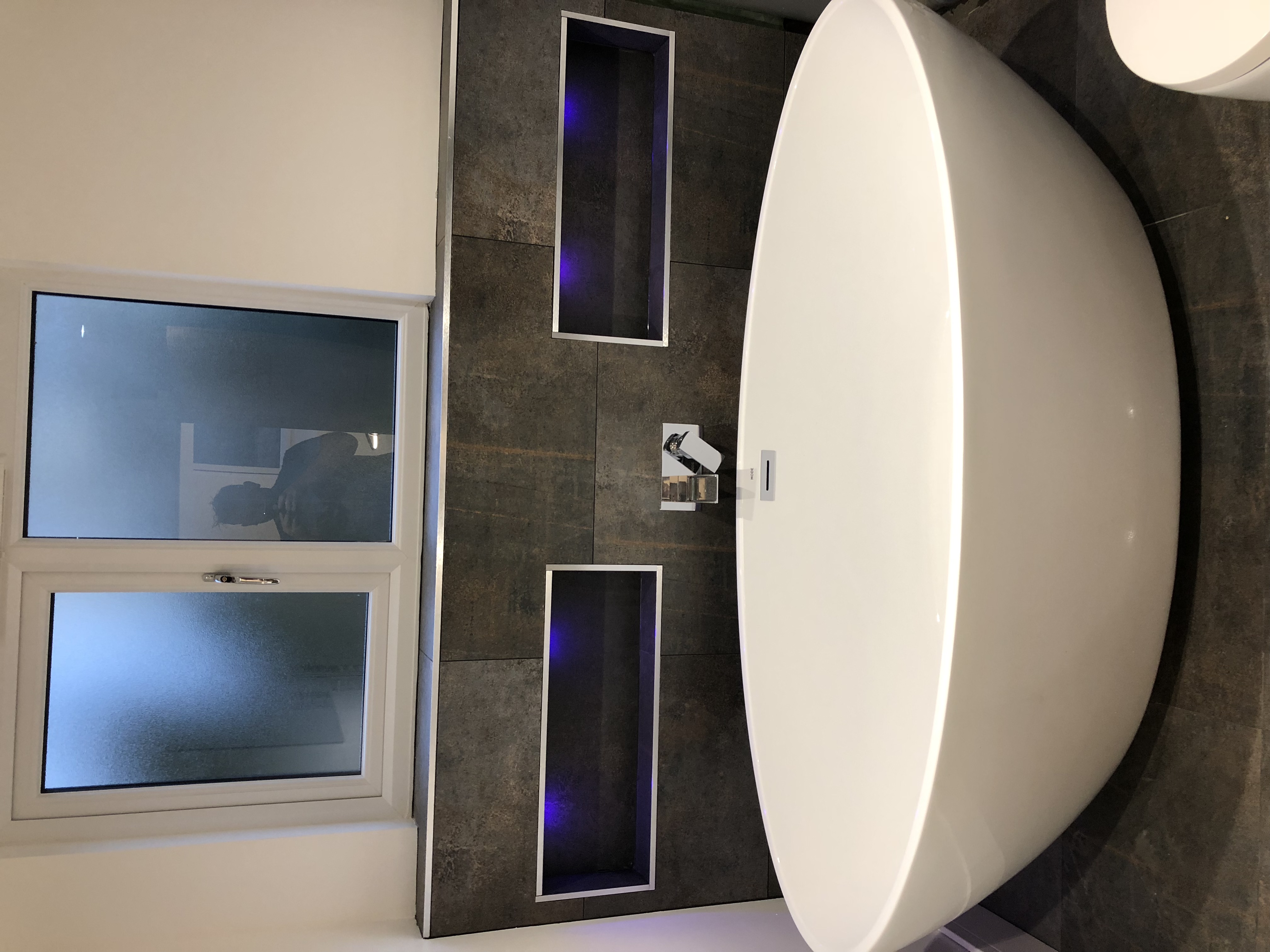

Questions:

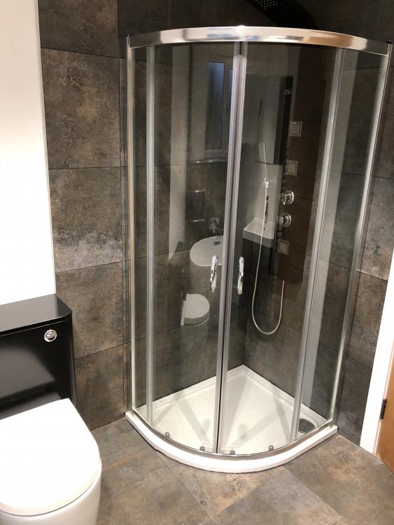

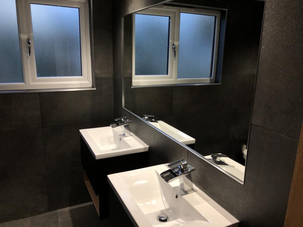

What did you do with your Jack-and-Jill bathroom in the end?

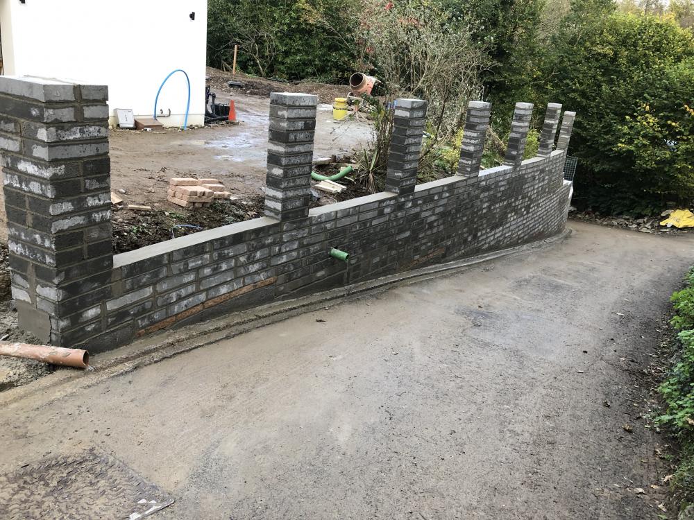

What is that driveside retaining wall made from? Looks interesting.

@Ferdinand
A little history on how we ended up here which may explain the outcome. I’m 31, this is only the 2nd property I’ve ever owned. The first being a shared ownership flat I bought 3 weeks before the recession hit and 8 years later I sold for less than I bought it for.  I had a 5 year sharesave plan with work that was due to pay out in July 2016, I had made a good profit on it and the amount was enough to allow us to leap the property ladder a bit, looking around we couldn’t find anything we wanted to purchase should the money have been in our pocket. Anything we did like was way out of our price range £300k - £350k. We saw this plot of land with planning permission for sale, liked the house and saw enough potential to change things to make it a home we could love.
So the brief was always to get my wife and I a house we simply couldn’t afford, in size and spec. The planning permission was originally submitted in 2000 and was reapplied for several times, so many things were not included that may have been part of it had the design stage actually started from 2010 onwards.
1 - Passive house or any particularly environmental facets were never really considered, MVHR wasn’t part of the design and I wasn’t even that aware of what it was until I was well in to the build. I had brickies on site 3 months after completing the purchase of the land, so there was no dwell time to consider things like that. Remember the brief above, we NEEDED a house! I did quickly look at solar panels, but the capital expenditure just wasn’t an option we had.  Briefly read up on 3G, again was disregarded due to cost, although I can’t remember what that was now.
2 - yes traditional block built house, trussed roof. We did consider block ground floor due to retaining wall and then timber frame on top but due to access issues and overhead HV power cables a crane was unlikely. Plus the 3 little pigs came to mind and I wanted a house made of bricks! I got 3 quotes for the watertight shell and all came in around £75k - and the end my chosen builder did say to me he believes he underquoted by approx £10-13k, so it could be argued that this cost should be factored in.
3 - as above the build is on our absolute limit of affordability of capex, however we do have a reasonable monthly income between us - may sound daft but I can afford a monthly gas bill more easily than I could £10k for a heat pump (this may be an age related perspective ?). If we added in many of the features that people here like to include the house would simply not have been an option to us. Either make it smaller or go back to the drawing board and pick up associated architect and planning fees - none of this was an option.

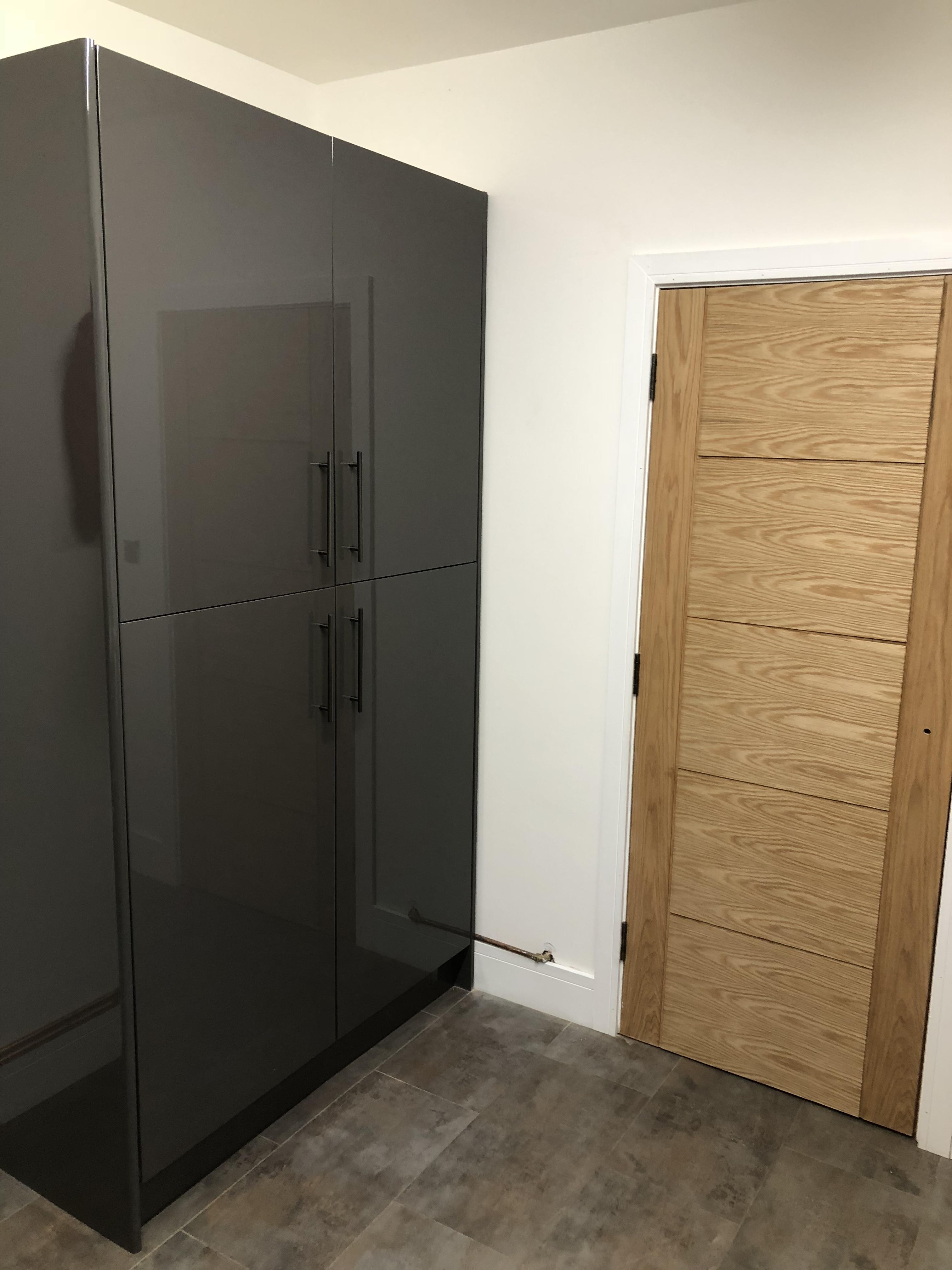

4 - Doors were Travis Perkins, £90 for a FD30 and £70 for a standard door, this was well under budget and proved to be a big cost saving on what I had expected. Flooring was £42/m2, so a reasonable cost, I think the wide board again makes it look like more than it is, link posted in a previous comment. The grey floor tiles in small en suites are indeed Wickes, the grey wall tiles are from TileMountain.co.uk @ 9/m2 and look much better than that price. The large format 900x450 black tiles were also from tile mountain and were only £25/m2 they don’t photograph well but look great in real life, a kind of rusted iron look to them with a slight sheen/glimmer that really shows off when wet.  The tiler thought they cost me £60m2 upwards and couldn’t believe what I paid for them.
5 - Labour. Electrician was £3500 labour only, he used my site as a “hospital job” doing a couple of hours on odd afternoons when other jobs ran shortness or cancelled, or on Fridays when he wanted to finish up close to his home. I pestered him to ensure he always stayed ahead of where I was and his slower progress never ever impacted anything I needed to be doing. He was an acquaintance already and we ended up with a good working relationship. For example it took him about 4 months to complete first fix 100% but as I say this never mattered as any room I needed to board or progress onwards was always completed.
- Plumber - friend did boiler room and snagging of my work for £1000 all in, this figure came about as I told him I only had £1000 for plumbing labour, so that was that. I did all first and second fix myself.
- Plasterer / Renderer - £6000 labour only for external render, internal scratch coat and skim. Cousin of mine so no other quotes were obtained because I know his work his top quality (he works on a lot of the ridiculous houses being build in Rock, Cornwall - Gordon Ramsay’s place included). I probably did get some mates rates here but I don’t actually know to what extent, 4 plasterers on site at one point who I didn’t know so they all had to be paid out of the total.
Tiler - £160 a day, my advice is don’t be afraid to use day rate, if you trust the tradesman you could both end up with a better arrangement. When you ask someone to quote on price you are offloading the risk and paying a premium for this, my advice here would be to de-risk the job as much as possible yourself then get some one in on day rate who will be happy to do a good days work for a days pay.
Joiner - £100 a day, this was a bit of luck on my part. Skilled joiner had some health issues and couldn’t drive at the time I met him, was getting himself back in to work after an extended sick period so was willing to work quite cheap. At first I was picking him up each day but he got his licence back during the build. I’ll agree this probably saved me a fair bit, I’ve had him here working for the final 4 weeks.

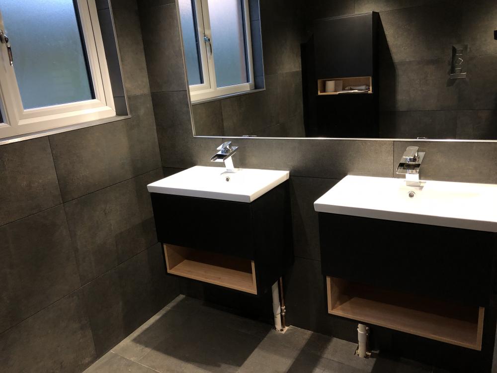

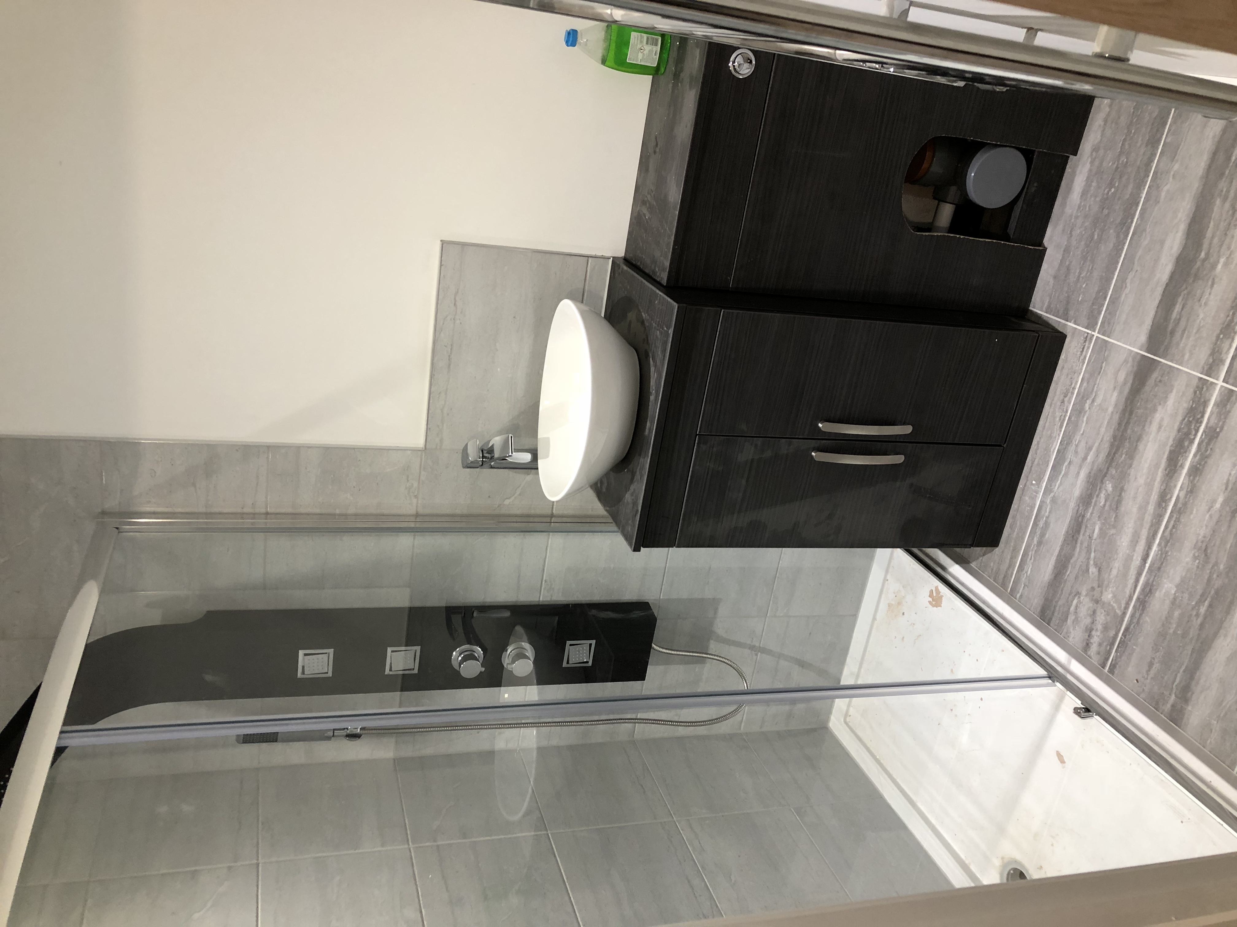

Ah the jack and Jill bathroom - I think my first post here which I remember your good self replying to offering advice. Well we took it and now have 2 separate bedrooms with 1.8 x 1.5 en suites, 1 with 1500 Bath 1 with 1500 shower. It’s the ones with the light grey tiles. Much better than the jack & Jill so thank you.

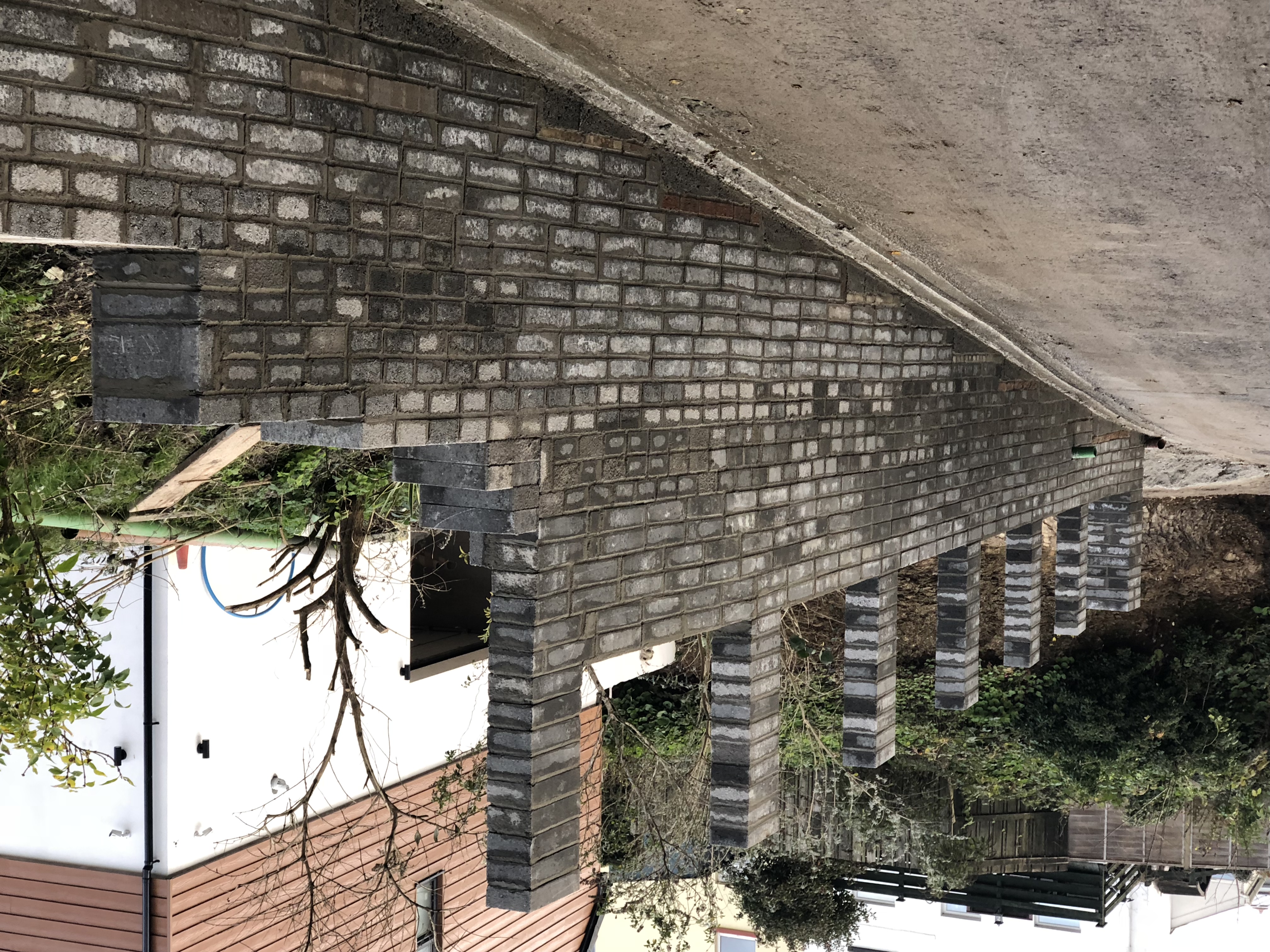

The drive retaining wall is just standard blockwork, only completed the day of the photo so still very green. Further down it will transition to Gabions to keep costs down.

Good to see that the various suggestions on the Jack and Jill worked.
Do you have a link to those hitech looking showers?
