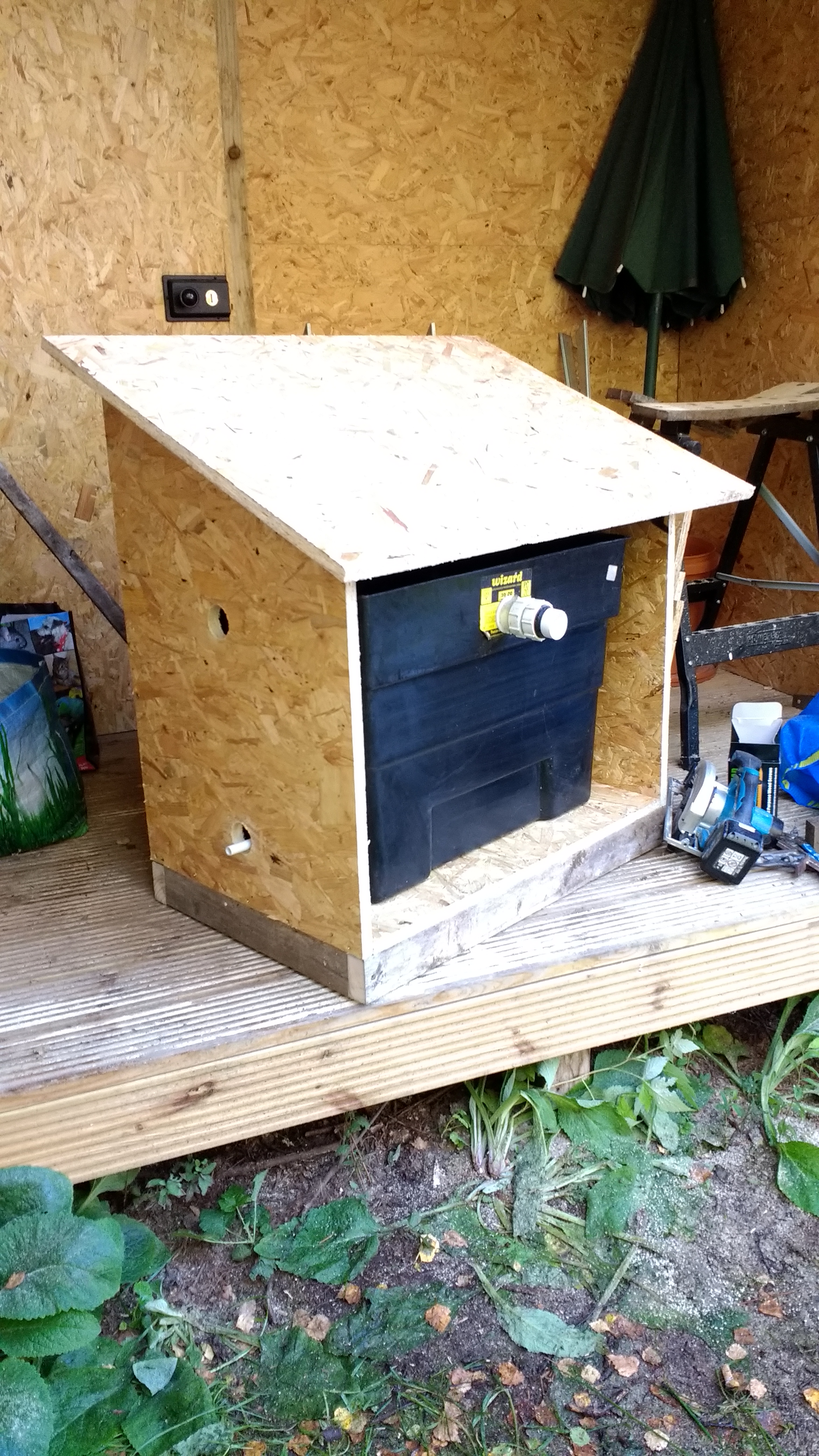

Two years on from starting the hut I'm fitting a gravity water system...I have a wash hand basin in the toilet and sink in kitchen both of which have taps. I connected the waste pipe ages ago which drains to the soak away but never go around to providing the taps with the one thing that kinda makes them useful!
To be honest the hut isn't in any way uncomfortable to live in. We have a standpipe less than 30m away and just fill up 5l water bottles for drinking and washing. However, I've got some free time and good rioja so why not go and play around up at the hut?
I'm putting this tank on some posts made up from small tree trunks, against an outside gable wall. This is case of bursts caused by freezing if I (or a less thoughtful wife or teenager) forget to drain the system between visits in winter.
First made a box for the second hand tank someone gave me.
The hole at the top is for a garden hose which I'll fill from the standpipe...will know when it's full when the overflow indicates ?
Bottom pipe will feed both taps. I'm teeing off just under the taps and connecting to both hot and cold. Whalah we should soon have some slow running water for washing...not much need for that but most handy when brushing teeth. Don't like the toothbrush in a cup thing and not having a tap to wash away the spit.??
I'll post a little photo diary as I progress

A pump will give you useable force at the taps, and it'll be fresh clean water from a roll along butt. The fact it's a second hand tank also worries me, I certainly hope it's not an old F&E tank? Do you know what it was doing previously?
Not a fan of this idea, :ph34r: sorry

@Nickfromwales what's a F&G or whatever, it was formerly a loft tank and made of plastic...stored under a hut for a few years after being liberated from a semi.
It's got lots of spider webs and stuff inside??

F&E ;)
Feed and expansion tank aka a header tank for central heating. When you stick your head up your nans attic you'll see two plastic tanks. One is the F&E and the others the CWS ( cold water storage) tank. The F&E will have spent its life full of ferrous corrosion and possibly inhibitor chemicals ( which will kill you if drunk ) so best to be sure what your water will be sat in.
What size is the tank? A CWS will usually be 24"x24"x18" high or so and an F&E will be be around 12"x18"x12" high or so.
Link to comment
Nans attic...lol, stick your own head up brother?
It's a CWS for sure.

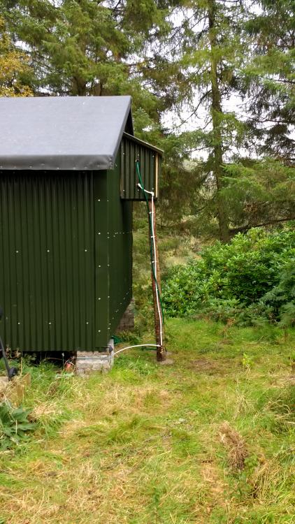

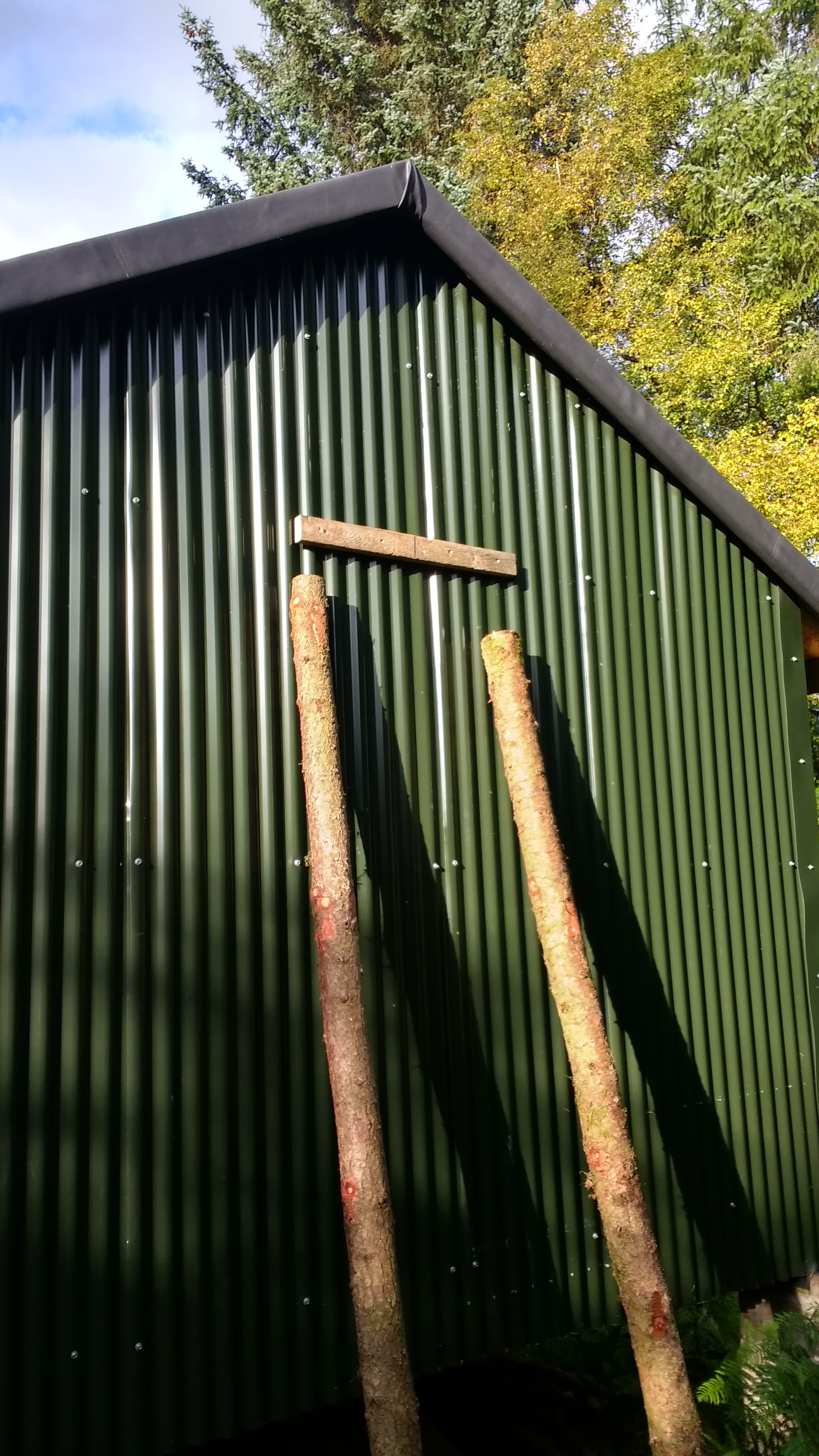

Not sure about my design to hold this up, it's a bit slap dash but hey ho it's not the Hilton.
This is where it's going...
I plan just two posts as the back of the tank house will be screwed through the corrugated tin to the gable wall.
Lifted it into place today and then realised the error of my judgement. Could not hold the box in place and get a screw in at the same time.
Used all my energy lifting the heavy box and was on the top rung of the ladder. Oh dear @recoveringacademic will give me a bollocking, had to push the box to one side while I jumped the other way.
Box survived intact, result! Me, just one little bruise but feeling a bit sore and stupid tonight.
Be careful out there builders...
  • Like 1
Link to comment

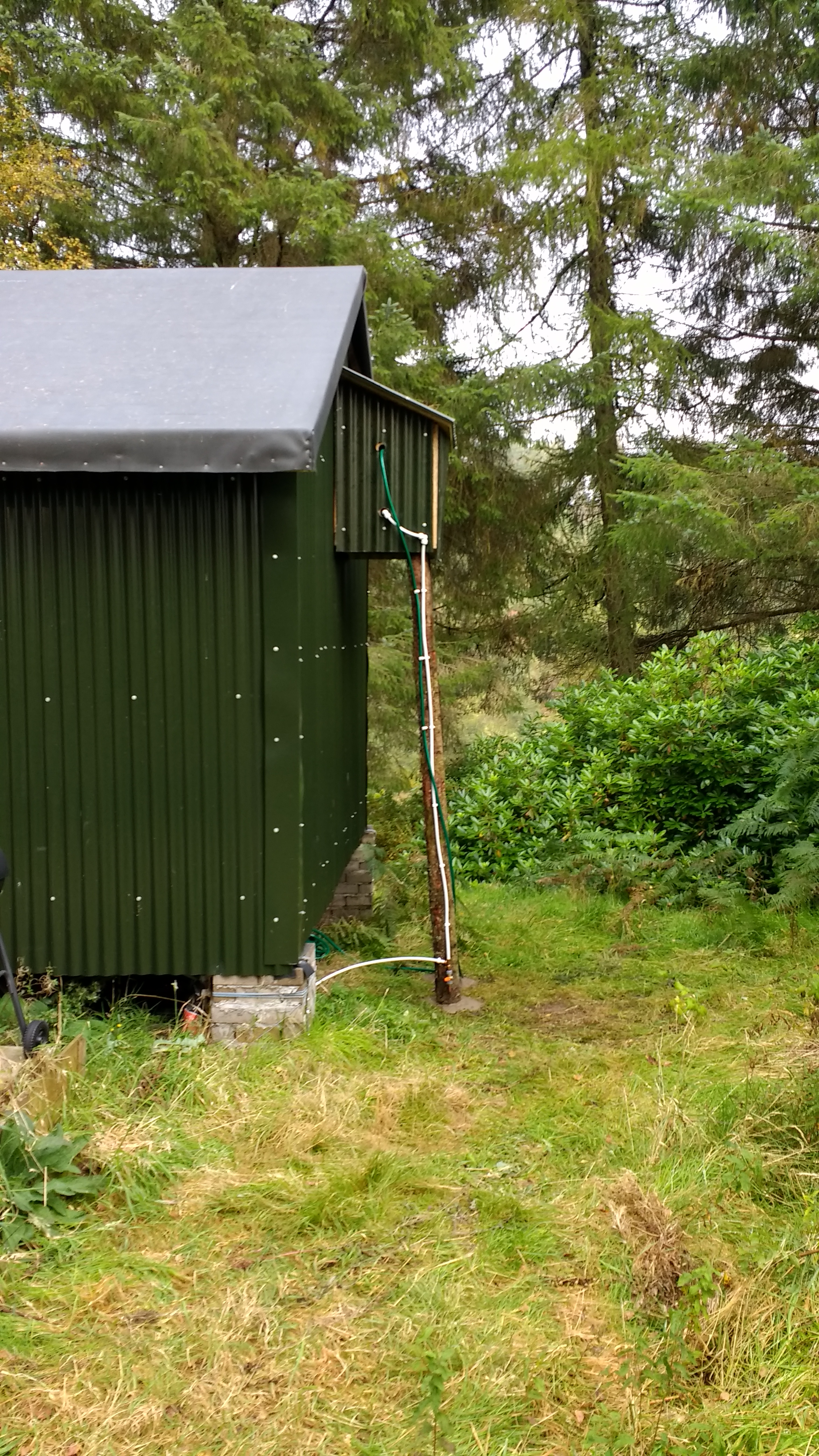

It works a treat!
Not great looking but I'll improve that and paint the pipe green.
All drinking etc water is still from bottles but wonderful to rinse dirty plates under the taps...oh how easily pleased I am???
