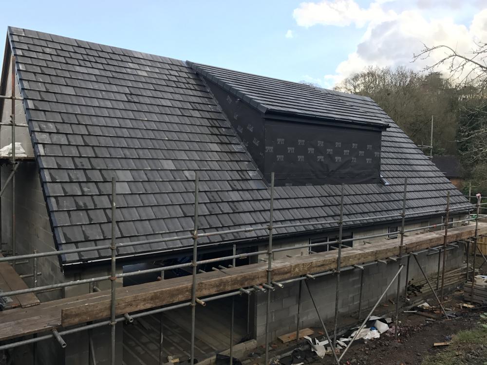

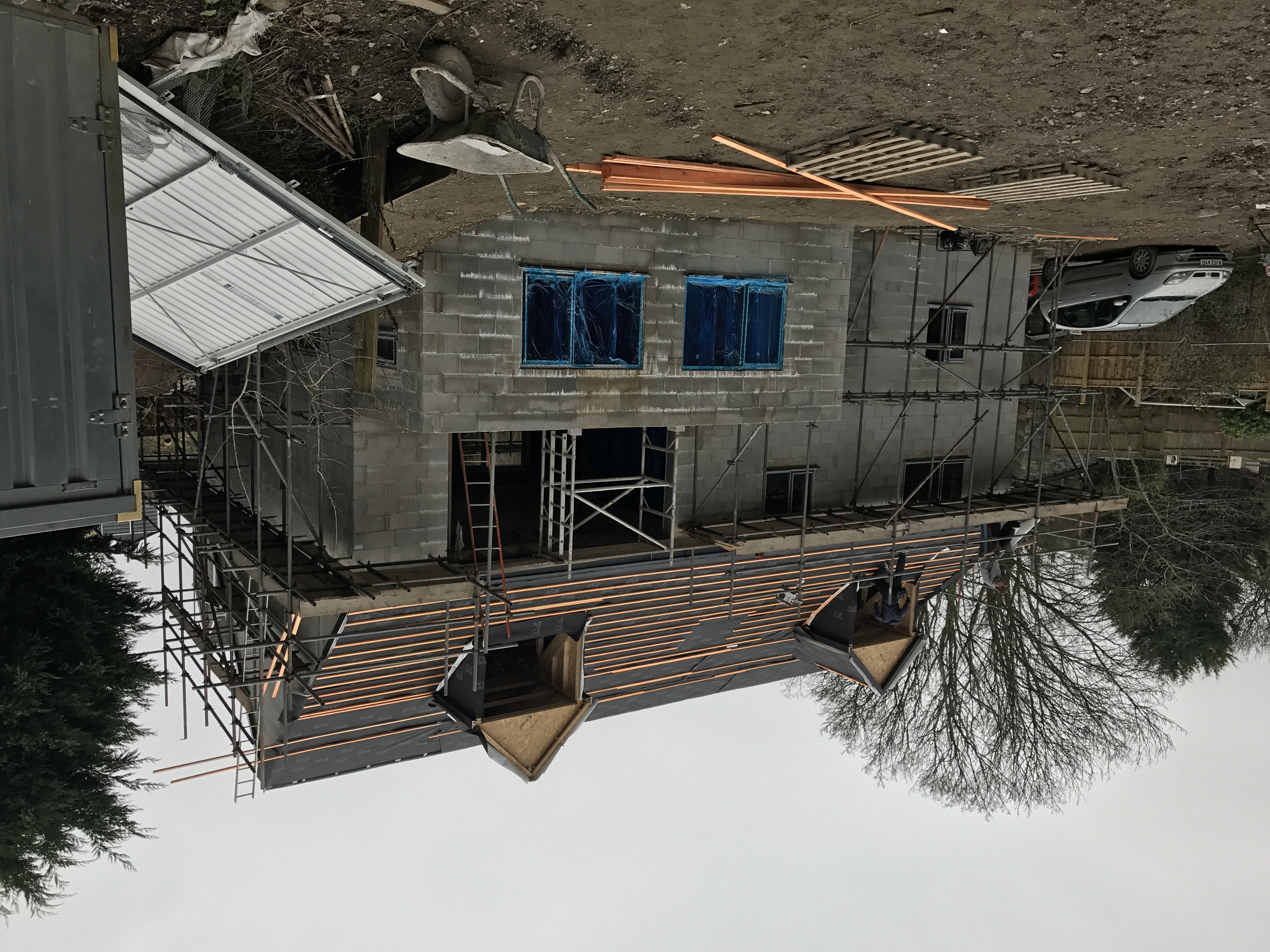

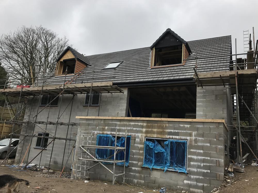

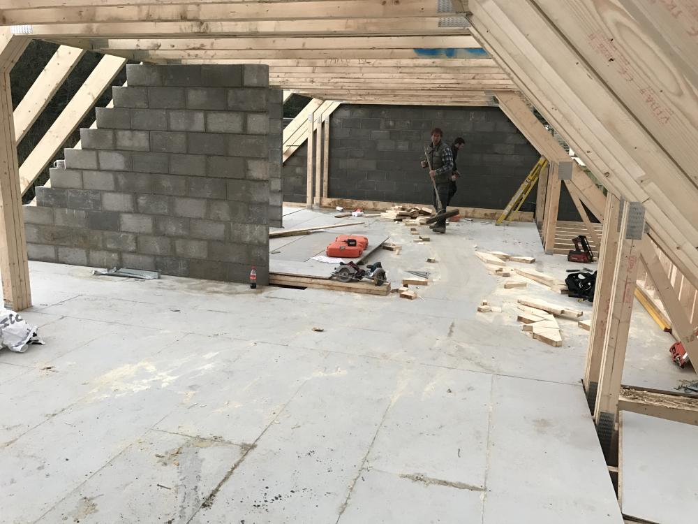

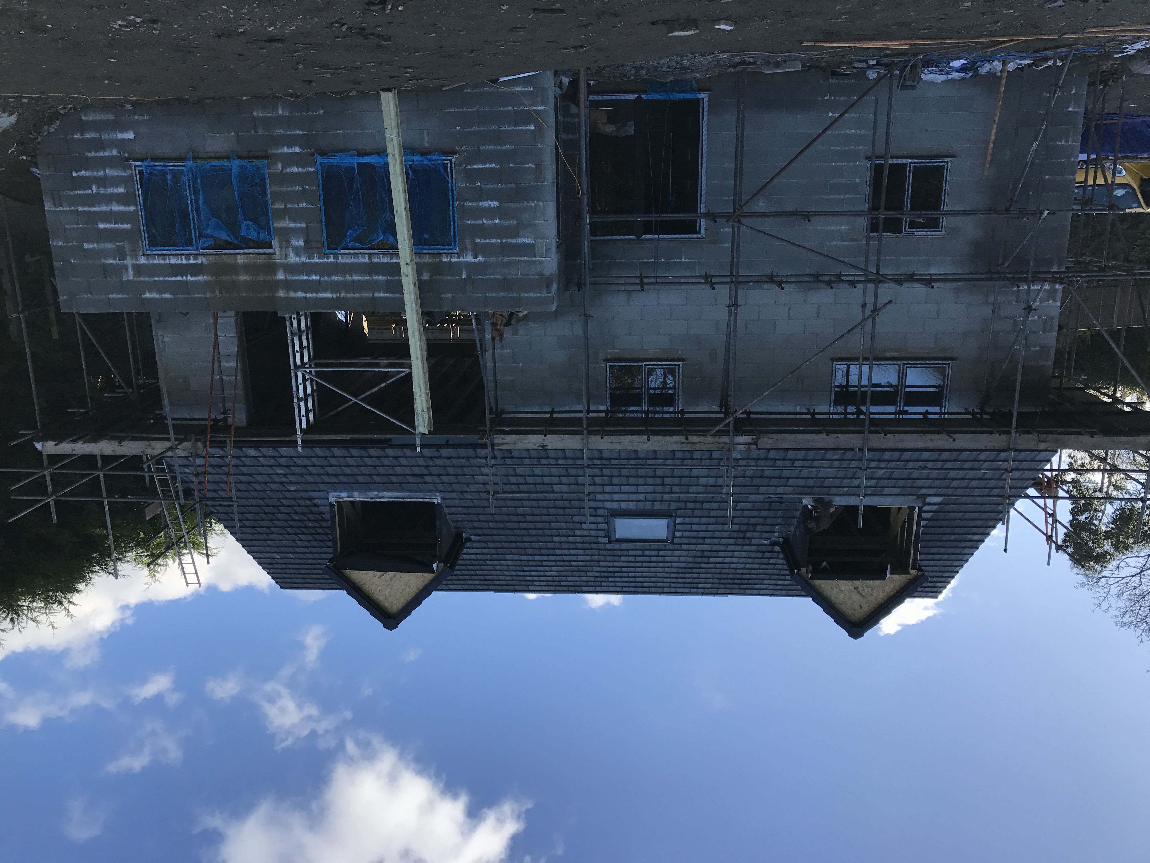

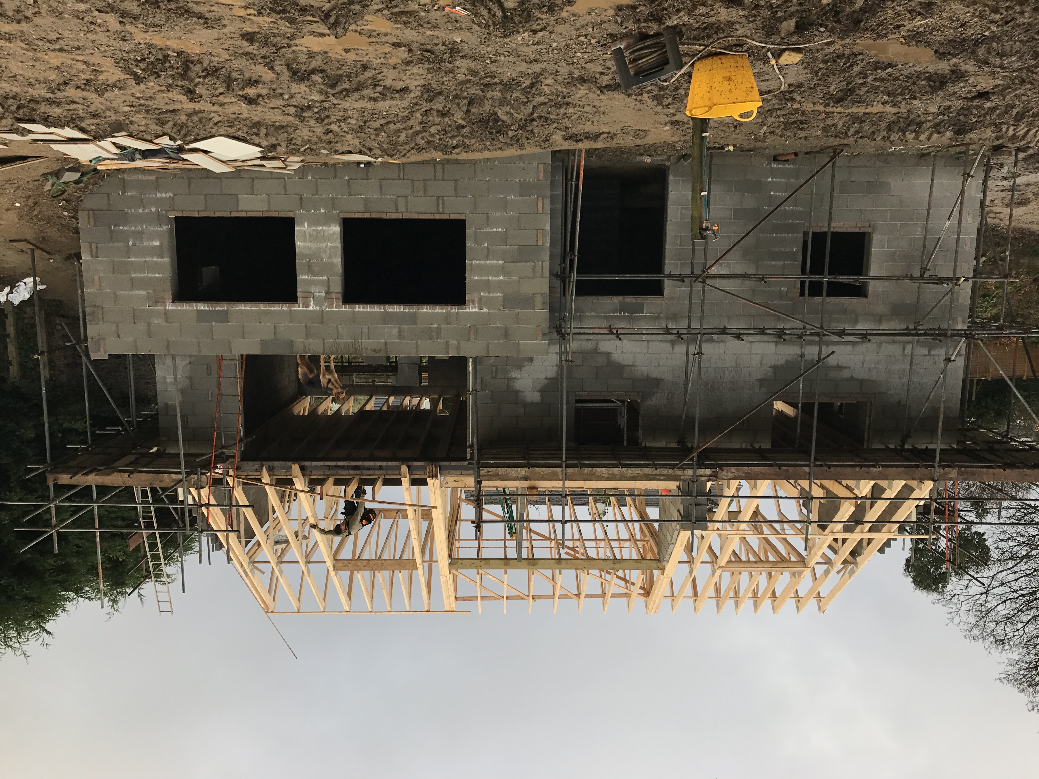

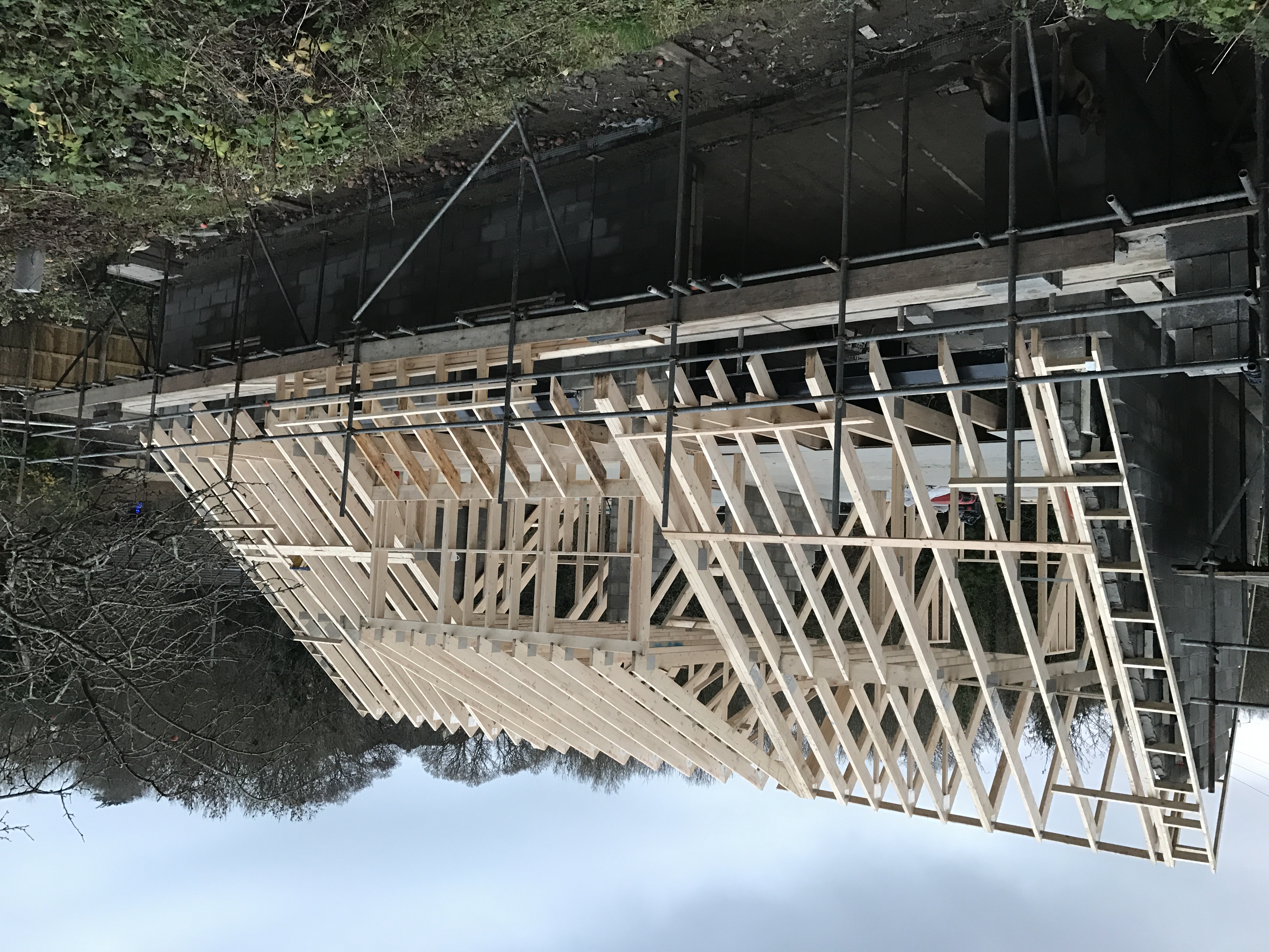

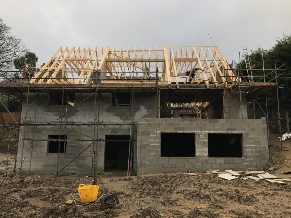

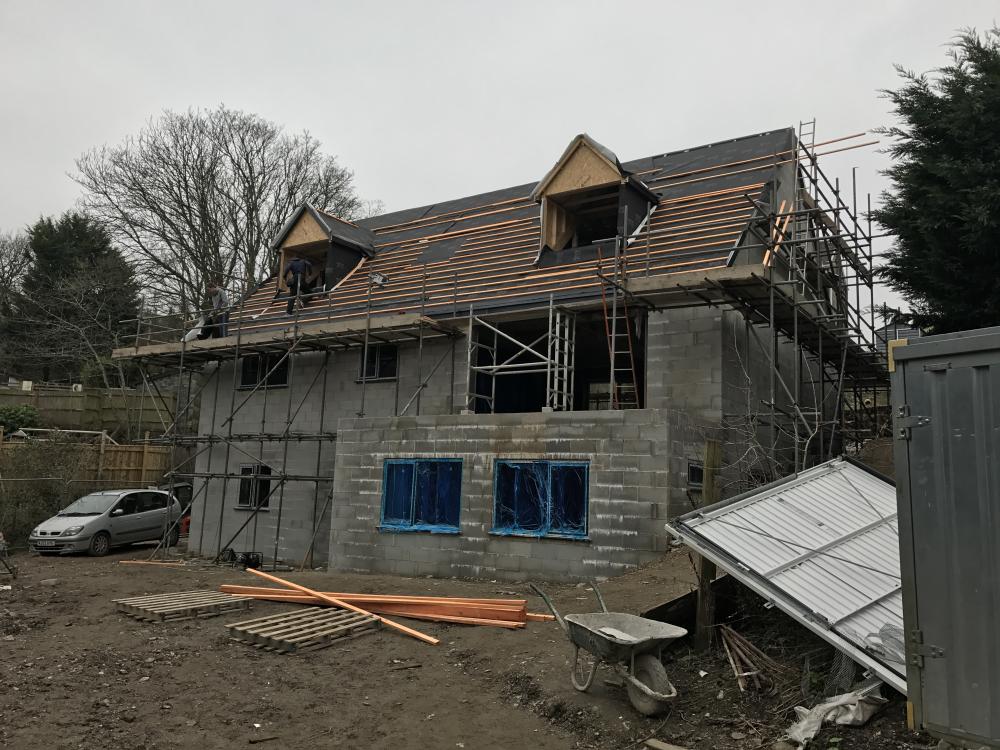

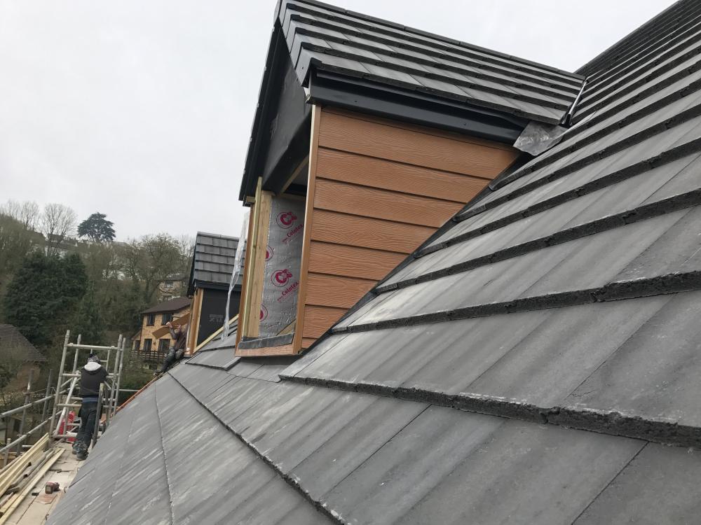

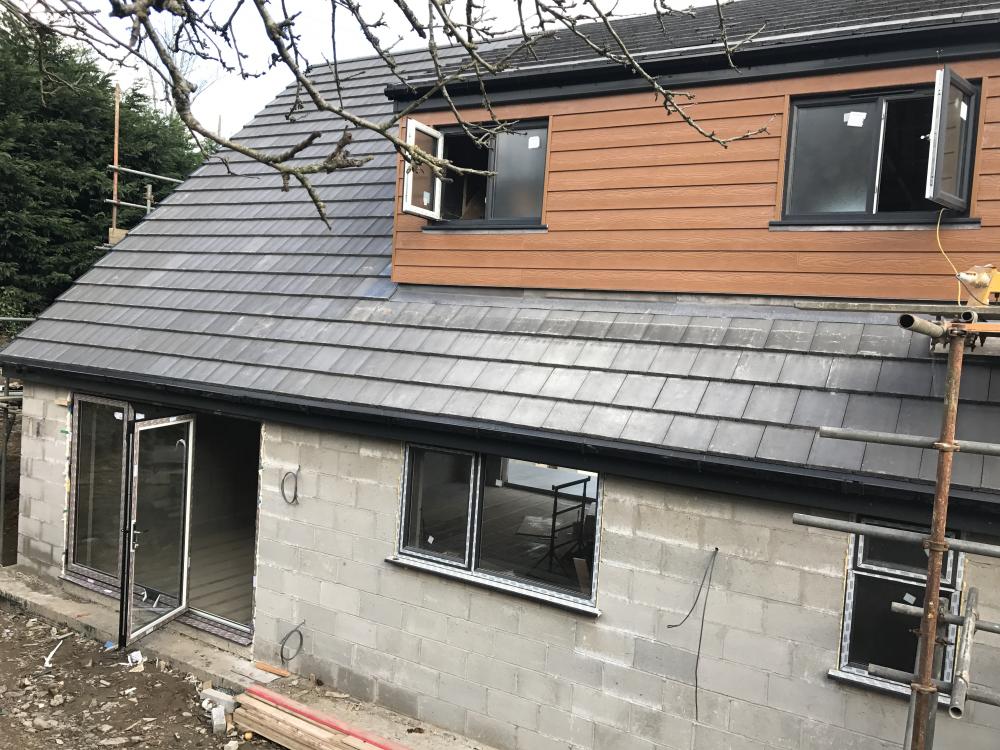

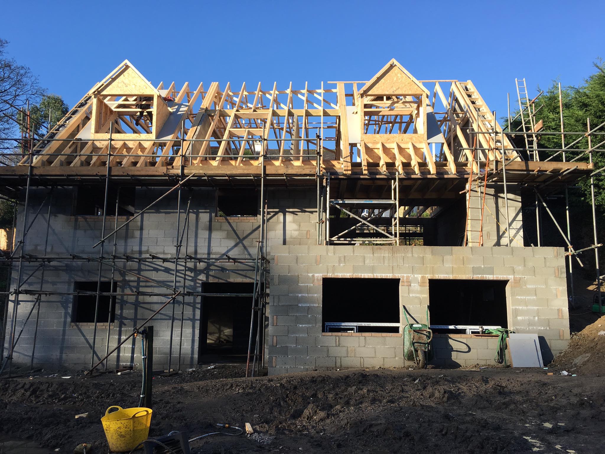

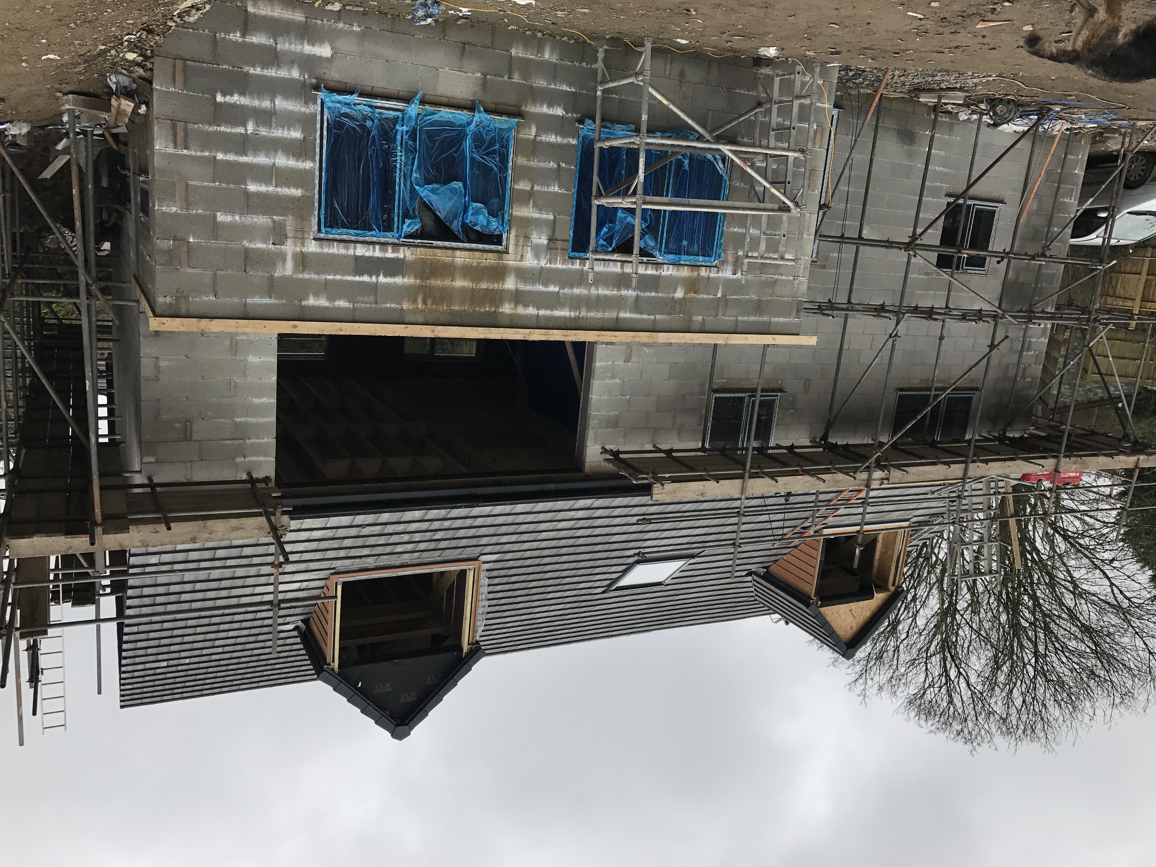

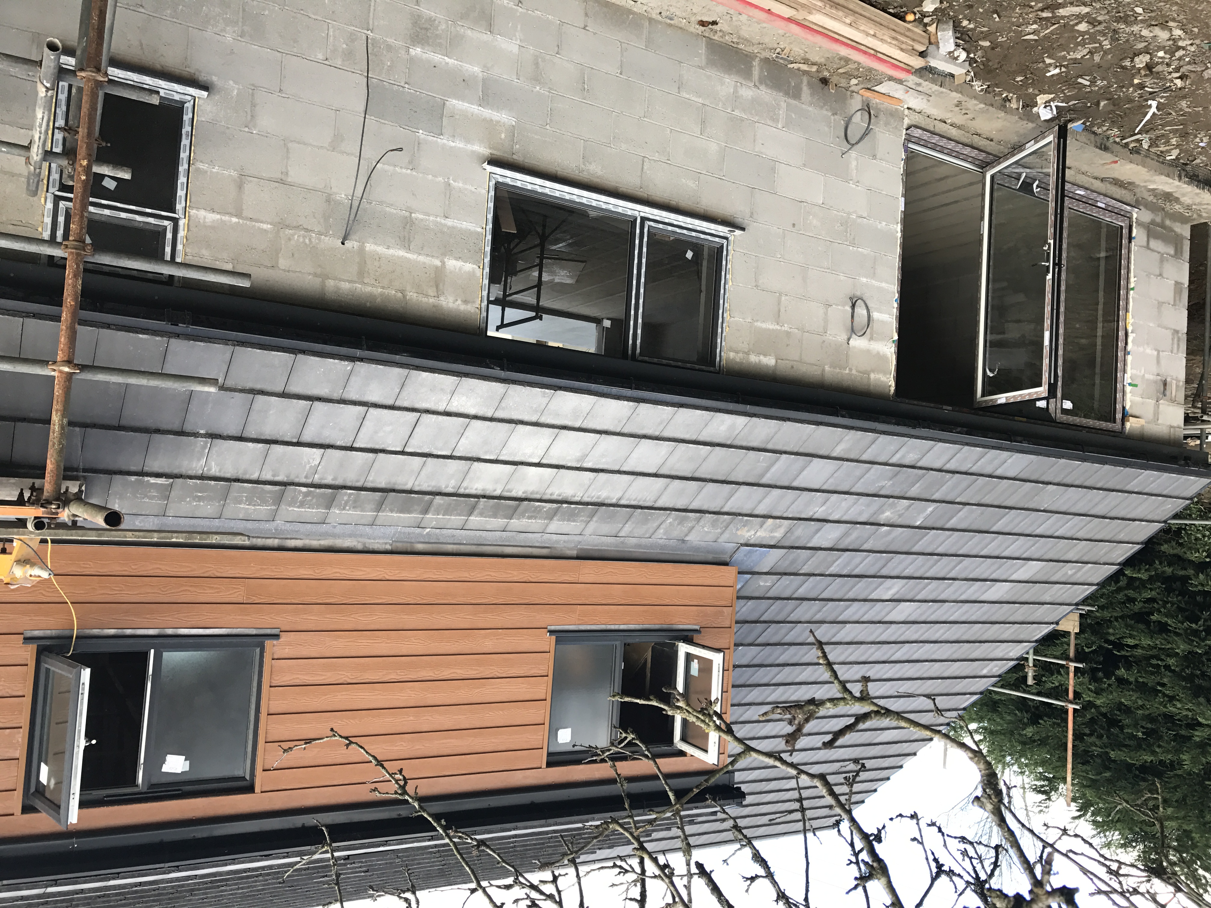

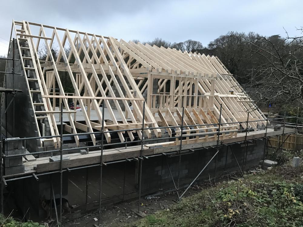

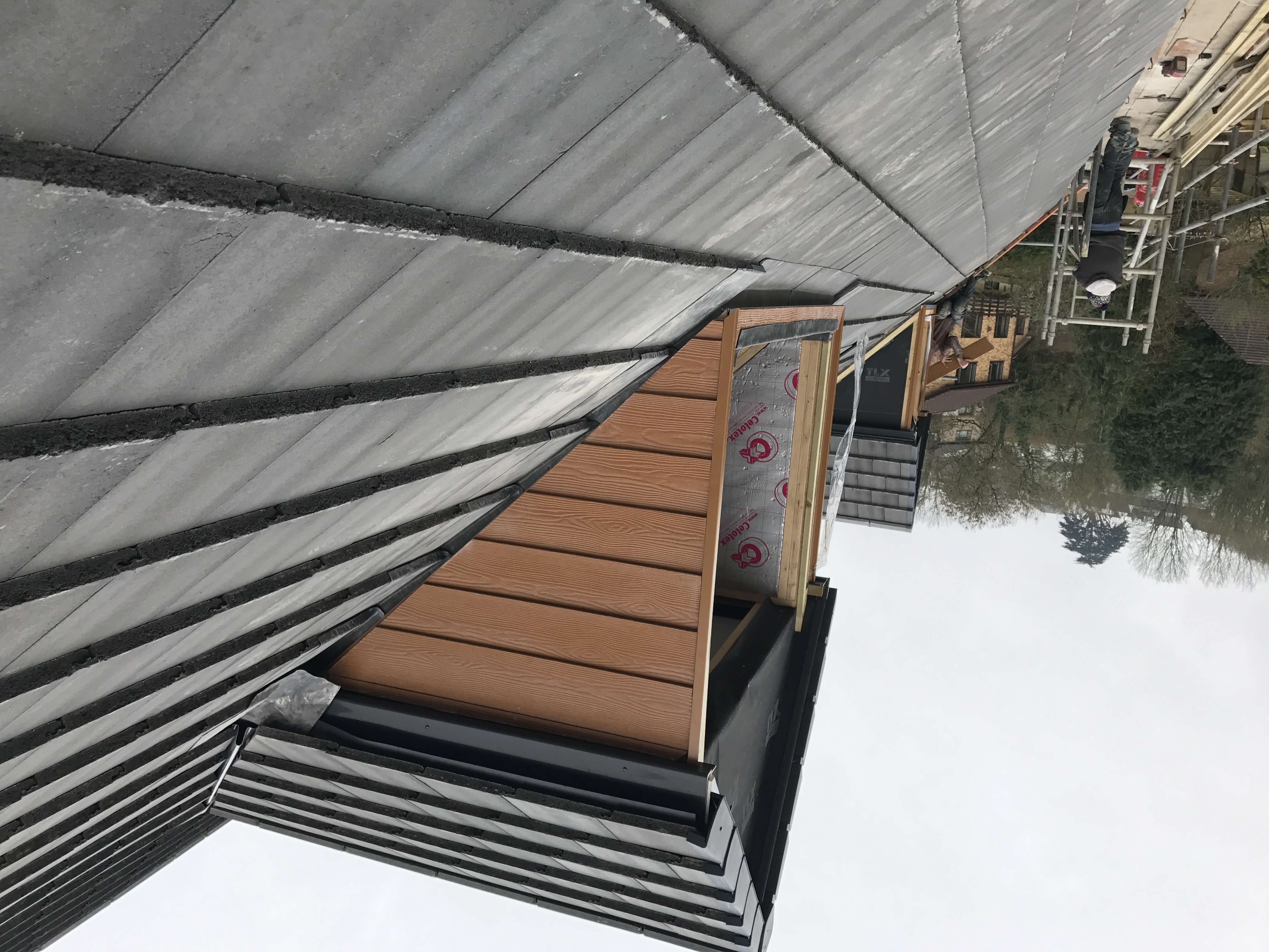

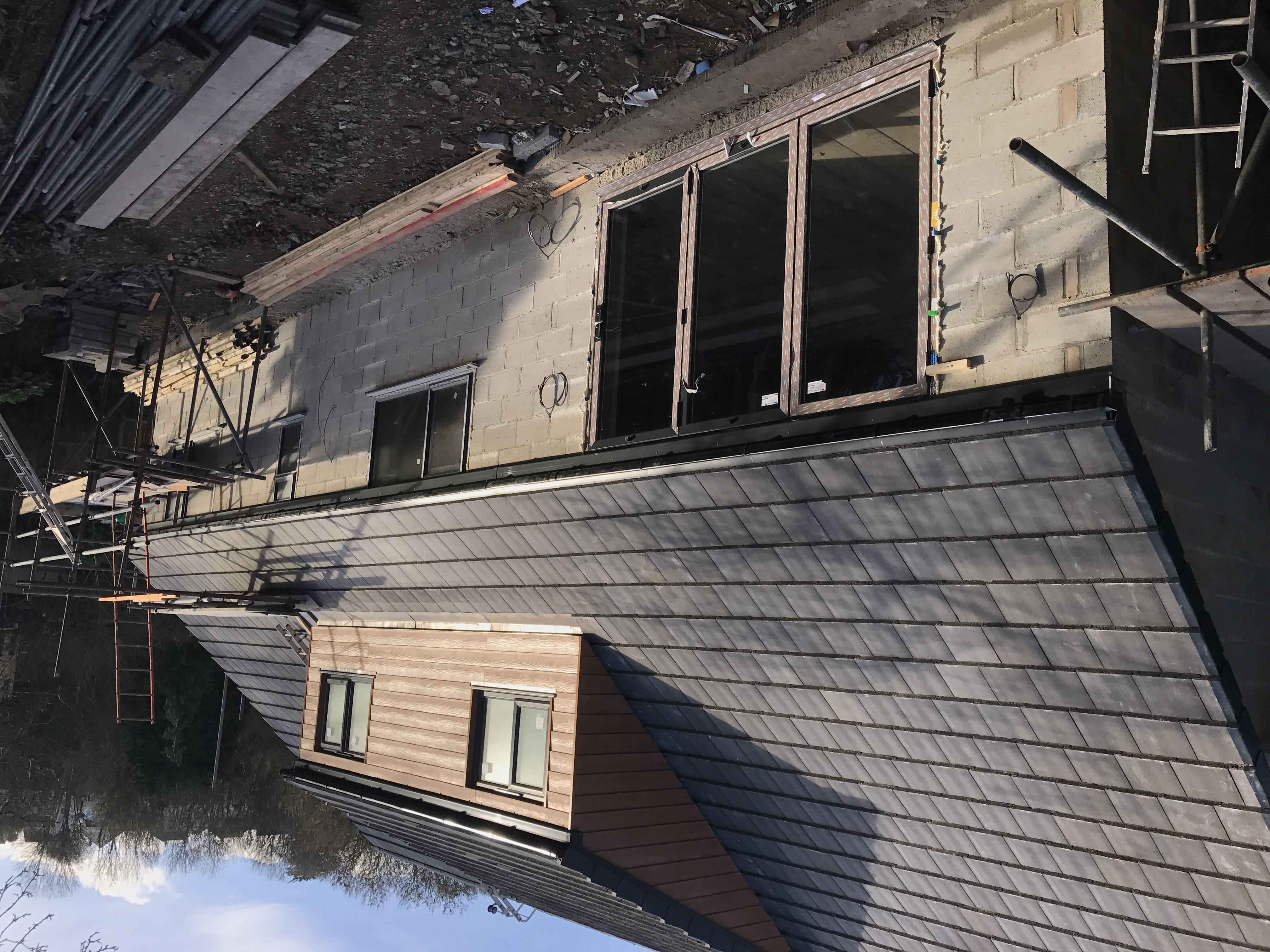

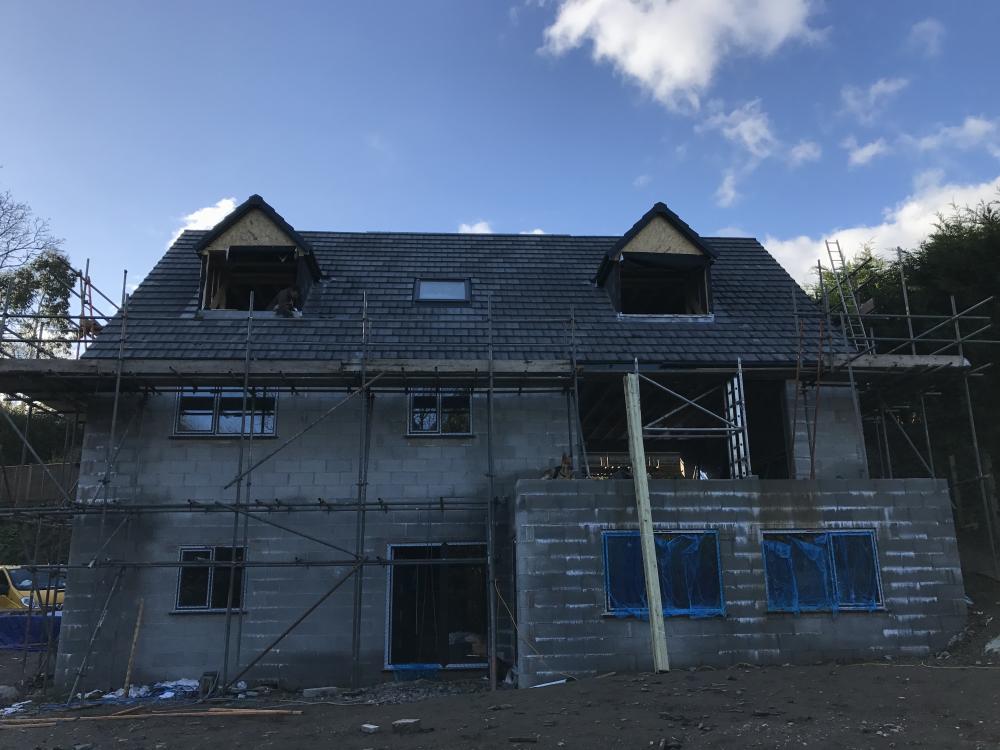

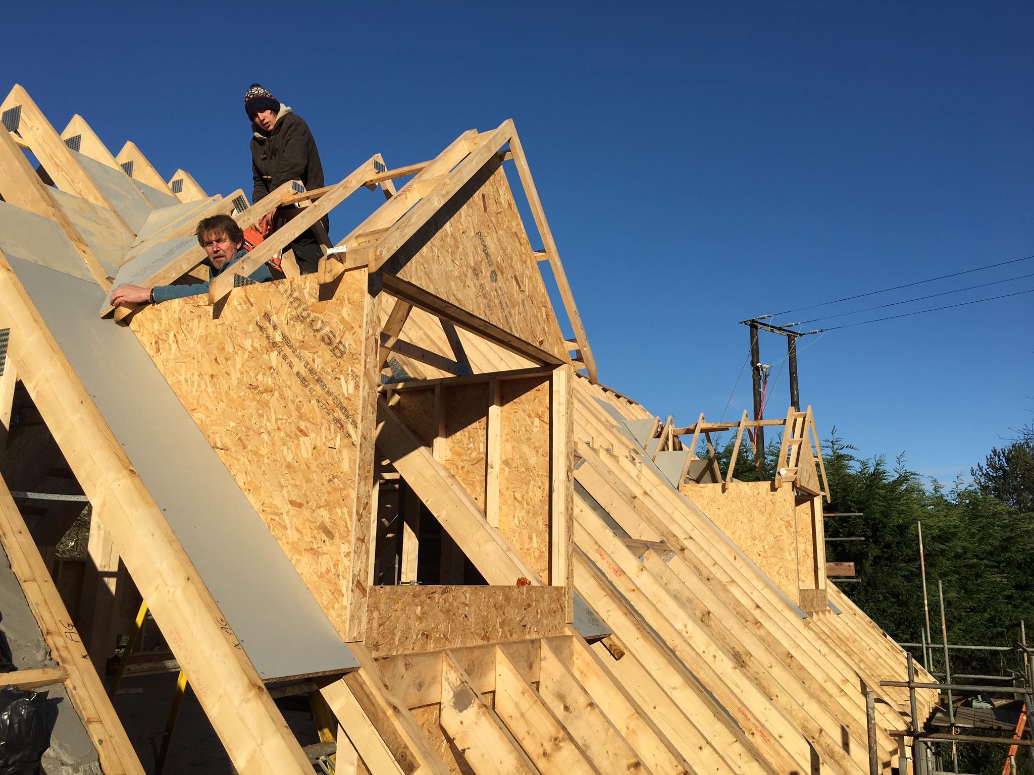

So I'm still here, plugging away. Apparently I have a roof that is constantly underestimated in terms of the amount of work required. Both chippies and roofers took weeks longer than expected. Still, all part of the fun!
Since my last update the cut roof elements were completed, dormers etc. Tiling was completed this Monday. I've insulated the loft. Marley Cedral cladding has begun in the past couple days.

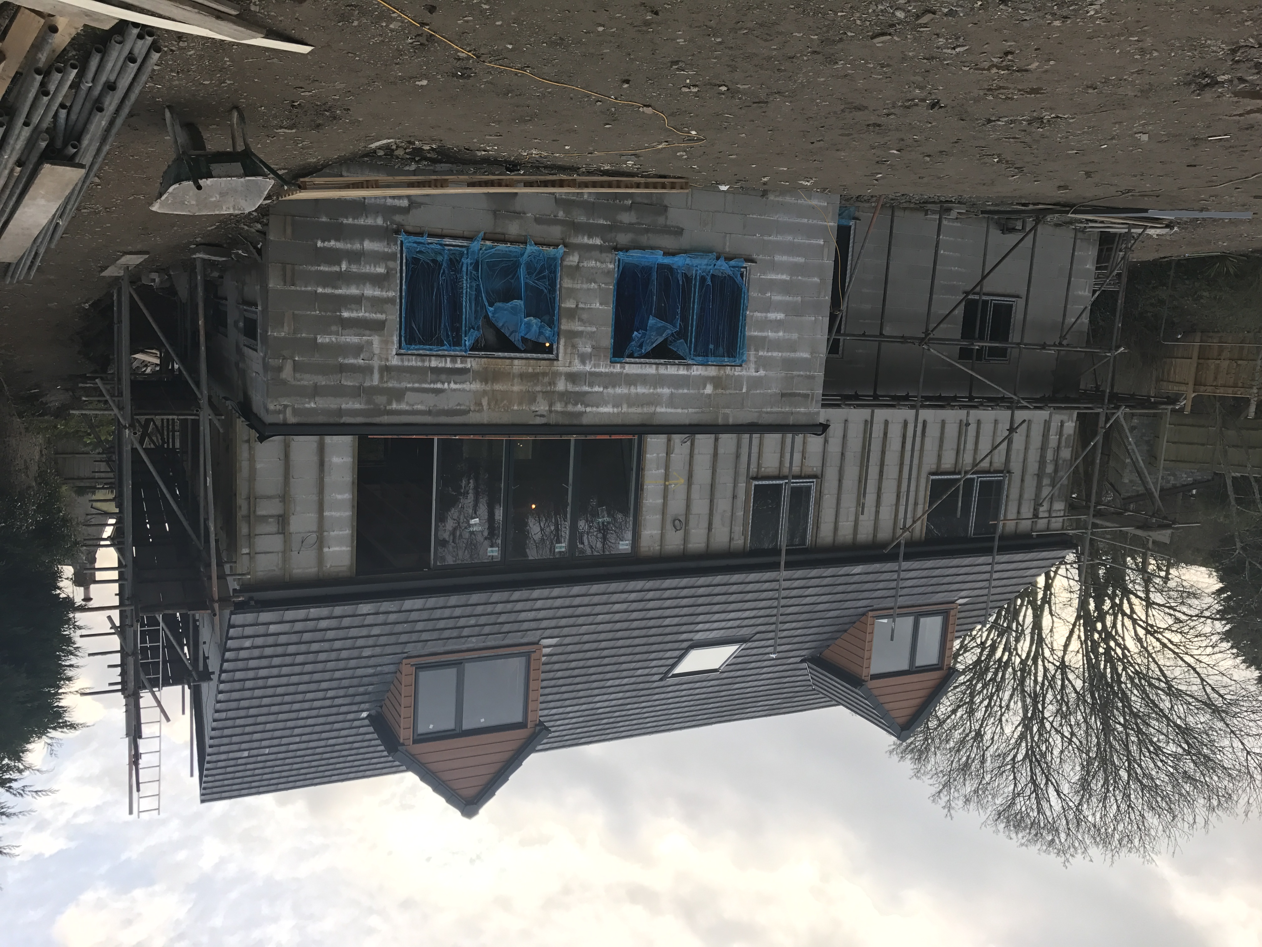

Next steps are for fibreglass flat roof to  hopefully be completed on the balcony on Monday, then rear bifold doors and front balcony Velfac sliding doors to be installed. I will then FINALLY be 100% watertight and ready to attack the inside in anger.
Few photos of various bits and bobs below.

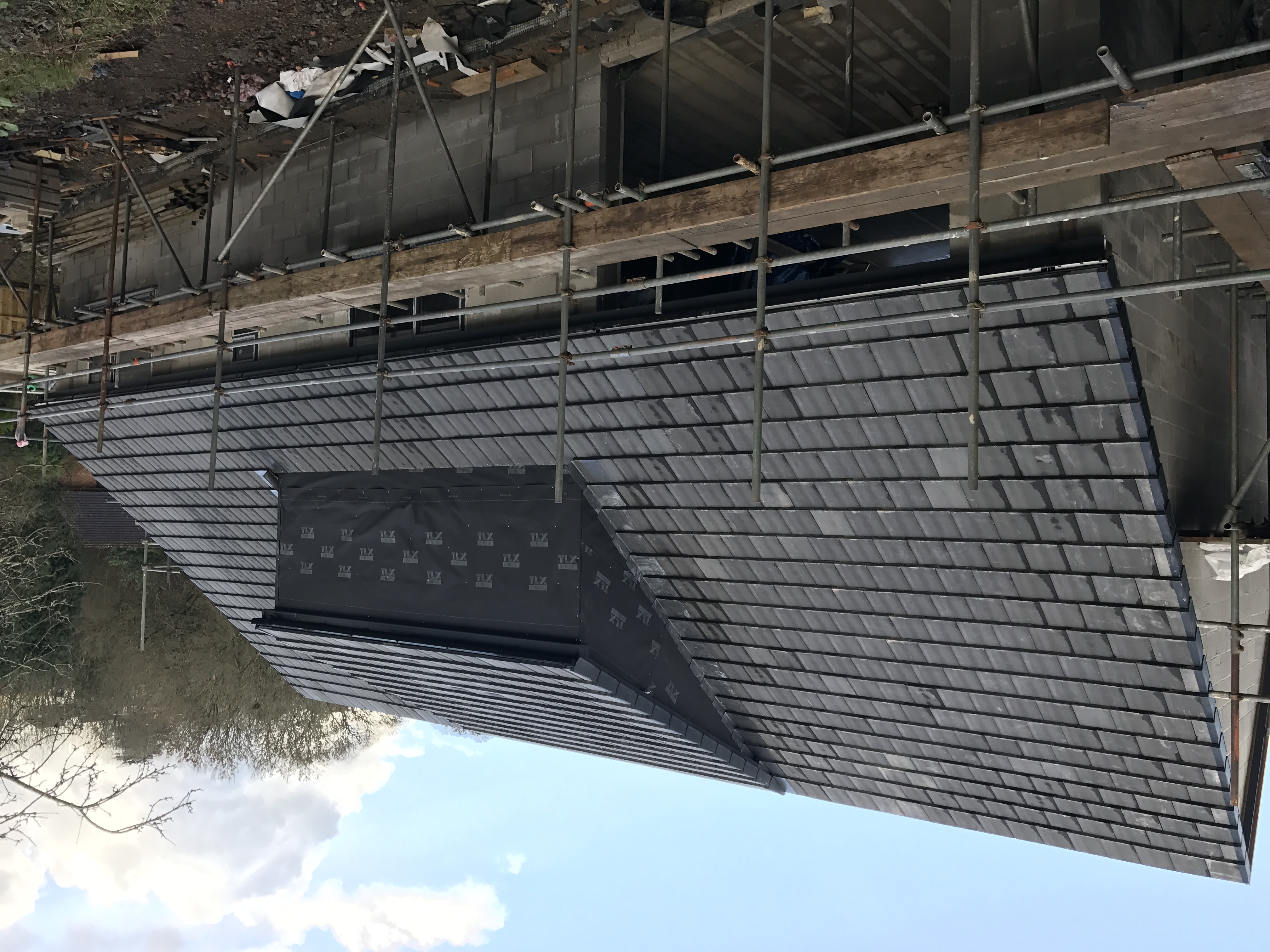

Oz07
Posted

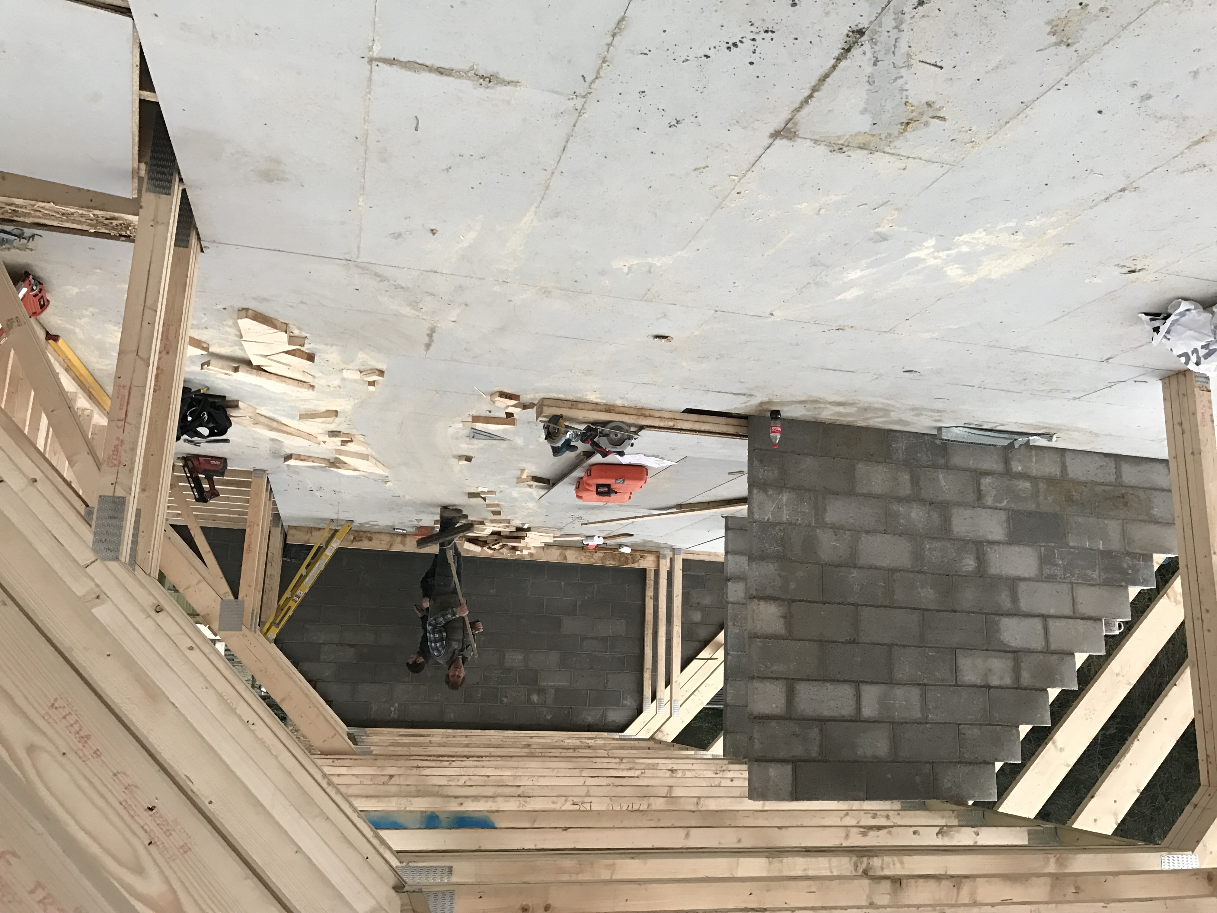

Look like they're enjoying the inset valley boards! Bit of a pain that job.

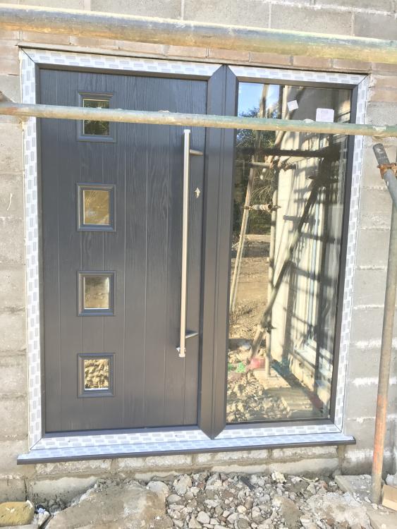

PeterW
Posted

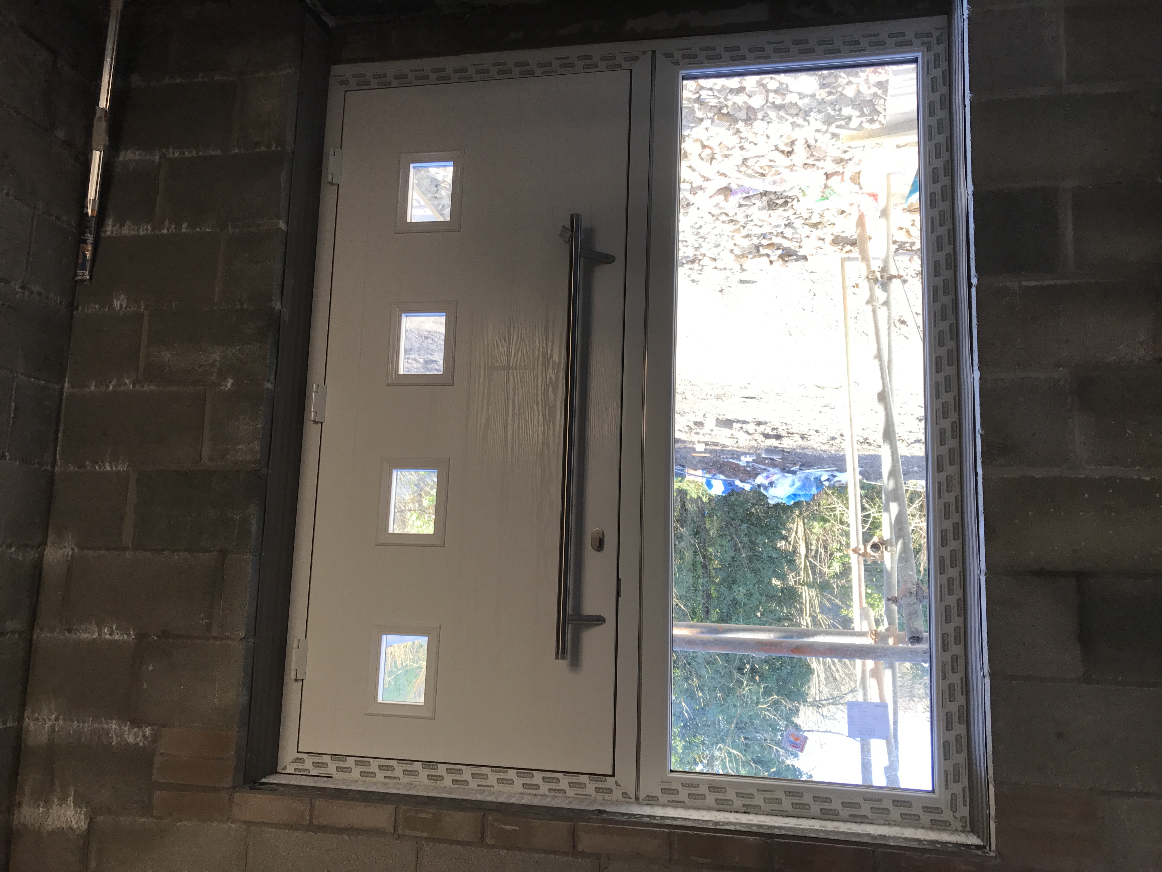

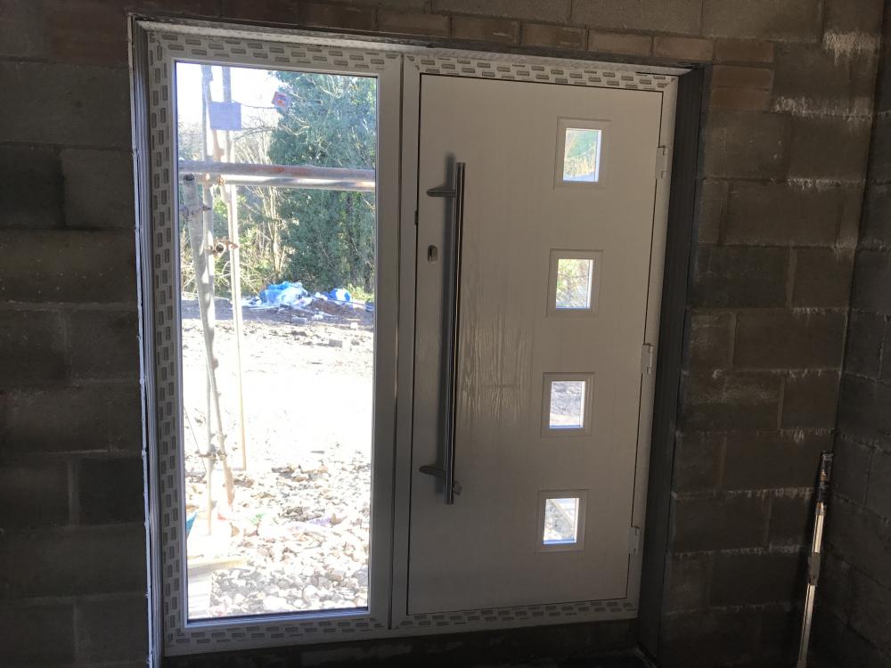

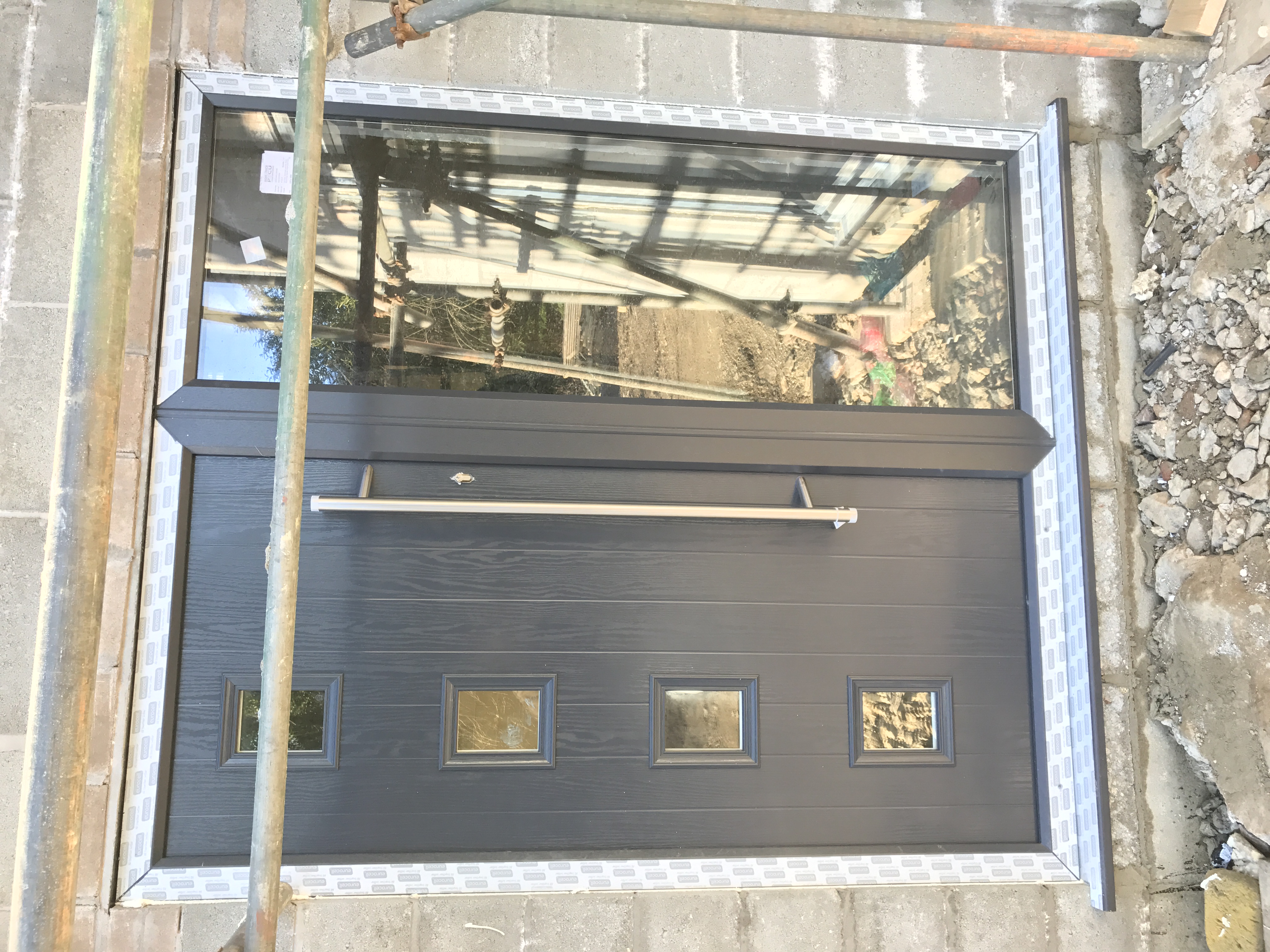

Nice front door - where is it from ..?

ProDave
Posted
Another advantage of the Scottish system of sarking the entire roof with some form of solid board.

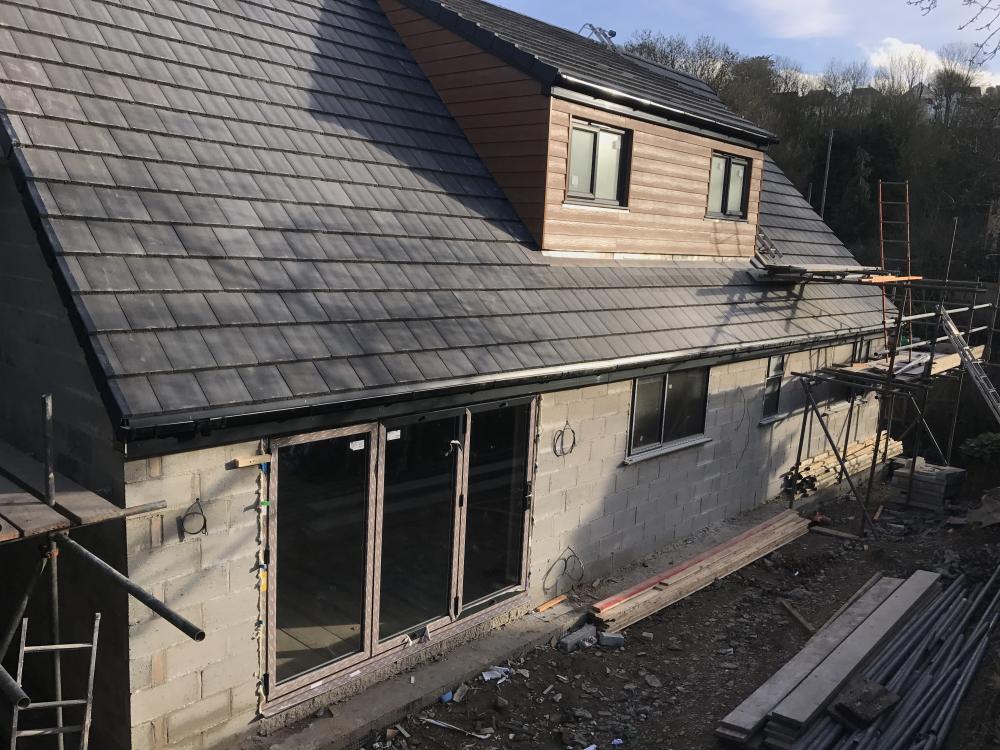

Declan52
Posted

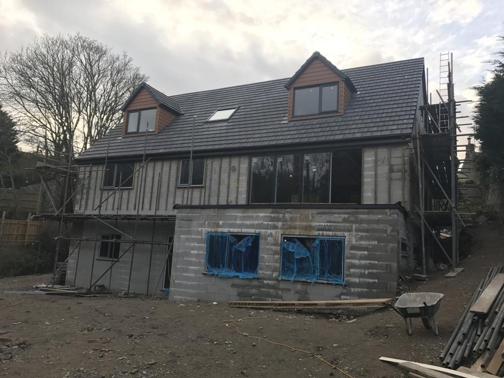

I would let the outside sit for a at least 6 months to dry out as going by the stains on the blockwork it was built when it was very wet. It will shrink and crack so might as well let the bare blocks crack rather than what ever render you are going with.
Grosey
Posted
The chippy in the photo doing it is Scottish, and said exactly the same. Then grumbled something about the English under his breath ?
  • Like 1
Grosey
Posted
First floor up will be clad, and it probably will be 6months + before the ground floor is rendered. What is it exactly that would have caused the staining? As it only seems to be on this balcony section not the rest of the house.
Declan52
Posted
The blocks where built when they where wet and you get the salts that are in the concrete and the mortar seep out. The tech term for it is effloressence .
let it dry out and most of it will brush of. The best cure is just time so let it sit for as long as possible and just keep brushing it of as it drys out. An old wives tale to treat it is white vinegar and water.

Grosey
Posted (edited)
14 minutes ago, PeterW said:
Is that including the side light ..??? Can you pm me the supplier..? And are they double or triple glazed ..?
Apologies just checked the quote the composite front doors was £799
Side light was £140 including glass.
Just double glazed but triple glazed was available.
http://www.rightpricewindows.co.uk/

Grosey
Posted
All of the dormer cladding is now complete....
Looks very different colours depending on the light which I'm pleased with. Still nervous about the 1st being clad though and whether we have made the right decision!
  • Like 1

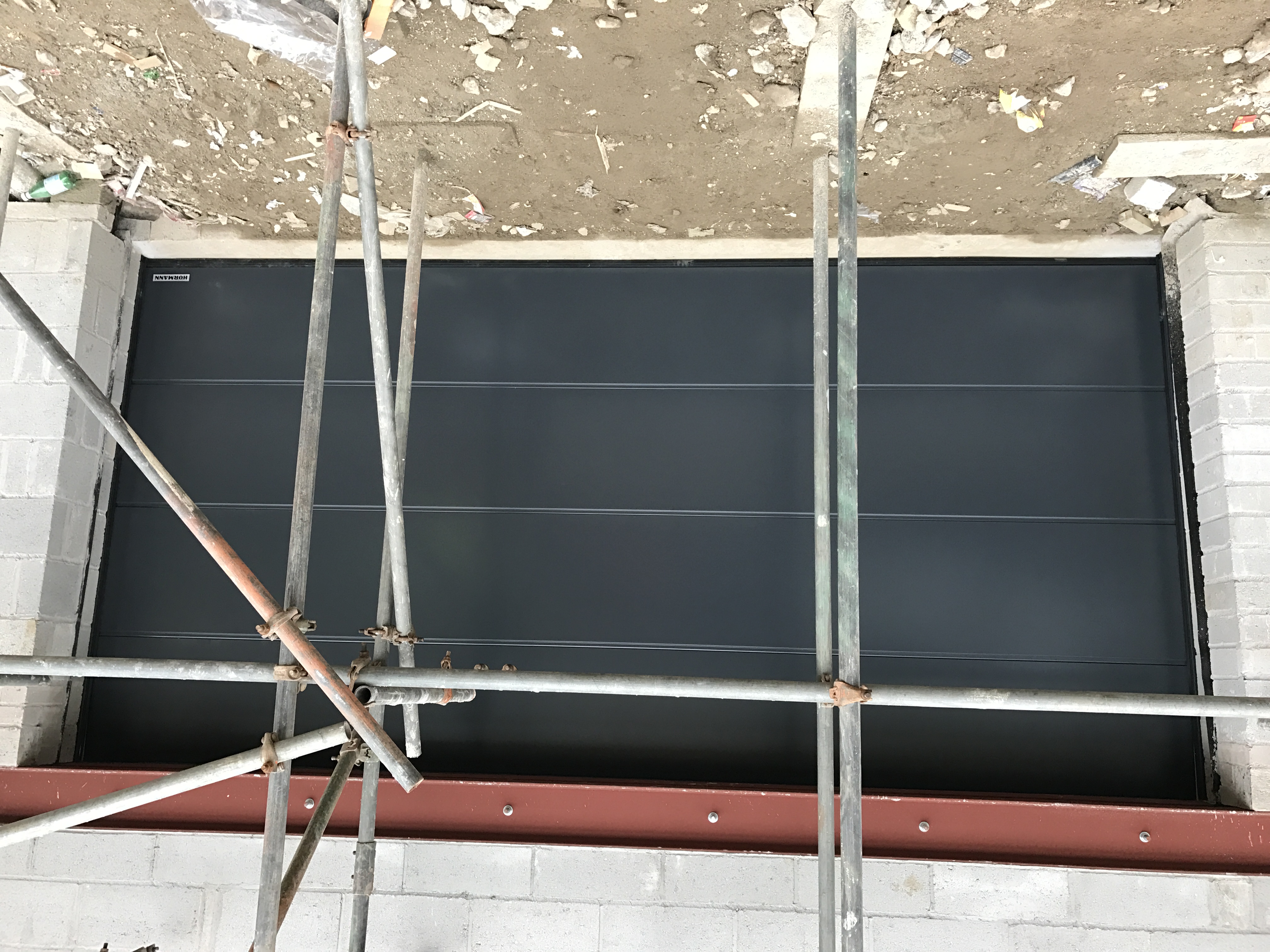

Jude1234
Posted

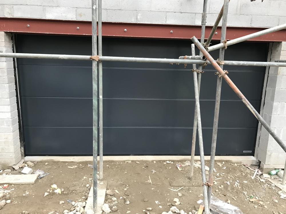

  @GroseyI know it is a bit late but where did you get your garage door from, I love the look of it.  We are just trying to find a modern looking double garage door
Triassic
Posted
Mine was a s sectional garage door, it came as five sections and was a double garage width, they cut the sections to the dimensions of the opening. I paid around £1200 for it five years ago.
  • Thanks 1
Grosey
Posted
Hi, as above it is a Hormann door, just from a dealer local to me. Sectional insulated, I think it was about £1600 ex vat, fitted. This included the electric opener & 2 remote fobs.
  • Thanks 1
Onoff
Posted
How wide out of interest is the garage door? Something else on my wish list!
Grosey
Posted
4000mm if I remember correctly.

Hi, thanks for putting up all the photos of your build it’s very helpful, I have done a shed dormer on my on my timber frame house I am building similar to yours, the question I have is about how the roofers went about the ridge on the dormer where there are different pitches on either side. Did they use a dry ridge system? (Is so do you know which one?) or did they mortar bed them on that part? (If so did they add any additional ventilation there?) many thanks for your time and I hope all is well with you and your home ?
