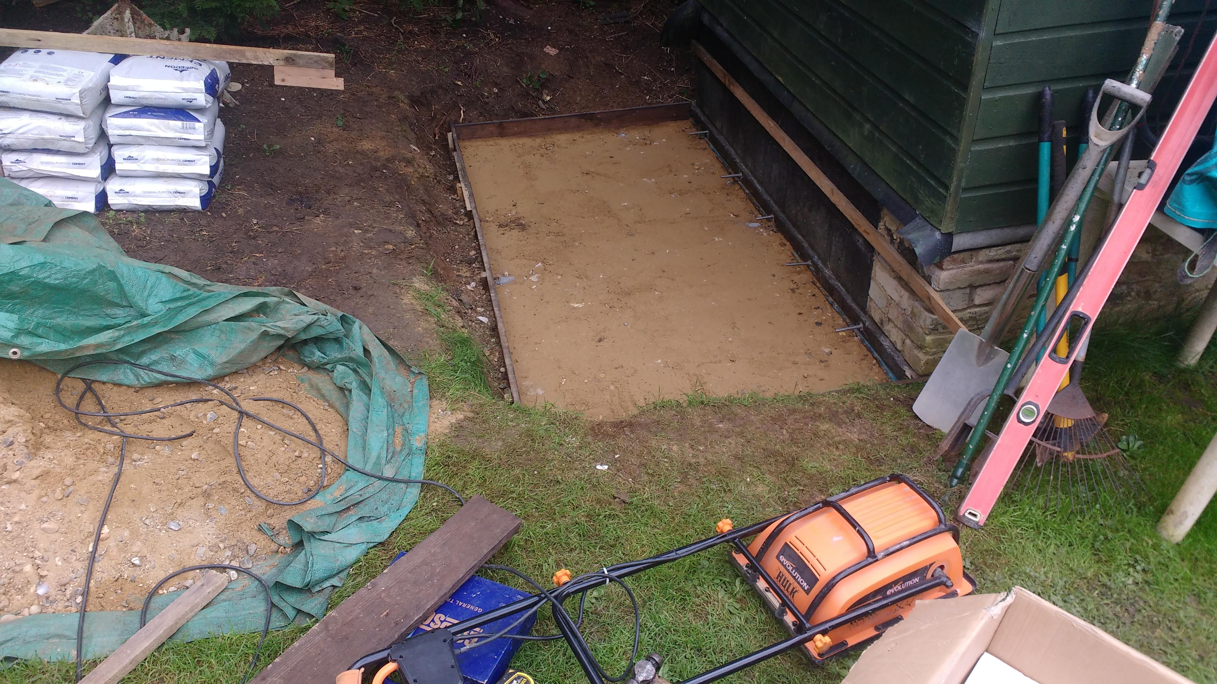

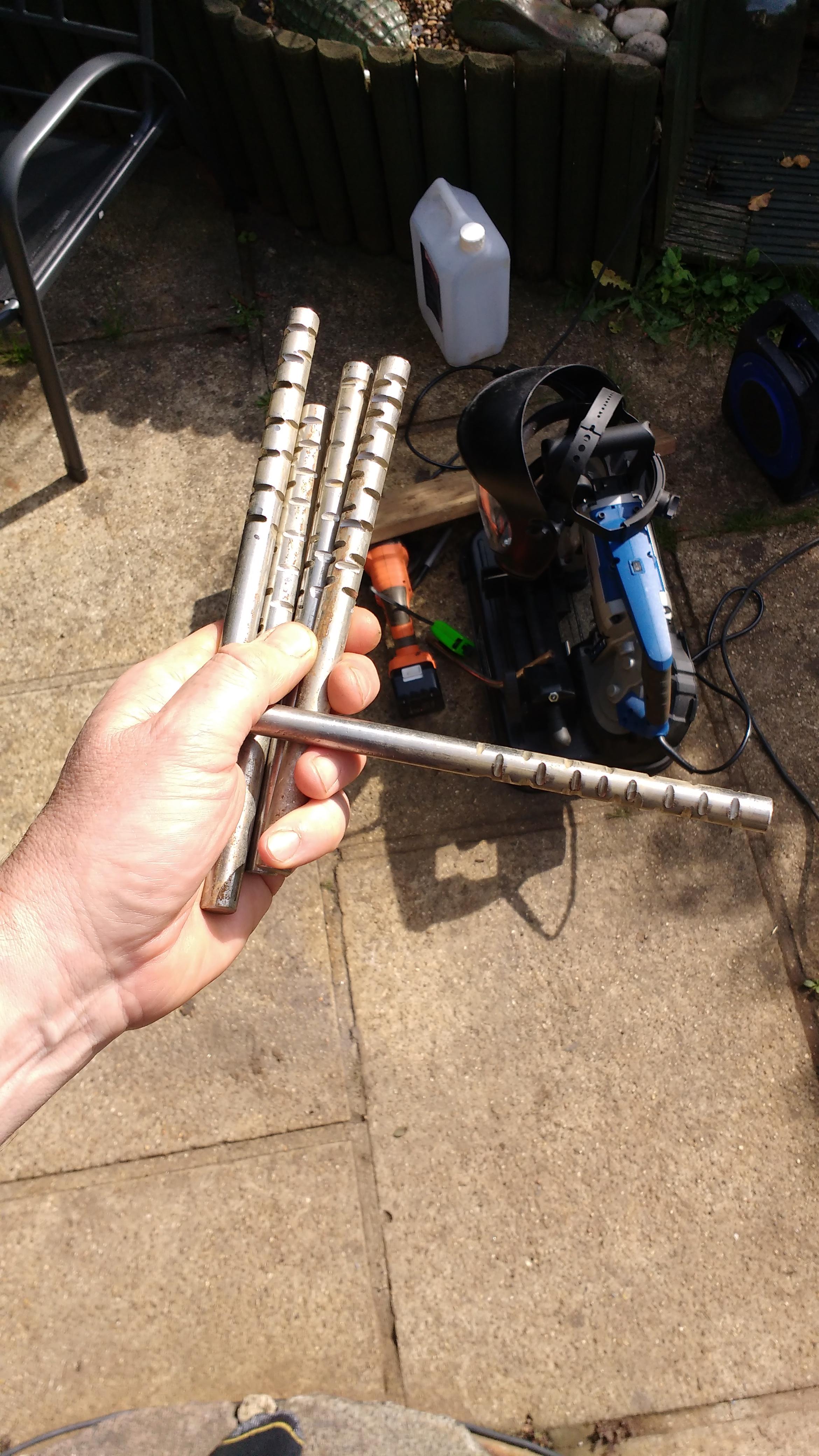

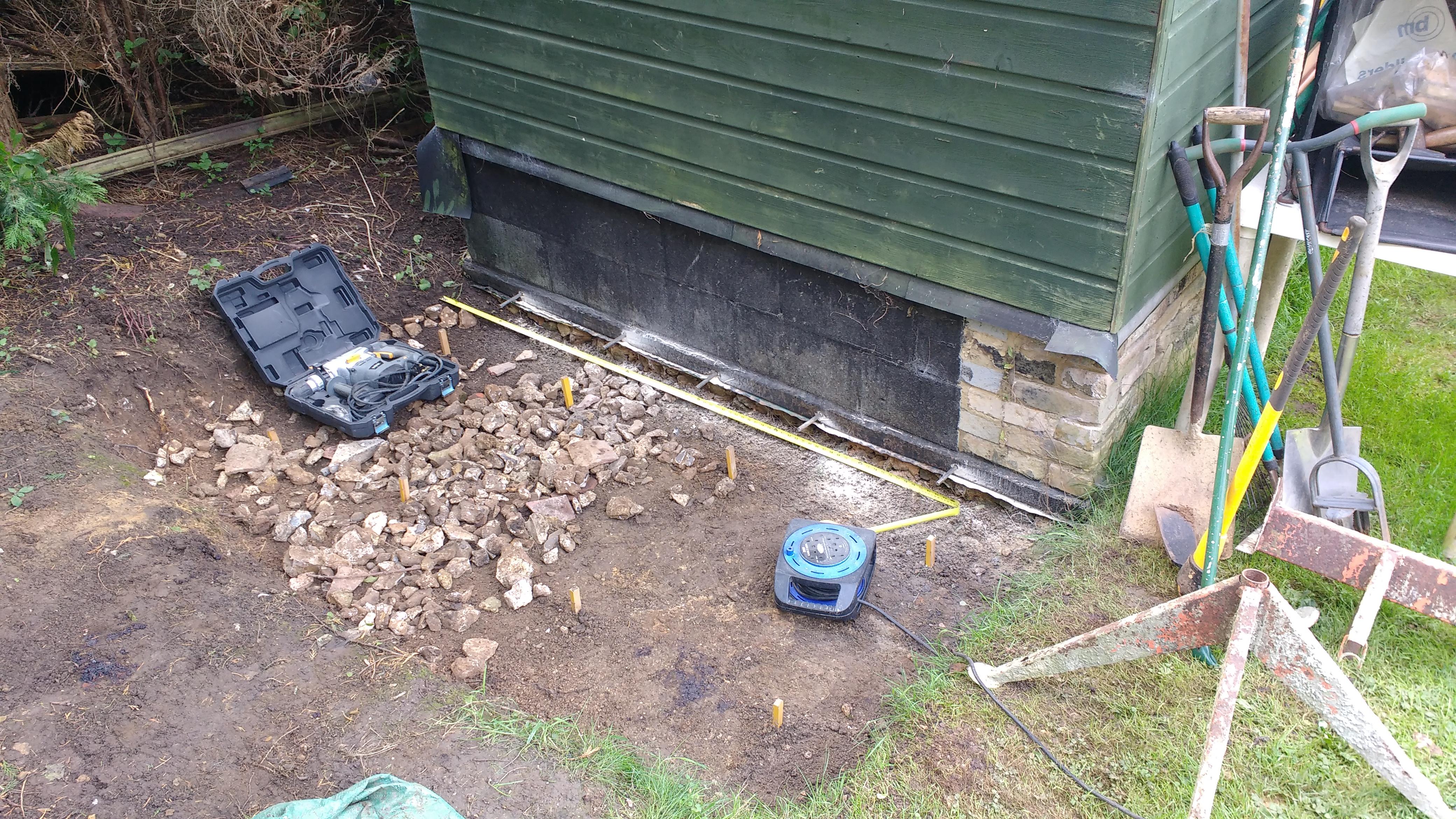

Onoff Posted September 17, 2021 Author Share Posted September 17, 2021 Want to put some slip pins in between old and new slabs. Cut some 200mm long st/st rod and made some indents over half the length with a 3mm disc to key the resin. Other, smooth half will get a wrap of Denso tape to protect from the concrete. Link to comment Share on other sites More sharing options...
Onoff Posted September 17, 2021 Author Share Posted September 17, 2021 Holes drilled and ready for resin. Quite impressed with my cheapo Hammer drill, bought when other drills had died drilling through the garage slab. Was a time you'd be looked down on for having a Titan, don't you have one @pocster? 1 Link to comment Share on other sites More sharing options...

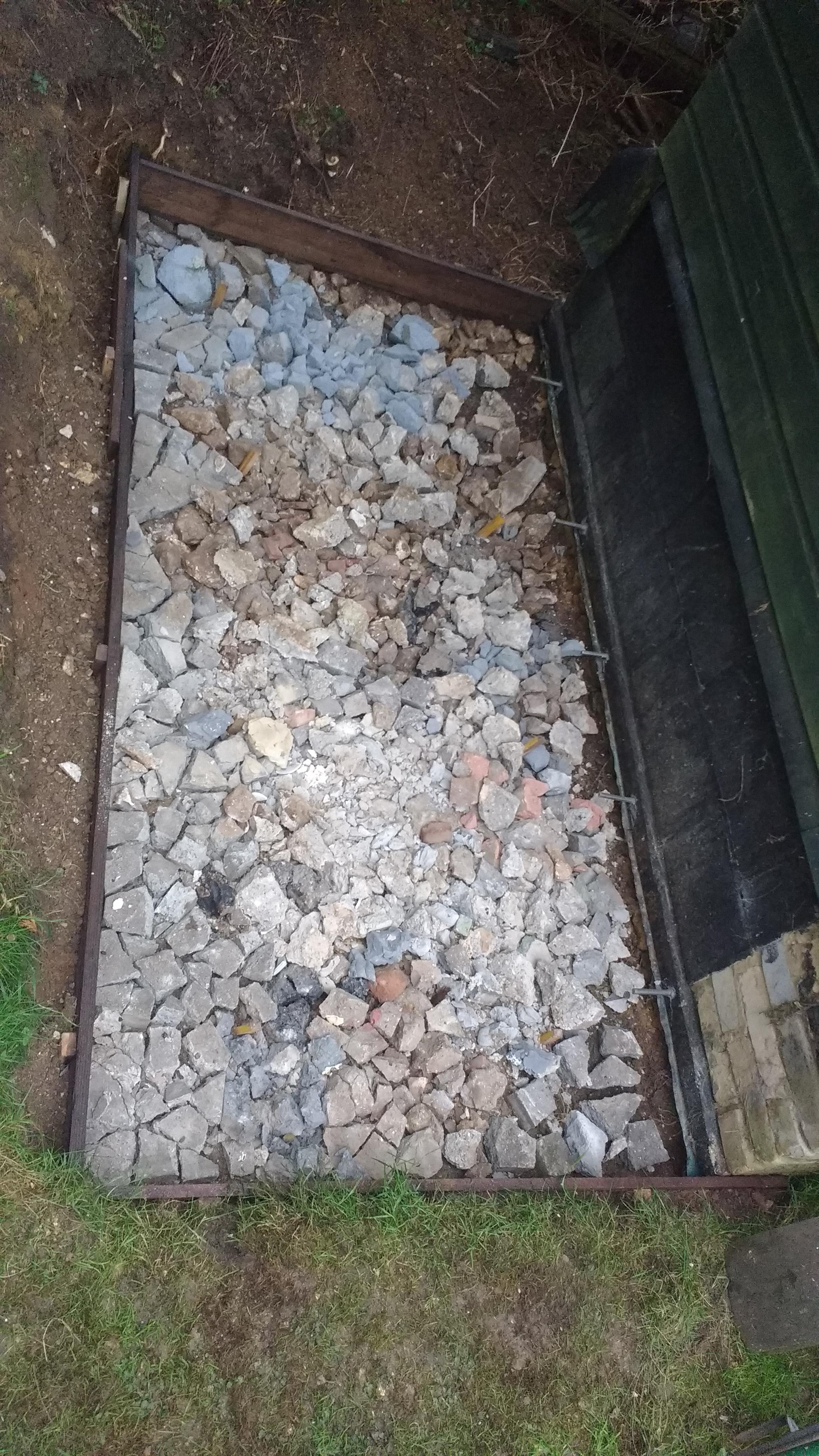

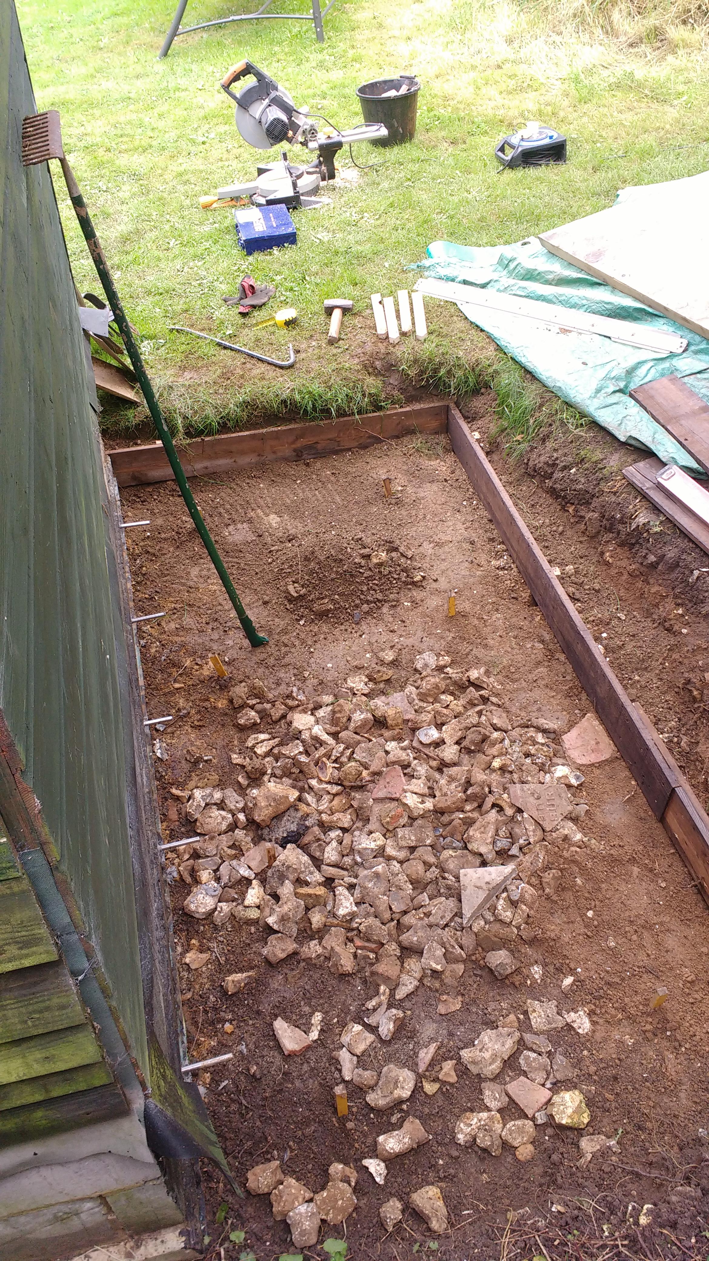

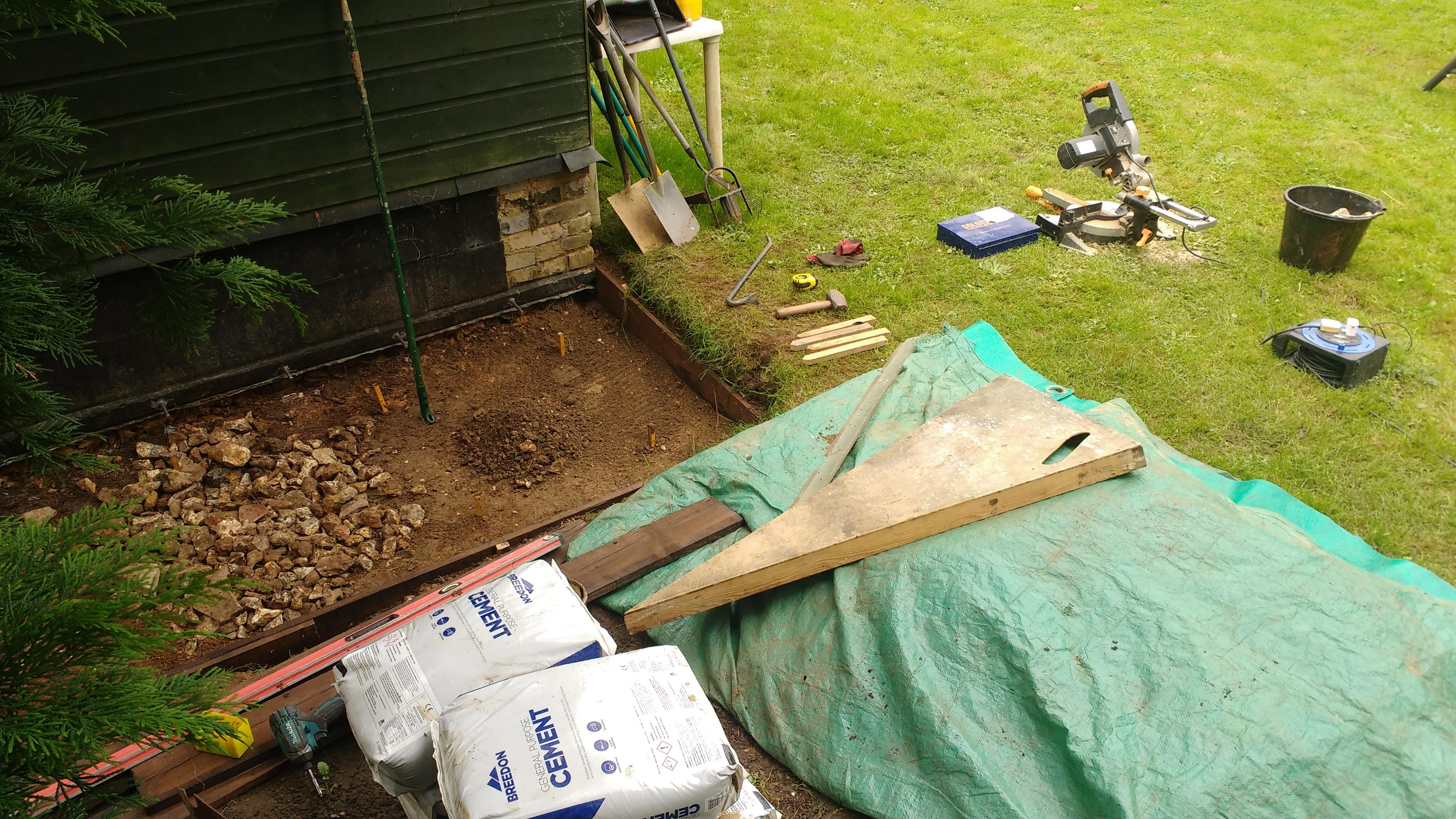

Onoff Posted September 20, 2021 Author Share Posted September 20, 2021 (edited) This is where I get bored and it starts to go slow. Doing the hardcore, got bloody great lumps I'm breaking up with a club hammer to get sort of level before the sand blind. Boring as Hell. It'd be much easier if smaller bits to start with. I've about 7 or 8 jumbo bags of assorted rubbly crap. Debating hiring a crusher one weekend to turn into a nice pile or ready to use Type 1, 2 esque. Would be handy when I do my drive. Blinded it with some all in one. Went over with the little Evolution electric whacker (the 5kN one). I'll round up a load of small sand, ballast etc plastic bags to lay down before the DPM as a bit of protection against some of the sharper stones: Still debating casting the dwarf wall... Edited September 20, 2021 by Onoff Link to comment Share on other sites More sharing options...

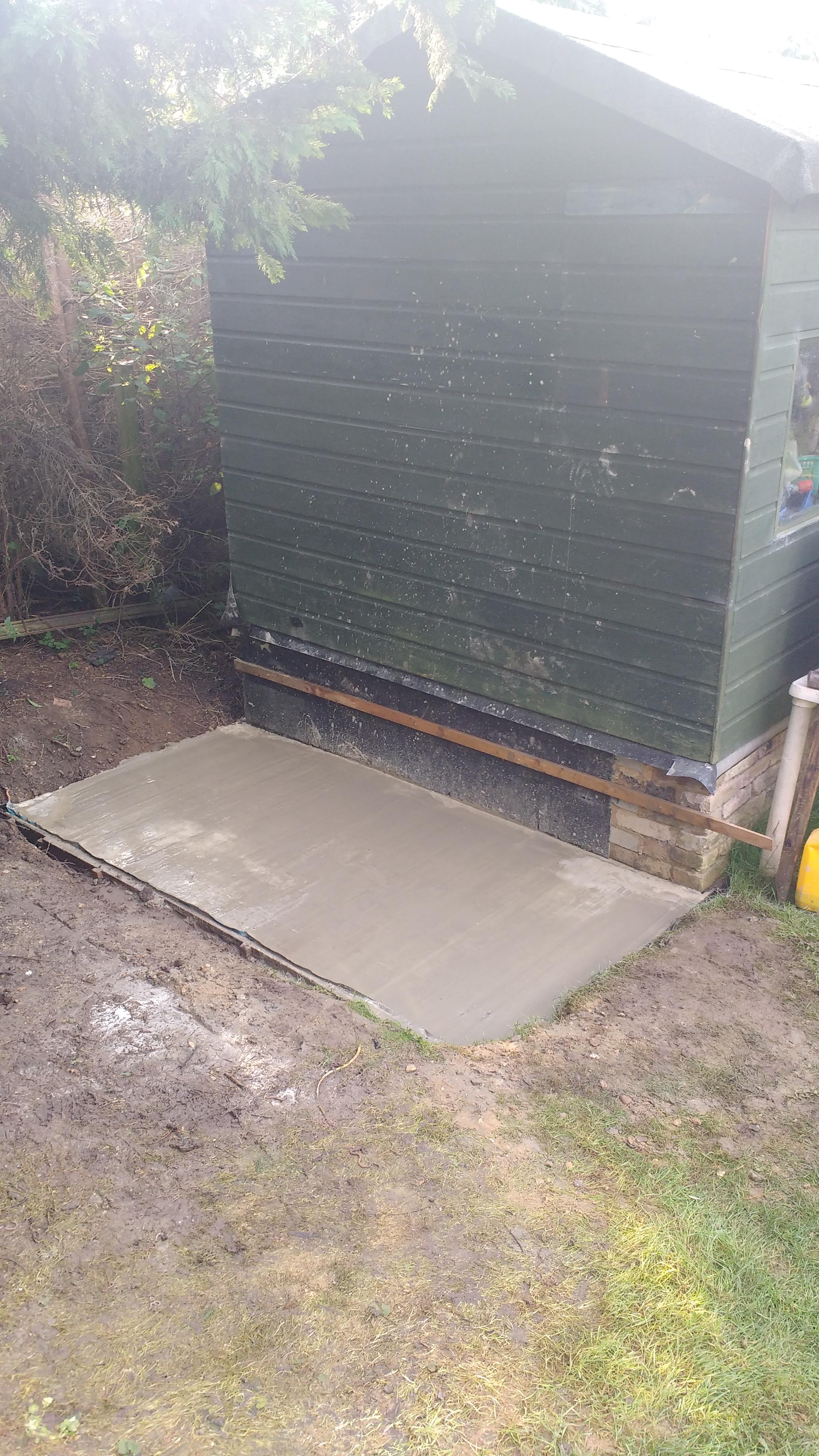

Onoff Posted September 26, 2021 Author Share Posted September 26, 2021 Bit more done. Forgot to take a pic with the A142 mesh down and bit of 4" soil pipe set level (filled with EPS), in one corner for future electrics. Just glad the mixer wasn't petrol/diesel: 1 Link to comment Share on other sites More sharing options...

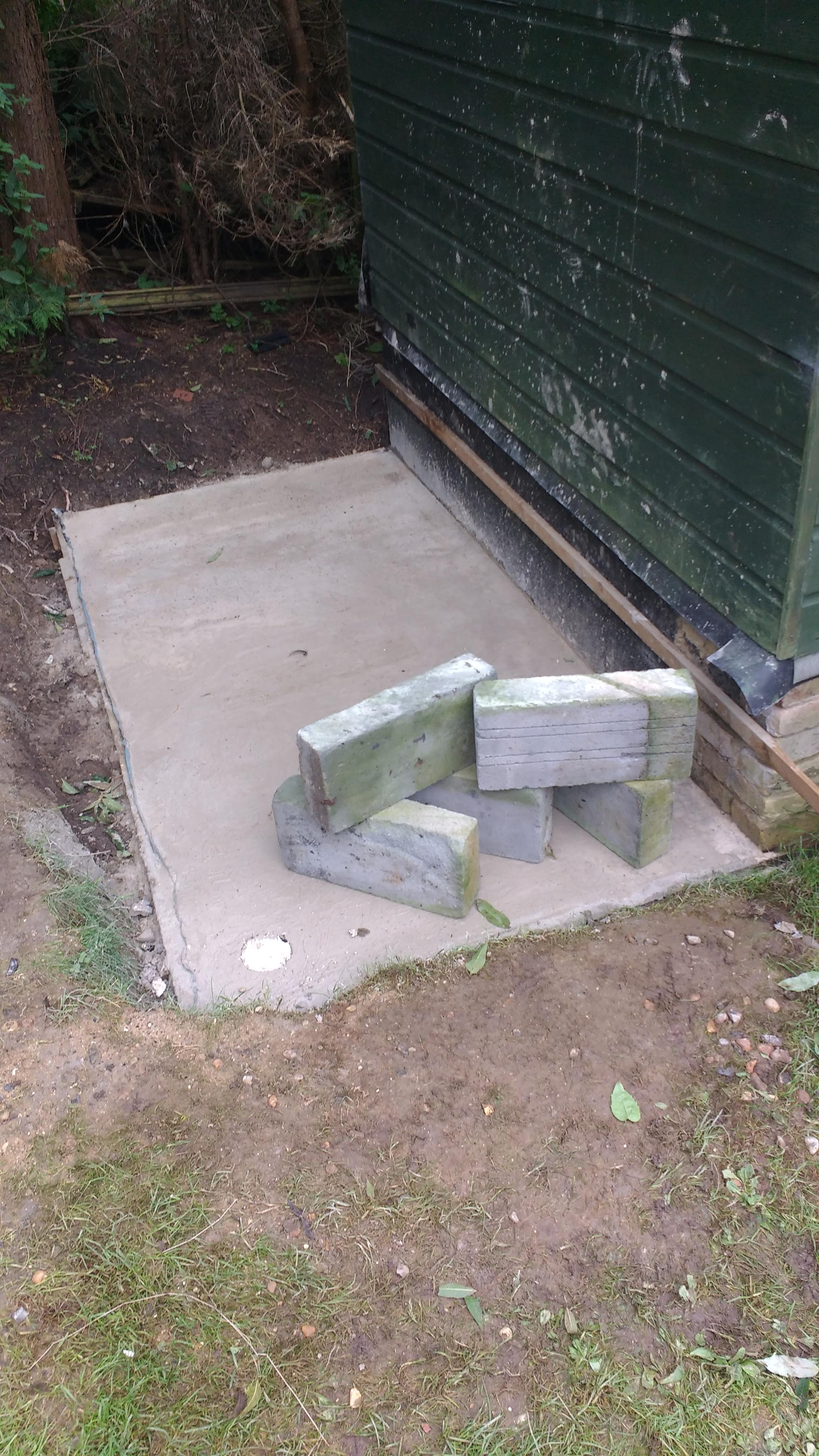

Onoff Posted September 28, 2021 Author Share Posted September 28, 2021 Found a good few 100mm Celcon blocks lying around, more than I thought I had. A bit of greenery on them, a few cuts and corners knocked off a couple where the faces have spalled. Some stock bricks too. I reckon I've enough to do a 3 sided dwarf wall similar to what I did for the original shed. Two things I'm concerned about though: 1) How to stop damp coming through them? Angle the dirt away, a bit of membrane tacked to the walls, French drain, gabions filled with flints etc? 2) The return corner where the pipe for (possible future) electrics is, that'll only be like a foot or so long then a doorway. Worried about an opening door cracking up that brick / block work corner...put the hinges the existing shed side? Hope that makes sense I'm on the 5.5% St Austell IPA! Link to comment Share on other sites More sharing options...

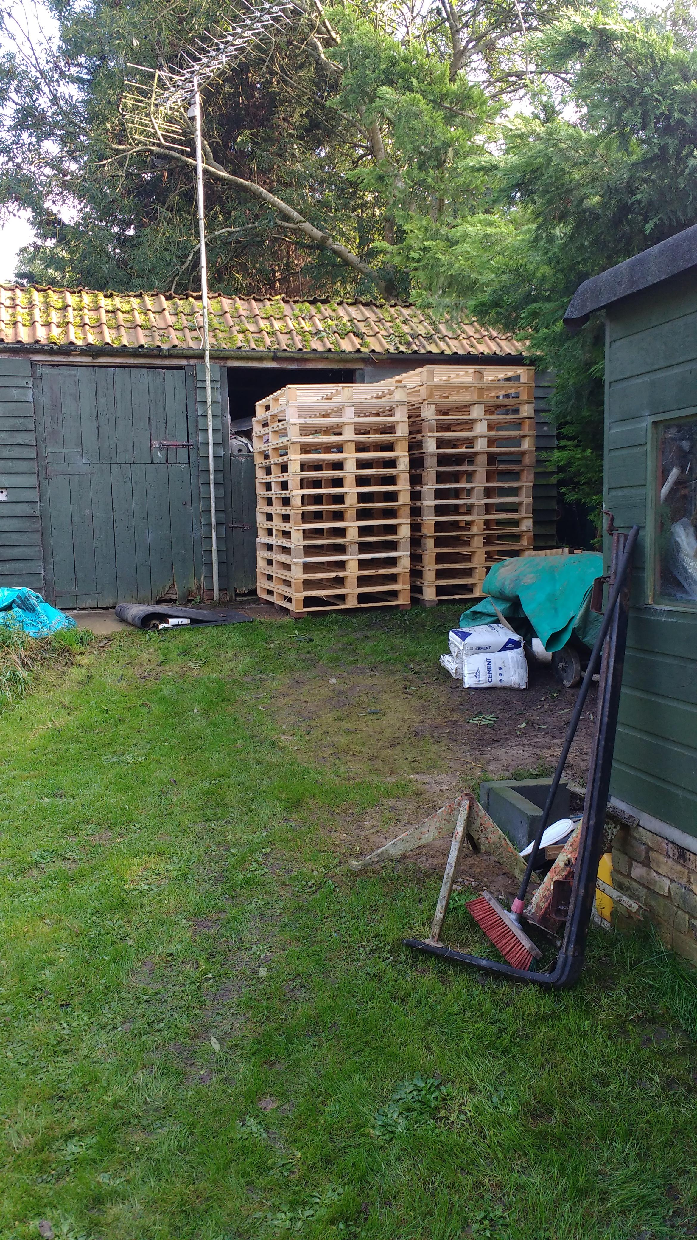

Onoff Posted October 9, 2021 Author Share Posted October 9, 2021 Just scored 29 same size pallets: Link to comment Share on other sites More sharing options...
