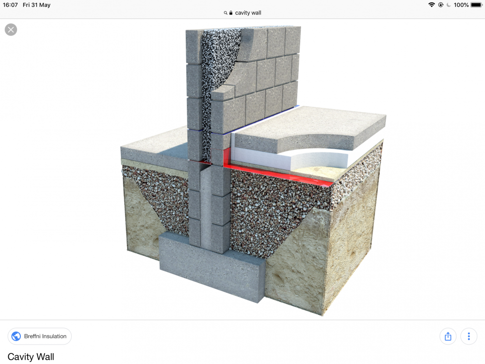

zoothorn Posted May 30, 2019 Author Share Posted May 30, 2019 Thanks chaps. My house is an old miner's cottage, 3ft thick slate, side wall to build onto is an uneven/ 'contoured' typical stone surface. What I'm trying to understand, is the 'layers' of different options, & what I have to do to meet regulations regarding my wall construction. For eg, would I be allowed to go simply one block course / roof ontop (ceiling joists separating the two rooms via metal ties between walls).. lining inside walls with battens > insulate > plasterboard.. for either room, or even both? Link to comment Share on other sites More sharing options...
PeterW Posted May 30, 2019 Share Posted May 30, 2019 19 minutes ago, zoothorn said: For eg, would I be allowed to go simply one block course / roof ontop (ceiling joists separating the two rooms via metal ties between walls).. lining inside walls with battens > insulate > plasterboard.. for either room, or even both? No If you go with block then you need to go (inside to outside) Plasterboard Block Cavity (with Insulation) Block Render This will give you a wall of 325mm thick, there or thereabouts. Floor joists will go on the inside skin, both block skins connected by ties. Roof (if you want a full open apex) will be hung on a ridge beam / steel resting on inside skin. As @Carrerahill says, I recon £20/m for blockwork is about right so that would give you around 150sqm of block and a £3k bill for that section. TF would probably come out not dissimilar I would expect 1 Link to comment Share on other sites More sharing options...

Declan52 Posted May 30, 2019 Share Posted May 30, 2019 You can build a single skin block but it will be a standard 4 inch block on its flat so you will end up using the same amount as you would with a cavity. Plus as you will have no cavity to help keep the rain from getting into the inside you have to use a certified waterproof system to plaster and seal the wall up. With a cavity you can just use a sand cement mix and rub it up and leave it. Let it sit a few years then fill any cracks and paint it whatever colour you like or just leave it grey. With a single skin then all the insulation will be on the inside so isn't as easy to put in place compared to a cavity. You need 10 standard blocks for each sqm. So work out how many sqm you have then X 10. This will give you how many you need so you can phone round and get a price. Once you know how many blocks then you can work out how much motar you need. A bag of cement and 3 sand will build about 30-35 blocks depending on how much you drop. It's time to be realistic. Can you build block or can you get some one who will but won't charge you plenty. It would be my preferred option as , being realistic time again, do you think you can make a set of timber frame panels up that will be to the right size and shape and square. Link to comment Share on other sites More sharing options...

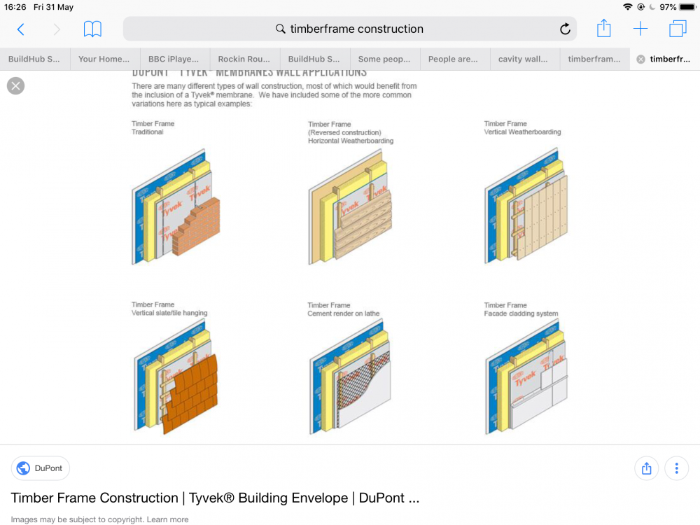

zoothorn Posted May 30, 2019 Author Share Posted May 30, 2019 1 hour ago, PeterW said: You have planning for a rendered outside wall finish, which you have permission to build. If you change it to vertical wood cladding then you will have to go back to planning for a new approval. In your example you have no insulation - where are you putting this as you have to have it...? It sounds like I'll have to go back anyway, if my top room wasn't 'open'? ok so now I know I have to have insulation: I didn't know this was compulsory. Is anything else compulsory within the wall structure? I had no idea the PP was for a wall method already chosen: I thought the wall method choosing came after PP, but before I get quotes. You see how impossible this process is for me/ anyone to understand how to progress? there are simply no guidelines. As to where would I be putting this insulation in my eg, I don't know: all I know is I see builds with this vertical cladding. If there's a separate, inner course (?) & this is the outer course, & its compulsory to have insulation- then the eg's I see MUST have insulation. So to answer your Q: "wherever that one's insulation is/ however that was done". I thought it might be a usual wall type I could be told of. Options so far I think are: block/ block, TF (which seems to be timber + block, or timber + timber.. or is it.. I'm confused by TF), ICF which I've never seen & don't see on builds anywhere here, & my vertical-clad eg.. which I don't know how is done so unknown if an option I can choose. Link to comment Share on other sites More sharing options...

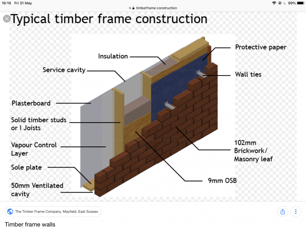

Declan52 Posted May 30, 2019 Share Posted May 30, 2019 No matter what you build it will have to be to the building regs so will have to have some quantity of insulation. With block the easiest is in the cavity and the easiest and best method is to get it blown in. With timber frame the insulation is in between the studs. This can be pir cut to suit, Rockwool or you can get different types sprayed in. Your choice on the type but it has to meet the regs. With timber frame your going to need something to keep the rain out. You can build a skin of block or use something like a cement board and then plaster this up. Once again your choice. You can go for cladding but your permission is for render finish so unless you go back to them and reapply then you have to stick with what they have passed. Link to comment Share on other sites More sharing options...

zoothorn Posted May 31, 2019 Author Share Posted May 31, 2019 So getting back to walls, could I go inner course block / outer course (vertical wood-clad) something or other? Link to comment Share on other sites More sharing options...
PeterW Posted May 31, 2019 Share Posted May 31, 2019 1 hour ago, zoothorn said: So getting back to walls, could I go inner course block / outer course (vertical wood-clad) something or other? No you have no insulation in that plus I’m not sure you could use wood as a flammable wall cladding that close to the road without coating it but would need to check. To use timber cladding and block you would need (from the inside) plasterboard block cavity with insulation block batten cladding I recon you should stick with block and render and a cut roof, steel supporting the roof timbers, unless you want to go the full timber frame deal with a render board finish. Link to comment Share on other sites More sharing options...
Russell griffiths Posted May 31, 2019 Share Posted May 31, 2019 1 hour ago, zoothorn said: So getting back to walls, could I go inner course block / outer course (vertical wood-clad) something or other? Nope, not unless you go 150mm blocks how will you hold the second storey up, you can’t go two storey in a single skin of blocks, it would just not stand up. Link to comment Share on other sites More sharing options...
