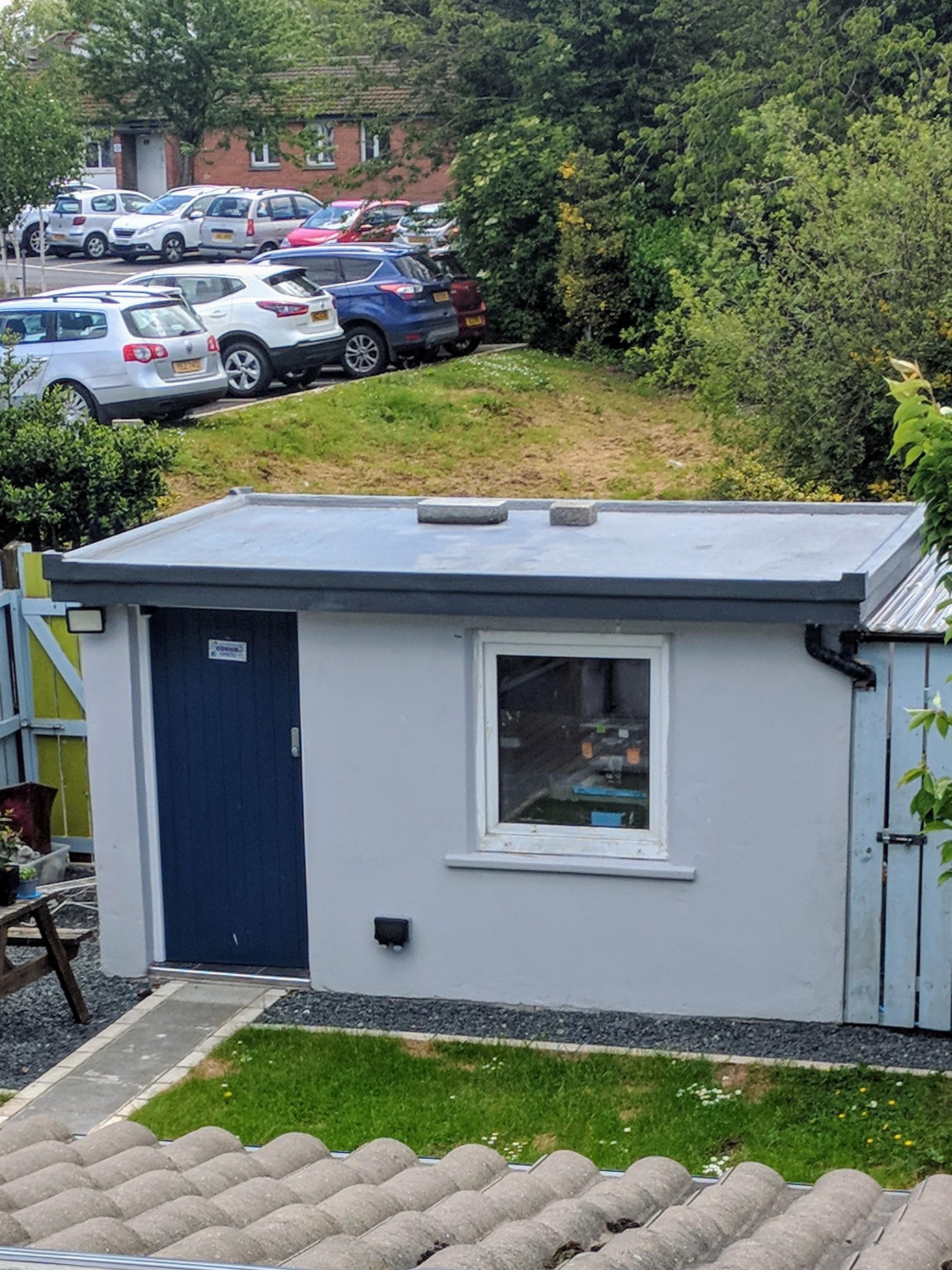

MJNewton Posted May 28, 2019 Posted May 28, 2019 (edited) The flat roof on our extension was covered with a PU liquid membrane - Desmopol. Whilst we initially had issues with the roof construction (fall and quality of finish) all those clouds have blown away (nearly; I struggle to let go of such anxieties) leaving me quite a fan of this type of coating. Of course, it is too early to comment on longevity but there are various 'features' to it that appeal: - Single covering with no joins - Very flexible and seemingly very tough - Easy to re-cover should the need arise (damage or planned renewal/maintenance) just by putting another coat over the top (when it comes to doing this I'll definitely be DIYing it - my roofer clearly showed there wasn't much skill in it!) - Minimal risk of failings around upstands etc unlike other coverings that depend on careful detailing - Can be used with zero degree falls (good for my roof that doesn't fall quite as much as it should due to an error in furring calculations!) The technical director of a roofing supplier (who supplies all types so I don't suspect bias) told me that, like seemingly many building technologies, here in the UK we seem to hold tightly on to 'traditional' methods and so new/novel techniques can struggle to catch on despite offering improvements and being used widely elsewhere (particularly on the continent). Edited May 28, 2019 by MJNewton 1 1
