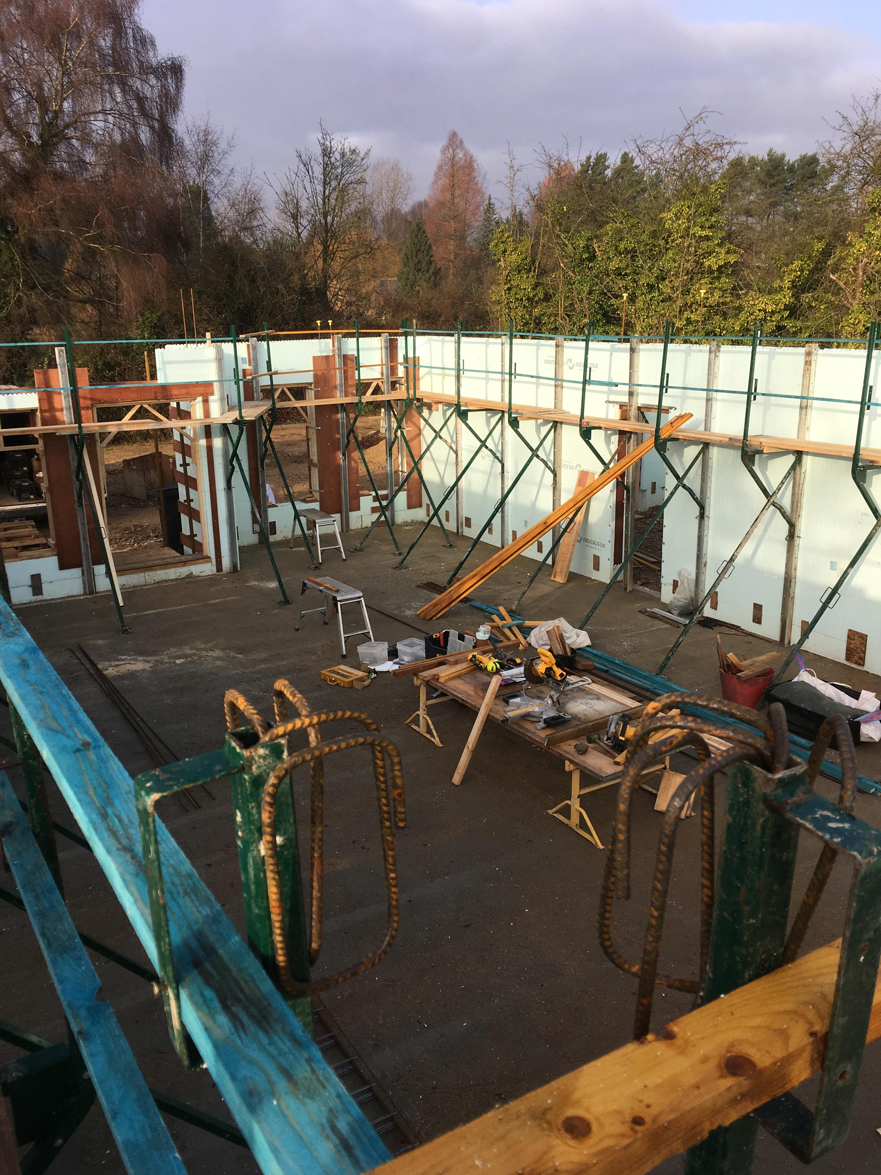

Russell griffiths Posted May 27, 2019 Posted May 27, 2019 Going back to your original point regarding bracing, none off those diagrams included a hand rail, when my pump guy turned up he commented on how nice the working platform was, and he told me about 2 jobs recently 1 he refused to pour as the platform was only 12 inches wide with no hand rail the second the self builders wife had a serious fall from the platform which required hospital treatment. I was the the one who started the chat about getting a group together to buy the timber bracing in the end I used the correct steel bracing with full hand rail and adjustable system and I’m glad I did. In all the bracing cost about £1400 and was money well spent. 3
Conor Posted May 27, 2019 Author Posted May 27, 2019 (edited) Jjjj@ragg987 @Russell griffiths Totally agree re handrails. I'd be putting in a proper system. Had considered erecting scaffolding around the outside to use as the working platform. Or would that get in the way? (Edit - how the hell do I delete that tag I put in by mistake?!) Edited May 27, 2019 by Conor

jamiehamy Posted May 27, 2019 Posted May 27, 2019 1 hour ago, scottishjohn said: check out isotex --no bracing needed 'no bracing needed' - because UK self builders are able to summon a flat calm for the duration of construction. Tbh, if they are claim that, its utterly irresponsible in various ways. If they make that claim, they can claim anything. There's nothing to lock those blocks in places - wouldn't touch them with a bargepole.
scottishjohn Posted May 27, 2019 Posted May 27, 2019 7 minutes ago, jamiehamy said: 'no bracing needed' - because UK self builders are able to summon a flat calm for the duration of construction. Tbh, if they are claim that, its utterly irresponsible in various ways. If they make that claim, they can claim anything. There's nothing to lock those blocks in places - wouldn't touch them with a bargepole. that,s your choice ---been used for 40 years --so its obviously not a problem . what locks them in place --its called gravity and if it really worried you --then just use a bit of "thin joint mortar or low expansion foam on each one ? and if you really want belt and braces only go 5 rows and then fill --its never going to be a problem is it ? If we going to be silly a wayward teenager could set fire to your poly blocks ??,or one with an electric battery powered carving knife woodcrete does not burn ,so another advantage should your house catch fire
jamiehamy Posted May 27, 2019 Posted May 27, 2019 2 hours ago, scottishjohn said: that,s your choice ---been used for 40 years --so its obviously not a problem . what locks them in place --its called gravity and if it really worried you --then just use a bit of "thin joint mortar or low expansion foam on each one ? and if you really want belt and braces only go 5 rows and then fill --its never going to be a problem is it ? If we going to be silly a wayward teenager could set fire to your poly blocks ??,or one with an electric battery powered carving knife woodcrete does not burn ,so another advantage should your house catch fire No bracing is 'obviously' not a problem? Sorry, but not only on the theoretical side, we have a builder here who has proven it. I wonder then what wind or force the unbraced unpoured icf can withstand? Its an important point and worth discussing. They appear not even to have a click lock or locking mould which adds to my concern over this particular product. Never mind gravity it looks like you could gently push the whole lot down.
scottishjohn Posted May 27, 2019 Posted May 27, 2019 (edited) 1 hour ago, jamiehamy said: No bracing is 'obviously' not a problem? Sorry, but not only on the theoretical side, we have a builder here who has proven it. I wonder then what wind or force the They appear not even to have a click lock or locking mould which adds to my concern over this particular product. Never mind gravity it looks like you could gently push the whole lot down. and he will be the first to say he built it too high , opinion and connjecture is all you have to support your argument 40 years +of use is what i will take as my proof it works. common sense ,something which you seem to ignoring ,would tell you that professional builders ,who are well used to the system would not be doing it without bracing if it was a very likely scenario .,and all over europe .where as every poly system maker take great pains to make you aware that bracing is mandatory ,what ever the weather it was durisol ,not isotex that fell down suffice it to say he had quality issues with his blocks as well , add excess height and odd size blocks ,theres the reason "unbraced unpoured icf can withstand? Its an important point and worth discussing". no, the makers have already worked all that out and state maximum recommended height at which you pour the wall. Edited May 27, 2019 by scottishjohn
jamiehamy Posted May 28, 2019 Posted May 28, 2019 10 hours ago, scottishjohn said: and he will be the first to say he built it too high , opinion and connjecture is all you have to support your argument 40 years +of use is what i will take as my proof it works. common sense ,something which you seem to ignoring ,would tell you that professional builders ,who are well used to the system would not be doing it without bracing if it was a very likely scenario .,and all over europe .where as every poly system maker take great pains to make you aware that bracing is mandatory ,what ever the weather it was durisol ,not isotex that fell down suffice it to say he had quality issues with his blocks as well , add excess height and odd size blocks ,theres the reason "unbraced unpoured icf can withstand? Its an important point and worth discussing". no, the makers have already worked all that out and state maximum recommended height at which you pour the wall. So what wind speed can it withstand unpoured?
