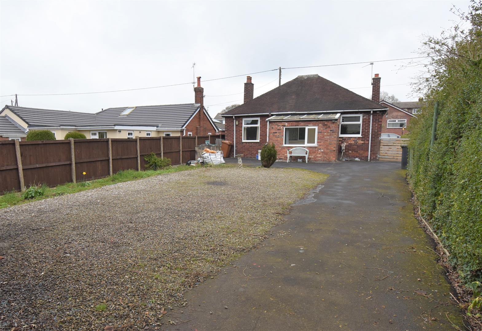

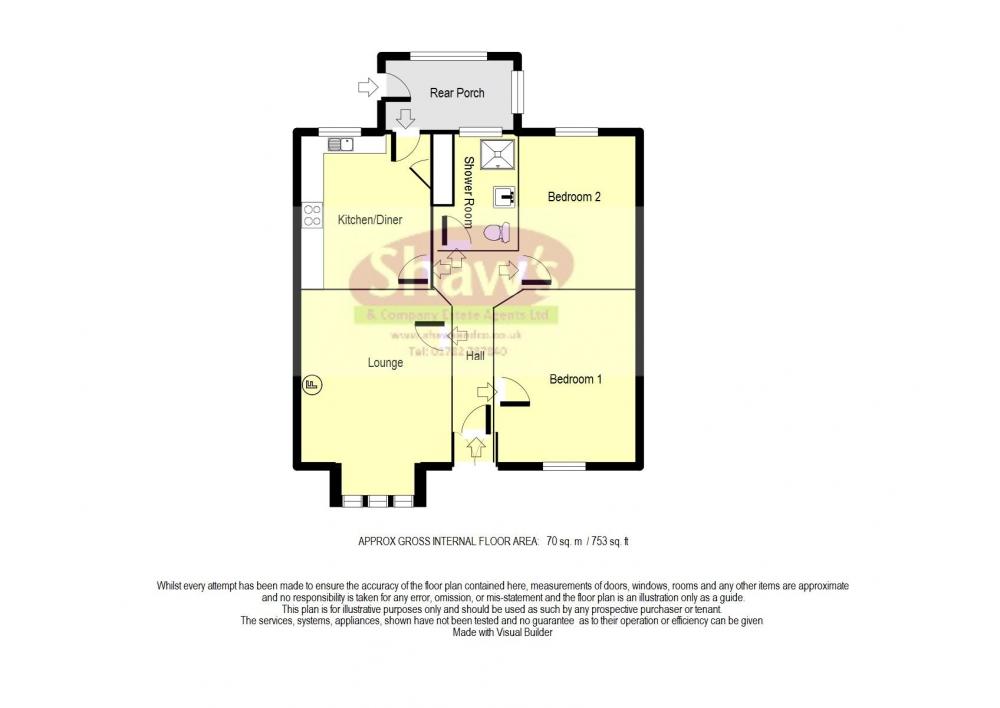

We have pretty much secured our first house and the sale is moving through very quickly (first time buyers, no chain and a friendship with the owner). We have opted for a bungalow which was on a generous plot size in comparison to the house. a little different for a 21 year old but I see the potential to make this a very nice home. I would like some of your experienced opinions on where and how best to utilise the available space. My first thought for real change is that I feel it needs an extension. It isn't a big bungalow by any means but its adequate for me and my partner for now so we have time on our hands to search around for the best option.
My thoughts are to extend out the full width of the house back as far as possible and open the current back kitchen wall to create an 'L'  shaped open plan kitchen, diner and new living room (the rear of the house is south facing). This would free up the current living room as a new bedroom, making it a 3 bedroom bungalow which will add value, right? I need your help on how to best go about this. How would the roof design affect the extension, would it have to be a flat roof? My other thought is to extend out the back and leave the 'loft' space above the extension open for a possible loft conversion in the future but again, I don't know if it would be possible because of the roof without it looking out of shape. Also, the current 'sun porch is coming down ASAP.
I am open to timber frame extensions etc and I have a lot of family and friends in the building trade which will hopefully bring the cost down.
I don't know if its worth noting but we are the end bungalow, the house next door is a 2 storey building.
Pictures attached.
Thanks for taking the time to read and help.

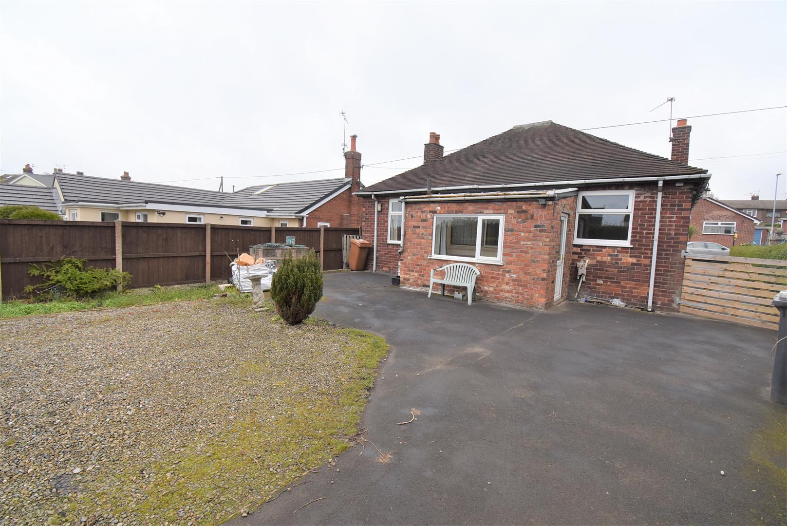

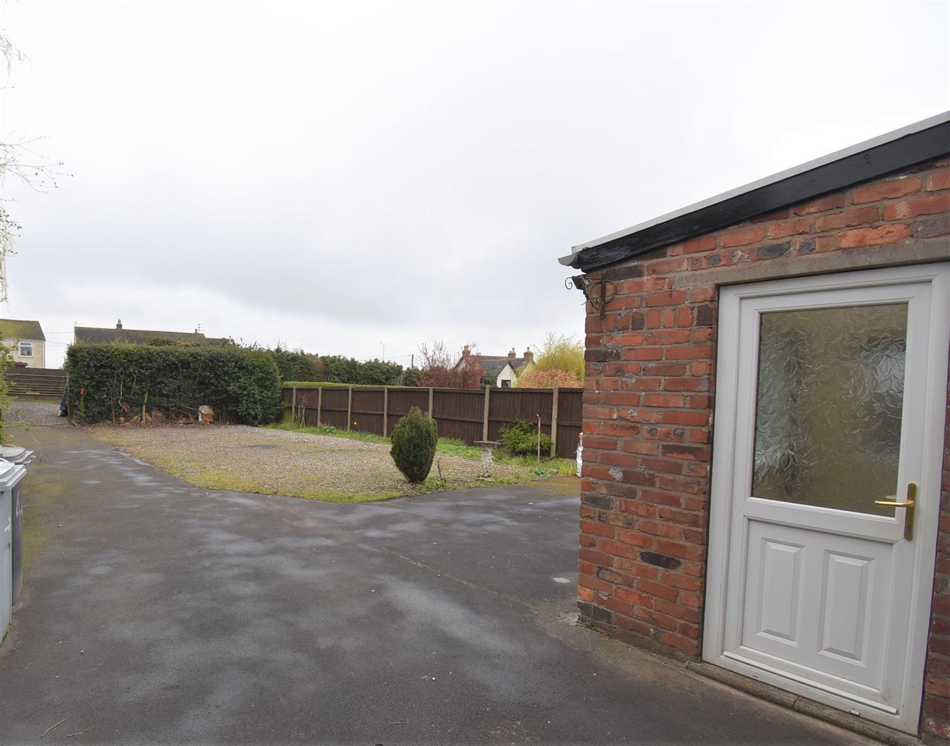

The rear porch is bonkers and you are well shot of it.  With a house of this age you need to be very careful of asbestos, especially if you plan to demolish.
Why the sea of tarmac at the back? Is that the only parking?  It would be good to have the back garden feel a bit more private.
Link to comment
Share on other sites
You are right, which is why its coming down. its literally been thrown on, not even tied into the brickwork.
We don't plan to demolish the house, we plan just to extend and make the most of what we currently have. The previous owner had tractors and other machinery so I guess they found it easier to be solid instead of grass etc. Actually behind the tress you see at the back is a huge double garage with more free space behind that leading to the back gate you can see. There is plenty of parking space on the front and a private road at the rear for vehicle access too.
We are aware there is a lot of work to be done, this house hasn't been updated since god knows when but it's all part of the fun and reason we took it on.
it's one of them you've got to see it to understand it's potential kind of houses. Pictures really don't do it any favours unfortunately.

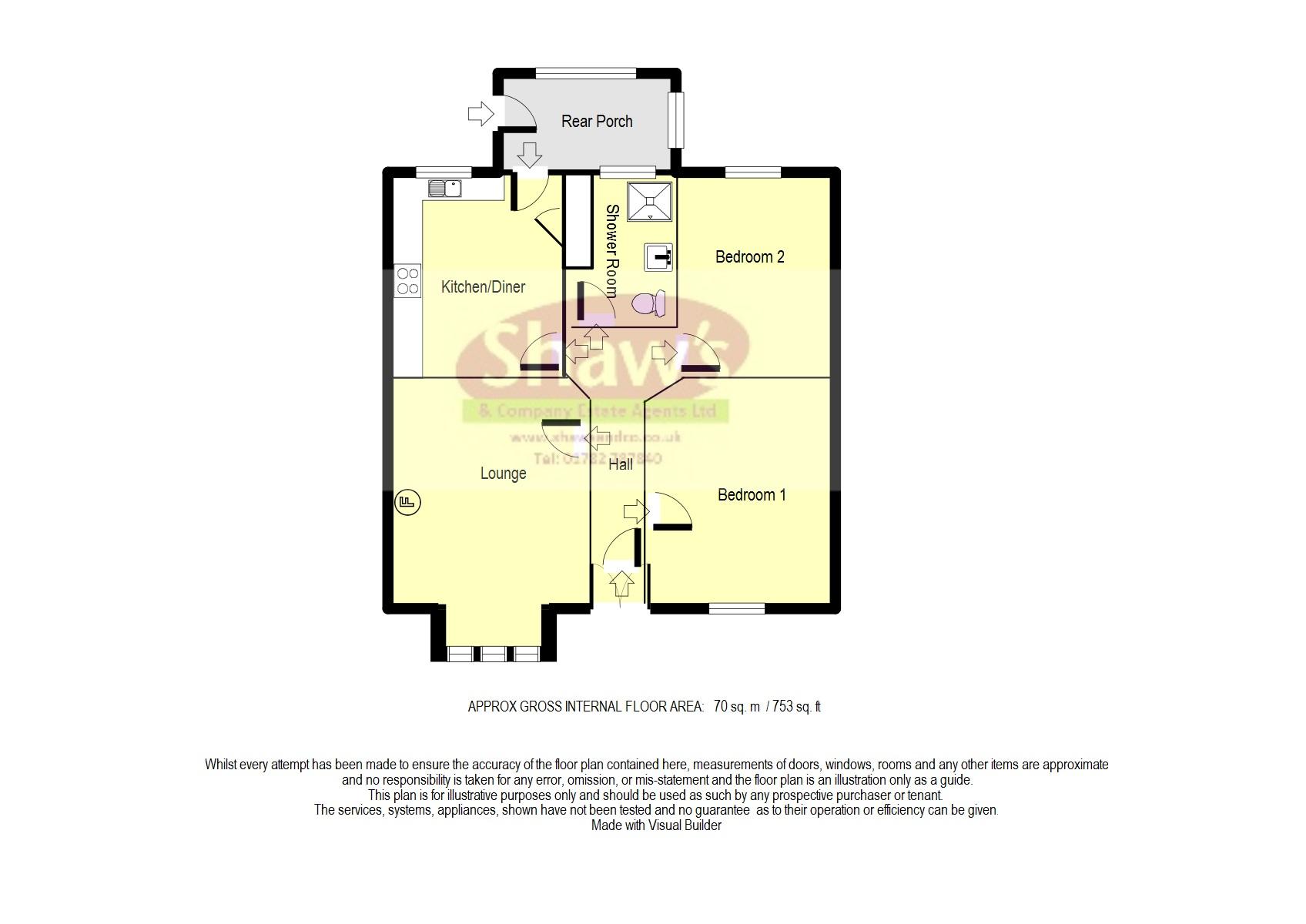

For what its worth, this is what my initial thoughts of doing would be to make it better (not an architect, just a internet random)
  • Currently the is not a good connection with the good space to the rear, have the living area to the rear as the extension, have a pitched roof in the extension area and have it open (vaulted ceiling) to make it a big space (my drawing below the kitchen / living room connection is poor.
  • Move the bedrooms to the front of the house rearranging internal walls.
  • big issues are what internal walls can you get rid of, and is the shower room movable, as it blocks up a far amount of rear access space.
  • You may want to consider leaving space for stairs in the future a loft conversion could happen over the existing house if it is high enough.

Thank you for taking the time to put that together, its an interesting idea.
I hadn't considered moving the bathroom because of it being extra work (on a budget very tight for first time buyers). I also hadn't thought about re-arranging internal walls because I don't mind how the current plan is but its worth taking into consideration. I figured that extending back on the currently property (full width) would work out easier and cheaper.
What are your thoughts on doing this in timber frame? I plan to render the entire house white (as a few have already done in the street) so the rear would match.
Link to comment
tbh i don't know how much extra work this would be and there is a big difference from drawing lines on a computer and actual walls (e.g structural requirements), you are in the best position to know what can and can't be moved, and if you want to.
but i think that the bathroom is in such a awkward location, i can't think of anyway that it can be kept in that location with a decent end result.
As for timber frame, not a clue, but a white render would modernise the look of the house.

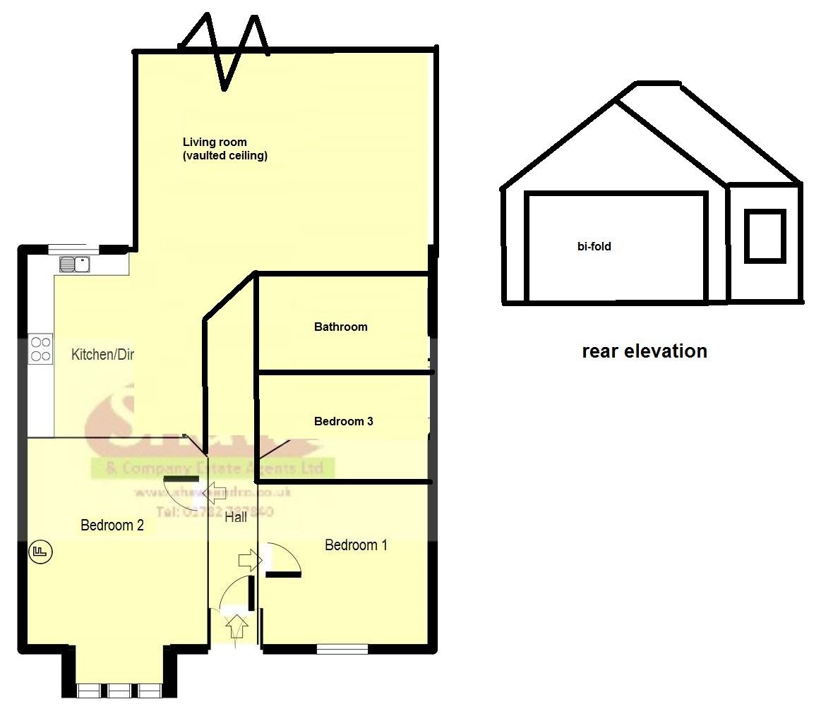

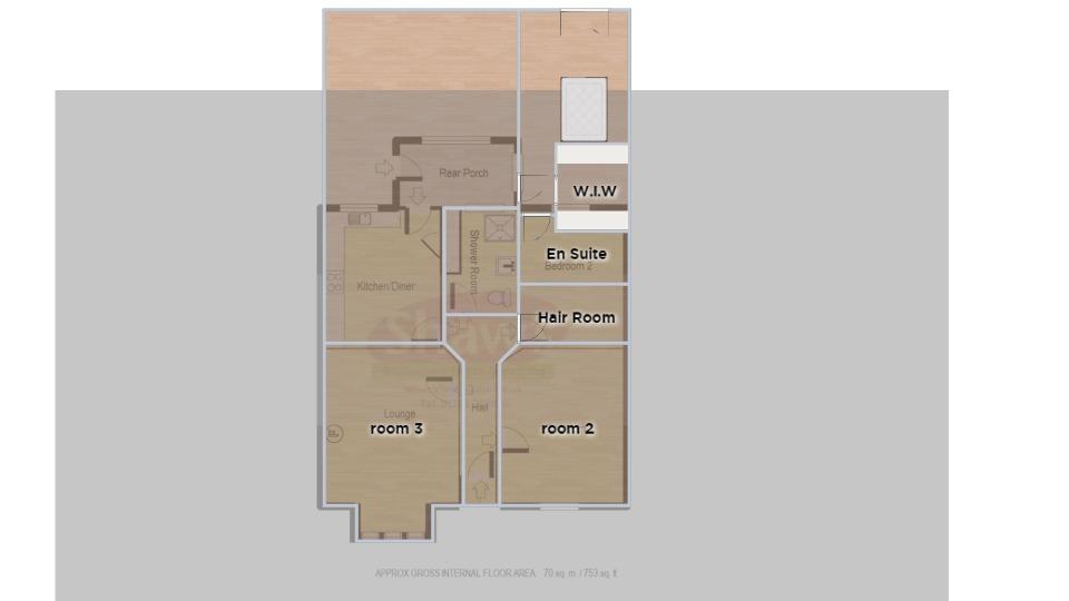

Hi all,
Back to my old thread here but we are a year on and the house mentioned above has been a dream for us.
Now we are looking at an extension, but I wanted an opinion from some of you.
I have attached a layout that I think would be nice (not exactly to scale, just a sketch up of an idea i have done.) I have put our current floorplan underneath so that you can see for reference the idea i am going for.
There are are a couple of things I'd like to do/keep listed below
  • If possible, avoid moving kitchen (back will be knocked out but will create an island type bar with the sink on with an open plan to the new lounge space) although if something really works better, I would do it.
  • We need to keep a hair room for my partners business (doesn't need to have windows)
  • The house has to become a 3 bed
  • The master bedroom (currently room 2) will ideally have an en suite & room 3 which is the lounge at the moment will become a bedroom (if the idea I go with sticks)
  • The open plan part is going to be some sort of vaulted ceiling with bi-fold doors onto the garden.
My main concern is that if I go with the design attached, when it comes round to having children, they will have their bedrooms at the front while the master is at the back. Would this be a concern to you guys if you were a) building the extension yourself or b) looking to buy the house with children? It's worth pointing out that we live in a really nice village area, not busy and we have the most fantastic neighbours.
Thanks for taking the time to read this
E

OK.
My general  comments are that it looks good to me - plumbing all close together in the plan for cost control etc,  and
1 - Make sure that the hairdressing room is suitable to have a chair for a chaperone (safeguarding) should children be served.
2 -  Alternative use for that room would probably be a utility, so just think about how you would do it with a washing machine, drying machine and drying area / pulley etc.
3 - You will want an accessible services closet  in the middle somewhere.

Thanks for the comments back.
I think this is the layout we will go for, next question is how we do the roof/ceiling. Does this type of design lend itself to a vaulted ceiling or would you suggest otherwise? you can see the roof as it is now from the images i posted last year.
Cheers,
E
Link to comment
When you talk about the roof/ceiling, are you referring to the new rear extension? If so, yes it could be vaulted either with a hipped roof to match existing or gable ended. I personally prefer vaulted roofs where the rooms they served is used as one. In other words, not having an open plan Kitchen of which half would have a flat ceiling and the other half vaulted. Starts messing with my OCD as to where you then position islands/breakfast bars and breakfast/dining tables, etc...
Btw, habitable rooms would need to provide adequate ventilation via an openable window and trickle vents. So the ‘hair room’ would need a window unless you were to call it a Coats cupboard prior to BR sign off and change it to what you want post BR sign off.
