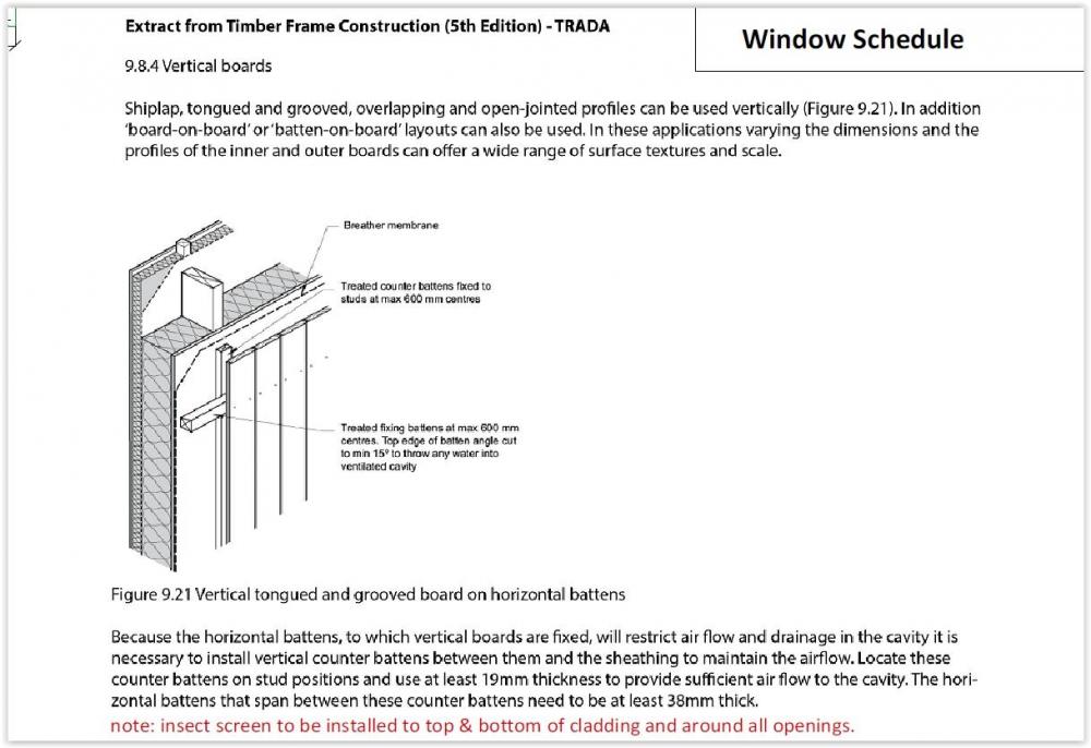

zoothorn Posted May 27, 2019 Author Share Posted May 27, 2019 Can someone help me out on this simple Q. If an inner course wall is built, say a TFrame, & I'm left to 'choose any manner of ways to clad the outside'.. Does a cavity -always- have to be incorporated between the two courses? and if I choose a nice stepped-vertical-cedar "cladding" for my outside.. what does it fix onto? I mean if there's a cavity (& I think its right that a modern wall has to have one) it can't be fixed it to the inner course. So what does it fix onto.. I can't visualise/ understand it. I can understand perfectly, if the outer course was block, or, if the inner course was block & the cladding fixed to this with no cavity between. Link to comment Share on other sites More sharing options...
Tennentslager Posted May 27, 2019 Share Posted May 27, 2019 Not that I’m any expert but you could have a single row of blocks and 145mm thick timbers to make the walls with OSB sheet on the outside then your vapour barrier on top of that batten this both horizontally and vertically and attach you cladding to the battens. this will create a rain screen and the battens create a cavity behind this for air movement insulation goes in between the 145mm timbers with plasterboard inside... @Peter and @Declan52 will tell you if I’m talking mince Link to comment Share on other sites More sharing options...

PeterW Posted May 27, 2019 Share Posted May 27, 2019 9 minutes ago, zoothorn said: Then, if so, I'm trying to understand how a wood cladding (not brick cladding) attatches to this cavity (it can't is my point- it can't attatch to thin air, so what does it attatch to?). The answer to this, is this ... 1 hour ago, Tennentslager said: and 145mm thick timbers to make the walls with OSB sheet on the outside then your vapour barrier on top of that batten this both horizontally and vertically and attach you cladding to the battens. this will create a rain screen and the battens create a cavity behind this for air movement From the inside: plasterboard batten vapor control layer (plastic sheet) 145mm timbers packed with insulation OSB breather membrane vertical batten horizontal batten render board render Make sense now .?? Link to comment Share on other sites More sharing options...

zoothorn Posted May 27, 2019 Author Share Posted May 27, 2019 13 minutes ago, PeterW said: The answer to this, is this ... From the inside: plasterboard batten vapor control layer (plastic sheet) 145mm timbers packed with insulation OSB breather membrane vertical batten horizontal batten render board render Make sense now .?? More sense, thanks.. but where is the 50mm cavity tho?? I hadn't heard of a render board I must say I thought all modern walls had to be 2 courses, with a cavity between, as a certainty. Link to comment Share on other sites More sharing options...
PeterW Posted May 27, 2019 Share Posted May 27, 2019 1 minute ago, zoothorn said: More sense, thanks.. but where is the 50mm cavity tho?? I hadn't heard of a render board I must say I thought all modern walls had to be 2 courses, with a cavity between, as a certainty. Cavity is here : 17 minutes ago, PeterW said: vertical batten horizontal batten 2 x 50x25 battens at 90 degrees to each other and you have a 50mm cavity. You don't need a cavity anyway so not sure where you get that from. If it’s from a book, then it’s making general statements that aren’t correct unless it covers each build method. Link to comment Share on other sites More sharing options...

zoothorn Posted May 27, 2019 Author Share Posted May 27, 2019 2 minutes ago, PeterW said: Cavity is here : 2 x 50x25 battens at 90 degrees to each other and you have a 50mm cavity. You don't need a cavity anyway so not sure where you get that from. If it’s from a book, then it’s making general statements that aren’t correct unless it covers each build method. I don't need a cavity? so what do I need then? how is anyone like me possibly in a position to choose what kind of wall construction to go with? or do I just say 'right, no cavity- so then I want a single block wall'. simple as that. can I do that? Link to comment Share on other sites More sharing options...
PeterW Posted May 27, 2019 Share Posted May 27, 2019 Just now, zoothorn said: I don't need a cavity? so what do I need then? how is anyone like me possibly in a position to choose what kind of wall construction to go with? or do I just say 'right, no cavity- so then I want a single block wall'. simple as that. can I do that? No ...! Not you... Read my post carefully. It is not a requirement to have a cavity, as in every construction must have one. There are build methods that mean you don’t need them , such as ICF, and even some timber frames use direct clad such as how @ProDave has done his. You could build a single block skin and then clad it with External Wall Insulation (EWI) and render that - perfectly legal to do so long as you meet building regs insulation levels. Not sure how easy or cheap it would be to do. Go back to my question though, what’s your budget as that could dictate the method. Link to comment Share on other sites More sharing options...

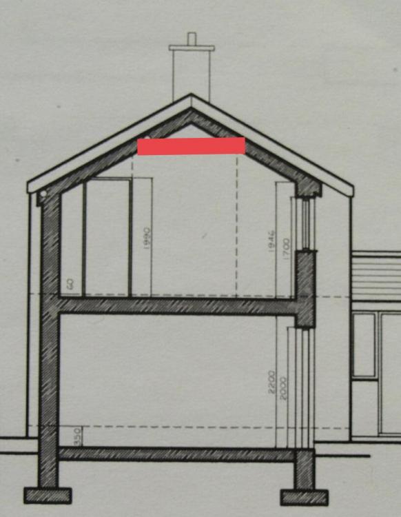

zoothorn Posted May 27, 2019 Author Share Posted May 27, 2019 (edited) @PeterW ok thanks. I must say this is amazing to learn I don't neccessarily need a cavity. You see I've worked on such a build (17yr old), witnessed such builds as a single story extension ~10 yrs ago, see only eg's of such builds around, & my plans submitted suggest this build either has, or will have, such cavity-based builds. So you see I had no other idea, than this was what regs stipulate for extention walls for a decade+ now. Ok I need to reasses I think with this knowledge. My budget is £30k with vat included. My rough idea was to do as £best I possibly could: get builder to do main stuff: TF inner course 3x walls, floor, 2nd story, roof, 2 windows/ 2 doors.. all up to watertight. Then I do the outer course either myself (wood cladding all I could do, I'd think) or get s'one else cheaper to do. I pB inside. I do wiring. I finish off skirting, decorate etc. If all walls are TF plus timber cladding, I'm worried about one thing: structural solidity. I get hit with full force weather at this spot- its sits like a duck in this respect. So if I -could- I'd be much happier with a BLOCK inner course instead. Edited May 27, 2019 by zoothorn Link to comment Share on other sites More sharing options...
PeterW Posted May 27, 2019 Share Posted May 27, 2019 You could do that for change of £20k. Link to comment Share on other sites More sharing options...
zoothorn Posted May 27, 2019 Author Share Posted May 27, 2019 That's very encouraging PeterW. (you could do that.. you mean me do it tho?) Link to comment Share on other sites More sharing options...
PeterW Posted May 27, 2019 Share Posted May 27, 2019 What I mean is that there isn’t that much to do, and whatever route you go, £20k should see you done and finished. Is the space below ie the ground floor room, part of the house or an unheated workshop ..? May make a difference for BRegs. Whats the actual purpose of the extension..? Link to comment Share on other sites More sharing options...
zoothorn Posted May 27, 2019 Author Share Posted May 27, 2019 Unheated workshop exactly Peter, one door only.. but called a 'storeroom' (dont want regs to know a portion of my work done in here- no need to know). Upper story really to make very best use of area above (& a very fine south view from french windows): this room yes part of house, via a knock-thru door from my bedroom. A 'study' its called, but a 3rd bedroom best 'sold' as. Link to comment Share on other sites More sharing options...
PeterW Posted May 27, 2019 Share Posted May 27, 2019 So it’s a workshop ..? Do you need it to be heated ..? This does make stuff slightly easier but also complicated in other ways ..! You will need to insulate the walls but tbh you could get away with just full filling the walls with Rockwool, and the same with the floor of the room above. Then clad with celotex and you’re probably reducing the heat loss a lot. If it’s an unheated space then still consider some insulation in the concrete floor but you can reduce it. This is purely down to comfort. Link to comment Share on other sites More sharing options...
zoothorn Posted May 27, 2019 Author Share Posted May 27, 2019 No, I don't need it to be heated (only 10 hrs per week in it too, all 30 min bursts). The work tho will be routing: noisey & I'm close to road, so I have in mind ideally some wall density plus rockwool for room1 to appease sod n'bors complaining to authorities. A thick door is my idea too. I thought regs would just enforce me to put 100mm insulation in the floor, even it called a 'storeroom' on plans.. but if it -saves a good chunk- & helps height without I'd be fine: if you might recall my mainroom ceiling is terribly low.. & replicating same ceiling H across in this "wing" means a ceiling barely 6" above my head- in a small room it'll be oppressive (main room's big). So idea is build a foot down. thanks, zoot Link to comment Share on other sites More sharing options...
PeterW Posted May 27, 2019 Share Posted May 27, 2019 Thick door may not help that much but a lobby door would if you could move it so you had 2 doors at right angles. Got a dimensioned floor plan ..? Link to comment Share on other sites More sharing options...
zoothorn Posted May 28, 2019 Author Share Posted May 28, 2019 (edited) On 27/05/2019 at 21:50, PeterW said: Thick door may not help that much but a lobby door would if you could move it so you had 2 doors at right angles. Got a dimensioned floor plan ..? Yes below. Tbh the door I can fashion it thicker, redo it even in time if very ''leaky".. or make a sliding panel across the door, inside, to baffle the noise maybe even. I can cross this bridge later/ last etc. Edited May 29, 2019 by zoothorn Link to comment Share on other sites More sharing options...
