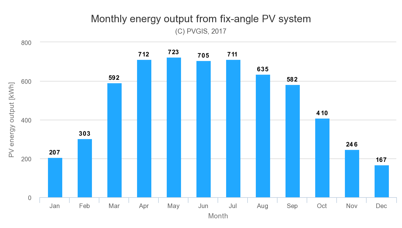

Posted
So, I just got another quote at 4.5K for a 16 panel 305W system which seems pretty good. However I expect they are expecting a normal roof and not a wooden one so not sure how thats gonna work. This is their calculation attached.
Posted
You can do your own calculation using PVGIS if you wish.  It's probably what some of the PV companies do anyway.  PVGIS is here: http://re.jrc.ec.europa.eu/pvg_tools/en/tools.html#PVP  You just enter your location, the pitch of your roof, the direction the roof faces and the installed peak power of the PV system and it will give you loads of pretty accurate data on performance.
Remember that you'll probably struggle to use more than about half the annual output, as periods of high generation aren't likely to coincide with periods when you can use all that generation.  Despite having an electric car, and an all-electric house, with electric hot water storage, I'm lucky if I can use even half our daily generation; much of the time I'm finding that the hot water system is fully charged, and my car is fully charged, by mid-morning, so excess generation is just being exported to the grid from then on.

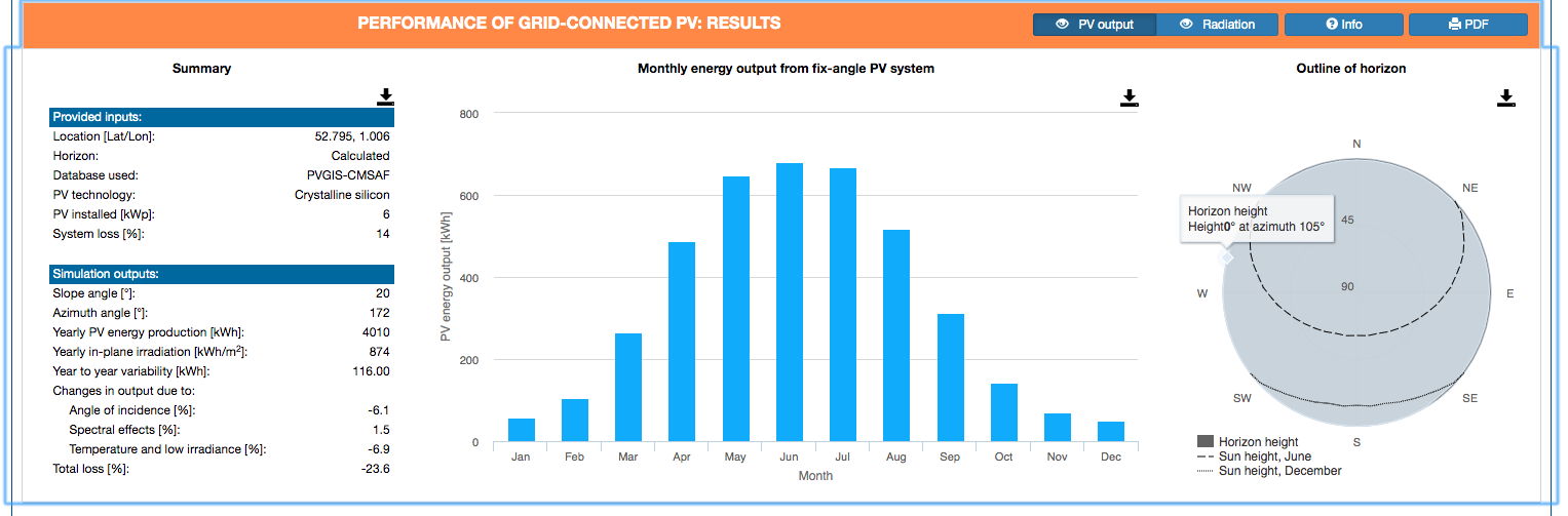

Hi @JSHarris,
where could I get more information about your hot water /PV setup - I'd like to get my head into the details to see if its still worth the effort of us without the FIT.
Looking at that link you shared with a 6K systems we would generate 4010K a year (attached)
Many thanks
Posted
every time i look at it comes back the same --you must use ALL the pv and then consider what itwould have cost you same as bought in
so 4010kw x 0.16p per unit =£641.6 per year  you save if you had bought it in -
start adding E7  where buy rate is much lower  and not being able to use it all --calculation just gets worse
tell me if i,m wrong

Our system has 25 off black PV panels set into the roof using GSE Integration in-roof mounts.  These are rated at 6.25 kWp and feed a 6 kW Aurora Power One inverter.  Because the maximum power is over the 16 A per phase allowable for connection without consent, we had to get consent from the DNO (in our case SSE) to be able to install this system.
I have a home made excess PV generation power diverter, that senses when we are exporting electricity and switches a variable amount of power to the water heating system.  The water heating uses a Sunamp UniQ eHW 9, which uses phase change storage to allow up to about 10 kWh of heat to be stored in a small volume (roughly half the volume of a washing machine).  The heating element in this system is very like an immersion heater, with the same power rating.
The Sunamp controller determines when the Sunamp heating element can accept power, and the excess PV diverter can then just heat the element as required.  In winter, when we have periods of several days with little or no useful PV generation, I have a boost time switch, which comes on in the early hours, during the E7 off-peak period, to charge the Sunamp if it hasn't been charged during the day.  This ensures we always have hot water, even during cloudy periods.
The Sunamp heats the hot water rather like a powerful combi boiler.  It only heats water on demand, as it has an internal heat exchanger that can deliver over 30 kW to the incoming cold, mains pressure, hot water, delivering hot water at around 55°C.  We have a TMV on the output to mix this down with cold water to about 45°C which we find is about right for hot water from the taps etc.
Out of interest, here's the PVGIS plot for our 6.25 kW system, which faces SSW and is at 45° roof pitch (it delivers about 6,000 kWh/year):
  • Thanks 1
