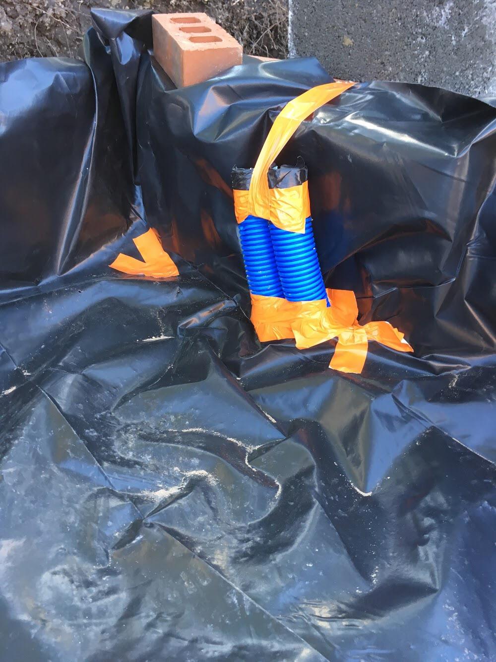

PeterW Posted May 15, 2019 Share Posted May 15, 2019 Not the best picture but you can see how the two ducts here come through the DPM. This was just before the concrete was poured - both drop down below the ground level in a slow bend. The orange tape is where the DPM was sealed to the ducts. Black tape used to cap them off so the concrete didn’t end up down the duct !! 1 Link to comment Share on other sites More sharing options...

gwebstech Posted May 15, 2019 Author Share Posted May 15, 2019 33 minutes ago, PeterW said: Not the best picture but you can see how the two ducts here come through the DPM. This was just before the concrete was poured - both drop down below the ground level in a slow bend. The orange tape is where the DPM was sealed to the ducts. Black tape used to cap them off so the concrete didn’t end up down the duct !! thanks mate, this is what i was thinking is theo nly way to do it. Im assuming BCO passed this? my point was that you have to break the membrane somewhere which i thought wold cause damp/moisture issues Link to comment Share on other sites More sharing options...

Russell griffiths Posted May 15, 2019 Share Posted May 15, 2019 You will need to cut a hole in your membrane in more than just one place. Every poo pipe water main bt duct going out for any outside services it it has been done like this forever, don’t worry too much tape them up nicely and you won’t have a problem. 1 Link to comment Share on other sites More sharing options...
