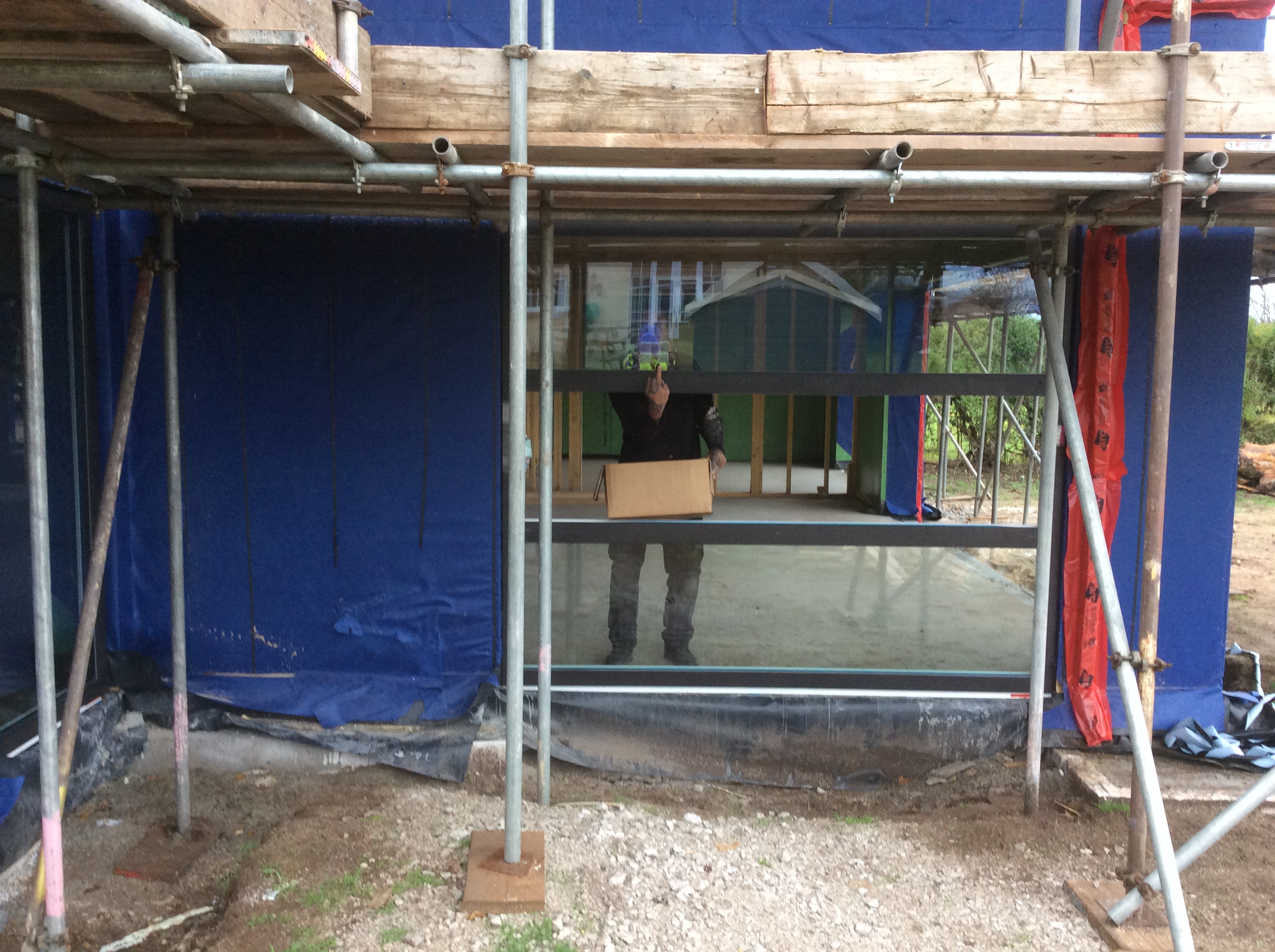

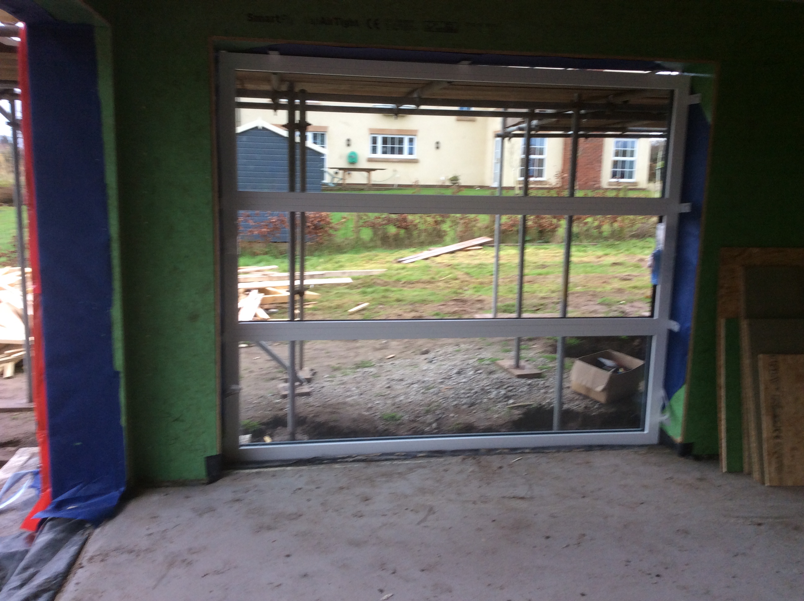

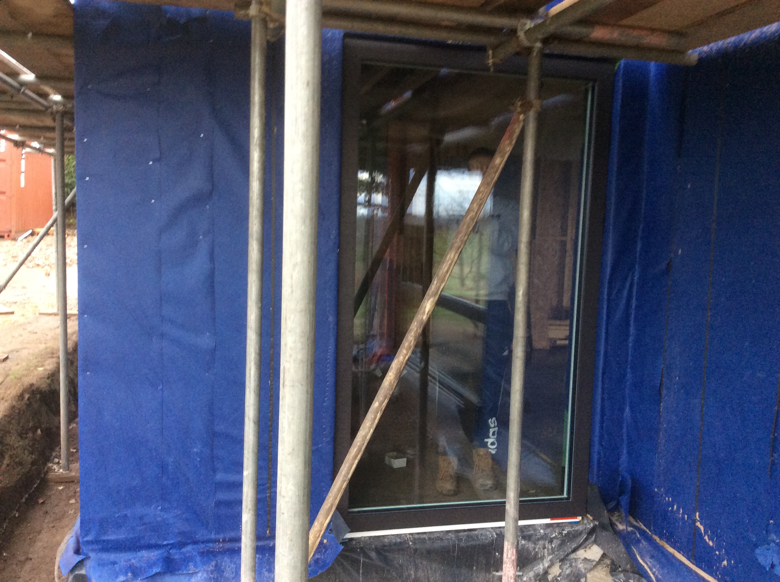

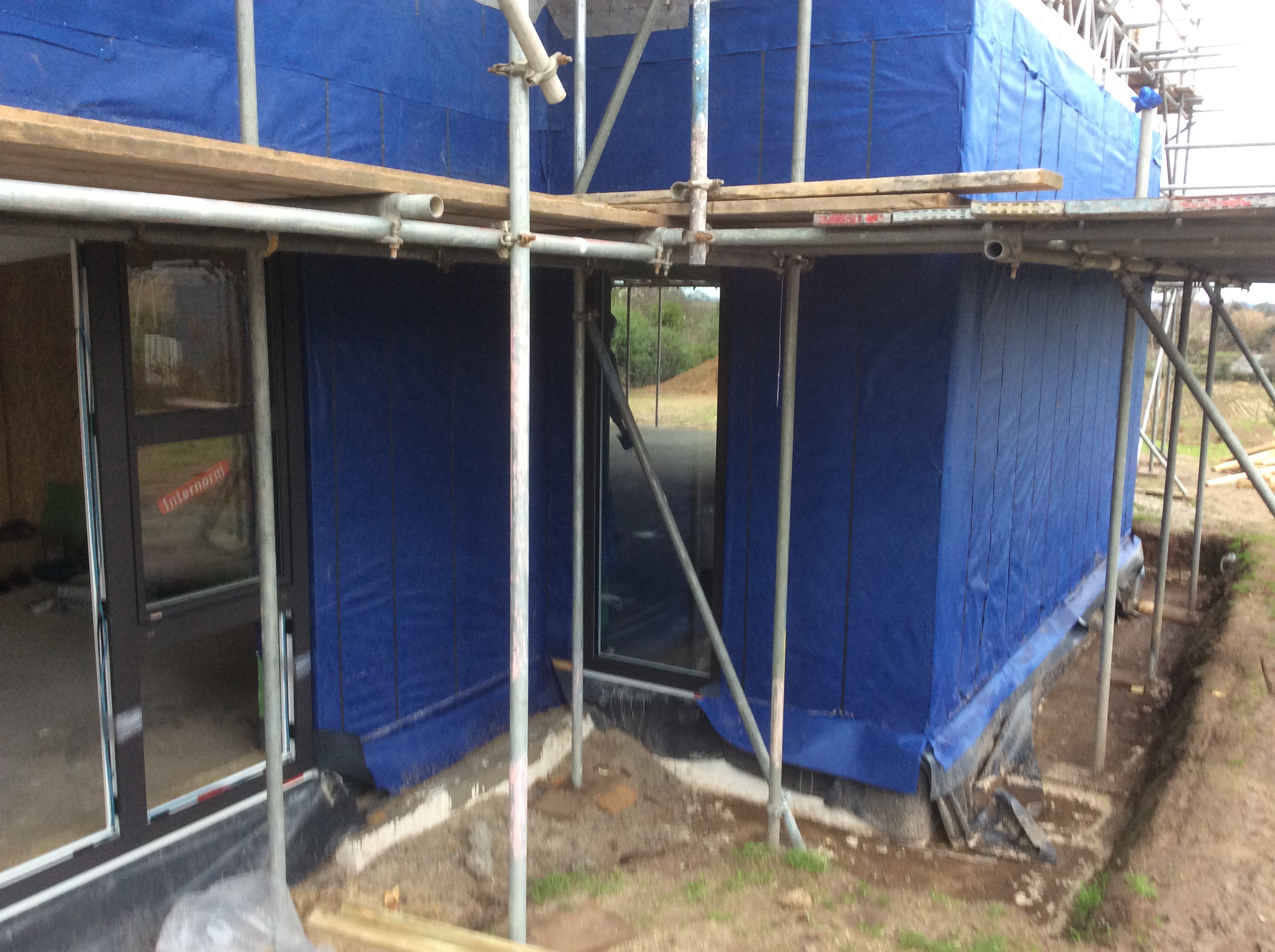

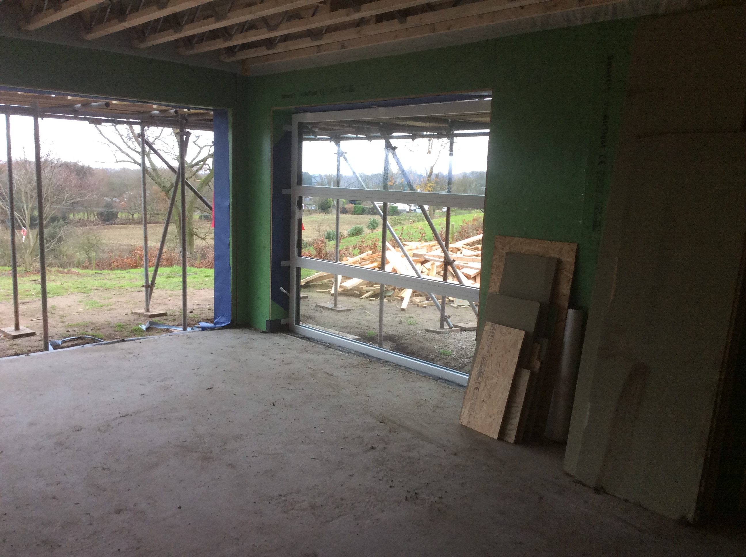

worldwidewebs Posted December 9, 2016 Author Share Posted December 9, 2016 Windows are here!!!! 1 Link to comment Share on other sites More sharing options...
ProDave Posted December 9, 2016 Share Posted December 9, 2016 What's the hand signal in picture 3 ? Link to comment Share on other sites More sharing options...
worldwidewebs Posted December 9, 2016 Author Share Posted December 9, 2016 Just now, ProDave said: What's the hand signal in picture 3 ? I think that was the first window to be fitted Link to comment Share on other sites More sharing options...
