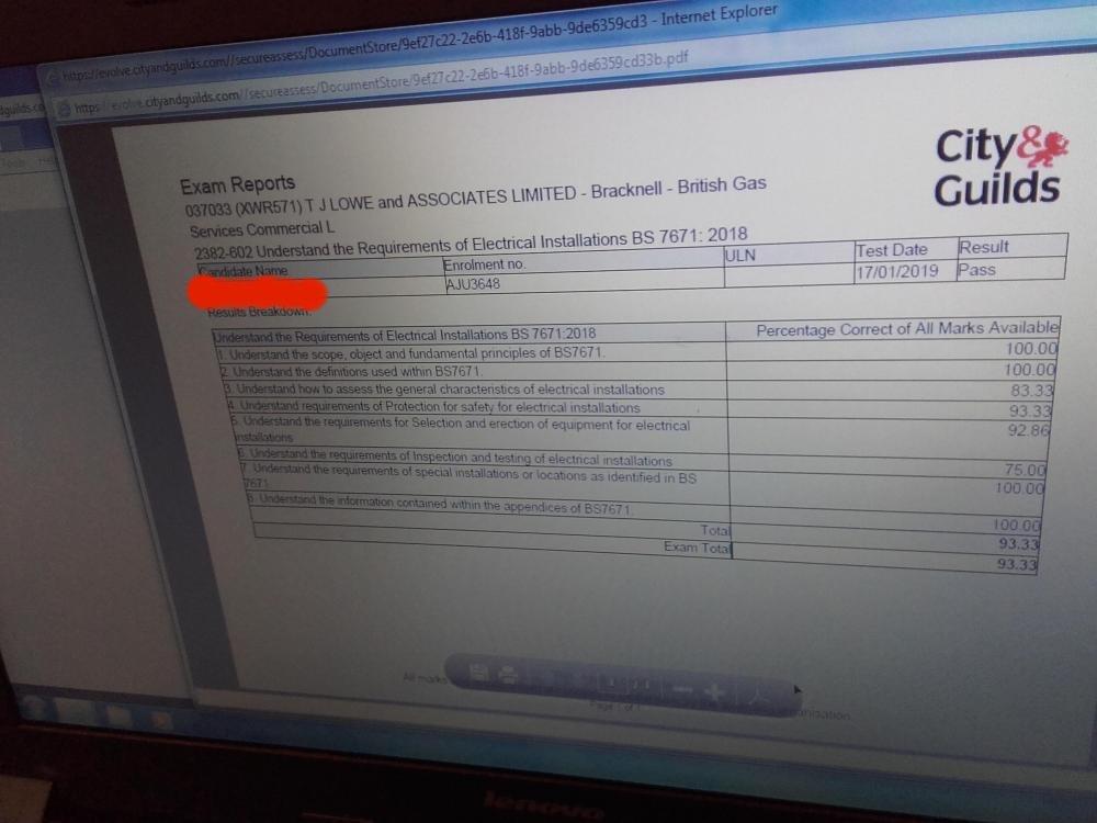

plastering into the wall breaks all sorts of rules ----NO JOINTS in cables especially not in walls
I don,t make the rules and i,m sure it will be fine
Please point me at where it says that in the regs...I've a copy in front of me.
20190117_165738.thumb.jpg.499a30c70b6df80d4113bd59810ea2da.jpg.55d6daf4bfda66289fb19ed7c8ebf4b5.jpg
Try 526.3 (iv) that this is acceptable.
Edited by Onoff

Not going to argue with you. I can point to the exact reg that says this can be done. Anyway the "regs" are not statutory (but can be used as a defence in law). Anyone who said the "good jointed cable" was illegal was likely talking out of their arse and on the fiddle. Disagree entirely ref the first place any problem is going to happen is a well made joint. It won't be a properly done crimp it'll be a screw terminal.
Link to comment
Share on other sites
7 minutes ago, scottishjohn said:
I can,t
but i can tell you form experience with a house we rented to council for battered women +kids
their sparkies came in had all the switchs out etc and found a good jointed cable and told us that was illegal  and proceeded to pull a complete  new cable in  at their  own expense .
I queried if they could not use a JB --yes but only if it servicable --which inside a wall is not
It could be a common sense thing ,but not the impression they left me with .
we all know that any joint no matter how well made is the most likely first place any  problem is going to happen  .
unless you got a 150m  run of cable why do it anyway ?
Joints in  areas that are not accessible are absolutely fine, as long as they are not things like screw terminals.  Crimps, soldered and heat sleeved, or Wagos in a box, are all classified as being compliant with 526.3:
Quote
526.3
Every connection shall be accessible for inspection, testing and maintenance, except for the following:
(i)   A joint designed to be buried in the ground
(ii)  A compound-filled or encapsulated joint
(iii)  A connection  between  a  cold  tail and  the  heating element as  in  ceiling heating,  floor  heating or a  trace heating system
(iv)  A joint made by welding, soldering, brazing or appropriate compression tool
(v)  Joints or connections made in equipment by the manufacturer of the product and not intended to be inspected or maintained
(vi)  Equipment complying with BS5733  for a  maintenance-free accessory and marked  with the  symbol image.png.97b32f8c2104c4c213e12e97d4b53e6d.png and installed in accordance with the manufacturer's instructions.
Link to comment
