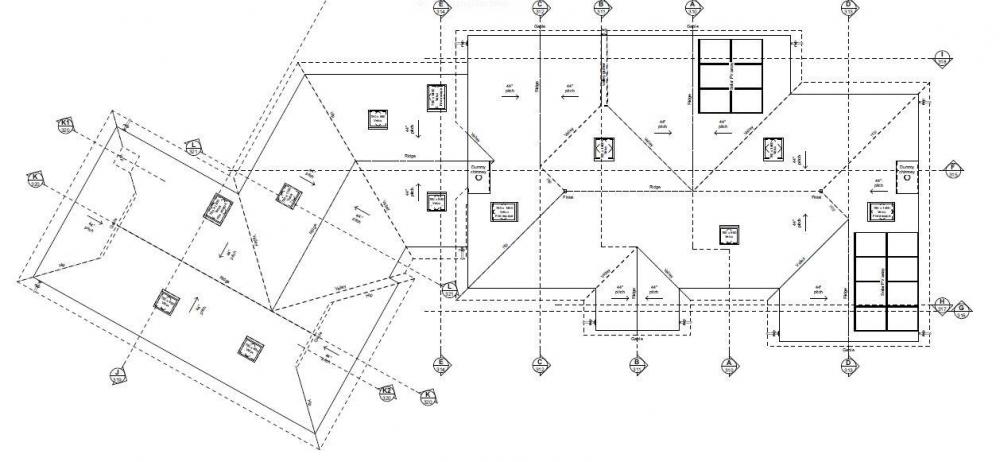

Vijay Posted May 4, 2019 Share Posted May 4, 2019 Morning, Really need some advice and thoughts on my roof construction. It's not the simplest of roofs and is quite large. There's 2 levels, over to the left is on top of single storey and the middle/right is on top of 2 storey. They are all habitable rooms so were designed as room in roof attic trusses and are designed as a cold roof. The roof is to have 12mm OSB sarking. I guess my question is would you go with this construction method? Is there a better of of building this roof or a better bang for your buck method? I also contacted Thermoroof after spotting it on the latest series of Grand Designs, but they never bothered replying (I've just emailed them again). Is SIPS worth considering for a roof? My guess is it would work out flipping expensive but maybe balance out by the time I've bought all the trusses/insulation/sarking? Are there any other systems worth considering? This is the layout Link to comment Share on other sites More sharing options...

scottishjohn Posted May 4, 2019 Share Posted May 4, 2019 (edited) 1 hour ago, Vijay said: Is SIPS worth considering for a roof? limited span without extra support and no trusses with sips roof about 4.5-5m from memory , is often though used Edited May 4, 2019 by scottishjohn Link to comment Share on other sites More sharing options...
PeterW Posted May 4, 2019 Share Posted May 4, 2019 What year building regs are you using ..? and what’s the u-Value in the DER/SAP..? For ease and simplicity I would go with Attic trusses as you get both the floor and the roof in one hit. Easy and simple to manage, any crew can do it. You also get a full set of plans and the design done for you - most if not all will do a site survey prior to manufacture so you get an accurate roof. Some now also use Wolf/Posi systems for the trusses so you can get very deep roof construction that is very light. I wouldn’t go with any sort of panel system with that design - too many odd angles and you can’t tweak them the same way you can move a piece of OSB etc. Link to comment Share on other sites More sharing options...

Simplysimon Posted May 4, 2019 Share Posted May 4, 2019 as stated previously design done for you, you could get a joiner to build it taditionally but engineers don't like that. it could be done with i beams but would need re-engineered for ridge loading but would allow you to blow insulation as opposed to cutting and fitting. so for simplicity as you say, stick with trusses. buy your insulation from seconds and co. if you have the insulation prior to trusses arriving then have them cut nice and straight and to size and if fillets cut and fitted to side of trusses, then the insulation can be dropped in as roof erected prior to sheeting. Link to comment Share on other sites More sharing options...
