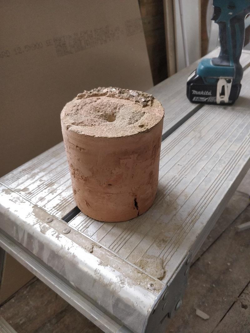

Pocster Posted April 29, 2019 Posted April 29, 2019 Guys ! Decided to start Monday with an easy job ( or so I thought ) Need to core 150mm hole . Have core drill and cutter . Vibrates like f - as you can see from the attempt it’s going all over the place . Have ‘arbour ‘ - think that’s what it is called . I don’t take out the drill bit do I ? As I assume that acts as a guide . Any advice welcome !
Pocster Posted April 29, 2019 Author Posted April 29, 2019 9 minutes ago, PeterW said: Have you got it switched to hammer..? Nope ! First thing I checked . All the videos make it look easy ! - assume they are cutting through thermalite ! I’m knackered and about 1cm in !!!
Pocster Posted April 29, 2019 Author Posted April 29, 2019 Now drill cuts out motor runs but no rotation . Assume it had overheated but feels cool . 2cm in only another 18 to go !!!

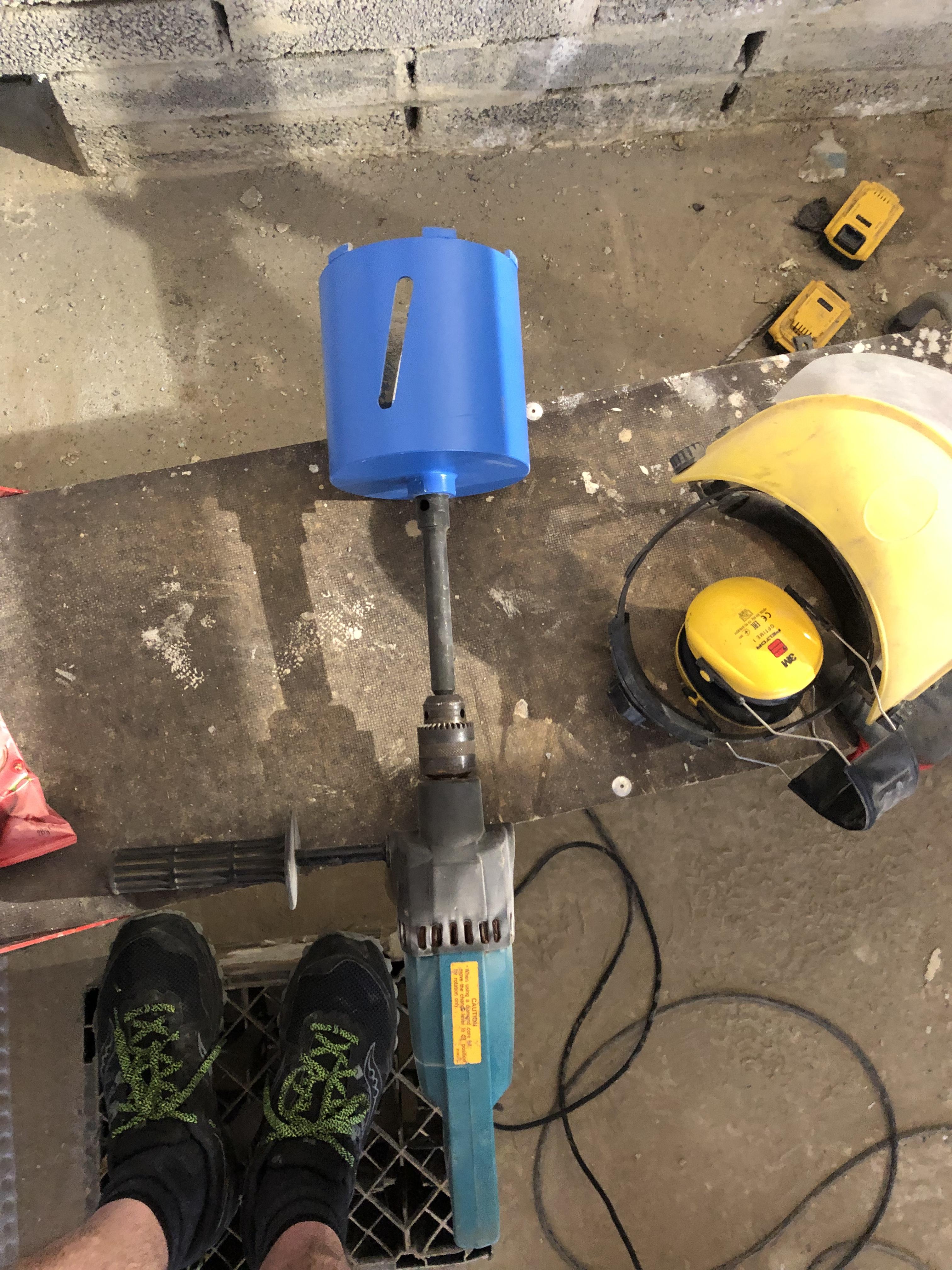

Declan52 Posted April 29, 2019 Posted April 29, 2019 I would say that bit isn't helping. There isn't much of the diamond stuff on it. https://www.redbanduk.co.uk/102-to-152mm-o-d-wet-diamond-core-bit-1-1-4-unc-female You would have been better hiring a complete unit like this pro drill and bit n this page. https://www.hss.com/hire/c/breaking-and-drilling/diamond-drills 1

AdamSee Posted April 29, 2019 Posted April 29, 2019 (edited) I've had to do a few core holes now. My advice is 1- get someone else to do it or 2 - You start with a pilot hole using drill bit of same size as the core bit pilot. Then using a drill with a clutch but without a hammer setting, push firmly, try to keep is going fast and it will start to cut a sharp line. once about 10 - 15mm in. Take out the drill and remove the core pilot bit. Then carry on as you were. If it start to jam when you get deeper it will be because you've gone off on the piss slightly. Best bet there is to withdraw the drill and slowly go back in regrinding the surface slightly larger/straighter. Aim to keep the drill going fast at a low pressure rather than slow with high pressure. You get a knack for it after a while. Edited April 29, 2019 by AdamSee
Pocster Posted April 29, 2019 Author Posted April 29, 2019 3 minutes ago, Declan52 said: I would say that bit isn't helping. There isn't much of the diamond stuff on it. https://www.redbanduk.co.uk/102-to-152mm-o-d-wet-diamond-core-bit-1-1-4-unc-female You would have been better hiring a complete unit like this pro drill and bit n this page. https://www.hss.com/hire/c/breaking-and-drilling/diamond-drills And there I was being ‘clever’ buying a 2nd hand Makita core drill and new core bits . Almost at half way - knackered lol . Will take my time ( like I have a choice ) and just get this 1 home done today .

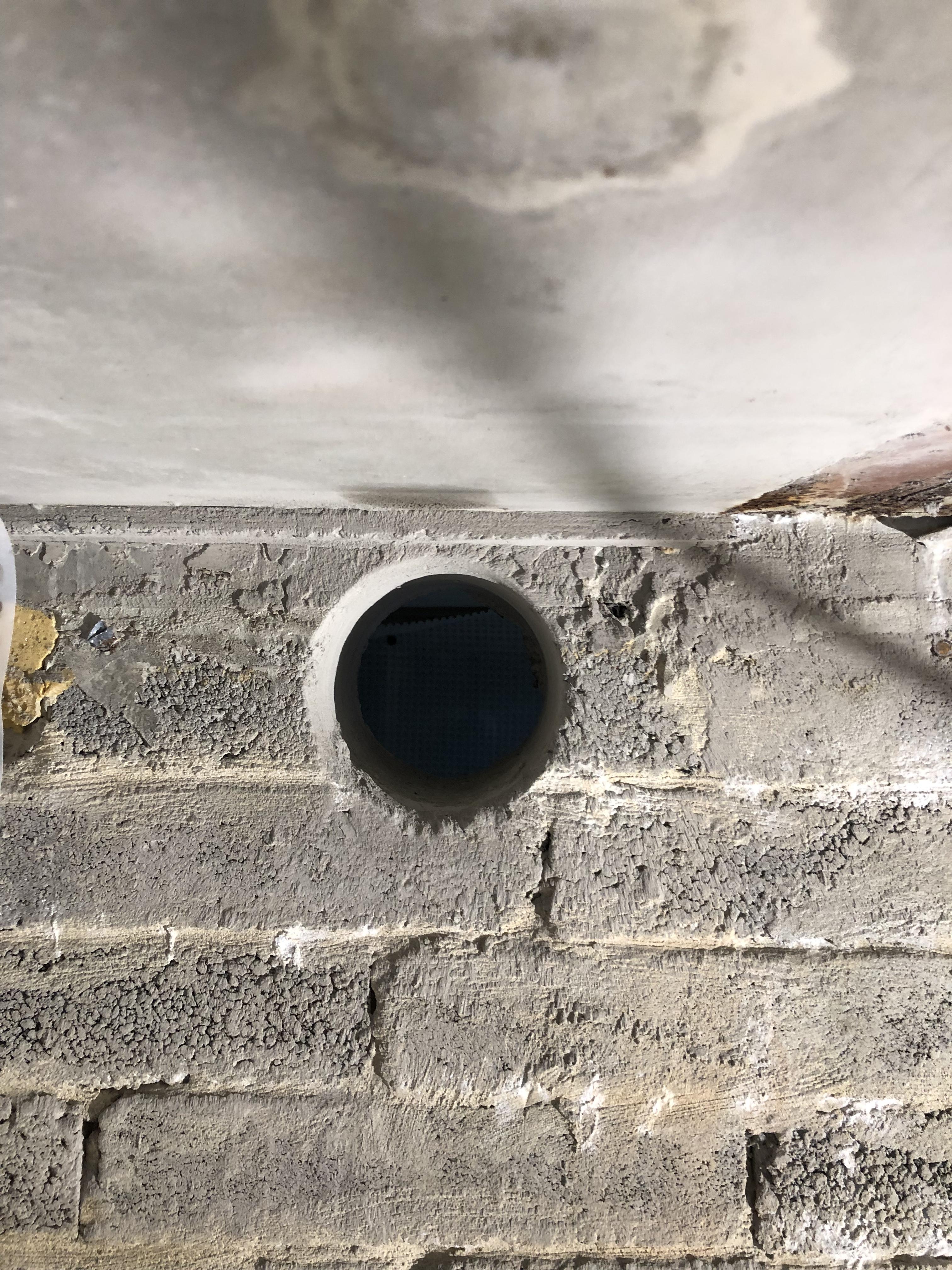

AdamSee Posted April 29, 2019 Posted April 29, 2019 Congratulations you've done it! So how long did it take to do one? Just out of curiosity....why do you need to do another 18 holes? you making a weird crazy golf setup of something? 1
Pocster Posted April 29, 2019 Author Posted April 29, 2019 (edited) 12 minutes ago, AdamSee said: Congratulations you've done it! So how long did it take to do one? Just out of curiosity....why do you need to do another 18 holes? you making a weird crazy golf setup of something? This is the largest . 150mm for pipework to ASHP . They also need another 100mm one for the ufh pipework . So worst one done . Took about 4 hours in total with rests ? Edited April 29, 2019 by pocster

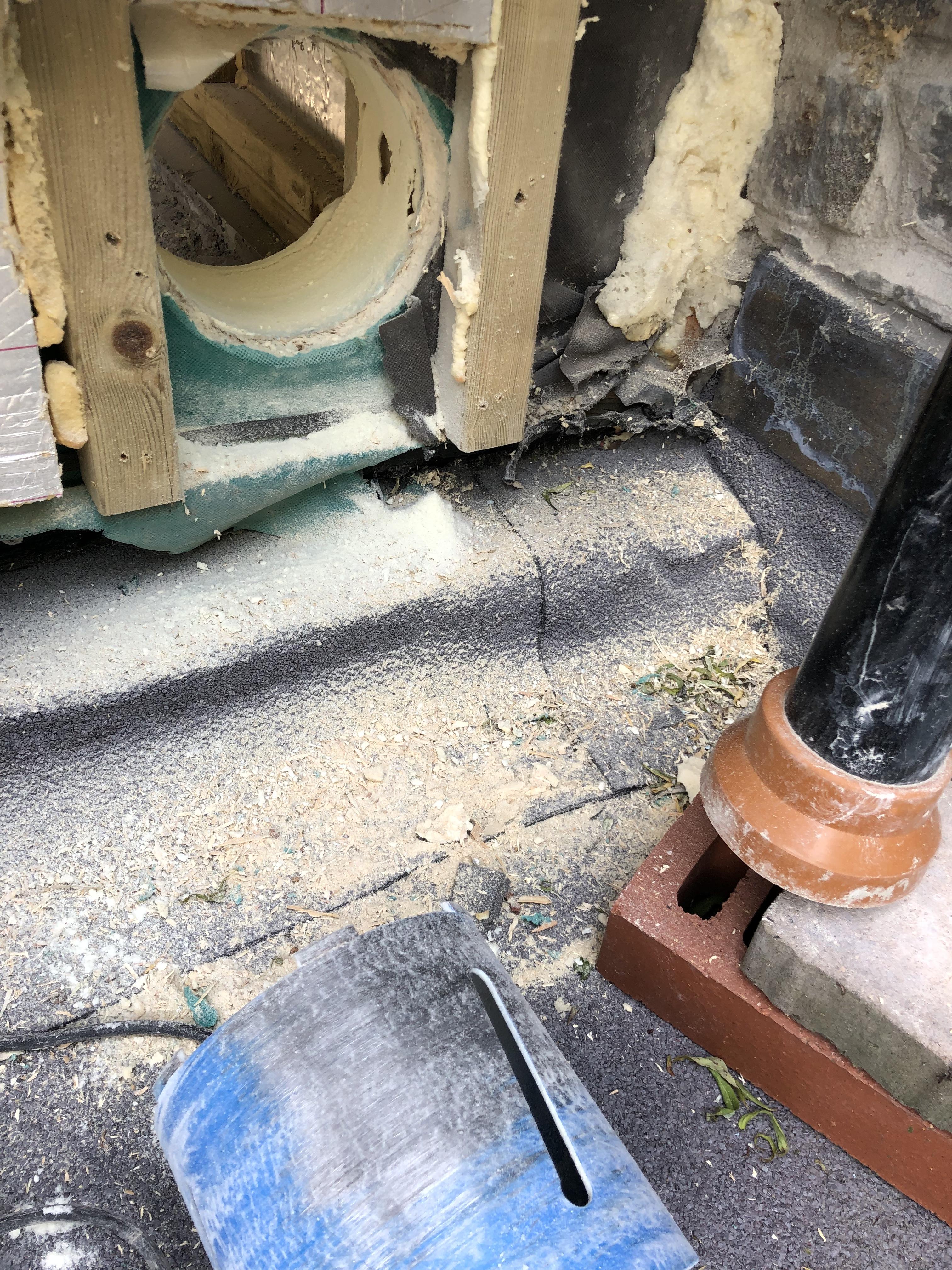

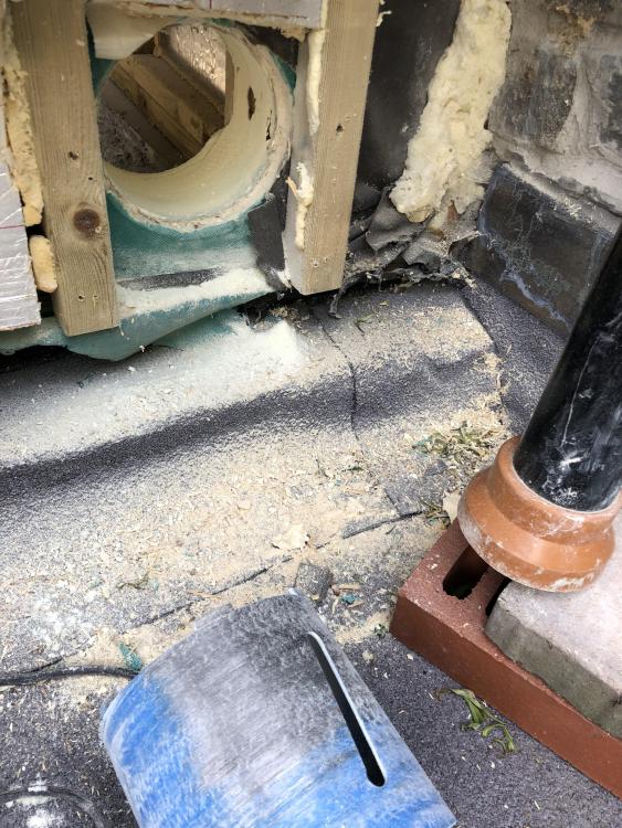

Pocster Posted April 30, 2019 Author Posted April 30, 2019 An easy 150mm because it was through timber frame . This is for ASHP pipework
dpmiller Posted April 30, 2019 Posted April 30, 2019 looking at the way the paint is worn off that cutter, has it been dropped or bent?
Pocster Posted April 30, 2019 Author Posted April 30, 2019 1 hour ago, dpmiller said: looking at the way the paint is worn off that cutter, has it been dropped or bent? Nope ; it just vibrates like mad !
