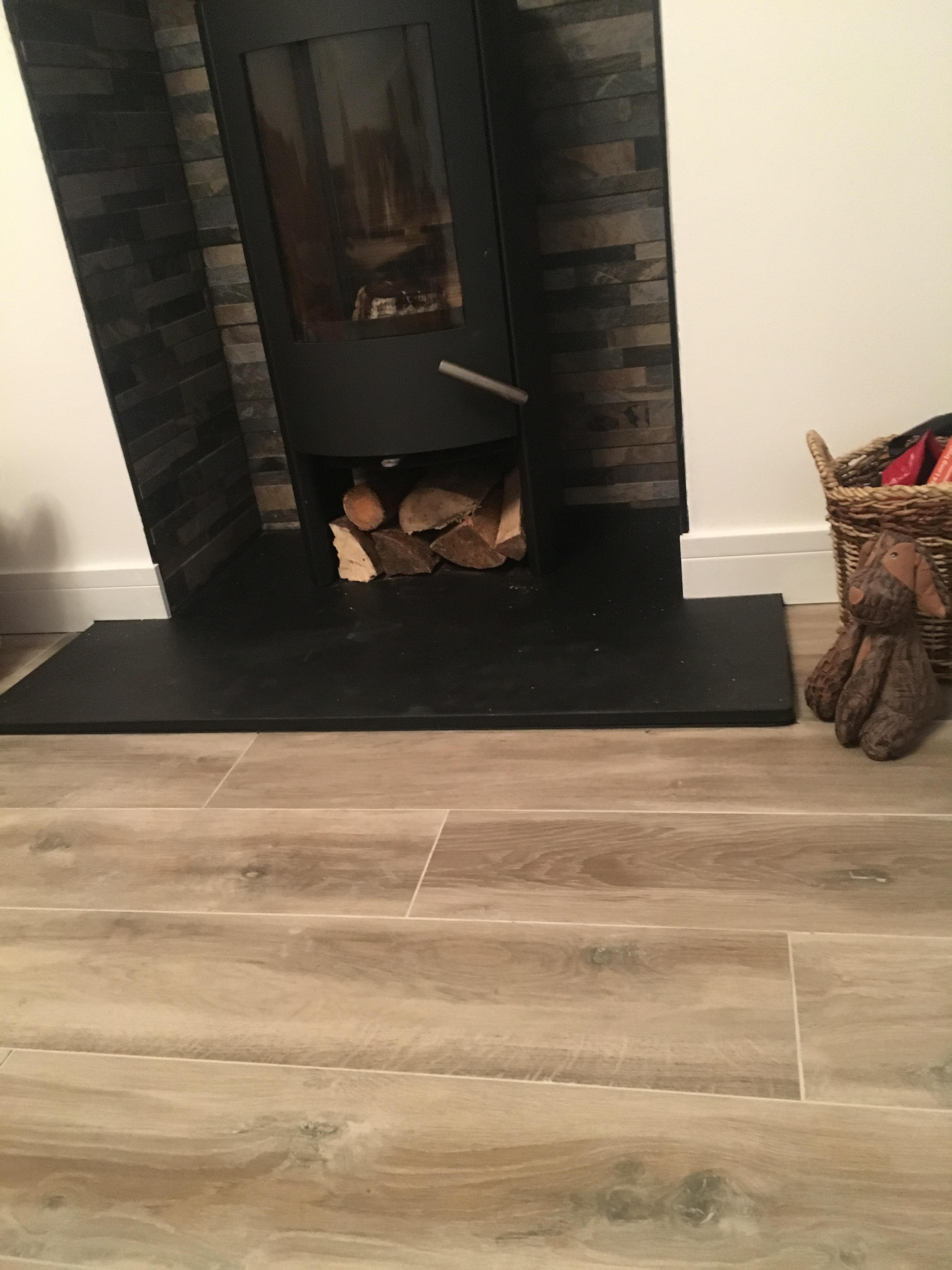

nod Posted April 26, 2019 Posted April 26, 2019 A T shaped piece is exspensive But looks great I’m a tiler but decided to cough up the £290 quid for a T shaped Black Slate Though it does look nice
nod Posted April 26, 2019 Posted April 26, 2019 4 minutes ago, nod said: A T shaped piece is exspensive But looks great I’m a tiler but decided to cough up the £290 quid for a T shaped Black Slate Though it does look nice The main problem with tiles is the edge isn’t finished unless you build an upstanding Say 100 mil

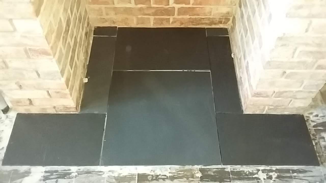

bassanclan Posted April 26, 2019 Posted April 26, 2019 Slate slabs, subsequently grouted with a dark charcoal grout
Tennentslager Posted April 26, 2019 Posted April 26, 2019 32 minutes ago, bassanclan said: Slate slabs, subsequently grouted with a dark charcoal grout Plus 1 slate slabs from B&Q garden area were 6 quid each and I bedded and grouted with black dyed concrete worked great and cheap
