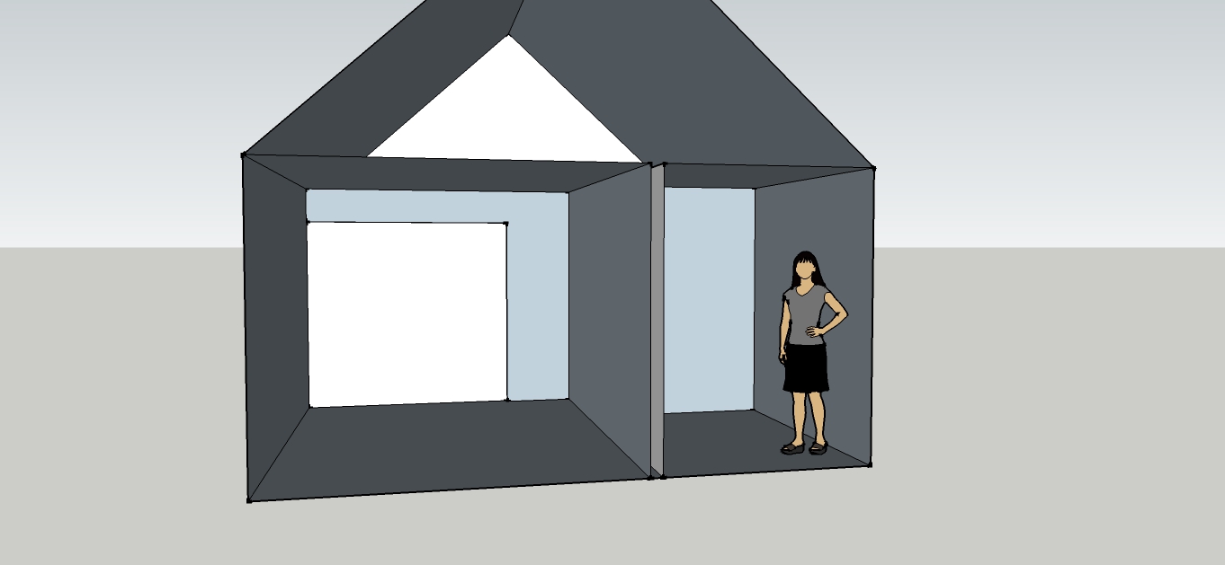

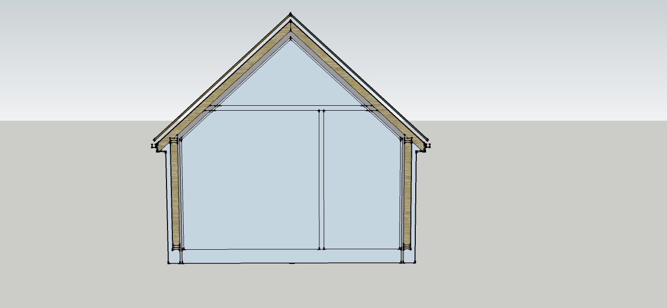

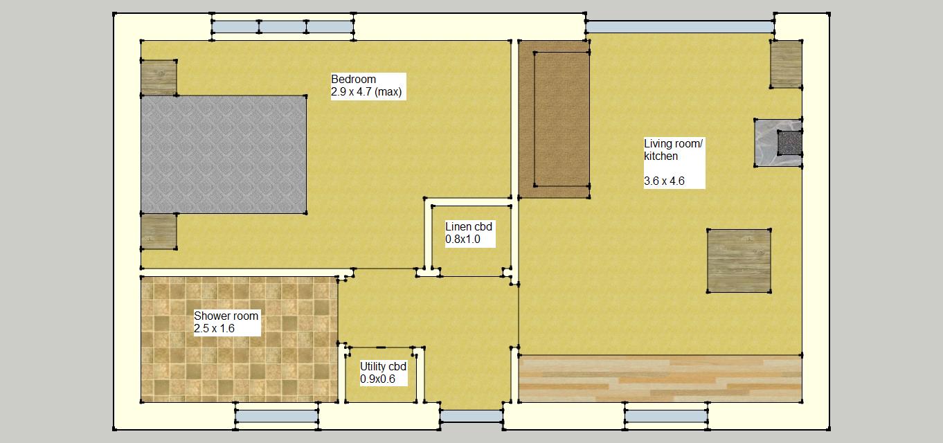

Crofter Posted August 31, 2016 Posted August 31, 2016 I should really have made a decision on this ages ago, but have been kicking the can down the road, so to speak. Also, it's a bit of a subjective question of aesthetics, without a right or wrong answer. My wee house has a warm roof built using a hefty ridge beam, so not much extra support is required, making a totally open and vaulted roof an option from a structural POV. There will be a central partition wall which will tie the walls together and help support the ridge beam as well. Even as it currently stands, it has been up for months now and stood through some gales without so much as a creak, so I'm happy that it doesn't need any extra beams in place. One half of the house is a sinlge open plan room and that will have a vaulted ceiling (there are actually a couple of beams at 10ft above FFL as well, primarily to give me somewhere to put the lights). Oh and one minor complication is that technically I ought to have the ceiling at no more than 10ft height, so these beams also double as a support at that height in case anybody at a later date enforces that particular point. The other half of the house is trickier to make a decision on. It will be split between three spaces- an entrance hallway, the bedroom, and the shower room. My feeling is that, especially for the two smaller spaces, a standard height ceiling would look best and anything else would just look wrong. A room that is taller than it is wide seems like a strange concept. Really not sure about the bedroom, though, which is just about big enough to work with a raised or vaulted ceiling, but this would be assymetrical as the room only spans a little over half the width of the building. Hope I've described this adequately- floor plan and section attached for clarity. Just curious about what ceiling height you guys think would look/feel 'right'...
Ferdinand Posted August 31, 2016 Posted August 31, 2016 (edited) What is above your ceiling etc? I might try to work from the top and decide how much height I need in any stirage space or sleeping platform up there. Can you for example have enough height to walk along the middle beneath the ridge beam? I think any ceiling height would be OK, but might tend to 2.4m as standard, or perhaps 2.6m. F Edited August 31, 2016 by Ferdinand
Crofter Posted August 31, 2016 Author Posted August 31, 2016 I'm not too bothered about having a usable space- nobody is going to be living in this house permanently, no water tank to hide away anywhere, and if needs must there is storage underneath the house, which sits on piers. A sleeping platform is perhaps one exception, but that can be fitted into the space above the built in wardrobe that is going in the partition between lounge and bedroom (not marked on plan, but basically it will run behind where the sofa sits). Not wedded to the idea of a platform and it would almost certainly break the 10ft ceiling height rule. My main aesthetic concern is that any ceiling higher than 2.4m will involve some degree of coomb along one edge. And I think this could look a bit weird.

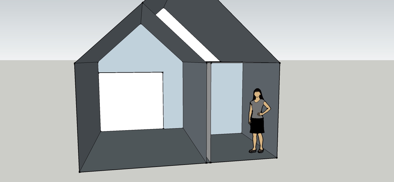

ProDave Posted August 31, 2016 Posted August 31, 2016 For the bathroom, I would have a conventional flat ceiling. for the bedrom, I would give it a vaulted ceiling, but not just right up to the extreme top of the roof, that would leave a lopsided vaulted ceiling if you see what I mean. Instead, on the wall between a bedroom and bathroom, I would start another "false" vaulted ceiling starting at the same level and going up at the same angle to meet the main roof. like this: 2
Crofter Posted August 31, 2016 Author Posted August 31, 2016 That's certainly a permutation that I hadn't considered! I think a high ceiling in the bathroom is a bit of a waste and means extra tiles or wetwall, funny angles to complicate finishing, etc. Glad it's not just me who thinks a lopsided vaulted ceiling would look weird.

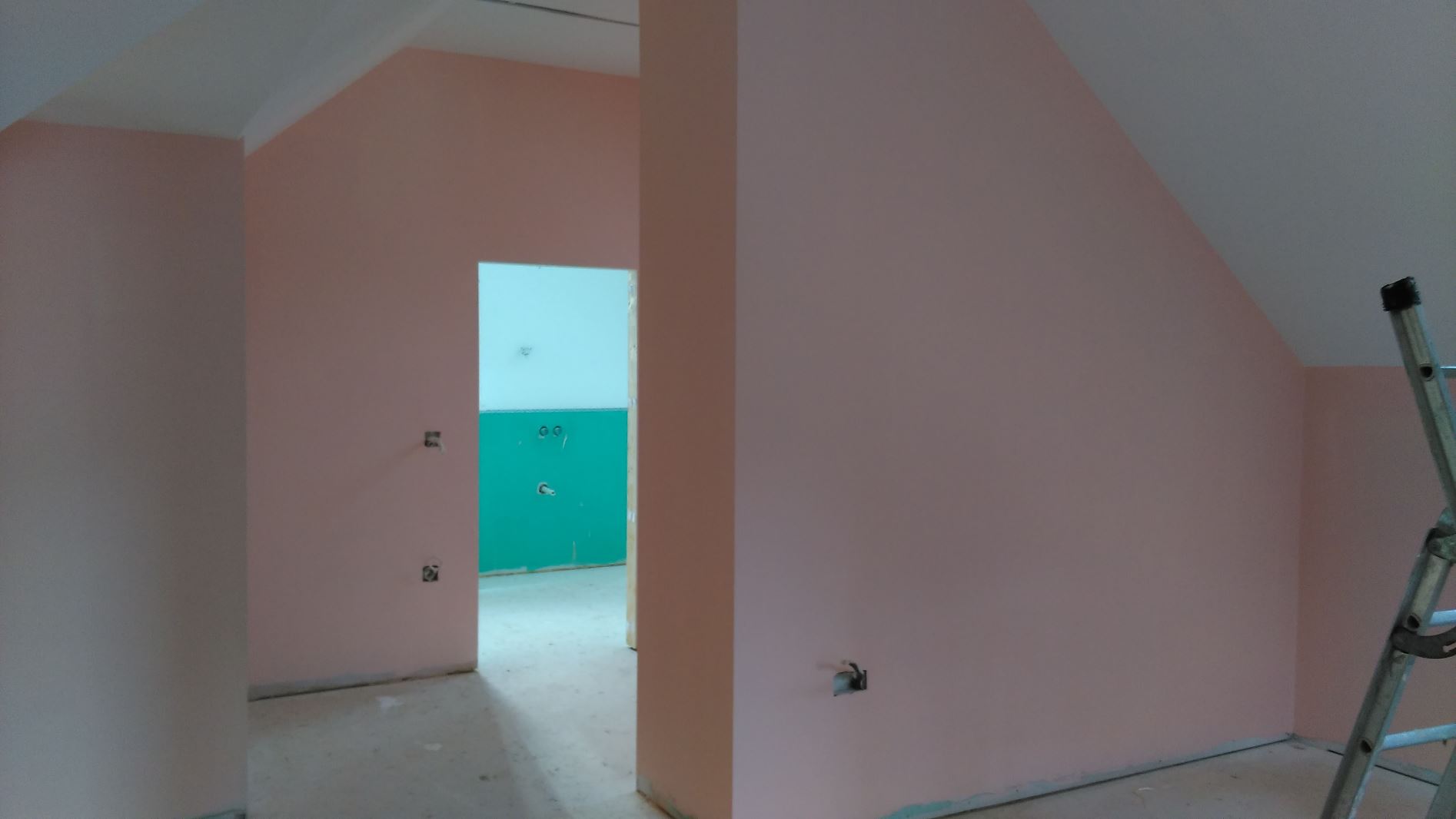

ragg987 Posted August 31, 2016 Posted August 31, 2016 We have vaulted ceilings in our bedrooms and bathrooms. Some are symmentrical and others (e.g. bathroom) are not symetrical, but still at full height. Our smallest vaulted room is the bathroom at 3.25m x 2.4m - the ridge of the vault is along the longer side. I think this works extremely well, the vault and asymetry are aestehtically pleasing (to us) and add a degree of quirkiness into what could otherwise be more box-like. You are welcome to take a look if you happen to be in the area (Aylesbury). I attach a picture of another vaulted area to give you a feel of ours (not the one described above). Image is from larger bedroom through to smaller dressing area (vault is not symmetrical here) through to bathroom. We do not intend to fully tile the bathrooms - only to height set by shower screen and half-height for the rest, as dictated by boxing for suspended toilet and sink (green bit in the image). 1

Crofter Posted September 6, 2016 Author Posted September 6, 2016 Having had time to ruminate over this some more, I think I'm down to two options: 1- just have a conventional 2.4m ceiling. It looks absolutely fine, it's the easiest to do, and it could enhance the 'wow factor' of the room that does have a vaulted ceiling. 2- follow @ProDave's suggestion and have a false ceiling to create a symmetrical vaulted ceiling, probably in conjunction with roof beams at 2.4m height. This entails a bit more work and some more penetrations through the airtightness barrier (where the false ceiling meets the rafters).
