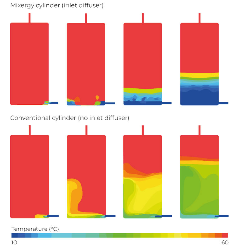

Dan F Posted April 13, 2020 Share Posted April 13, 2020 @Robert Clark Let us know how it goes.. @ProDave That makes sense, just keen to do a bit more than that, but can't justify spending £5,000 on Sunamp! Also my understanding is that a non-mixergy UVC without the careful stratification will need a larger ASHP (to stop water going lukewarm during heavy use) meaning we'd need to be looking at 12/14kW options (when we only need max 6kW for heating). How did you size your ASHP? Link to comment Share on other sites More sharing options...
ProDave Posted April 13, 2020 Share Posted April 13, 2020 No with no heat input, the water stays in layers so as you draw water off, it stays pretty much the same delivery temperature until it runs out. It is only when you start putting heat back into the cylinder that convection starts and the contents get mixed about. We have a 5kW ASHP. An 8 or 9kW would do you well. Mine was sized using @Jeremy Harris heat loss calculator that showd a maximum heat input demand of just over 2kW. 5kW is about as small as you can buy. Link to comment Share on other sites More sharing options...
Dan F Posted April 13, 2020 Share Posted April 13, 2020 7 minutes ago, ProDave said: No with no heat input, the water stays in layers so as you draw water off, it stays pretty much the same delivery temperature until it runs out. It is only when you start putting heat back into the cylinder that convection starts and the contents get mixed about. Really? My understanding was that with a a standard UVC the incoming cold water gets mixed and so the water temperature at the top of the tank will be lukewarm by the time you've used a certain % of the tank. This can be improved with a good inlet difuser, which some tanks have, but not all. Do you have any way of knowing what the delivery temperature is over time without supplying heat to your tank? Which brand? Mixergy uses Newark tanks, what I'm not sure is if they use the standard Newark inlet diffuser, or if they use a custom diffuser or are doing anything else on top of this. Regarding ASHP sizing: we have PHPP heating load of 3kW, but have been advised to use 6kW based on other calcs. Issue is that if we go for a 400L tank, recoevery time of 6kW ASHP is going to be high.. which is another reason to be able to load-shift to avoid oversizing ASHP.. Link to comment Share on other sites More sharing options...
ProDave Posted April 13, 2020 Share Posted April 13, 2020 29 minutes ago, Dan Feist said: Really? My understanding was that with a a standard UVC the incoming cold water gets mixed and so the water temperature at the top of the tank will be lukewarm by the time you've used a certain % of the tank. This can be improved with a good inlet difuser, which some tanks have, but not all. Do you have any way of knowing what the delivery temperature is over time without supplying heat to your tank? Which brand? Mixergy uses Newark tanks, what I'm not sure is if they use the standard Newark inlet diffuser, or if they use a custom diffuser or are doing anything else on top of this. Regarding ASHP sizing: we have PHPP heating load of 3kW, but have been advised to use 6kW based on other calcs. Issue is that if we go for a 400L tank, recoevery time of 6kW ASHP is going to be high.. which is another reason to be able to load-shift to avoid oversizing ASHP.. Not my findings. The water only starts mixing when you apply some heat input that starts convection. Perhaps my Telford tank has an inlet difuser but they don't mention it. Link to comment Share on other sites More sharing options...
Dan F Posted April 13, 2020 Share Posted April 13, 2020 2 hours ago, ProDave said: Not my findings. The water only starts mixing when you apply some heat input that starts convection. Perhaps my Telford tank has an inlet difuser but they don't mention it. Mmm, Pherhaps I'll have to quiz mixergy a bit more on exactly how different their tank is/isn't from a discharge/mixing perspective is., Unless @Robert Clark or @joth know? Link to comment Share on other sites More sharing options...
ProDave Posted April 13, 2020 Share Posted April 13, 2020 10 minutes ago, Dan Feist said: Mmm, Pherhaps I'll have to quiz mixergy a bit more on exactly how different their tank is/isn't from a discharge/mixing perspective is., Unless @Robert Clark or @joth know? All I can say is with no hot water being heated overnight, is the morning hot water is still plenty hot. It may have lost a few degrees in the tank, and there is no doubt less of it, but it has not gone all luke warm. Link to comment Share on other sites More sharing options...
Dan F Posted April 13, 2020 Share Posted April 13, 2020 27 minutes ago, ProDave said: All I can say is with no hot water being heated overnight, is the morning hot water is still plenty hot. It may have lost a few degrees in the tank, and there is no doubt less of it, but it has not gone all luke warm. I found some data which would back up both your assertion and Mixergy's claim. Standard tank doesn't mean all water mixes, just that more mixes, but there is still hot water at top. https://ec.europa.eu/environment/ecoap/sites/ecoap_stayconnected/files/etv/mixergy_verification_report_npl_08122016_-_no_appendices.pdf Link to comment Share on other sites More sharing options...
joth Posted April 14, 2020 Share Posted April 14, 2020 20 hours ago, Dan Feist said: I found some data which would back up both your assertion and Mixergy's claim. Standard tank doesn't mean all water mixes, just that more mixes, but there is still hot water at top. https://ec.europa.eu/environment/ecoap/sites/ecoap_stayconnected/files/etv/mixergy_verification_report_npl_08122016_-_no_appendices.pdf That report is interesting, as it shows that a standard tank's usable volume decreases as the flow rate increases (as expected, more turbulance results in loss of the thermocline), whereas the Mixergy actually has a slight increase in usable volume as the flow rate increases. Any idea why? On 13/04/2020 at 18:35, Dan Feist said: Mixergy uses Newark tanks, what I'm not sure is if they use the standard Newark inlet diffuser, or if they use a custom diffuser or are doing anything else on top of this. Couple interesting points on this from the report: - It states: "The Mixergy Tank is a hot water tank that makes use of a novel inlet diffuser and angled heating element scheme to increase the utilisation of stored water within a domestic hot water tank" - It seems they used a Newark tank as the reference "standard" tank (going on Table 7 & 8) so does make a direct comparison of the two - The tests were carried out by Newark on their premises (but under instruction of NPL), so not entire independent, but sure what more to read into that if anything. Link to comment Share on other sites More sharing options...
Dan F Posted April 14, 2020 Share Posted April 14, 2020 Quote whereas the Mixergy actually has a slight increase in usable volume as the flow rate increases. Any idea why? No idea, it could just variance in test. Kind of a shame they tested with 75L and not a larger tank, but I guess the the same model applies. If anything I'd assume large tank might be slightly better as the size of the inlet difussor will be smaller compared to the total volume or the tank and further from the hot water at the top (that's guesswork though..) Link to comment Share on other sites More sharing options...
