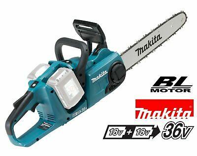

Onoff Posted April 21, 2019 Author Posted April 21, 2019 On 21/04/2019 at 08:54, scottishjohn said: time to remove those trees growing around it as well ,before their roots give you more problems. they will be growing like hell with all that fertiliser and moisture and roots will be heading to the moisture -through the bricks no doubt Expand Agreed. Looking at the Makita 36V chainsaws, can't decide on the 300 or 350mm blade. If I go for the 350mm then there's two models DUC353Z and 355Z. Both brushless. Used the compare facility on the Makita site but none the wiser what the difference is! On 21/04/2019 at 08:55, PeterW said: If you’re replacing the tank with a treatment system then I’d get rid of all the clay pipes, interceptors etc and start again. Go from a new manhole at the back of the house to the treatment plant in one straight run in uPVC and then trash the rest into the septic to fill it in. Clay pipes move too much and that’s a lot of your problems. You may find you’re getting blockages as the joints are weeping and the solids are being left behind. Expand As I was rodding I was hitting what I thought were maybe blockages, must have been the joints. I connected 2 packs of 10, 900mm rods so 18m and that just went from manhole 2 to 3. Might be another inbetween but I can't see one despite prodding the ground along the line.

Onoff Posted April 21, 2019 Author Posted April 21, 2019 (edited) On 21/04/2019 at 10:19, Cpd said: Agree with this, unless you really want to be the go to guy with the local electric chainsaw....... but hay who am I to speak I just live buying tools, luckily I am very protective of my equipment so people know better than ask to borrow my gear........ Expand EVERYBODY around here has a chainsaw...except me! They scare the sh!t out of me tbh. The BiL just got the small "1 hander" 36V Makita DUC302Z jobbie and is super impressed. At the mo I always have to ask him if I need anything trimming. Edited April 21, 2019 by Onoff

PeterW Posted April 21, 2019 Posted April 21, 2019 On 21/04/2019 at 10:53, Onoff said: BiL just got the small "1 hander" 36V Makita DUC302Z jobbie and is super impressed Expand You mean one of these ..?? Makita Top Handle So ... it’s not a “1 hander” at all, it’s a top handle short bar for aerial work. It puts your right hand on top of the machine so the pivot point is further forward and you can use the machine in tighter spaces when you’re climbing or working off MEWPs . Your left hand goes on the other side ... see the black lever on the far side with 3 rectangular holes in it ..? That’s the chain brake. Slam it forward, chain stops instantly. It’s there so when you get kick back or climb out of the saw and it swings back toward your head, the chain stops before it cuts your visor in two, or worse. If he uses it “1-handed” then I hope he has good life insurance ...
Onoff Posted April 21, 2019 Author Posted April 21, 2019 On 21/04/2019 at 14:43, PeterW said: You mean one of these ..?? Expand That's the one. He reckons it more for tree work and possibly more dangerous than this sort:
PeterW Posted April 21, 2019 Posted April 21, 2019 On 21/04/2019 at 15:06, Onoff said: That's the one. He reckons it more for tree work and possibly more dangerous than this sort: Expand It is much more dangerous ..! Hence why I think they should be licensed .....
