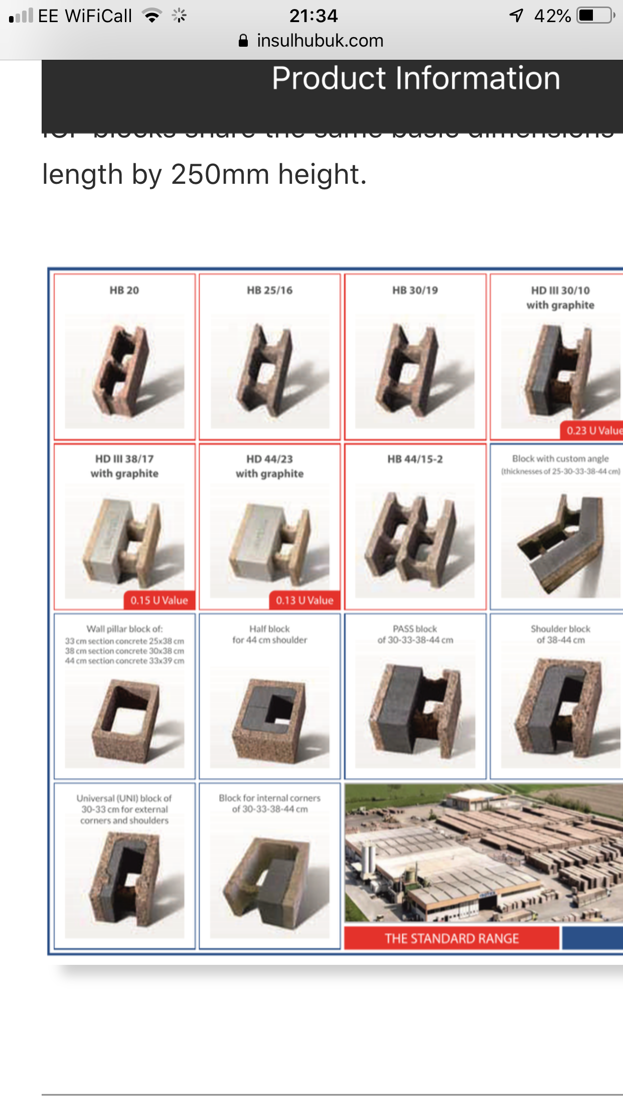

Sue B Posted April 15, 2019 Share Posted April 15, 2019 (edited) Not entirely sure what you are building but Isotex (which is similar to Durisol) have column blocks which we will probably use in our build for 2 columns supporting the overhang on the first floor. The website is Insulhub. I may have completely the wrong idea about what you are trying to do though. Edited April 15, 2019 by Sue B 1 Link to comment Share on other sites More sharing options...

Sue B Posted April 17, 2019 Share Posted April 17, 2019 I believe that the Isotex blocks have a finishing process after they have been dried that the Durisol blocks maybe don’t have or the process is less robust. Certainly, we could see the difference in the few blocks that we used on the training courses. The Isotex blocks were also smoother on the outside (you’d still need the gloves) but were obviously more “finished” than the Durisol blocks. It’s not a huge issue for us, it Is just another factor to add to the decision scales. Link to comment Share on other sites More sharing options...

hallega Posted April 18, 2019 Author Share Posted April 18, 2019 Hmmm...looking at the Isotex they don't have the edging as the Durisol block, not having seen these yet I can't make any decisions, but maybe they will be at Grand design show? Thanks for the safety aspect re the cutting and eyes, it's all being taken in I can assure you after losing the top of a finger in the family I am Super careful now of everything. Link to comment Share on other sites More sharing options...
