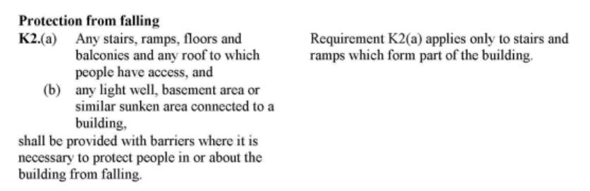

Jeremy Harris Posted April 10, 2019 Posted April 10, 2019 Part K2 has nothing about requiring fall protection from any elevated area to which there isn't access (my highlight): Protection from falling K2. (a) Any stairs, ramps, floors and balconies and any roof to which people have access 1

Onoff Posted April 10, 2019 Posted April 10, 2019 19 minutes ago, JSHarris said: Part K2 has nothing about requiring fall protection from any elevated area to which there isn't access (my highlight): Protection from falling K2. (a) Any stairs, ramps, floors and balconies and any roof to which people have access It does imo. We can cherry pick to our hearts content: "Guarding of areas used for maintenance For all buildings 3.4 Where people will use the stairs or ladders to access areas for maintenance they should comply with one of the following. a. If access will be required frequently (e.g. a minimum of once per month): follow provisions such as those suggested for dwellings in this Approved Document (see Diagram 3.1). b. If access will be required less frequently than once a month: it may be appropriate to use temporary guarding or warning notices. The Construction (Design and Management) Regulations 2007 and the Work at Height Regulations 2005 give provisions for such measures. 3.5 Use signs as specified in the Health and Safety (Safety Signs and Signals) Regulations 1996". Also: "For areas where access is required only for maintenance, greater care can be expected from people and therefore a lower standard of provision may be acceptable". Working at Height regs are referred to also. The full Part K doc: EXT.Approved-Document-K-Protection-from-Falling-ENG-2013.JMCN_.v1.200417.pdf Is access required perhaps to these areas for periodic window cleaning, maintenance of pv panels etc? Agreed though it needs a frank discussion as to why these requirements have been specified.
Jeremy Harris Posted April 10, 2019 Posted April 10, 2019 The general rule that's been used for decades is that if infrequent maintenance access is only by a temporary ladder or scaffolding, then no fixed provision for fall prevention/fall arrest is required. That's been the standard interpretation of the prevention from falling part of the building regulations (not Part K, which is only guidance as to compliance, and is not the regulations) for years. If there is a fixed ladder or staircase, or some other form of fixed roof access, then measures are normally required, ideally prevention, but if that isn't practical, then fall arrest provision. FWIW, the building regulations legal requirements are all here: https://www.legislation.gov.uk/uksi/2010/2214/schedule/1/made This is the law, whereas the Approved Documents (like Part K etc) are only guidance as to methods that may be used as one way (they may well be other ways not in the Approved Documents) to demonstrate that the requirements in the regulations have been complied with. The bit I quoted earlier came from the regulations, so is the legal requirement, not guidance. This is a cut and paste of the whole part of the law which I quoted from earlier:

Onoff Posted April 10, 2019 Posted April 10, 2019 (edited) 1 hour ago, JSHarris said: The general rule that's been used for decades is that if infrequent maintenance access is only by a temporary ladder or scaffolding, then no fixed provision for fall prevention/fall arrest is required. That's been the standard interpretation of the prevention from falling part of the building regulations (not Part K, which is only guidance as to compliance, and is not the regulations) for years. If there is a fixed ladder or staircase, or some other form of fixed roof access, then measures are normally required, ideally prevention, but if that isn't practical, then fall arrest provision. FWIW, the building regulations legal requirements are all here: https://www.legislation.gov.uk/uksi/2010/2214/schedule/1/made This is the law, whereas the Approved Documents (like Part K etc) are only guidance as to methods that may be used as one way (they may well be other ways not in the Approved Documents) to demonstrate that the requirements in the regulations have been complied with. The bit I quoted earlier came from the regulations, so is the legal requirement, not guidance. This is a cut and paste of the whole part of the law which I quoted from earlier: Edit: Comments withdrawn. Personal apology being made. Don't ask. Edited April 10, 2019 by Onoff 1
