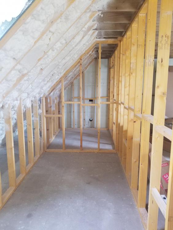

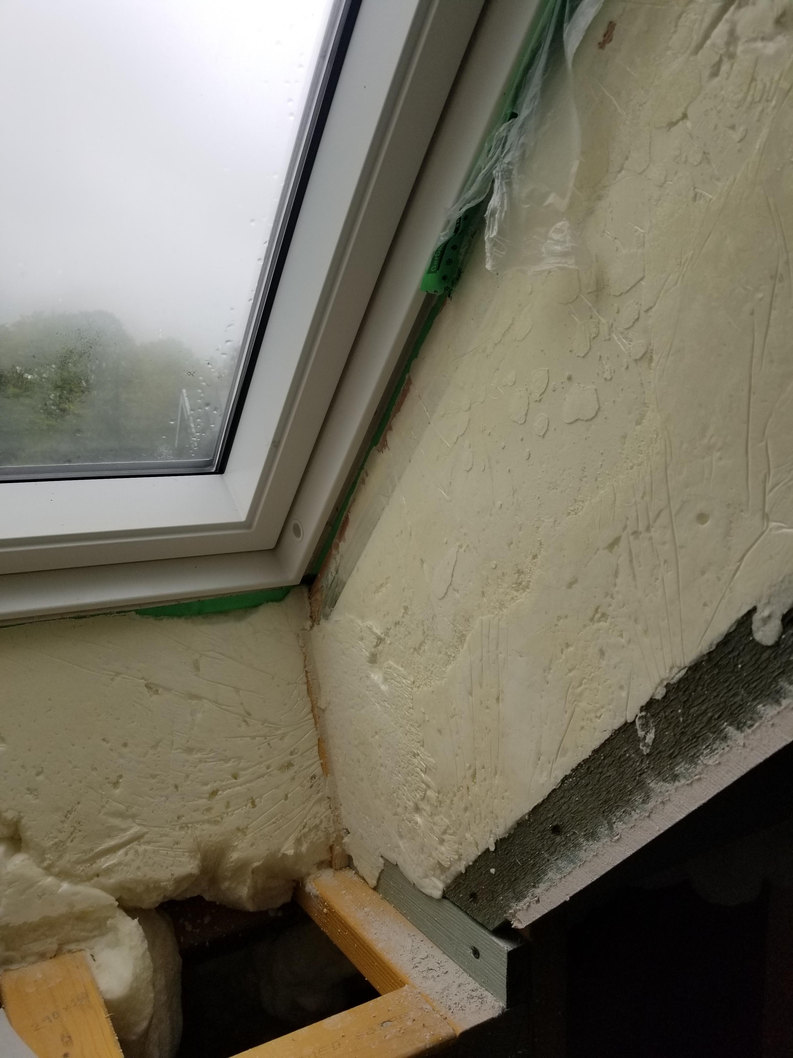

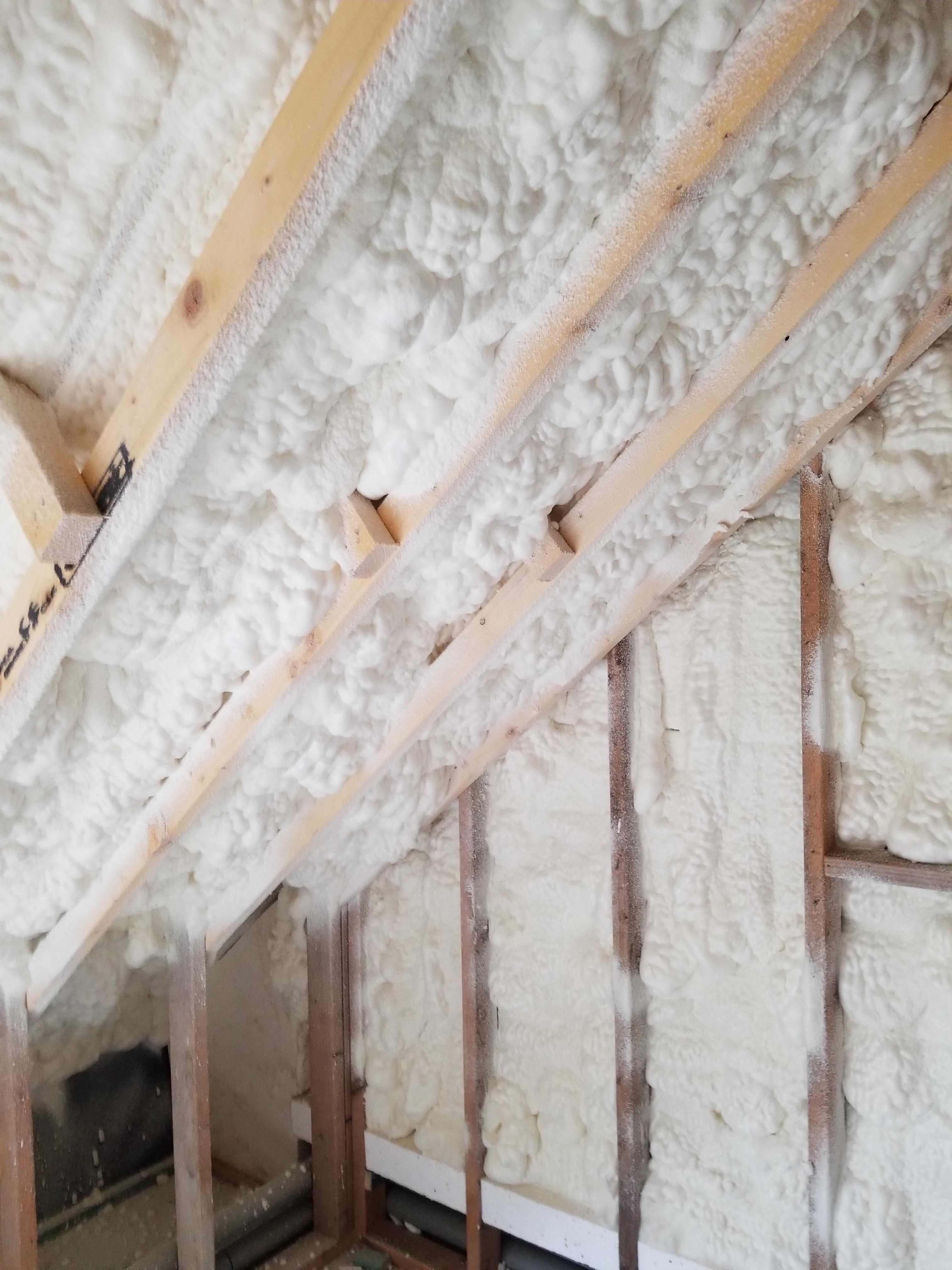

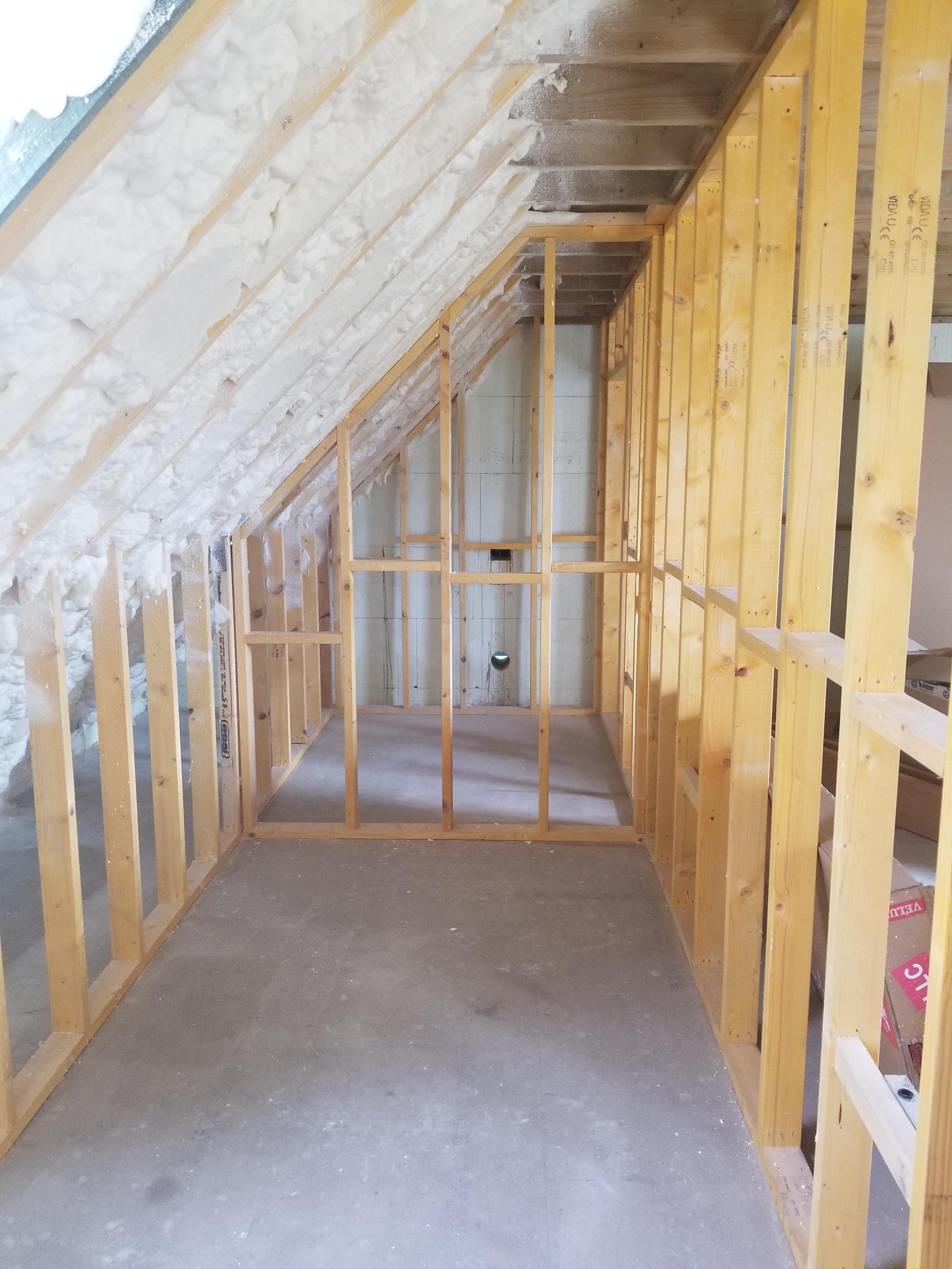

Alexphd1 Posted May 18, 2019 Share Posted May 18, 2019 (edited) Sorry forgot to report back. 500m2 sprayed at 400mm. No big issues. Very little to cut back. Icynene is just another brand (who only sell opencell insulation), lapolla their big UK rival have both closed and open cell but both only sell to approved installers. We came across 2 or 3 suppliers in the UK who where happy to sell us but ended up buying from Ireland. Edited May 18, 2019 by Alexphd1 Link to comment Share on other sites More sharing options...
Onoff Posted May 18, 2019 Share Posted May 18, 2019 So you did this yourself? No offence but it doesn't look filled to the full joist depth. Is that an issue? Or had it not expanded in the photos? Is that why very little cutting back? Link to comment Share on other sites More sharing options...
Digmixfill Posted May 18, 2019 Author Share Posted May 18, 2019 Your floor looks very unspoilt. Did you use dust sheets or did it just not splatter during application? Link to comment Share on other sites More sharing options...

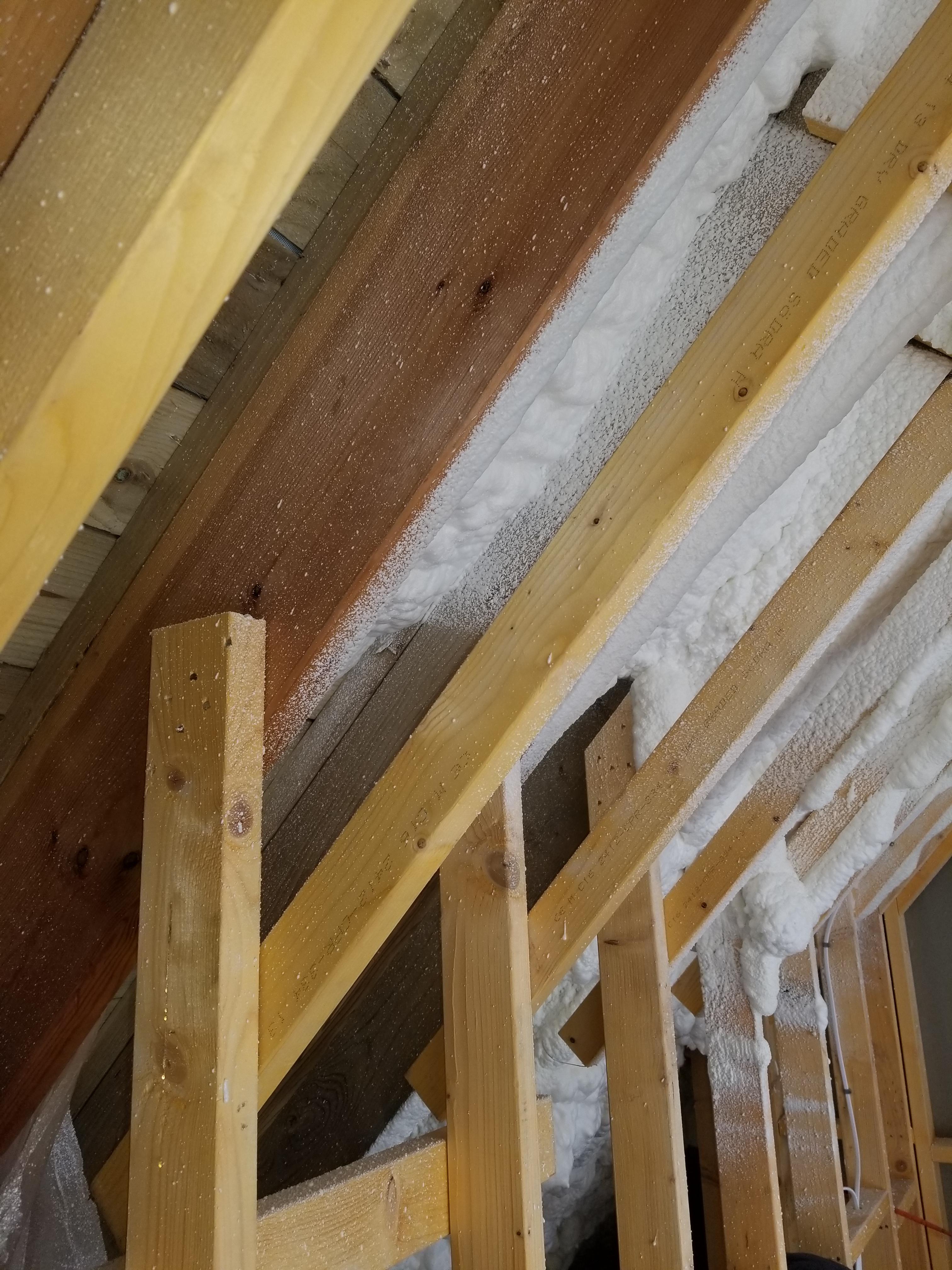

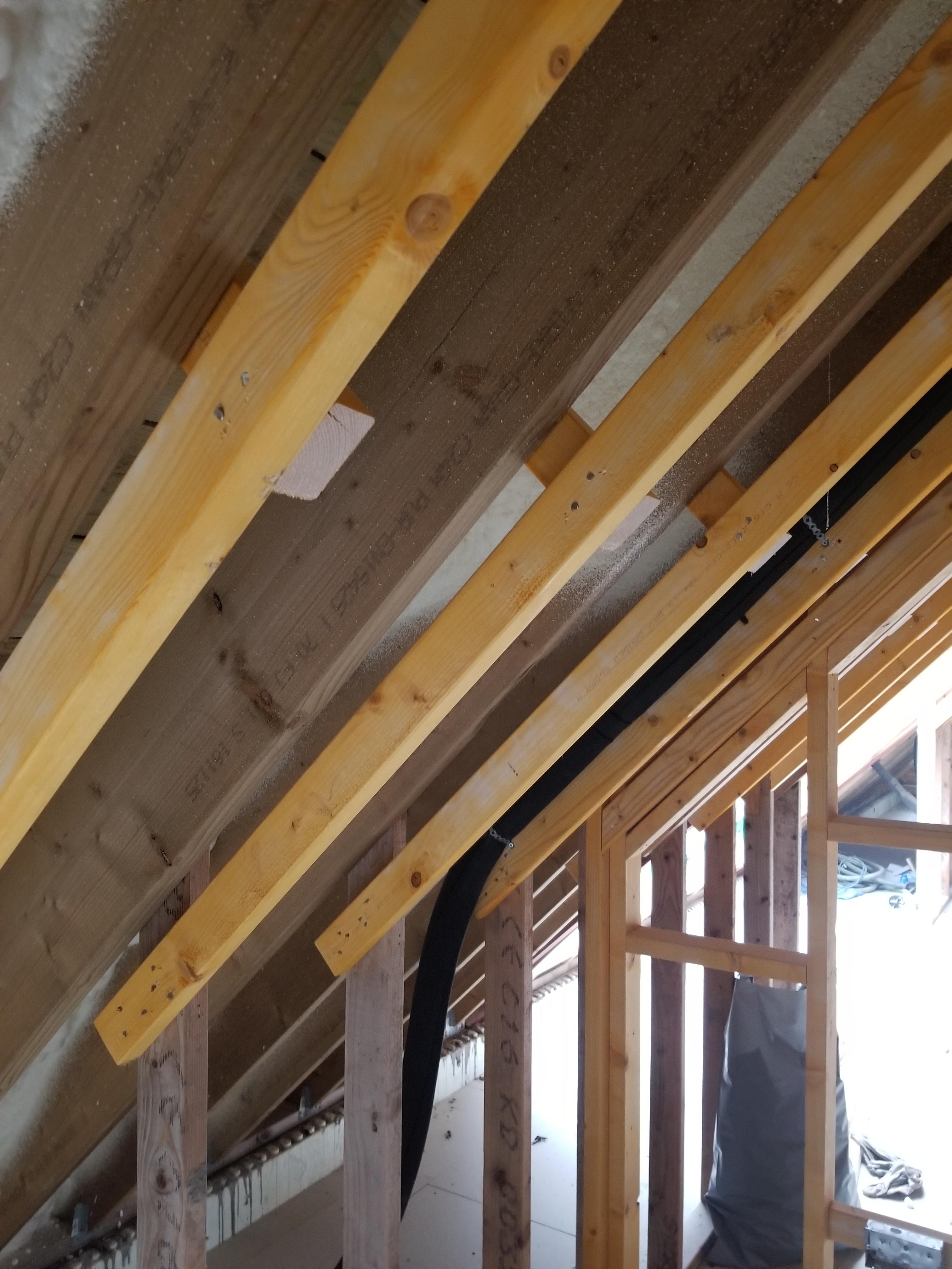

Alexphd1 Posted May 18, 2019 Share Posted May 18, 2019 We actually hung a extra rafter between the hanging post and ceiling and the target was stop the insulation somewhere in the 2nd rafter so no/very little cutting back was required where the plaster board fixes to. Downside 9f this we lost a bit more headroom. The main rafter from the wall to the ridge beam was 100% covered. I will add more photos tomorrow to make clear. Unfortunately we had a fair bit of splatter. Link to comment Share on other sites More sharing options...

Alexphd1 Posted May 19, 2019 Share Posted May 19, 2019 Unfortunately we where a lot longer than a day, more like a week! Possibly the learning curve had something to with this and we had 4-5 passes to make up depth. This photo may give you a better idea of the extra rafter between the hanging post and ceiling. Link to comment Share on other sites More sharing options...
