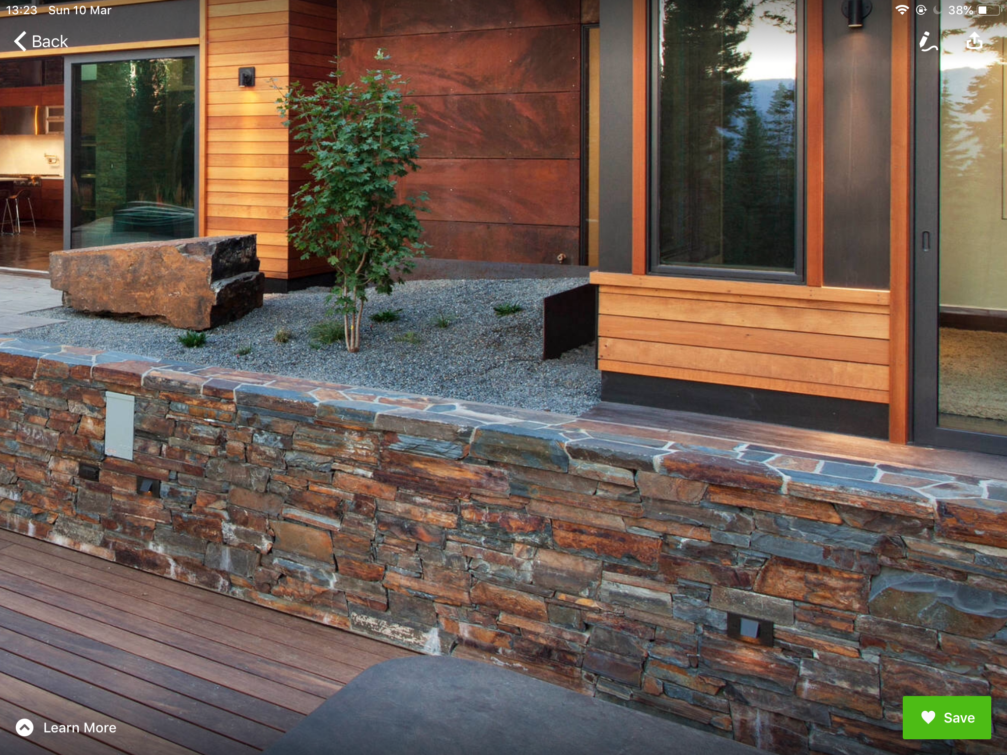

Triassic Posted April 4, 2019 Share Posted April 4, 2019 (edited) I’ve just started the process of cladding the exterior of my timber frame house. I’m thinking about the splash zone between the finished exterior ground level and where the exterior cladding starts. I appear to have two options, either take the cladding down to ground level or, render the gap, maybe in a contrasting colour. Come to think of it, I’m not even sure how wide should this splash zone be? What did you do, a photo might help! Edited April 4, 2019 by Triassic Link to comment Share on other sites More sharing options...
CC45 Posted April 4, 2019 Share Posted April 4, 2019 are you thinking of the 150mm above ground level to dpc? I wouldn't take the cladding any closer to the ground than this. Link to comment Share on other sites More sharing options...
Bitpipe Posted April 4, 2019 Share Posted April 4, 2019 We left a 100mm gap between bottom of the render system and what was then expected to be ground level. I dressed this with an additional strip of 20mm thick x 200mm deep EPS over the EPS cladding the basement wall, digging out a bit to get the depth. We then ran our paving flush with the top of the render (to allow no step entry to house on all sides) but set 100mm back to from a 100x200mm channel round the house. Next job is to line the EPS with Ubiflex flashing and backfill the channel with decorative white stone chips to act as a french drain, leaving a 100mm gap between the render and air gap and the top of the stone. When rendering the garage with the same system, I managed to get the Ubiflex onto the base of the garage wall first so it runs under the bottom batten - thought of it too late for the house. However if the render is getting fixed then I may hold off and apply it then. Will send a pic later. 2 Link to comment Share on other sites More sharing options...
Triassic Posted April 4, 2019 Author Share Posted April 4, 2019 59 minutes ago, CC45 said: are you thinking of the 150mm above ground level to dpc? I wouldn't take the cladding any closer to the ground than this. Yes. I’ve focussed so much on the render and the cladding, I’ve not really considered what to do here ! Link to comment Share on other sites More sharing options...

scottishjohn Posted May 11, 2019 Share Posted May 11, 2019 (edited) I notice a lot of cladding going very close to ground IMHO that is not good idea when it rains you get the splashing of water and muck on to the boarding think you need a good 12"of stone or something at bottom or your cladding will get dirty and discoloured over time , maybe a grass edging next to house of something soft that will stop the bounce back,certainly paving or anything hard will make it worse very common in scotland to have 3 courses at least of "fyfestone stone" before render starts and that will be over hanging the stone work i think that is why they do it -rendering stays nice and clean old stone cottages the bottom of the wall is always discoloured when they render to ground ,not quite as bad if a border of chips or something Edited May 11, 2019 by scottishjohn 1 Link to comment Share on other sites More sharing options...

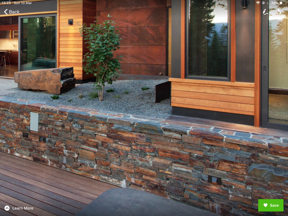

Russell griffiths Posted May 11, 2019 Share Posted May 11, 2019 2 hours ago, scottishjohn said: I notice a lot of cladding going very close to ground IMHO that is not good idea when it rains you get the splashing of water and muck on to the boarding think you need a good 12"of stone or something at bottom or your cladding will get dirty and discoloured over time , maybe a grass edging next to house of something soft that will stop the bounce back,certainly paving or anything hard will make it worse very common in scotland to have 3 courses at least of "fyfestone stone" before render starts and that will be over hanging the stone work i think that is why they do it -rendering stays nice and clean old stone cottages the bottom of the wall is always discoloured when they render to ground ,not quite as bad if a border of chips or something You are right a lot of newer designs really miss the old standard correct way to do something, white render straight to the floor may look good on the architects computer, but it will look rough in 5 years time. We are looking to do something similar to the pic. Link to comment Share on other sites More sharing options...
