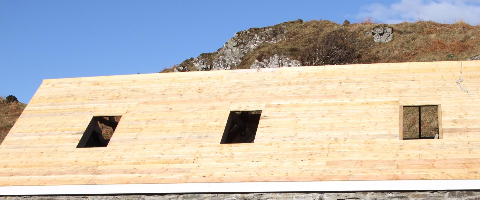

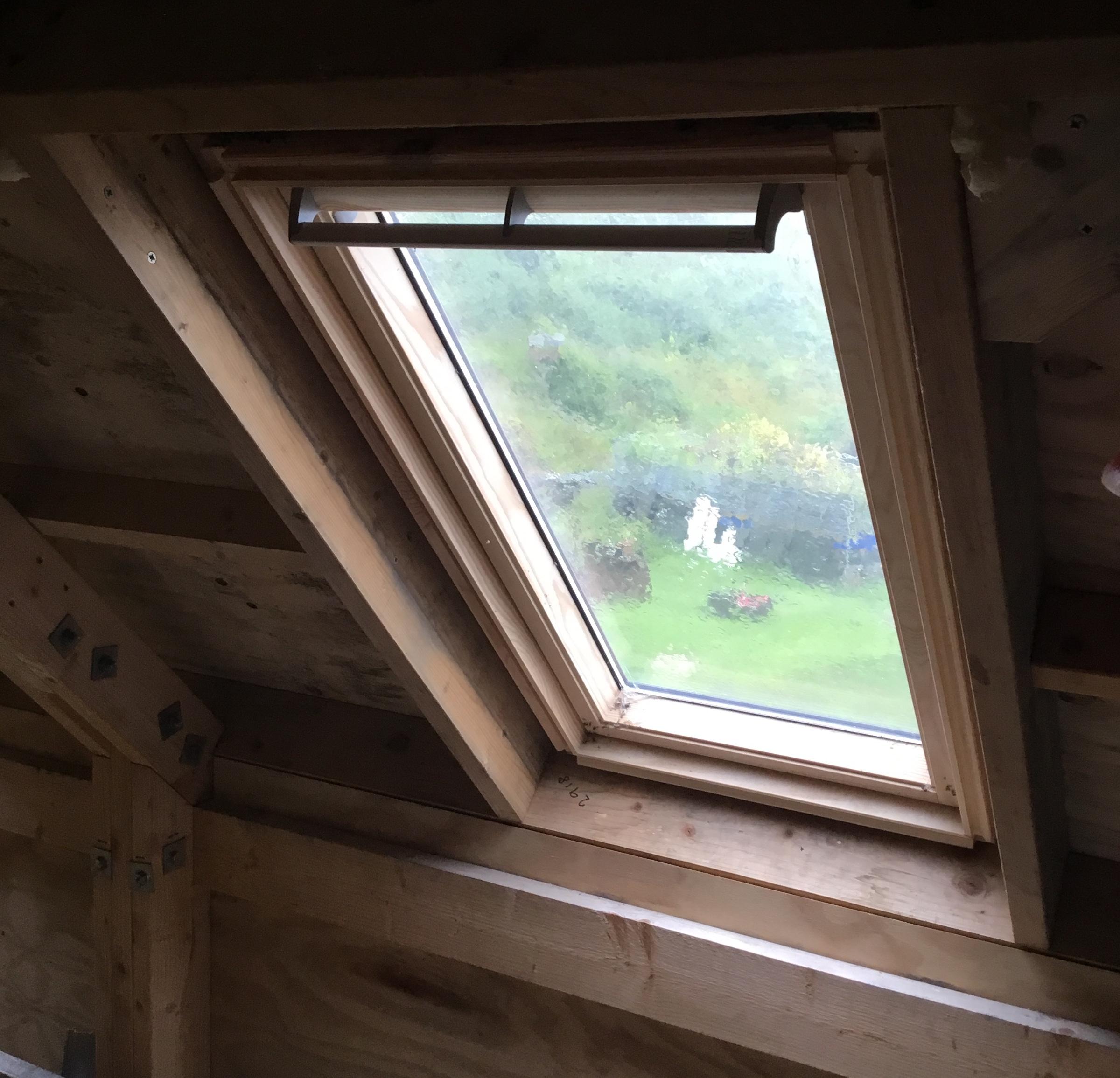

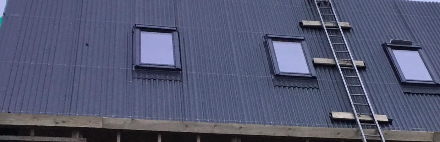

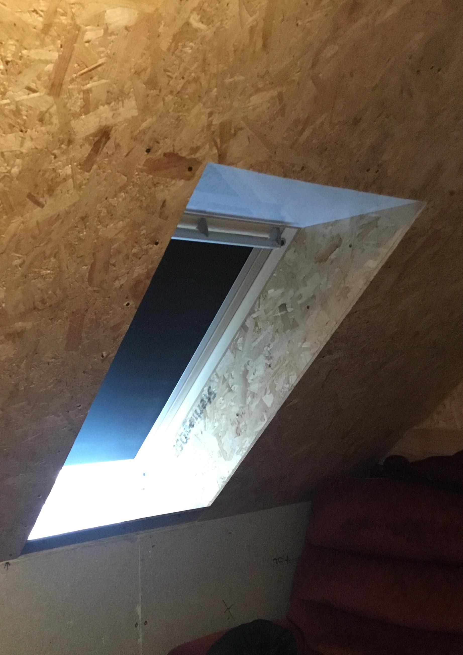

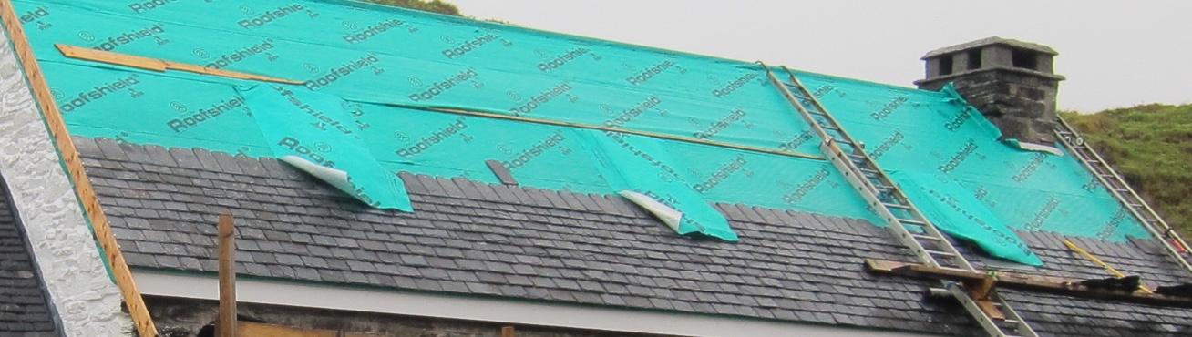

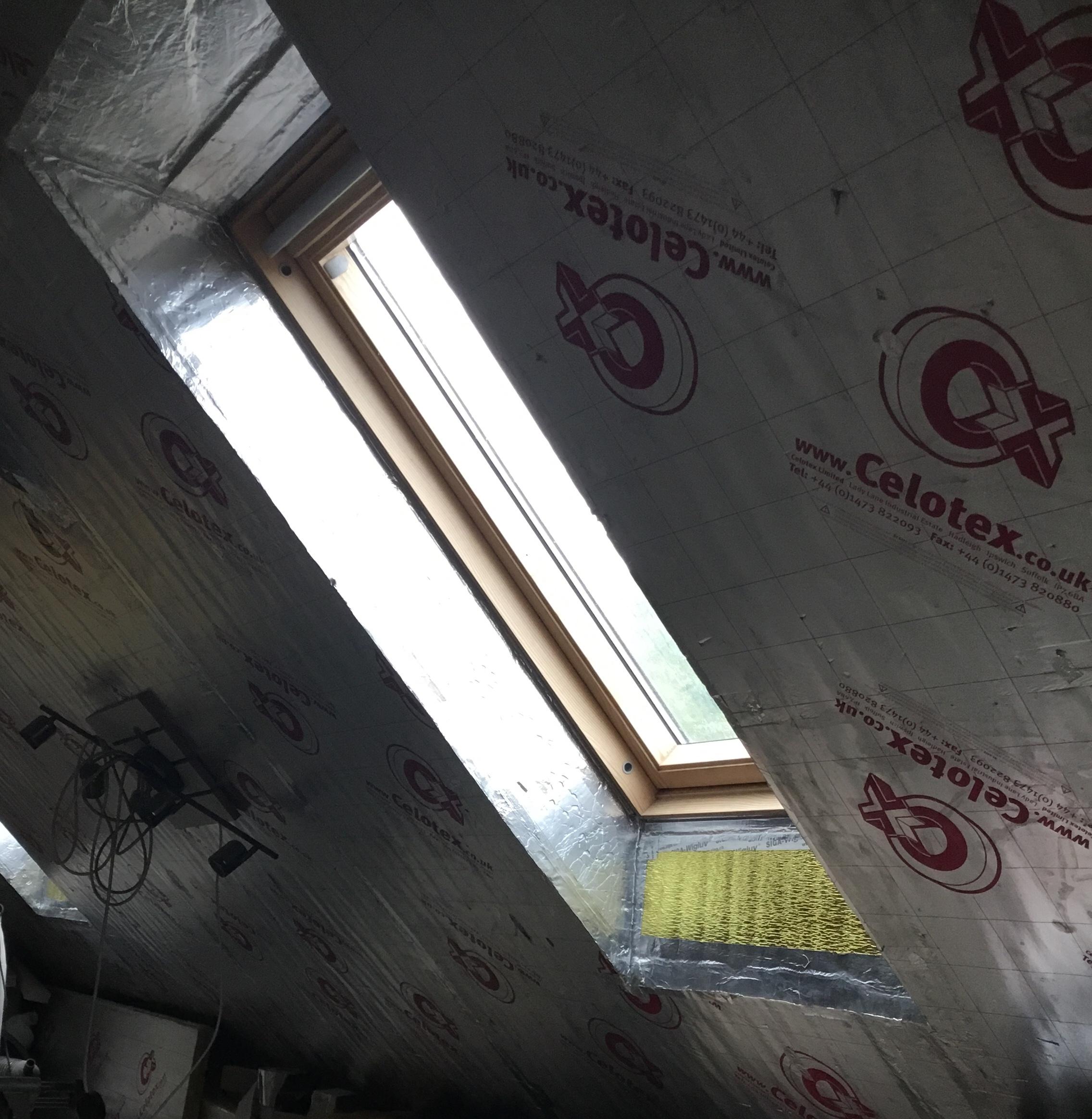

Cpd Posted July 22, 2019 Share Posted July 22, 2019 i was asked me by @Visti by Pm for a bit more detail on my roof installation and a step by step account of the process of Installing velux windows in a wriggly tin roof...... these things are always hard to remember after the event...... but I will try. 1. The positioning of the windows has to be decided at design stage as the roof design will need to take into consideration the velux openings. 2. Confirming where the edge of the tin is to start in relation to the edge of the roof is critical so that you have a datum point to start from. A potential problem With the roof design could be that the timbers that “box out” the opening could later infringe on the interior opening size of the window, you need to also think about cold bridges with this boxing out section as again a can see where you could end up with inadequate insulation on the internal sides of the boxing out section if it was put to close to the velux frame. 3. Carful pre design of where your tin fixings are going to go is essential if you want it to look right........ I started at 120mm up from the base of the tin and then every 1200mm with the last fixings hidden beneath the ridge flashing. I’ve seen a lot of roofs where this has not been though about and you end up with some strange and pretty ugly fixings that can really make a good roof look bad...... I also used string lines across the roof to mark my fixing points with a permanent marker. 4, there is some wiggle room when cut the holes out in the roof and you should take advantage of this make sure you cut the holes out with the extra allowable space around the perimeter ) as it’s the only place you have to make adjustments to the velux / flashings position if required when matching the tin up to the flashing. 5. If installing multiple windows in a row, I did 4..... you need to remember to always go by your datum point not the last window....... otherwise the error will just follow you and the edge of the tin won’t fall into the internal gutter ! It’s really essential that you get this right as it would look like a bag of shite if the edge Of the tin doesn’t line up within 5-10mm of where you want them to fall in the velux gutters. 6. Avoid using cut edges anywhere that is exposed ! being on a tight budget I did use one cut edge that is at the base of the roof and I expect it will be the fit bit to start to fail once the salt water gets into it....... 7. When cutting tin...... I used a jigsaw with the tin clamped between wood, be carful not to damage the tin with this wood, it may be wise to make up some slightly padded wood clamps for this work. After cutting there are loads of really nasty sharp filings and you need to get these off without damaging the tin as they will stick into the plastic coating on the tin and then start to rust ! Use the longest metal cutting bit you can and practice on a bit of offcut first as there is a real knack to cutting tin with a jigsaw.. . 8. I put up a barge board at the base of the roof at the exact point where the tin was to end, this meant that when I was putting up the tin I could lay a bunch of it on the roof and CHECK to see if it was going to line up with the flashings ! Remember that if you put the barge board up at 90 degrees you will need to take into account that the tin has a 20mm profile and laid to the pitch of the roof that is 45 degrees and the top of the wriggle on the tin will hit the barge board and this is not the actual edge..... anyway you will work it out....... the barge board NEEDS to be solid as it’s going to have some good pressure on it when you get a bunch of tin laid out so go overboard when designing it.... just a piece of sarking tased In will not do...... 9. The tin is very easy to handle but be carful of the sharp corners as they just live to rip your lovely new membrane! 10. I need to stop as I am the worlds slowest one finger typist i am sure there is more and I am sure others will chip in with the bits I have missed or miss represented ! Link to comment Share on other sites More sharing options...

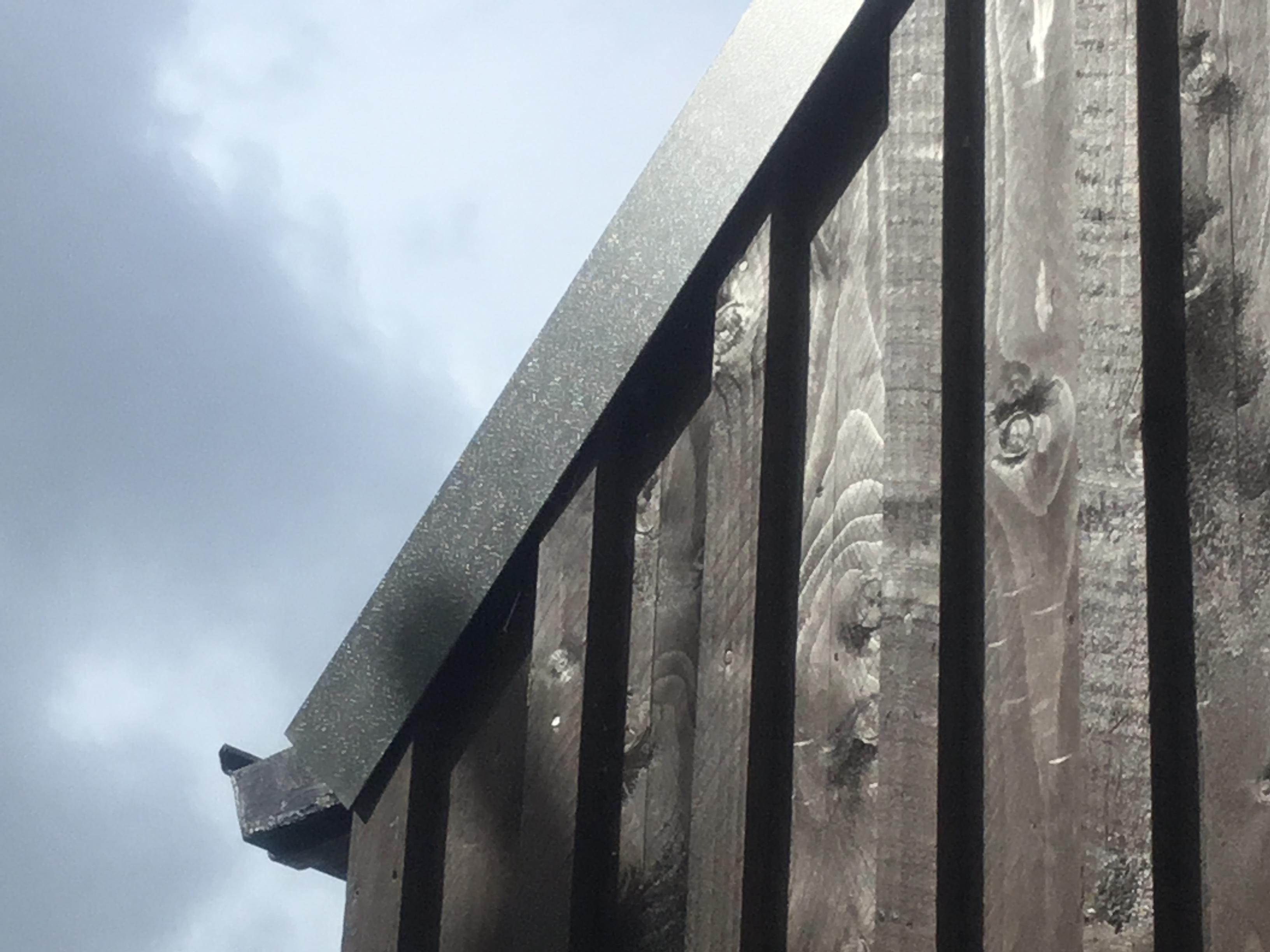

Cpd Posted September 6, 2019 Share Posted September 6, 2019 (edited) Just a small detail in regards to gable flashing onto timber cladding, I have found that leaving a small gap between the roof flashing and the timber stops water running down the timber, not sure if this is standard practice but I had one which was tight fitting and water was tracking onto the timber was causing unnecessary dampness and staining. On my glorified shed I stood the flashing off by 10mm+ and the water now tracks harmlessly down the lower side of the flashing and drips away. Small detail for a very specific application but may be of help to some. I used a small strip if wood tacked into the top of the timber cladding and under the flashing as a spacer to get a consistent gap. Edited September 6, 2019 by Cpd 2 1 Link to comment Share on other sites More sharing options...

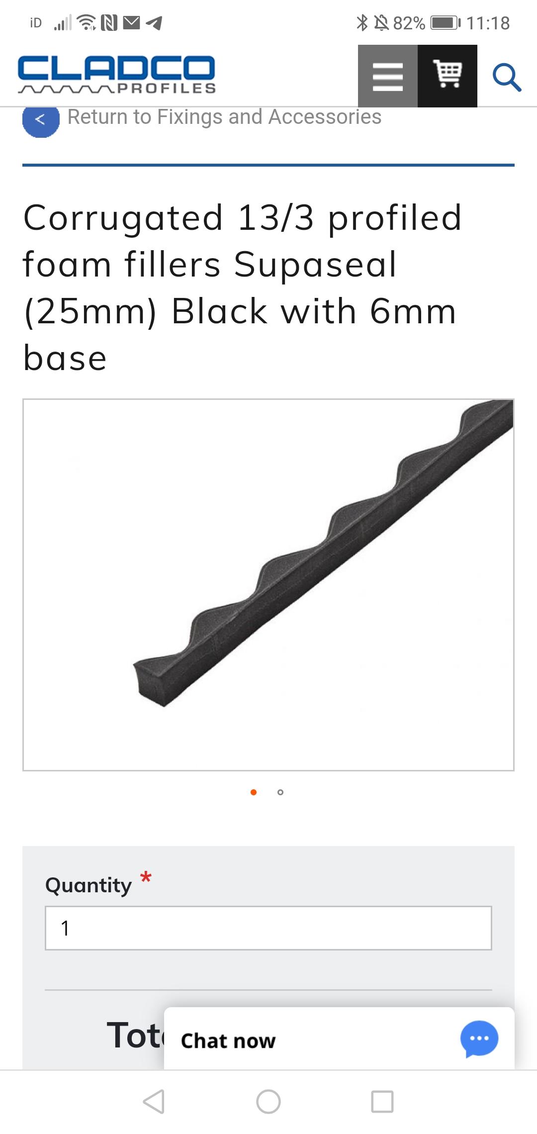

Cpd Posted April 10, 2020 Share Posted April 10, 2020 I left the bottom open as you need ventilation, I used these at the top to stop water blowing up under the ridge...... very windy location and water blows right over the roof..... I fitted them on top of the tin and below the ridge flashing. Until you explain what your roof is for its very hard for people to give good advice. Link to comment Share on other sites More sharing options...
Visti Posted April 10, 2020 Share Posted April 10, 2020 Exactly as @Cpd did, we only used the foam filler to plug the gap at the top with the ridge cap, since that doesn't have a corrugated profile. If you screw the sheet directly to an OSB board then: 1. You'll have very limited ventilation, since you're restricting it per vertical profile, and allowing not very much volume of circulation at all (Cladco profiles are only 18mm thick). 2. Condensation will run directly onto the OSB from the tin, with no chance to evaporate first or on an intermediary medium such as a batten or purlin which don't matter as much as your structural envelope. Do you have your roof buildup details? Any reason you can't use battens or purlins? The former are cheap as chips. If you're in Oxfordshire I've 4 packs of 10 just lying around. Link to comment Share on other sites More sharing options...

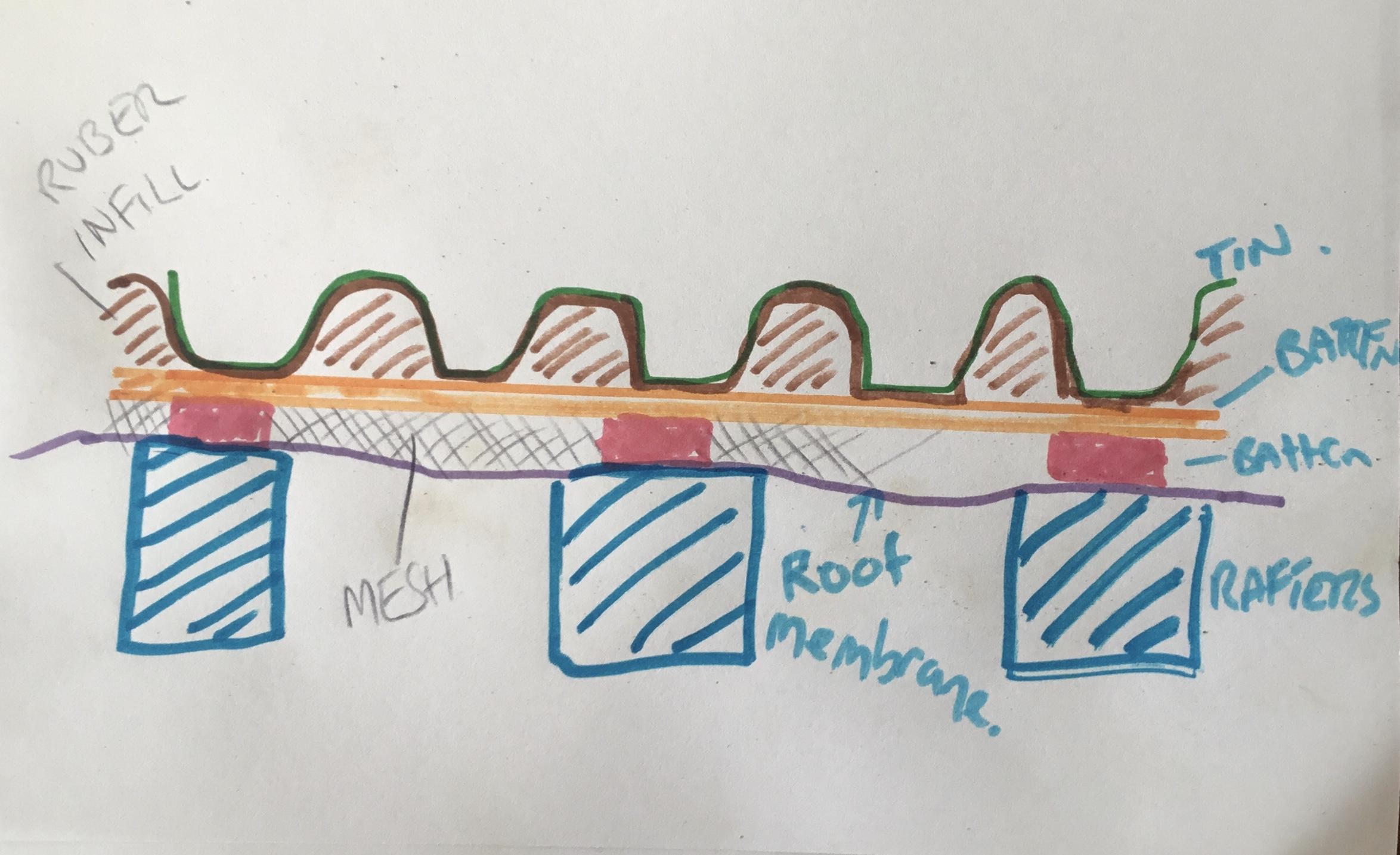

TheMick Posted April 12, 2020 Share Posted April 12, 2020 On 10/04/2020 at 15:33, Cpd said: I left the bottom open as you need ventilation, I used these at the top to stop water blowing up under the ridge...... very windy location and water blows right over the roof..... I fitted them on top of the tin and below the ridge flashing. Until you explain what your roof is for its very hard for people to give good advice. But the cladco install video shows them going in the bottom near the gutter. It's doesn't mention fitting then at the top at all. Do you think it's better to just have the battens running lengthways or have a sheet covering the whole roof with the battens on top of it? Thx Link to comment Share on other sites More sharing options...
Russell griffiths Posted April 12, 2020 Share Posted April 12, 2020 This is how I would do it cover the tops of the rafters with a good quality breather membrane, then a 50x25 counter batten that fits on top and parallel to the rafters then a 50x25 batten fixed on top but at 90degrees to the rafters, fit sheets on top use a ventilation strip at eaves and ridge you want airflow but not bugs. Those battens are 100x25 and are spaced 100mm apart you won’t need to do this, space them how far apart the sheet manufacturers say you need the fixings 600-750mm whatever, remember you won’t be able to walk on anywhere there isn’t a batten. mesh at facia level 1 1 Link to comment Share on other sites More sharing options...
joe90 Posted April 12, 2020 Share Posted April 12, 2020 With my garage/workshop cladco roof I enquired about “anti condensation coating” and was told it’s only any good in well ventilated places like barns. Instead I simply used roofing battens over roofing felt draped slightly, profile filler at ridge to stop driving rain and bug screen at eaves. This works very well. Link to comment Share on other sites More sharing options...
Cpd Posted April 12, 2020 Share Posted April 12, 2020 3 hours ago, TheMick said: But the cladco install video shows them going in the bottom near the gutter. It's doesn't mention fitting then at the top at all. Do you think it's better to just have the battens running lengthways or have a sheet covering the whole roof with the battens on top of it? Thx I think @Russell griffiths design is spot on, max ventilation and no wildlife can get in, but as he said space your battens out as required. I really can’t see how the rubber infill is a good thing at the bottom....... you need ventilation. I guess you could fit it on top of the first batten in conjunction with a wire mesh to stop wildlife and let the ventilation work as it would be quite hard to get wire mesh to work with the corrugations. You will need to do something at the top if you live in an exposed location as I have watched water blowing right up my 45 degree roof and water was just pouring in under the ridge and running down the roof membrane and into the gutter at the bottom ! The rubber strip worked really well to stop this. 1 Link to comment Share on other sites More sharing options...
Cpd Posted April 12, 2020 Share Posted April 12, 2020 You would need to detail the insect mesh where it meets the roof membrane and I’m not sure how you would get the rubber in the right place as the first Fixing batten will be at least 100mm up the roof... just needs a mock up to come up with a plan. Link to comment Share on other sites More sharing options...
TheMick Posted April 12, 2020 Share Posted April 12, 2020 9 hours ago, Cpd said: I think @Russell griffiths design is spot on, max ventilation and no wildlife can get in, but as he said space your battens out as required. I really can’t see how the rubber infill is a good thing at the bottom....... you need ventilation. I guess you could fit it on top of the first batten in conjunction with a wire mesh to stop wildlife and let the ventilation work as it would be quite hard to get wire mesh to work with the corrugations. You will need to do something at the top if you live in an exposed location as I have watched water blowing right up my 45 degree roof and water was just pouring in under the ridge and running down the roof membrane and into the gutter at the bottom ! The rubber strip worked really well to stop this. Thanks for that. The roof membrane if I have this right should be breathable to allow any moisture from the inside of the room to be released into the ventilated area beneath the corrugated tin. If the room ceiling was boarded out on the inside face of the rafters with insulation behind it wouldn't that mean there would be no warm air/moisture to release in this way? Link to comment Share on other sites More sharing options...
