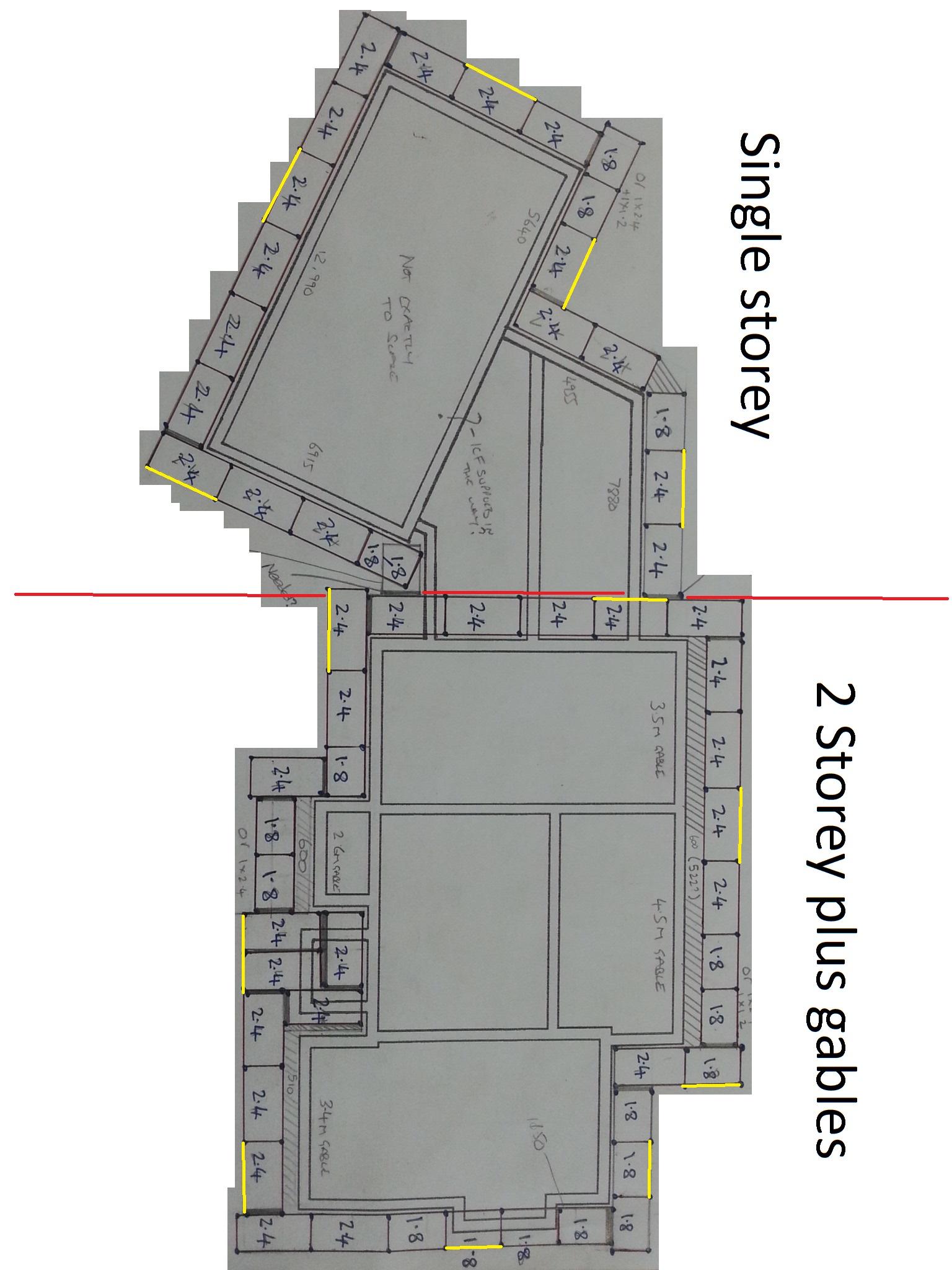

Vijay Posted May 10, 2019 Author Share Posted May 10, 2019 (edited) Dawn on me today it has to be two transoms because of the fixings. So just the bracing to sort now. If you guy in the know would see what you think of this bracing. Yellow lines show where I would use bracing (sort of every 4 bays). Obviously where it's double storey, I would zigzag it up (red line separates the single and double storey areas). Edited May 10, 2019 by Vijay Link to comment Share on other sites More sharing options...
Vijay Posted May 10, 2019 Author Share Posted May 10, 2019 sorry for it being the wrong way, can't see any option to rotate it Link to comment Share on other sites More sharing options...
