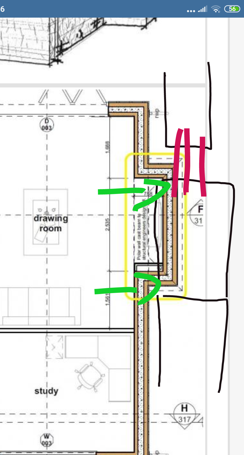

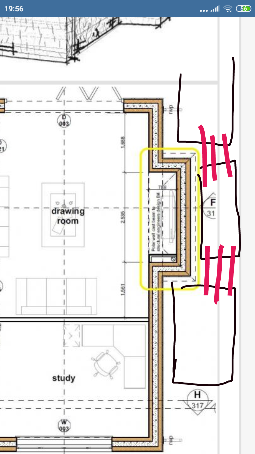

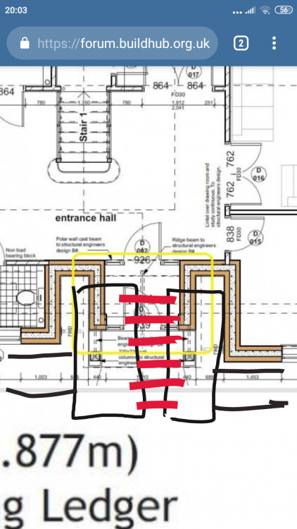

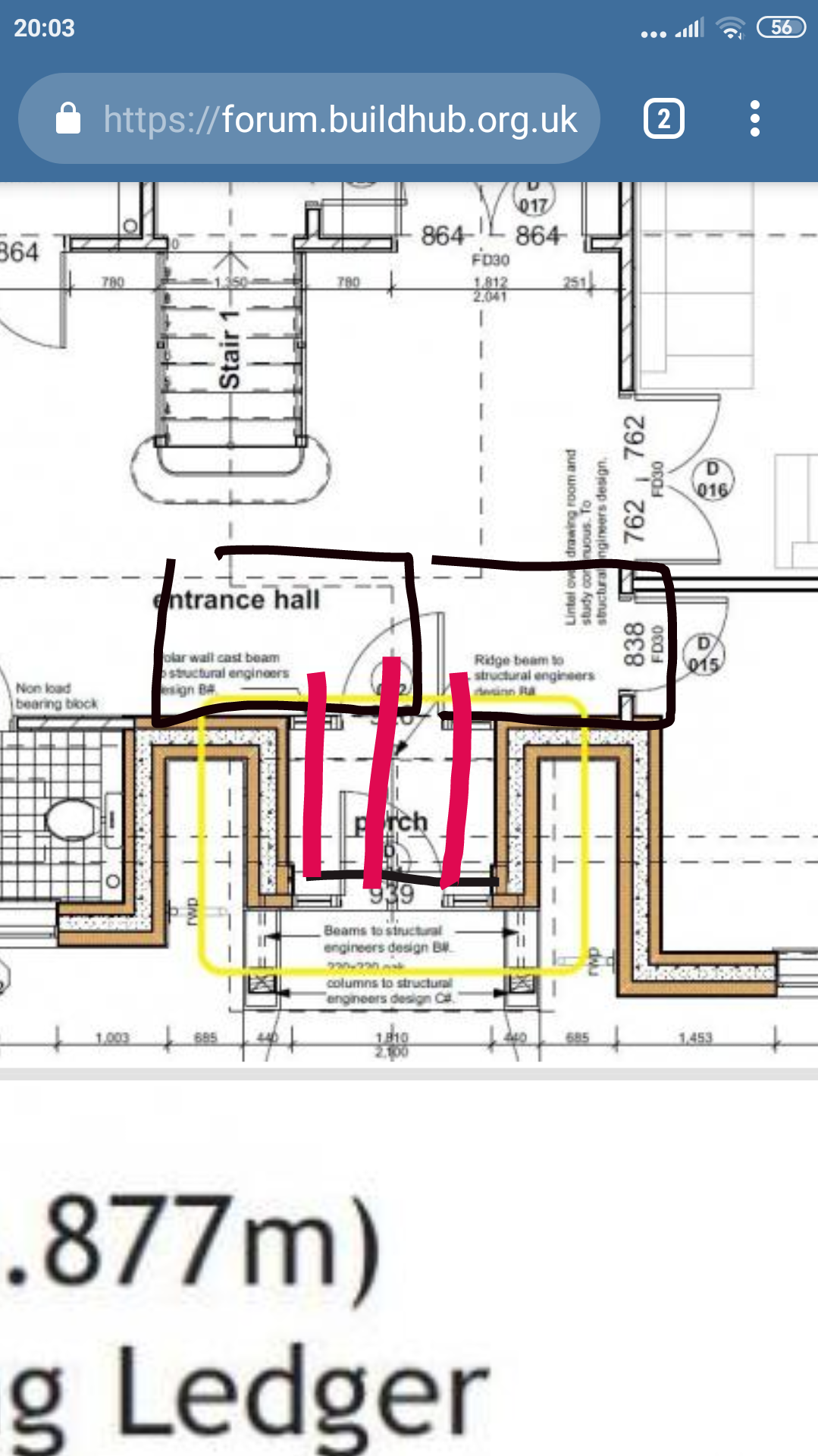

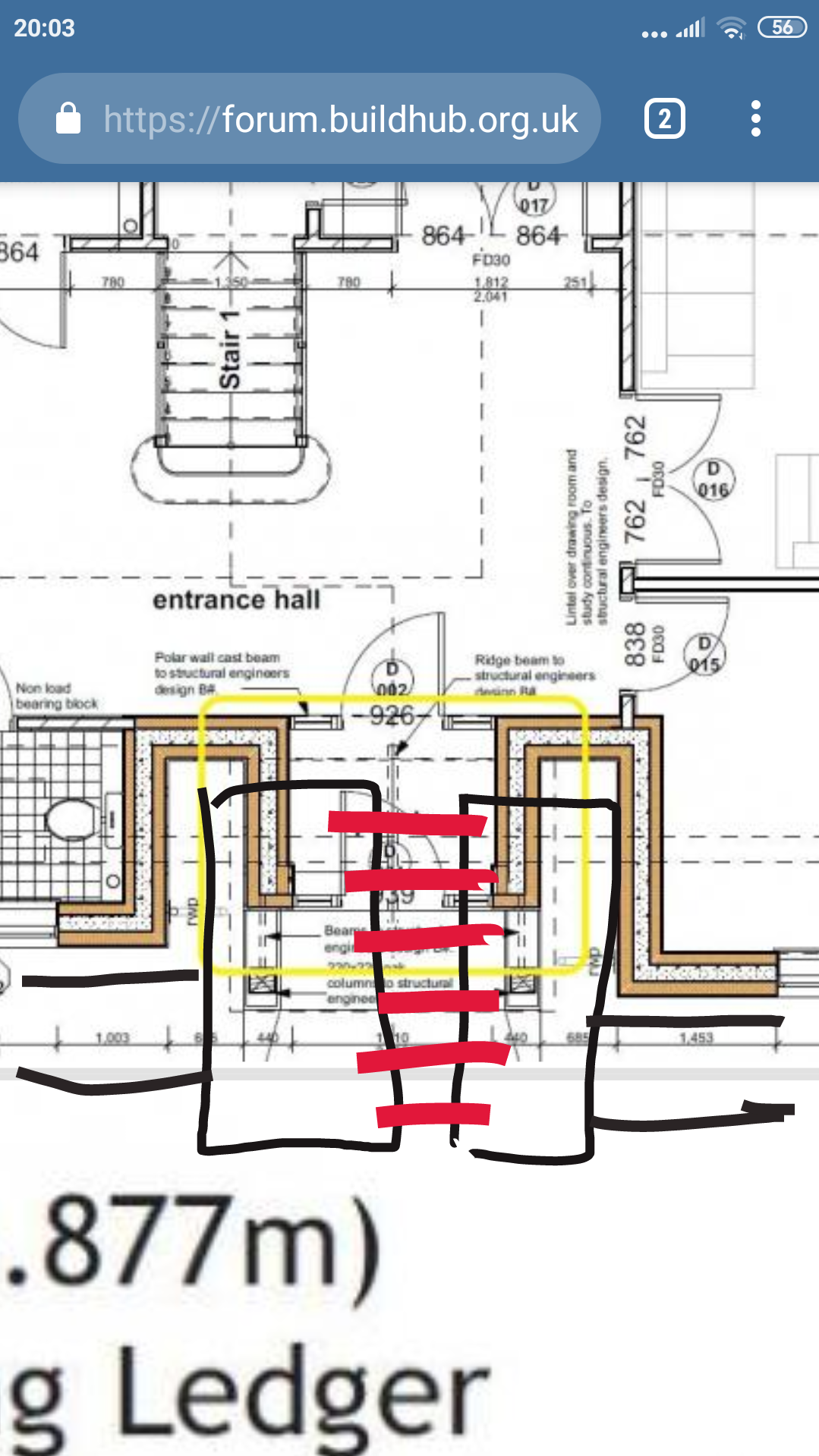

Declan52 Posted March 10, 2019 Share Posted March 10, 2019 The chimney is the easy bit. You will need to scaffold it twice and leave the small roof of till the main work is done. The first pic is when your on the first lift. Your basically putting one single bay in the middle of the chimney and bridge both gaps to the other runs. Will need to be all tied together. The second pic is when your above the height of that wall of the chimney. You continue the run and will have a single standard in the room. You won't be able to connect anything to it until it's above the wall height so you put a diagonal brace on where the green arrow are. Once above the wall height then put the ledgers and trannies in as usual. Then you just bridge the gap and tie both runs together. The porch is going to be a bit more tricky. For the first lift I would put 2 bays inside the house and 2 trestles at the door and then plank the gap and do that from the inside. Once your above the porch walls then it's 2 separate bays and planks covering the gap. This will be handy when doing the roof as it will be a massive area to load timber and tiles on to. Link to comment Share on other sites More sharing options...
Vijay Posted March 11, 2019 Author Share Posted March 11, 2019 Thanks again Declan So if I've understood correctly, I wouldn't have any bottom transoms where I'm bridging a wall? I really like that idea of the loading bay How high are the standards and their fixing points? What ladders am I allowed/supposed to use? Anything I've looked at kind of shows internal staircases. Link to comment Share on other sites More sharing options...
Declan52 Posted March 11, 2019 Share Posted March 11, 2019 27 minutes ago, Vijay said: Thanks again Declan So if I've understood correctly, I wouldn't have any bottom transoms where I'm bridging a wall? I really like that idea of the loading bay How high are the standards and their fixing points? What ladders am I allowed/supposed to use? Anything I've looked at kind of shows internal staircases. Yep the standard will only have a ledger/trannie at the top once its high enough to go over the wall. The diagonal will just stop it from moving in and out. Standards are 9ft9 mainly but you can get shorter bars, 6ft6 and 3ft3. Each standard will have 4 V shapes welded onto the bar at approx 1ft6 intervals. They look like a star. You use whatever type of ladder you have. Internal stairs are safer as nothing can fall in you as the planks above protect you. If it is on the outside then make sure it's long enough to get to your highest lift and go past it so it's safer to use. Make sure its tied to the bars as well. Link to comment Share on other sites More sharing options...

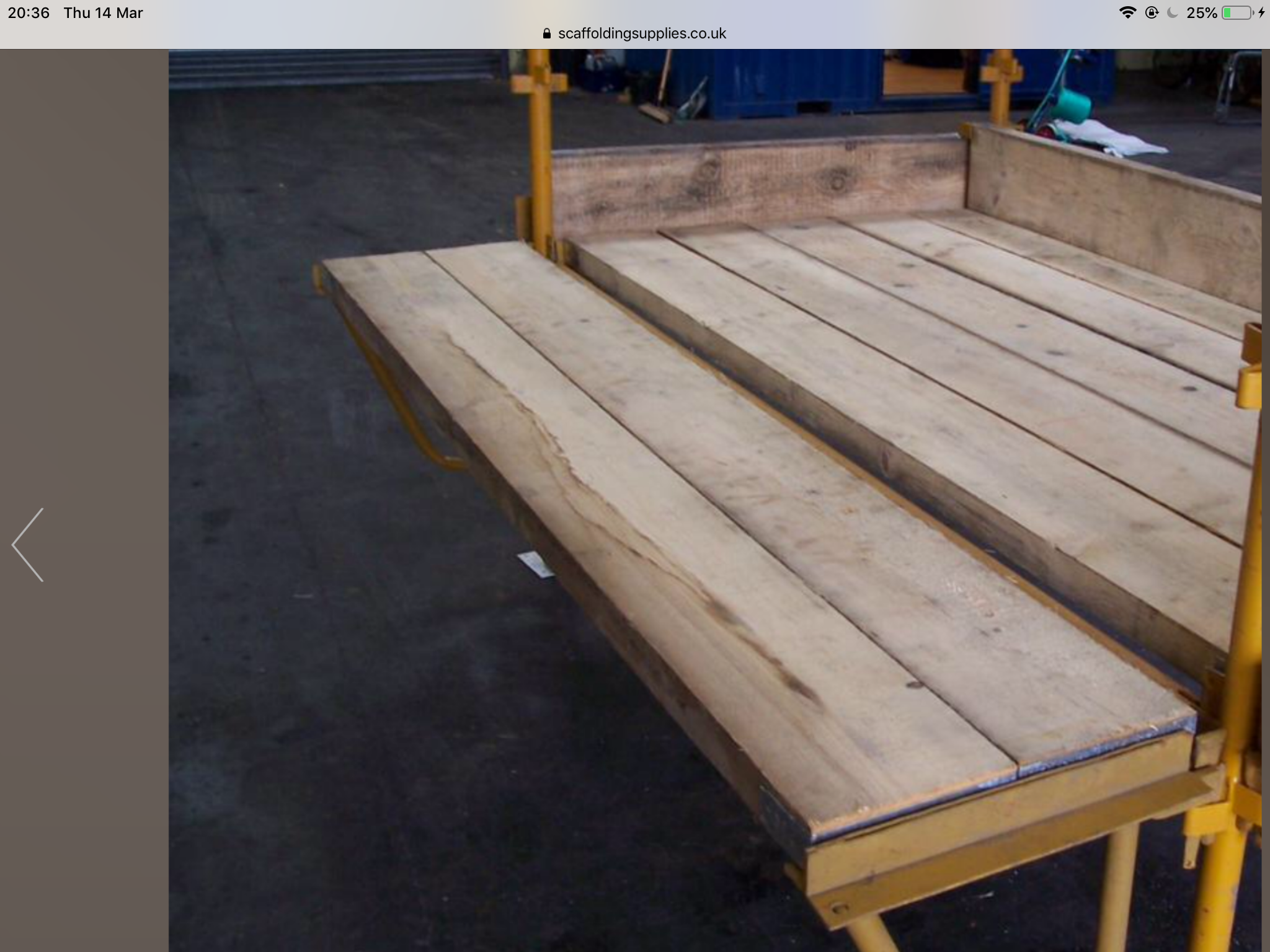

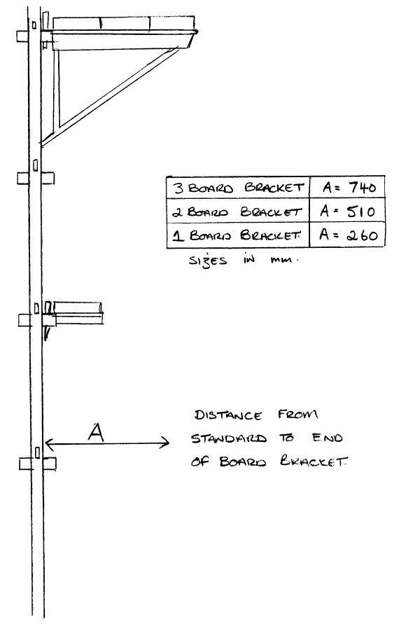

Declan52 Posted March 14, 2019 Share Posted March 14, 2019 Needs to be far enough out that it won't hit the over hang of your roof. You can use a 2 board hop up bracket and then it comes off when your at the roof height. https://www.scaffoldingsupplies.co.uk/products/details/3072.html Or set it 9 inches from the wall and if it needs moved out for the tiles as long as you have it sitting on timber it can be slid out easily enough to where it needs to go. Link to comment Share on other sites More sharing options...

ProDave Posted March 14, 2019 Share Posted March 14, 2019 On 10/03/2019 at 19:49, PeterW said: From memory there is a fitting on the side of the bridging ledger to take a cross brace but it’s been a while since I’ve seen one used - that chimney doesn’t look wider than 8ft anyway ..?? They are called "hop up's" Available as 1 or 2 board wide. Link to comment Share on other sites More sharing options...

ProDave Posted March 14, 2019 Share Posted March 14, 2019 Hop up's are used in conventional timber frame construction to allow the initial scaffold working platform to come close to the timber frame. Then later when the blockwork outer skin is built, the hop up's are removed to create the "gap" to build the blockwork. Link to comment Share on other sites More sharing options...
Vijay Posted March 20, 2019 Author Share Posted March 20, 2019 The dimension of the soffit is 450mm (plus tiles) so I guess I will have to include some hop up brackets/boards to keep things safe and have the scaffolding out far enough. Link to comment Share on other sites More sharing options...

Declan52 Posted March 20, 2019 Share Posted March 20, 2019 Yeah a hop up will make it easier. The return transoms are used at the level you plank out. So you lift them as you go up. If you have a few levels planked out then you need them on each of these corners. Link to comment Share on other sites More sharing options...

Declan52 Posted March 20, 2019 Share Posted March 20, 2019 You also use small lengths of round bar and use clamps and tie it together across the standards. Kwikstage is very easy to move a lift up and down that's what makes it so popular. Link to comment Share on other sites More sharing options...
Vijay Posted April 9, 2019 Author Share Posted April 9, 2019 (edited) Still trying to get a plan together of what I might need - not as easy as I first thought. I mentioned earlier that my soffit is 450mm, so am I right in saying using a 2 board hop up is correct which says it's 510mm? I'm very cautious of getting it wrong and ending up too close when it comes to the roof. I know you guys have said it can be "persuaded" out a little, but I could see that being an issue when corners are tied into each other. So should I plan to have my scaffolding say 550mm out to give me some slight clearance? Also, can I confirm that a return transom cannot bridge a standard but sits on the ledger (so a straight run of a ledger without a standard in the middle of it)? Edited April 9, 2019 by Vijay Link to comment Share on other sites More sharing options...

Declan52 Posted April 9, 2019 Share Posted April 9, 2019 You use a return transoms to tie together 2 different runs. It won't fit if there is a standard in the way. If you want to tie standards together you use clamps and short round bar or another ledger if it's a wider gap. As for the size of the hop, that's up to you. You could use a double board and set it 100mm from the wall and that would give plenty of room. Link to comment Share on other sites More sharing options...
