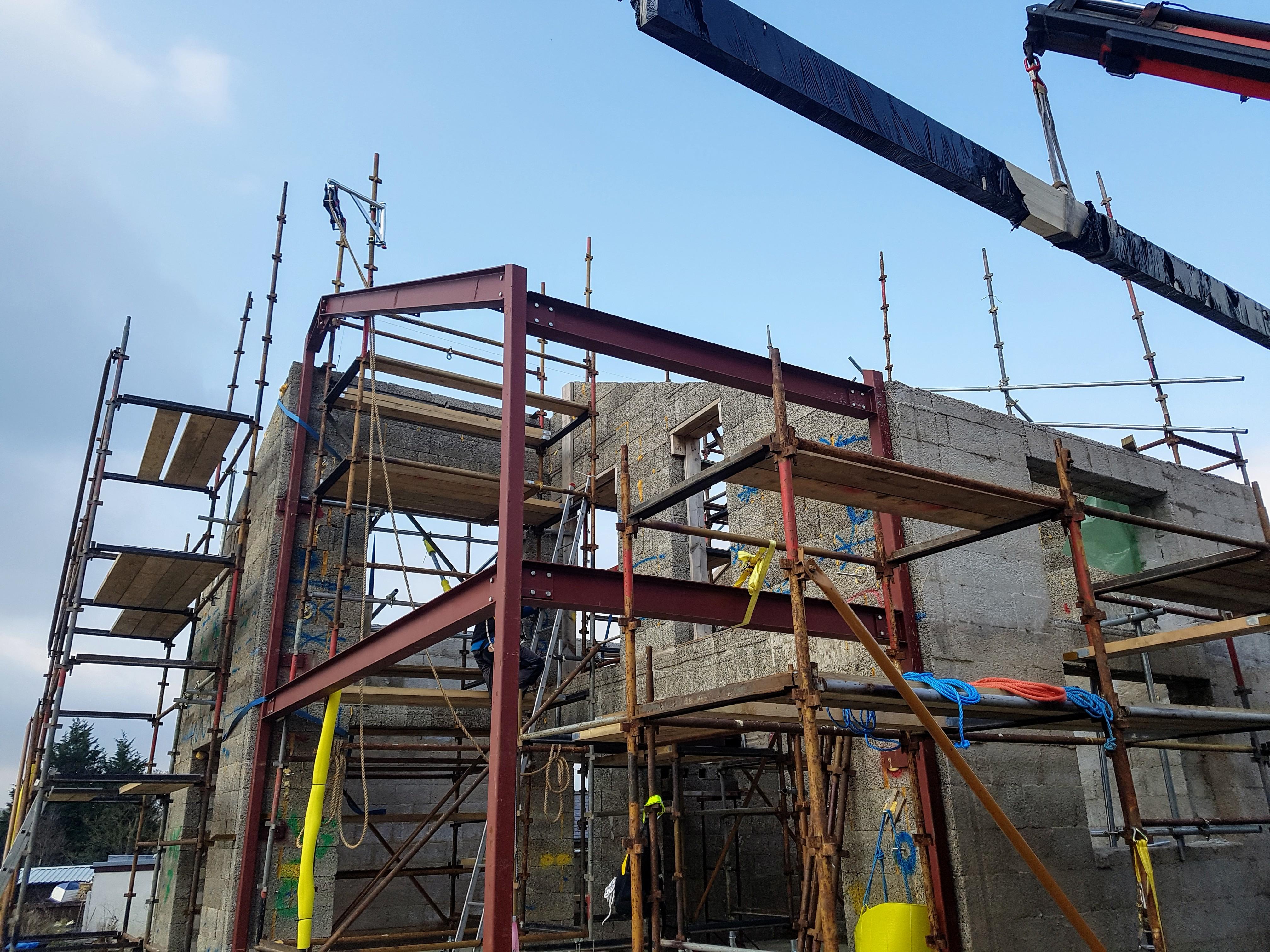

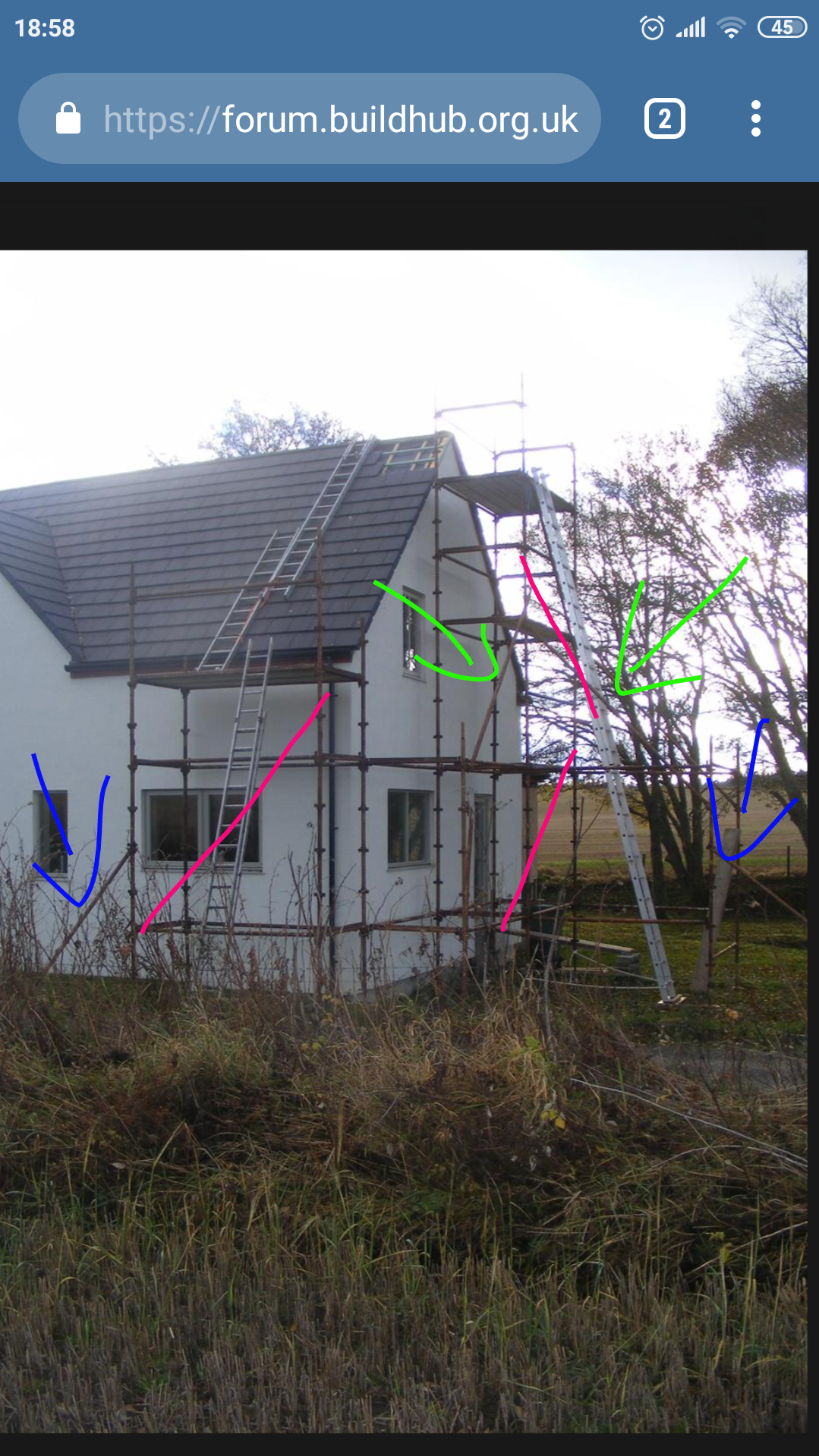

ProDave Posted March 6, 2019 Posted March 6, 2019 Perimiter of 40M is not that great, at a guess (I bet is is not a 10M per side square) that would be 6 lengths along 2 sides and 3 lengths on the other 2, so 18 bays of scaffold. I had 5 bays along the front and back and 3 bays along the sides though not as high perhaps. I would just buy enough and re sell at the end. Though I did choose to keep some, what is in my picture above is almost all that I have left now though I do have a lot more boards than I used for that.

ProDave Posted March 6, 2019 Posted March 6, 2019 Someone else said one brace per level possibly two. for me it was a case of how many have I got? and spread them about evenly. No the toe boards are not about rigidity but safety. And on the working platforms, you should have two handrails, one on the lower set of pegs as well, another thing I did after I took the photo.

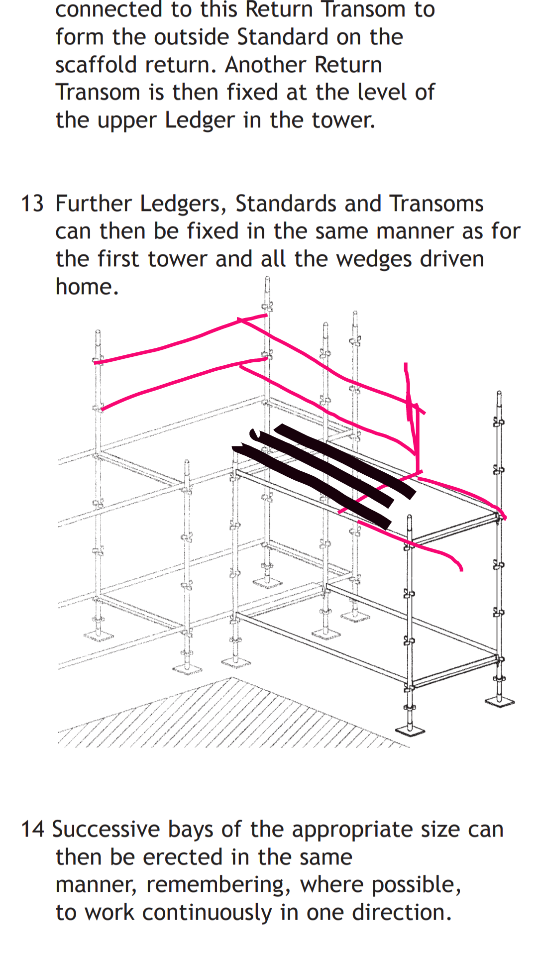

Vijay Posted March 6, 2019 Author Posted March 6, 2019 4 hours ago, Declan52 said: 2. Transoms are just the part the plank sits on. They are and upside T so the plank sits in the web. 3. You start another run and tie both parts together using small sections of round bar and clamps. Then overlap planks from one side to the other to bridge the gap. 5. You need a diagonal in on every lift in height. Depending on how long the run is you might need 2 spaced apart. 11. You can either use 21 ft round bars if this is long enough or steel ladders that have round bars that scaffold clamps clamp to. Or you leave the roof of the porch and put a standard on the floor and continue the run as normal. Strip the scaffold and then finish the porch. Need to put a pic up to see what you mean about the fire place. Thanks Declan 2. Are return transoms the correct/only way of doing a 90 degree return? 3 - Do you by any chance have a pic of that? 5 - My build has a lot in internal/external corners so lengths are kind of staggered (if that makes sense?), so I can't get my head around how I know how much bracing I might need. Is the bracing specific Kwikstage products or normal scaffold tube/fixings? 11 - I'll post up some pics to show what I mean

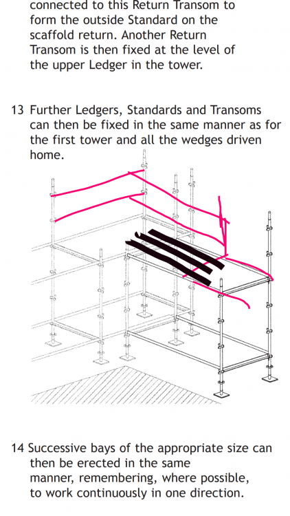

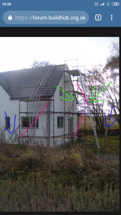

Declan52 Posted March 6, 2019 Posted March 6, 2019 Using daves pic as an example he should have used 3 diagonal bars in where I have the pink lines. Nothing wrong with how he has done it as he says he only had a few so used 2 for the centre bay to stop it wobbling about. One he has used in the correct way to stop the wobble as shown by the green lines. He has also used 2 as outriggers shown in the blue arrows. But dave was the only person on that scaffold so no real need for toe boards, double ledgers for handrails and double trannies at the ends. Strictly speaking he has took a risk but everyone does it. I have been on some proper scary scaffolds in my time, real sea leg type jobs.
ProDave Posted March 6, 2019 Posted March 6, 2019 The ones I use as "outriggers" are some leftovers that only have an intact peg on one end, so can't be used as a proper brace. I kept them when I sold most of the scaffold and use them like that with the "dud" end in the ground.

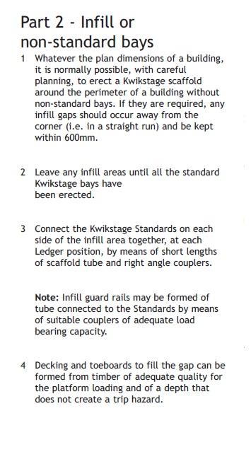

Declan52 Posted March 6, 2019 Posted March 6, 2019 13 minutes ago, Vijay said: Thanks Declan 2. Are return transoms the correct/only way of doing a 90 degree return? 3 - Do you by any chance have a pic of that? 5 - My build has a lot in internal/external corners so lengths are kind of staggered (if that makes sense?), so I can't get my head around how I know how much bracing I might need. Is the bracing specific Kwikstage products or normal scaffold tube/fixings? 11 - I'll post up some pics to show what I mean On that pdf page 13 the pic on the left shows how you can do a corner. If there is a gap then you can bridge it with planks. It will just depend on the how your run works in in 8ft lengths. The planks will cover the hole and you use 2 ledgers that will slot into a Standard on one side and use clamps to tie it to the other run. Page 52 is about the diagonal bracing. So every 4 bays is a brace. They are a kwickstage bar. They have a swivel type head as sometimes they take a bit of wrestling to get the pin to line up. https://www.scaffoldingsupplies.co.uk/products/details/364.html
Vijay Posted March 10, 2019 Author Posted March 10, 2019 Thanks so much Declan. I also found some more info on bay infills on page.15

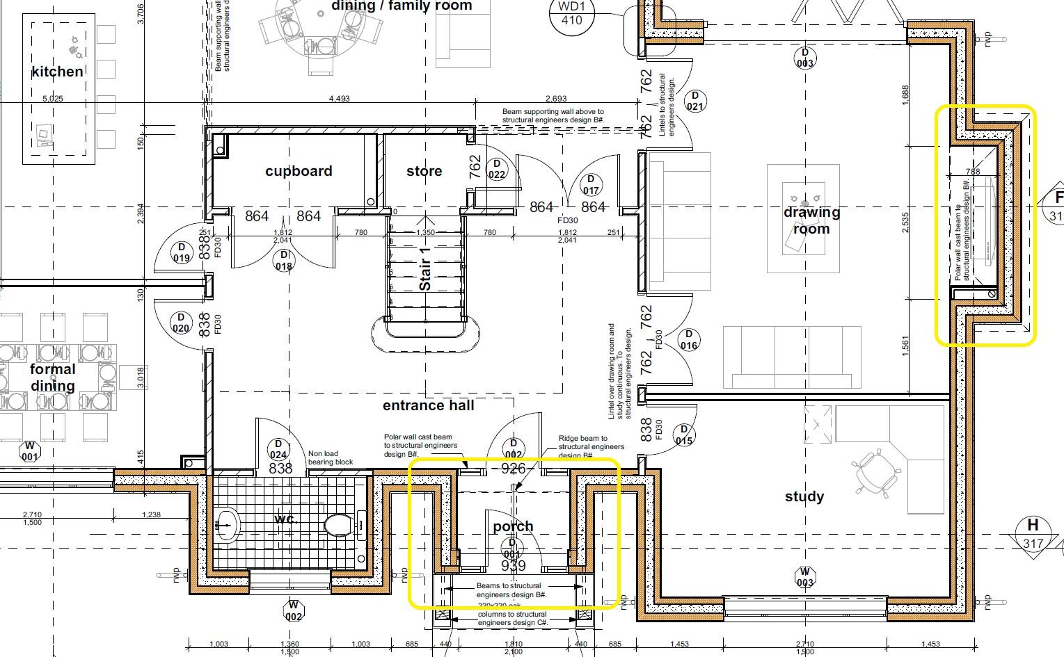

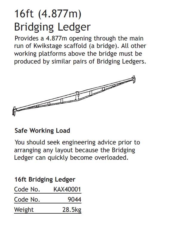

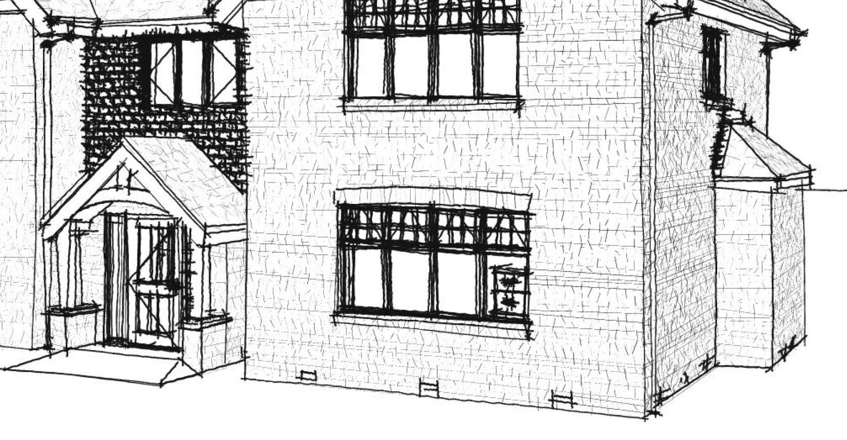

Vijay Posted March 10, 2019 Author Posted March 10, 2019 Here is a couple of pics that show what I mean about the porch and external fireplace. As I said these are single storey and I can't build them afterwards as it's all in ICF. I assume I need to use something like a bridging ledger??
PeterW Posted March 10, 2019 Posted March 10, 2019 @Vijay it doesn’t matter how much Kwikstage you have, or what components, you’ll still want more.... bridging ledgers are ok but they bounce a lot ..! That chimney can be done by missing out the bottom ledgers and just use a cross brace and keep the bottoms together with that.
Vijay Posted March 10, 2019 Author Posted March 10, 2019 So I would use 2 diagonal braces to make a V?
PeterW Posted March 10, 2019 Posted March 10, 2019 From memory there is a fitting on the side of the bridging ledger to take a cross brace but it’s been a while since I’ve seen one used - that chimney doesn’t look wider than 8ft anyway ..??
