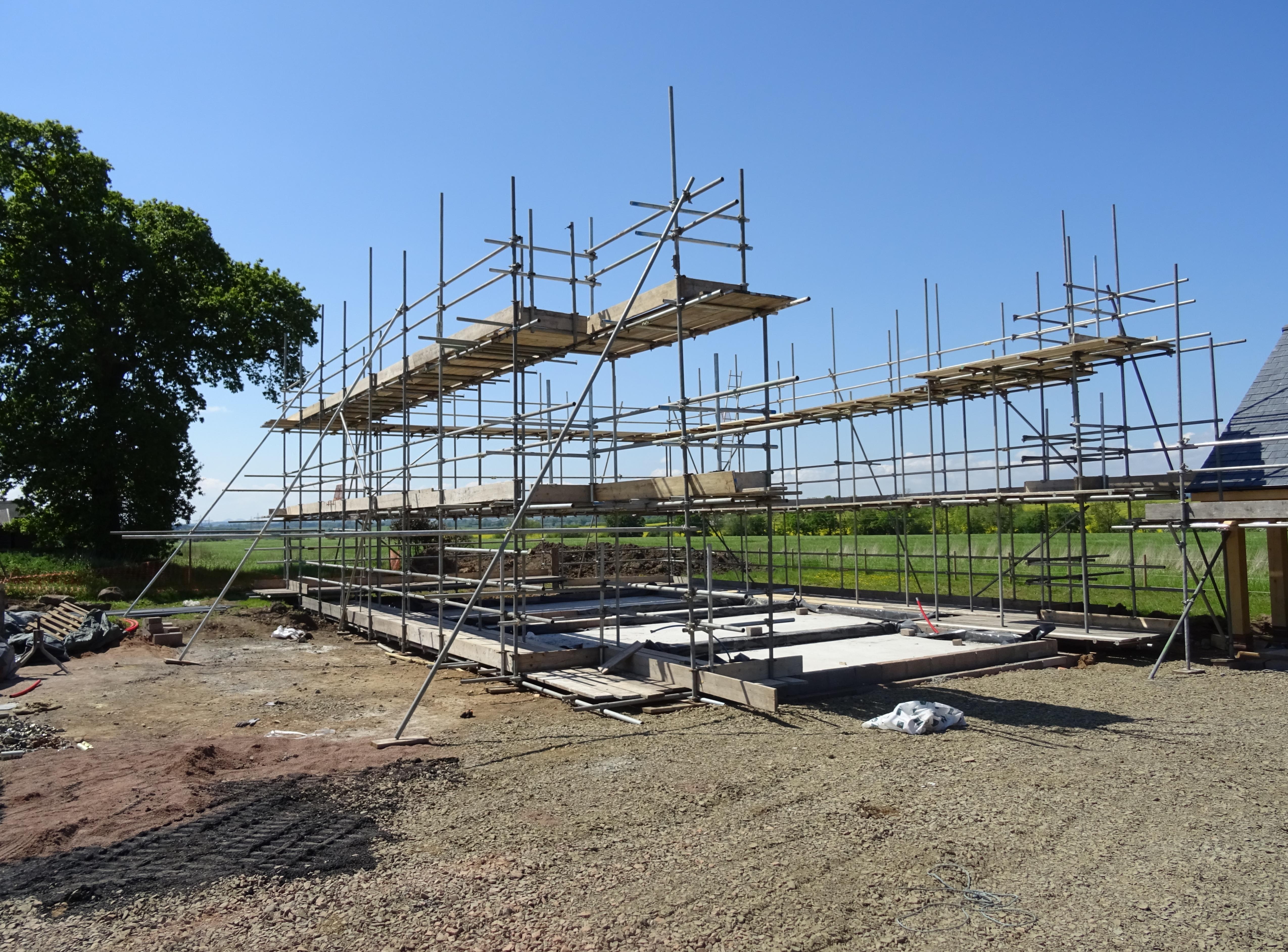

Redoctober Posted March 5, 2019 Share Posted March 5, 2019 The quote, even with the weekly visit included appears pretty much near the mark to me. If it helps, I paid £5k for the set up in the attached photo and that was for a 10 week hire. However, it did include a front and back set up for a single storey stand alone car port. Link to comment Share on other sites More sharing options...
nickw Posted March 5, 2019 Author Share Posted March 5, 2019 Mine doesn't include weekly visit, if inc it's about £5100 plus mine is only 1 lift , looks to be about half your height, eaves are only at 3.2m ish. Just waiting on another few quotes. I figure I'll change a couple of things to get the cost down. Link to comment Share on other sites More sharing options...
