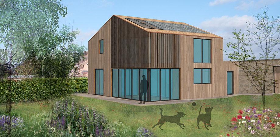

ToughButterCup Posted February 27, 2019 Share Posted February 27, 2019 1 hour ago, MikeGrahamT21 said: [...] Any one else embarked on such a project? I am in the process of making ours now. Its a series of vertical slats suspended between two RSJs, and faces the viewer in the image below. That corner of the house is outside the heated envelope - at one stage we were planning to glaze it - but its pointless, and expensive. Very expensive. The sexy term for what we are doing is called making a Breeze Corridor (Blame Kevin for that one). The architect calls it a design feature, Debbie calls it her Winter Garden, the retired feminist roofer calls it ' t patiau , I call it fun. I'm doing a bit on it each weekend. If needed , we'll make a scaled down version of that design in front of the two windows to the right of the ' patio' . PHPP points to a small theoretical risk of overheating. PHPP can't make adjustments for a crap first time, eight-fingered self- builder now can it? Link to comment Share on other sites More sharing options...
